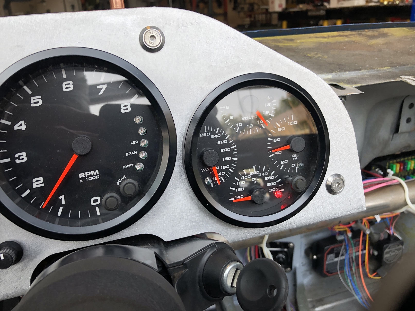

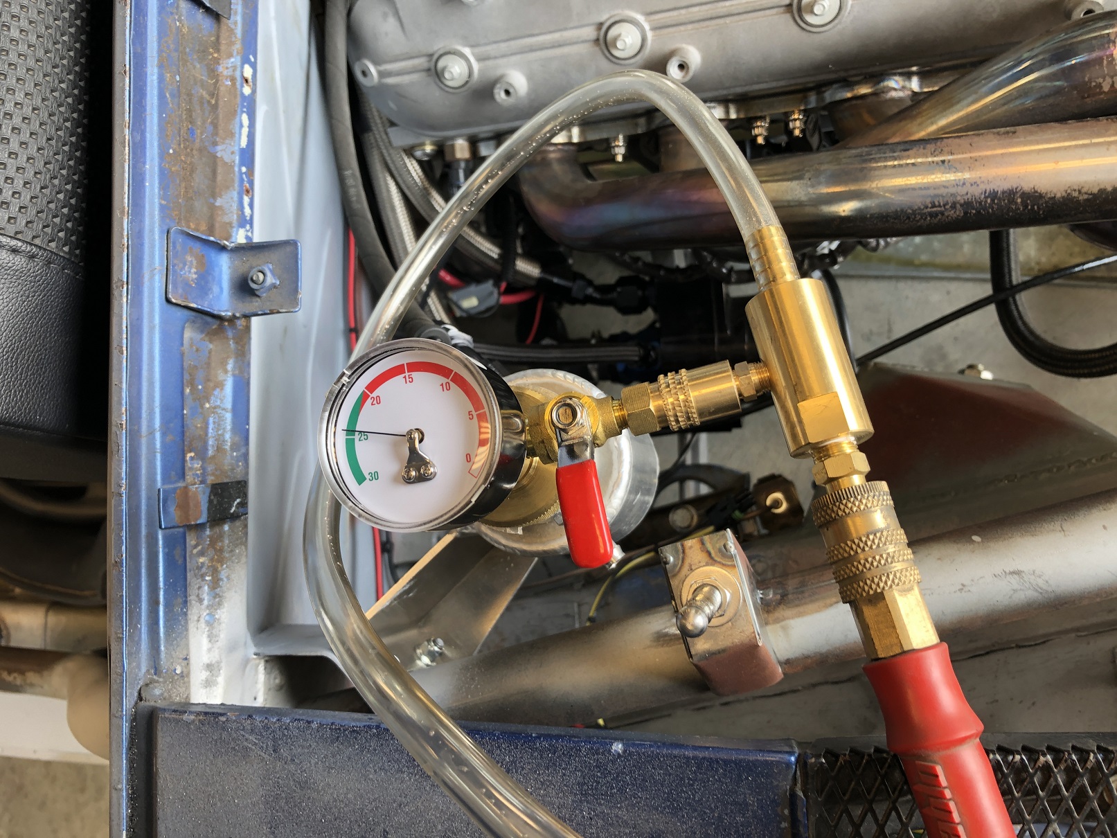

Thanks everyone, it was quite a momentous day! And no, @azbanks , I didn't run it at all after what you saw in the videos. I had a couple items to deal with first:
First, I hadn't yet put any coolant in it so didn't want to run it until that was addressed. @Krieger Andy came through with a magical vacuum driven radiator filling system. It uses a venturi set up, powered by an air compressor. Stick the main unit into the filler and pull a vacuum. If the system holds it, you have no leaks! Then remove the air line and attach a hose that is stuck into the coolant container. Open the valve and the system sucks in coolant until full.
All told, this took like 6 minutes. Very cool and highly recommended!

During those video runs, the oil pressure gauge was reading "0". I was confident it wasn't true since it last ran just fine on the dyno. But @markhoward Mark came through with a mechanical, remote pressure gauge! I connected it to a spare plug on the in/out oil block and cranked until I verified pressure was, in fact, there. It was, as expected. Big thanks to Mark! (IMG:style_emoticons/default/beerchug.gif)
So what's up with the gauge? Turns out the wiring that came with the gauge was pinned out differently than the "extra length" wiring I purchased about a year after I got the gauges. A quick flip of two wires and all's well!
Next, the water temp gauge seemed like it wasn't working so I verified the wiring then pulled the coolant temp sensor and used the heat gun on it. The gauge works.
I guess I expected the engine to come up to temp more quickly...
Anyway, I figured now that it has coolant, I'd just let it run until it was clear the temp gauge should move - and it did!
A word about the SpeedHut gauges: I REALLY like these. Each gauge has it's own programmable LED that supports a user-set warning at both a Low and High value. So, you can see that the oil temp light is on, indicating the oil isn't yet up to temp but the water temp light has gone out and the gauge is climbing.
Pretty neat.

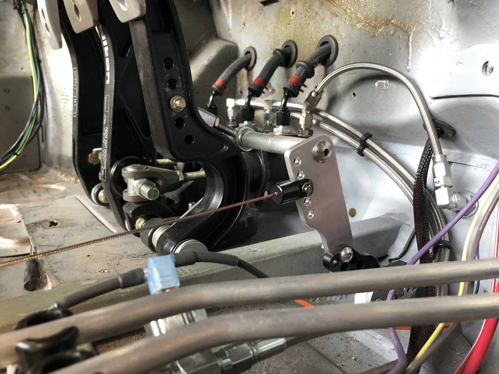

I'm hoping part of it is that the throttle feels a bit abrupt. The springs on the ITBs are really stiff. Maybe it'll all relax a bit as things settle in but I've already taken advantage of my "adjustable" throttle linkage:
I moved the cable attachment location down two positions. You can probably tell that this means the same pedal travel = less cable travel and softens throttle response.
I also have everything to learn about programming the the Holley HP ECU and wouldn't be surprised if there's something I can do in there, if needed.

Chris - the volts reading seems a little high at over 14V running - is that just parallax error from the camera angle? or maybe these big engines need big volts.....
- Tony
PS. I think its funny that you built a short, near straight through exhaust system - and you're surprised its rather loud...!

@Retroracer - Tony, I think it's the angle but I'll take a look. I wouldn't expect any issues as it's running a standard alternator, but then, you know me and electric stuff!
