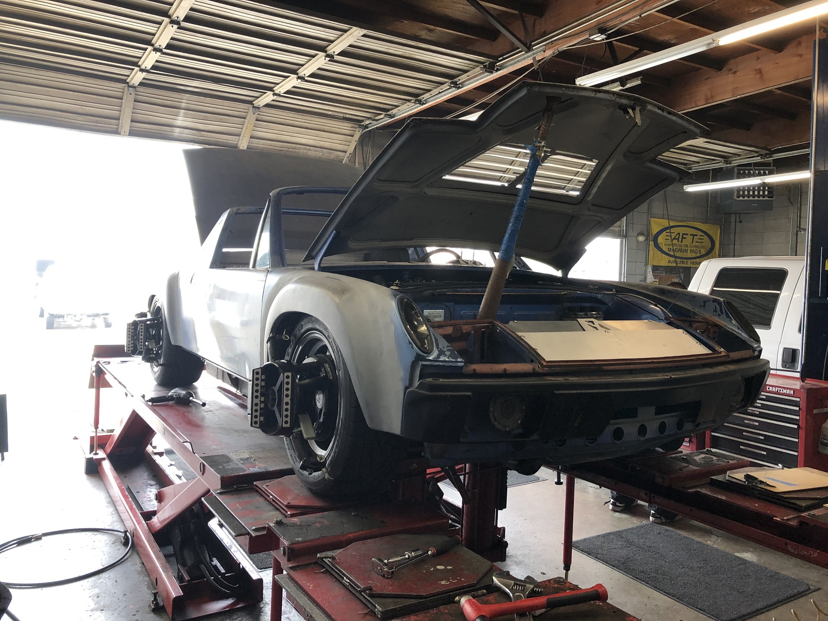

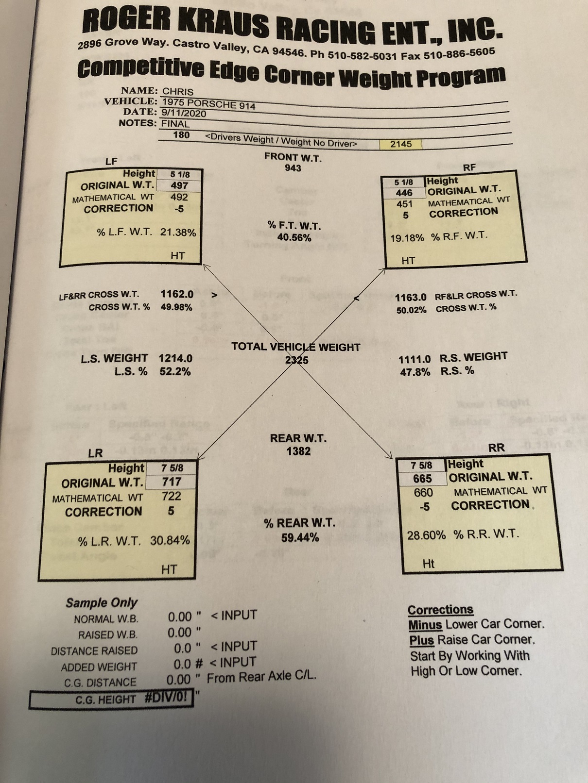

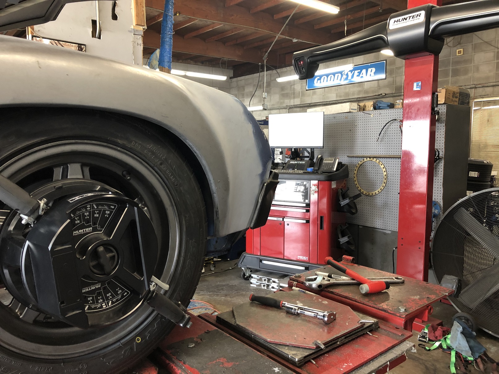

If there was a milestone I was most worried about, it was this one: Alignment and corner balance.
With all the chassis work I did, especially the Tangerine raised rear suspension pickup points, I was a little freaked out that when I took it in, it wouldn't be able to be brought into spec.
Well, after a morning at Roger Krause Racing with none other than Brandon Krause doing the work, I'm ecstatic to report that everything worked out wonderfully!
Even bump steer checked, measured and set. Overall, things are in the "aggressive street" range.
The following items weren't installed at the time:
- GT headlight kit/headlight bucket assembiles/headlights
- windshield
- rear window
- passenger seat
- targa top
- misc. seals
In this state, the car weighs in at 2145. I was sure it'd be heavier than that. I'd bet I don't add more than about 100 lbs. putting all the remaining stuff in so with 518 hp, I'm at ~ 4.34 lb/hp. Yikes.
But in all, a VERY major milestone. Next, it's off to get the ITBs and ECU some love.

WOW! WOW! WOW! That is light! You were pretty close in you weights too.

Damn that's light!!! That's almost 400lbs lighter than the white car which is also an aluminum LS motor.
Seriously impressive!
Congrats! It's gonna be a monster!!!
