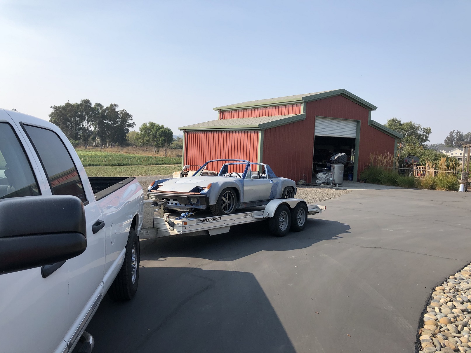

post Sep 20 2020, 05:11 PM
Post #3020
Posts: 5,858
Joined: 6-October 15
From: Petaluma, CA
Member No.: 19,241
Ready for tomorrow morning's trip to the tuner. With a bit of luck and tuner skill, I expect I'll be making the first, full road test by next weekend. The goal is to have it dialed in and ready for WCR in Nov.
And just to set expectations, that'll be with the windshield taped in, the roof taped on, no seals/weatherstripping, no interior, etc., etc.
