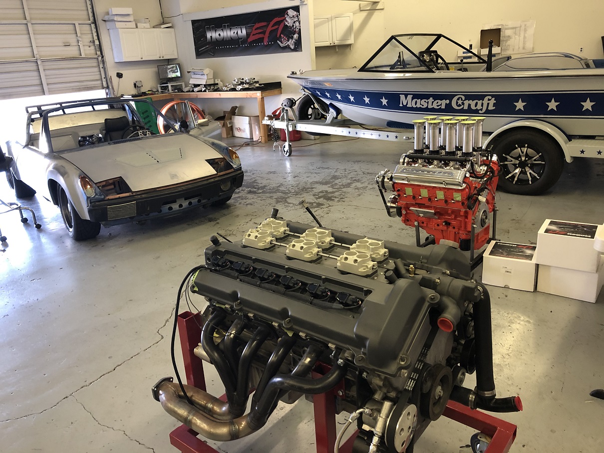

After time with the tuner, most stuff has been fixed but he was struggling with a consistent "hanging idle". Something's up where the butterflies don't/won't return to fully closed and it ends up with a 1500+ RPM idle. A blip of the throttle lowers vacuum and the idle settles in where it's supposed to be. So it could be that there's an issue with one or more of the return springs.
The tuner was in touch with the Borla engineer and there's agreement that something may have happened when the ITBs were messed with to remove the return springs.
Anyway, I drove about 10 miles yesterday and this issue makes it "not fun" to drive.
The tuner gave me a couple homework assignments and I'm trying to take care of them today. But I suspect the throttle bodies will be making a trip back to Borla to be inspected/reset.
I don't fault the tuner or Borla. Sometimes we are presented with situations that aren't what we hoped. While I certainly find this frustrating, I'm choosing to view it as a learning experience. I will come out of it with a far better understanding of this tech and my car.
Now, on a totally different note, here's the Pantera I mentioned earlier, along with an Aston Martin V12. What's that partially completed induction system on the V12 you ask? Oh, just a one-off stack system that the tuner designed and had fabricated from scratch.
And there's my ratty little 914, staring longingly at the tech-porn and eye candy it spent a few days with.

Panteras have always had an engine bay for the ages, but that one contains art full stop. Wow. (IMG:style_emoticons/default/wub.gif)
