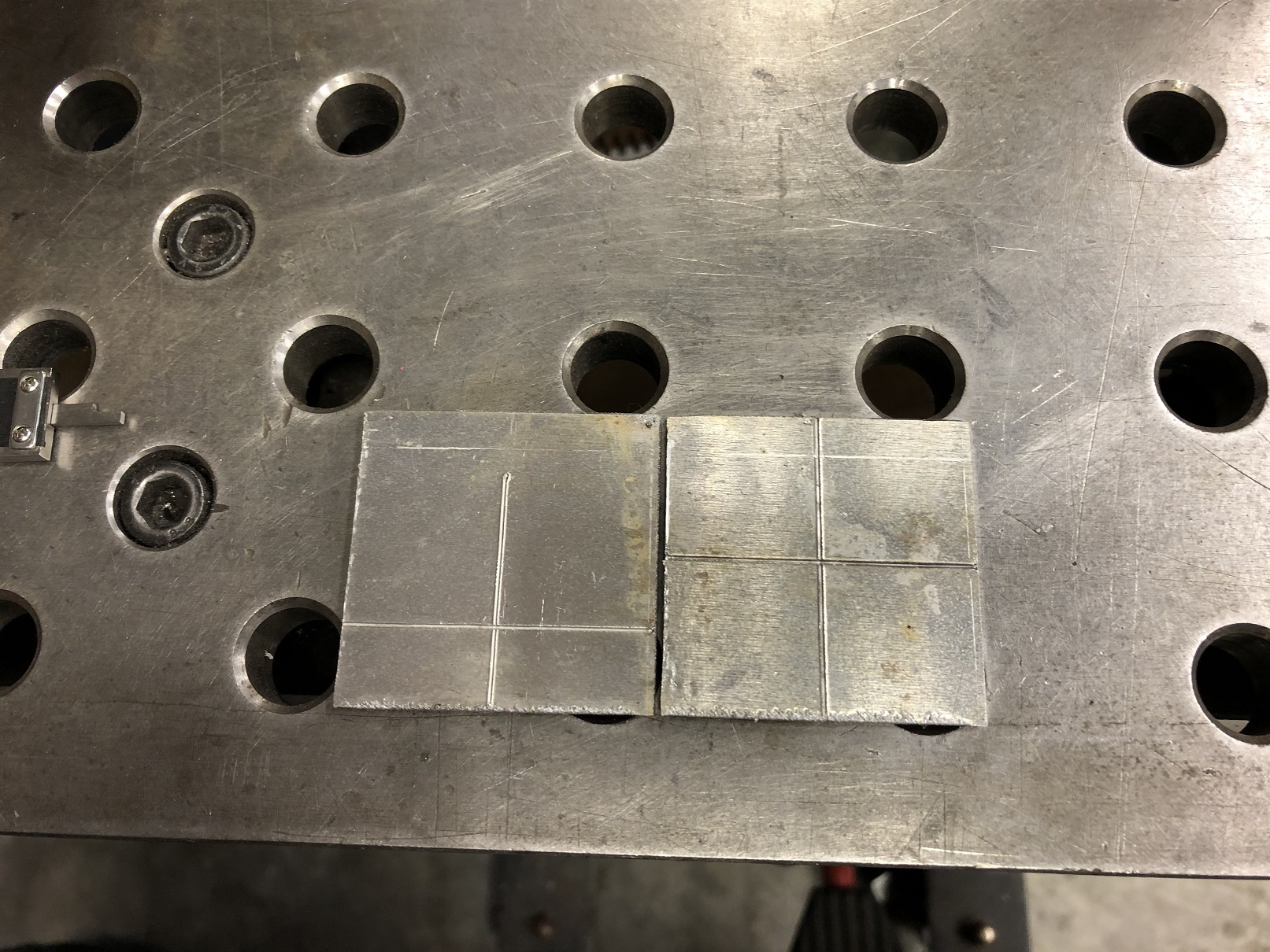

Well, that's better. Here's the before (left) and after (right) of the engraver offset adjustment. Yes, the cross is supposed to be in the middle. I won't go into what led to this (me (IMG:style_emoticons/default/dry.gif) ) but it's all better now.
I'm still getting too much of that punch mark so if I can't eliminate it, I'll have to come up with something else or forego the branding.
That must have been some wasted metal... and hours... (IMG:style_emoticons/default/sad.gif)
Glad to see it resolved!

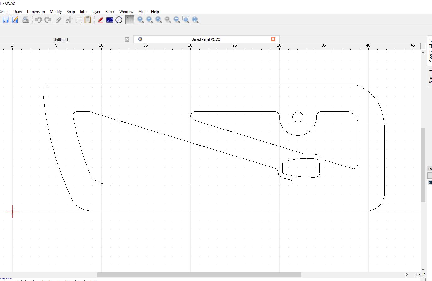

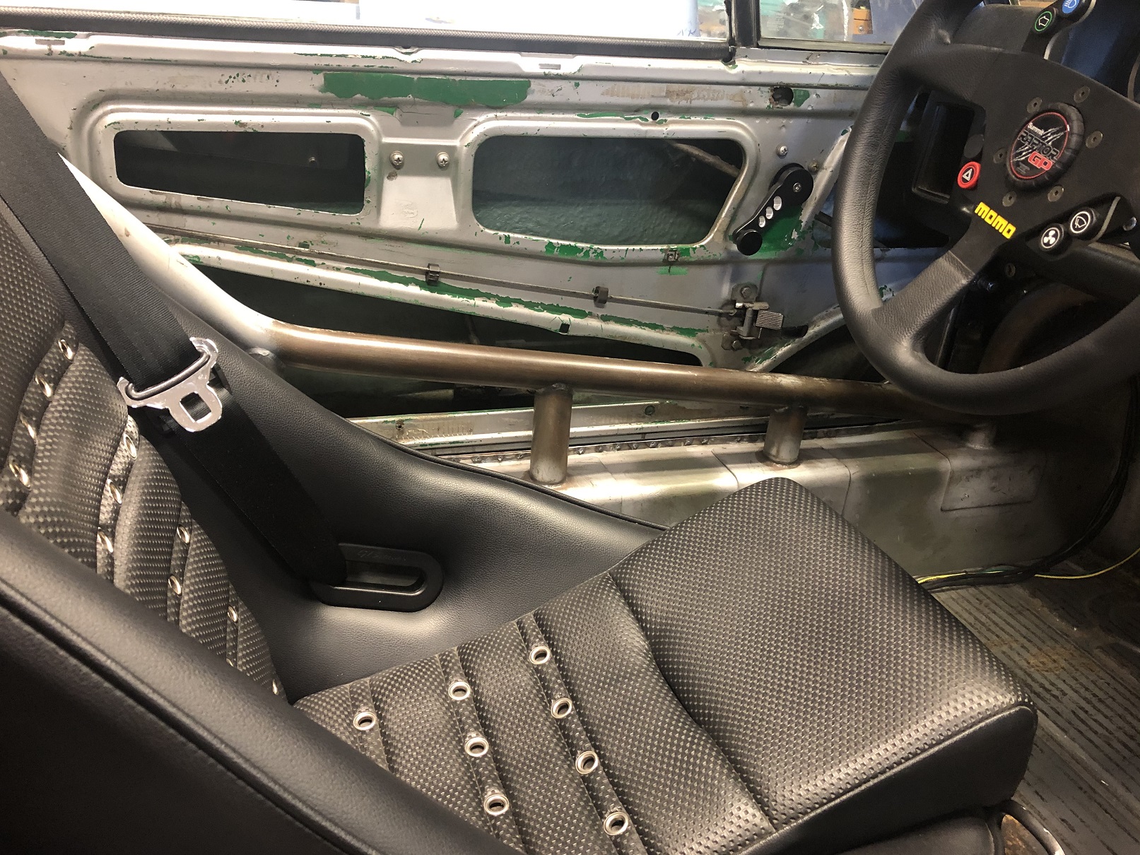

Why do I love 914 World? It's the people! I saw what a great job @jaredmcginness did on his build and was a bit jealous of his SolidWorks door panel. So I PM'd him asking if he'd share or sell me a copy of the file.
In one day, I had his "Sure you can have it" reply and today, at his earliest opportunity, I had the file.
Jared - thanks, thanks, THANKS! I owe you one - probably two! (IMG:style_emoticons/default/pray.gif)
And with the file in hand, I stated playing with designs. I want to stamp a suitable pattern into the panel then upholster it so the pattern stands out, or in, as the case may be.
This isn't what the design will be as I need to work it so it "fits" where my door bars are. I also want to build in a bit of a cubby that'll extend into one of the existing openings in the door frame.
Anyway, it's different work from the vents - and I'm ready for a break from those, for sure!
Again, Jared, you da' man! Thanks again.

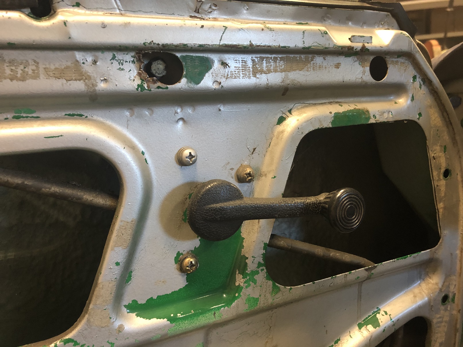

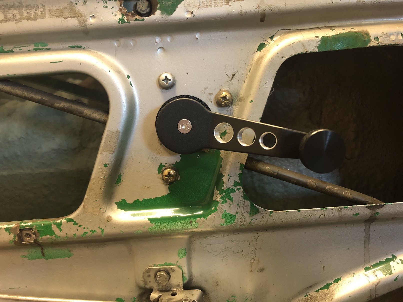

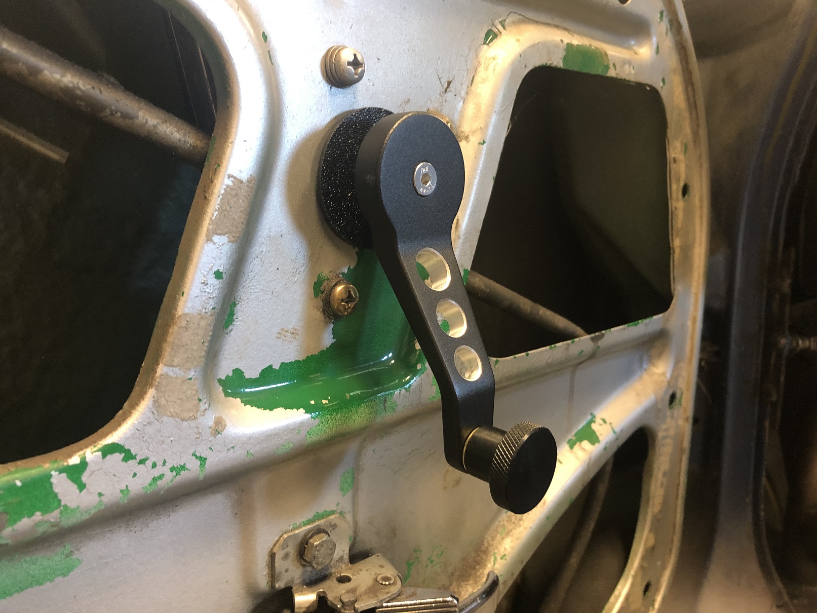

Before: stock window winder
After: GoWesty offset window winders that were treated to some graduated hole lightness, along with a touch of countersink.
And yes, the holes were purposely milled perpendicular to the arm, not the mounting base.
The goal was to try and sorta match the seats' grommet look. Parallel to the base would have left an oval look.
I'm happy with how they turned out. Just imagine how nice they'll look with some zippy door cards!
