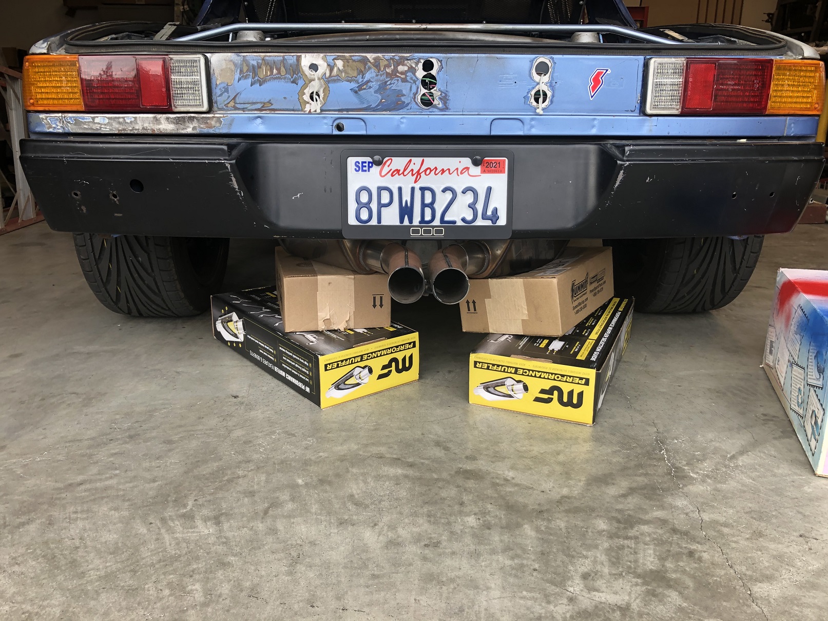

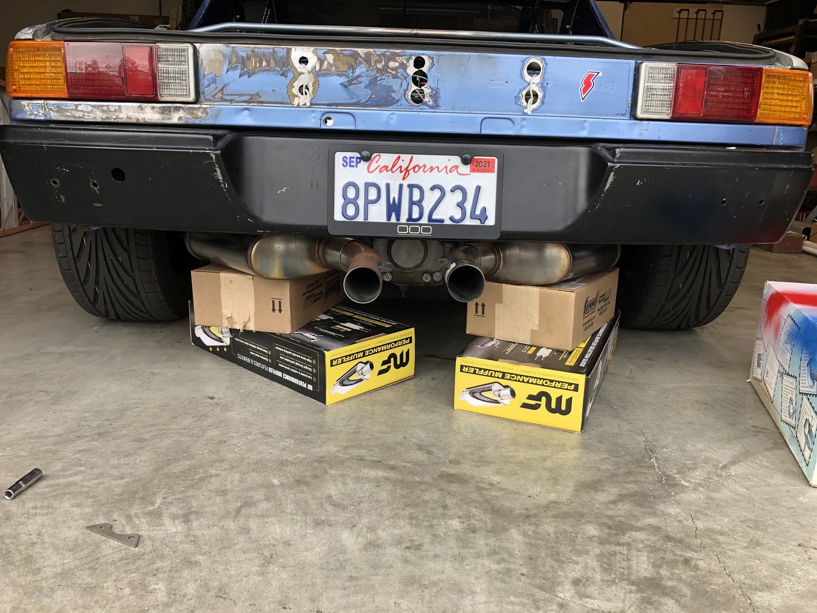

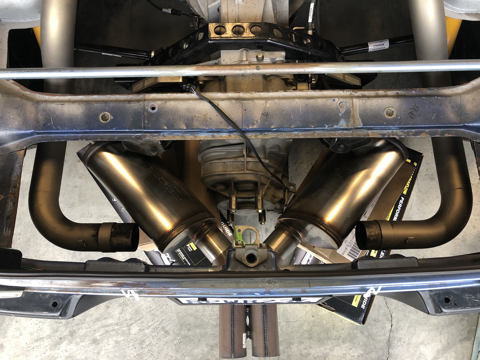

Happy New Year, I hope.
After better understanding the design of the X-pipe muffler I was using, I've decided to redo the exhaust before heading back to the tuner.
I'm still noodling on mounting approach and where I want the exhaust tips to exit.
I'm torn between the close together look, which I really like, vs farther apart where you could get a peek at the the cool looking muffler bracket I'm building.
No, those aren't the actual tips I'd use. Yes, I agree, they are too long. Just mocking up things.
I've also worked up a "through the body" exit that I may attempt. In this version, the mufflers don't hang below the bumper and aren't visible at all. And should I proceed with this idea, I suspect it'll will draw even more "gallery" comments than the hood vents... (IMG:style_emoticons/default/poke.gif)

Very nice. I bet it will be louder now too.

Have always loved it when you can see a bit of the transmission under the rear bumper of a mid-engined car (see 288 GTO for the gold standard), so I am voting for the split pipes. (IMG:style_emoticons/default/aktion035.gif)

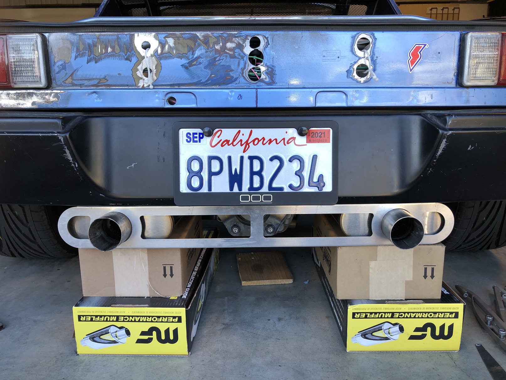

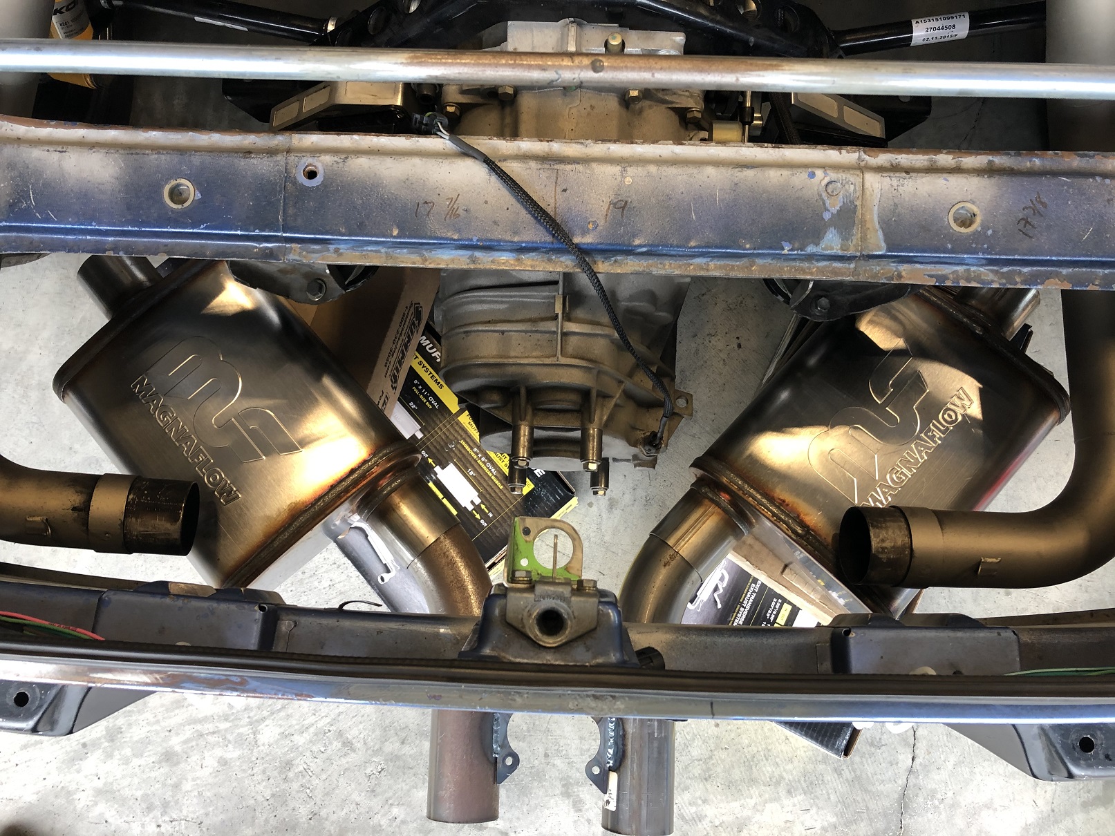

I needed a fixture to help keep the mufflers positioned while I fab the mounting bracket. I figured why not have some fun while I was at it.
I may try and figure out a way to incorporate this into a rear valance. Add mesh to the openings, etc. We'll see.

Only one that would make a temp holder this way (IMG:style_emoticons/default/smile.gif)
Don't forget the diffuser.

The spacing in this latest pic looks the best!

I agree with @cassmcentee -the spacing on the pipes looks great. (IMG:style_emoticons/default/beerchug.gif)
