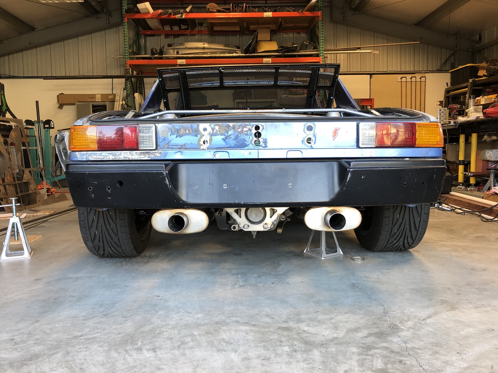

V2 exhaust system essentially done, complete with peek-a-boo of the end of the trans/muffler mount. Hopefully, Pete @horizontally-opposed will approve! (IMG:style_emoticons/default/happy11.gif)
I still have some final welding to complete but it's drive-worthy so tomorrow, I'm back to prepping for the next trip to the tuner.

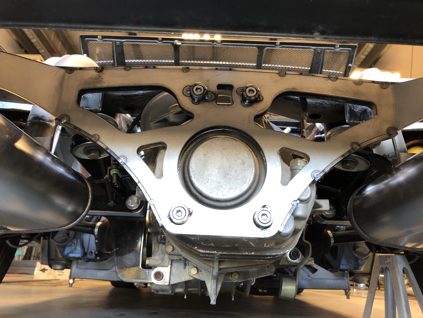

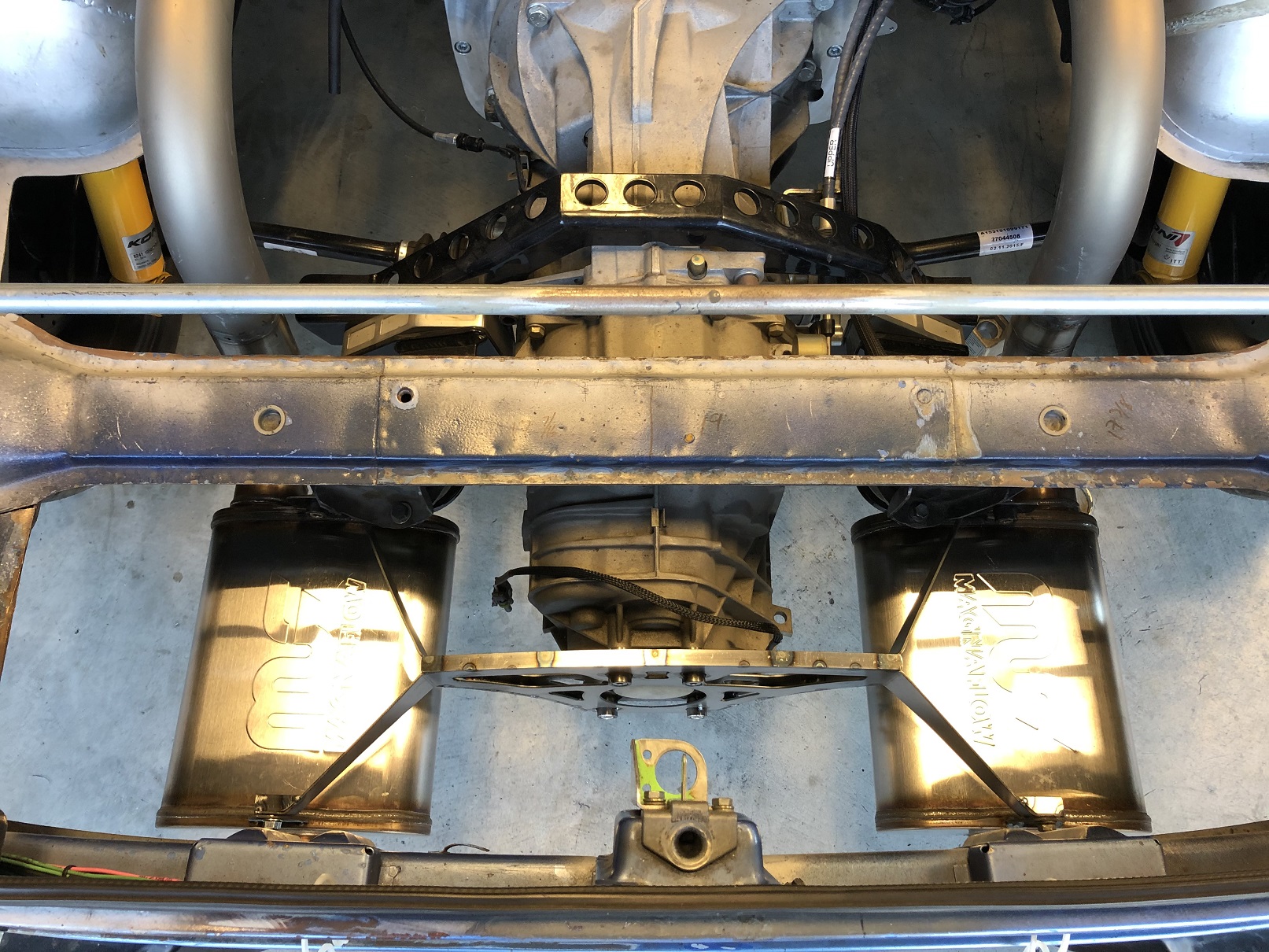

The new version of the muffler mount is more visible, but you sorta have to know to look for it. Yes, I know, there's finish welding to do on this piece.

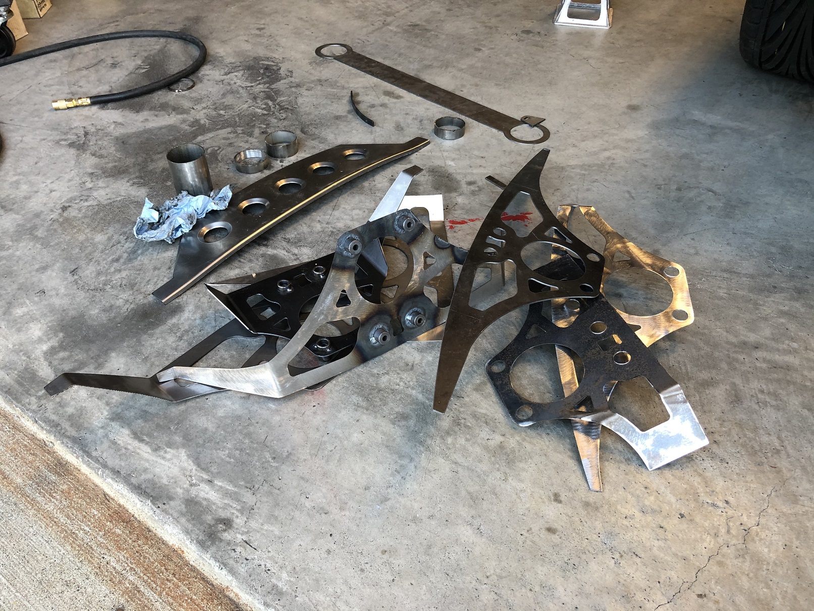

And re: that other pic? Well, it wouldn't be a Tygaboy production with out multiple versions/test pieces...

I really enjoyed meeting you (briefly!) at the WCR in Petaluma, and your build is EPIC! One thing you might consider doing is beefing up your trans mount... see the carnage my Suby-powered engine caused to my chassis beginning on post #444 at Suby-engined rustoration. Your engine surely puts out more than my 302whp...
@strawman - Good meeting you, too! Your build created quite a stir. Everyone was talking about how fast that thing is...
And yes, I've been noodling on that same cross-brace mod you did. Seeing the carnage on yours, I'm thinking I should get after that update sooner rather than later. Thanks for the poke!

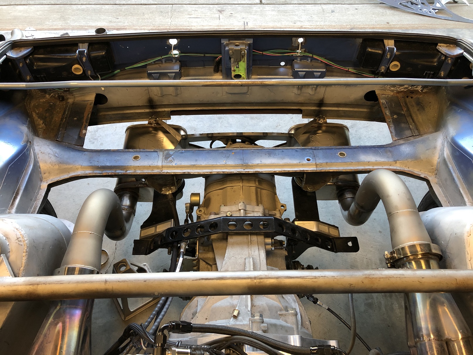

So no crossover anymore? Is there a performance advantage?
Also you mentioned a while back using a manifold and a center mount TB. Can you elaborate more about that?

@djway - So the muffler I was using is actually designed to have both inputs on the same end, the outlets on the other, not one of each, as I'd installed it. Watch the video - that I should have watched before doing all that work!
Short version is that the cross over ended up pointing about 50% of the input tubes all but right toward each other. It was surely creating a ton of turbulence that couldn't possibly be helping.
When I fired the new system, there was a HUGE imbalance in the volume of air exiting each side. This was what clued me in to the fact that something on the 2-4-6-8 side wasn't right.
So yes, a BIG improvement! (IMG:style_emoticons/default/laugh.gif)
