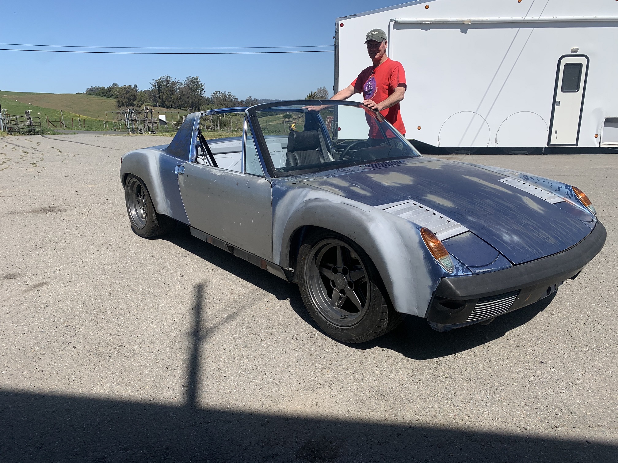

We went for our longest drive yet yesterday. Cooling system is all dialed in and performing as expected. Runs like a champ. Next, I need to sort the front suspension. I think it needs lighter torsion bars. I have 21s in there now, going to 19.
Here's very brief clip of our arrival at a friend's shop. Volume up!

But don't we make a handsome couple? (IMG:style_emoticons/default/laugh.gif)

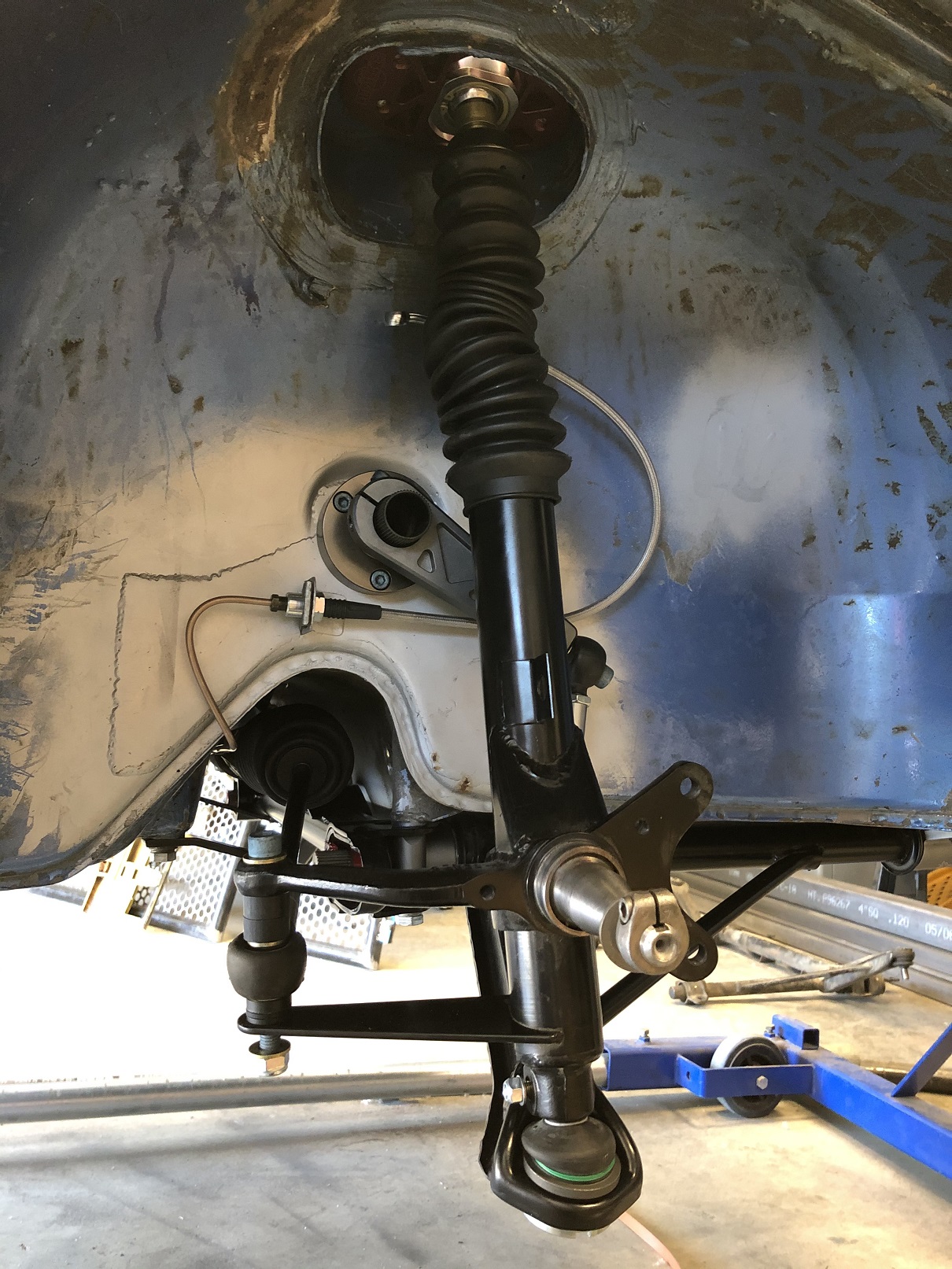

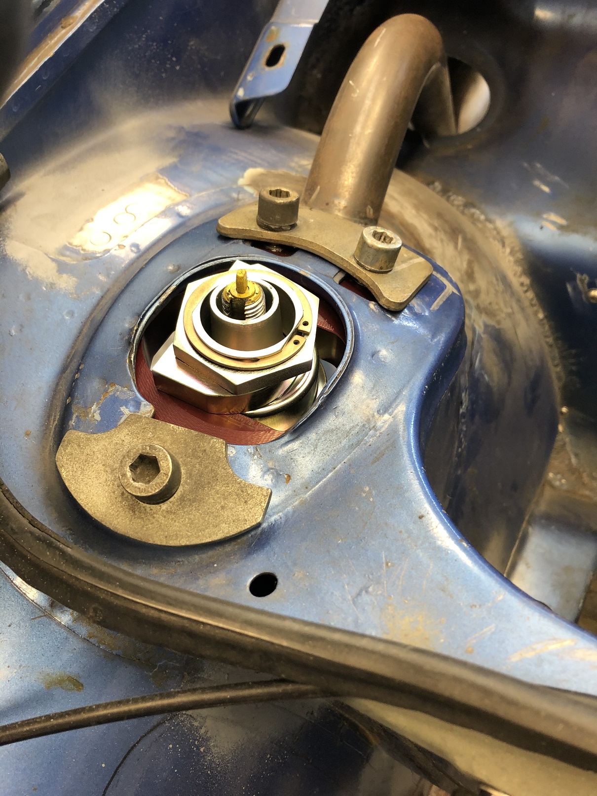

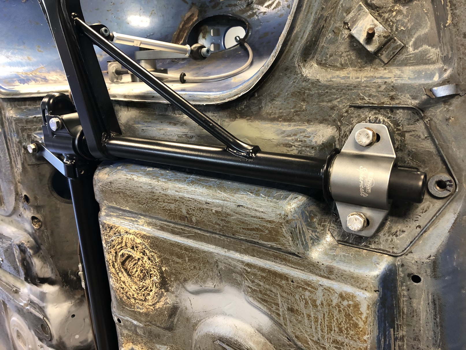

@Andyrew @strawman My front set up:
- 20 mm raised spindles
- Elephant bump steer kit
- Elephant spherical bushing
- Elephant quick adjust camber plates
- Elephant bladed sway bar with the medium stiff blade (it's the lighter of the two options)
- Lemforder Turbo tie rod kit (but with the Elephant bump steer tie rod ends)
The bump steer was set/checked as part of the alignment process at Roger Kraus Racing.
One issue that's not evident in the attached pics (taken before the alignment and final assembly so yes, there are loose or missing fasteners) is that, on my chassis, the fancy-schmancy camber plates interfere with the chassis before the strut can be tipped back far enough to get the caster in spec. Hence the .2 degrees under minimum.
I got a set of Tarrett monoball camber plates that I'm planning to swap in as the are physically smaller at the point they pass through the chassis and will allow me to get more caster. I'll also swap in the 19mm torsion bars.
I'll give Andrew's sway bar disconnect a try but that seems counter-intuitive, give how adding a sway bar to these cars is one of the the mods that gets great results. I know, I have a giant V8 and heavy trans, but still.
Thanks for your input and any other suggestions or observations!
