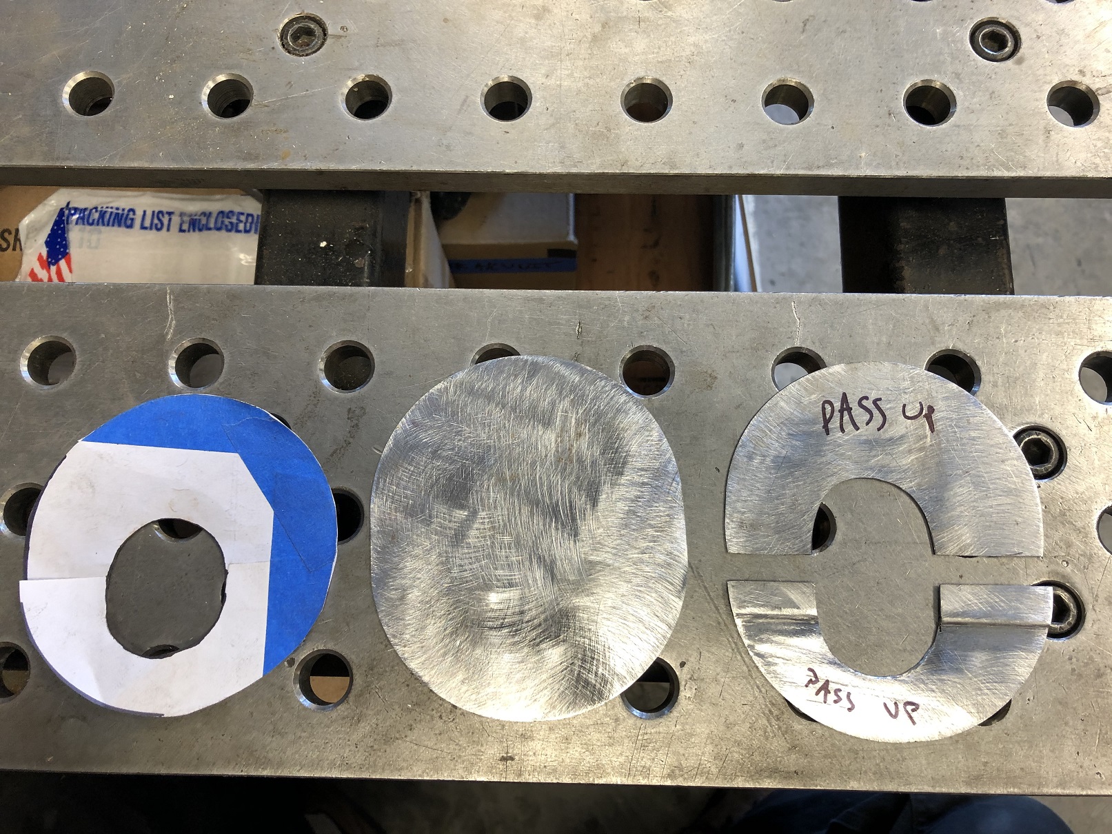

Speaking of little things that need completing, I have to close up these gaps around the front chassis bars where they pass though the heater hose holes.
What to do? (IMG:style_emoticons/default/idea.gif)
Dion
post Apr 23 2021, 05:42 PM
Post #3510
RN
Posts: 2,931
Joined: 16-September 04
From: Shepherdstown, WV
Member No.: 2,766
Vid was fun! Keep it going! (IMG:style_emoticons/default/lol-2.gif)
tygaboy
post Apr 23 2021, 05:57 PM
Post #3511
Posts: 5,852
Joined: 6-October 15
From: Petaluma, CA
Member No.: 19,241

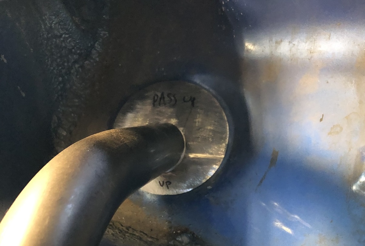

Step 1: Make a paper template to determine needed shape and hole location. Note that the bar passes through the hole at an angle so the hole needs to be an ellipse, not a circle.
Step 2: cut a metal blank. But remember, it has to be 2 pieces so draw up two circles with a 1/2" tangent linking them.
Step 3": Cut the blank essentially in half, stamp a step in one of the sides (using up that 1/2" mentioned in Step 2) so it overlaps the other side and helps to seal it up.

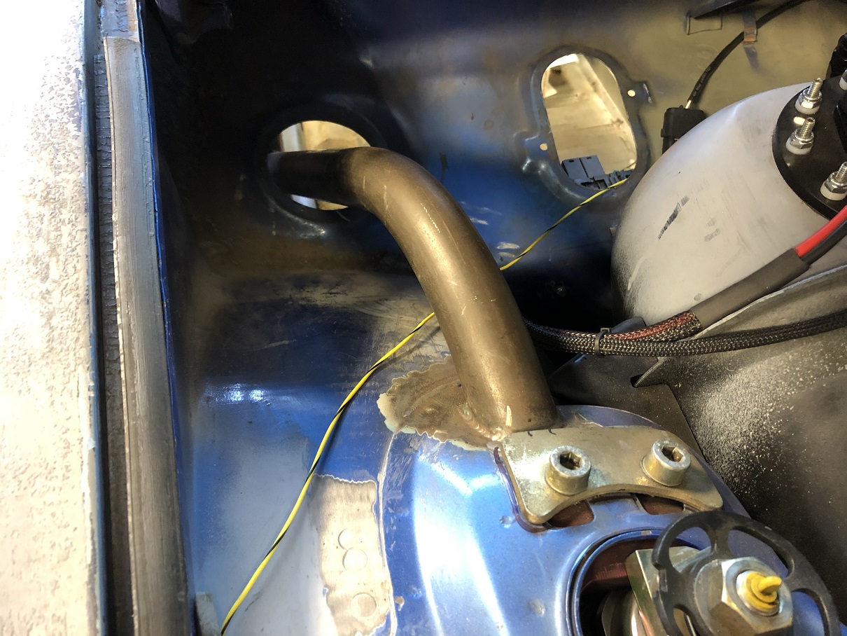

tygaboy
post Apr 23 2021, 06:06 PM
Post #3512
Posts: 5,852
From: Petaluma, CA
Member No.: 19,241
Clearance as needed and... done!
Turned out pretty well. Now on to the other side.
