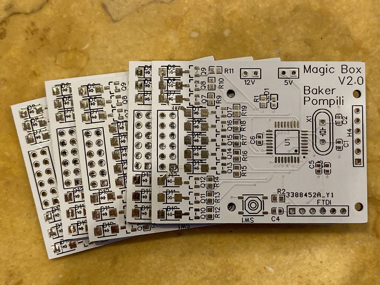

I'm filing this under the "not that you'll care" category. But then, some of you may enjoy the sillier things I'm doing on this build.
This time, it's the one-off PCB board designed by Nicco, the young man / programmer in that wireless demo video.
The MagicBox 2.0 (IMG:style_emoticons/default/laugh.gif) will package all the electronics and circuitry needed for "single button control" each of the headlights (as in the video) wipers and heater blower motor from my wireless steering wheel panel. Plus, there's room for other stuff, should I think of anything. This will be enclosed in a nice little box and it replaces that giant wiring mess seen in the video. Also planned is the replacement for the standard auto relays using a tidy Bussmann relay board and micro relays.
Note there are extra boards... Who wants to join me? (IMG:style_emoticons/default/happy11.gif)

Anything that makes our cars electrical systems more reliable, less bulky and simplifies things is a win in my book. (IMG:style_emoticons/default/beerchug.gif)

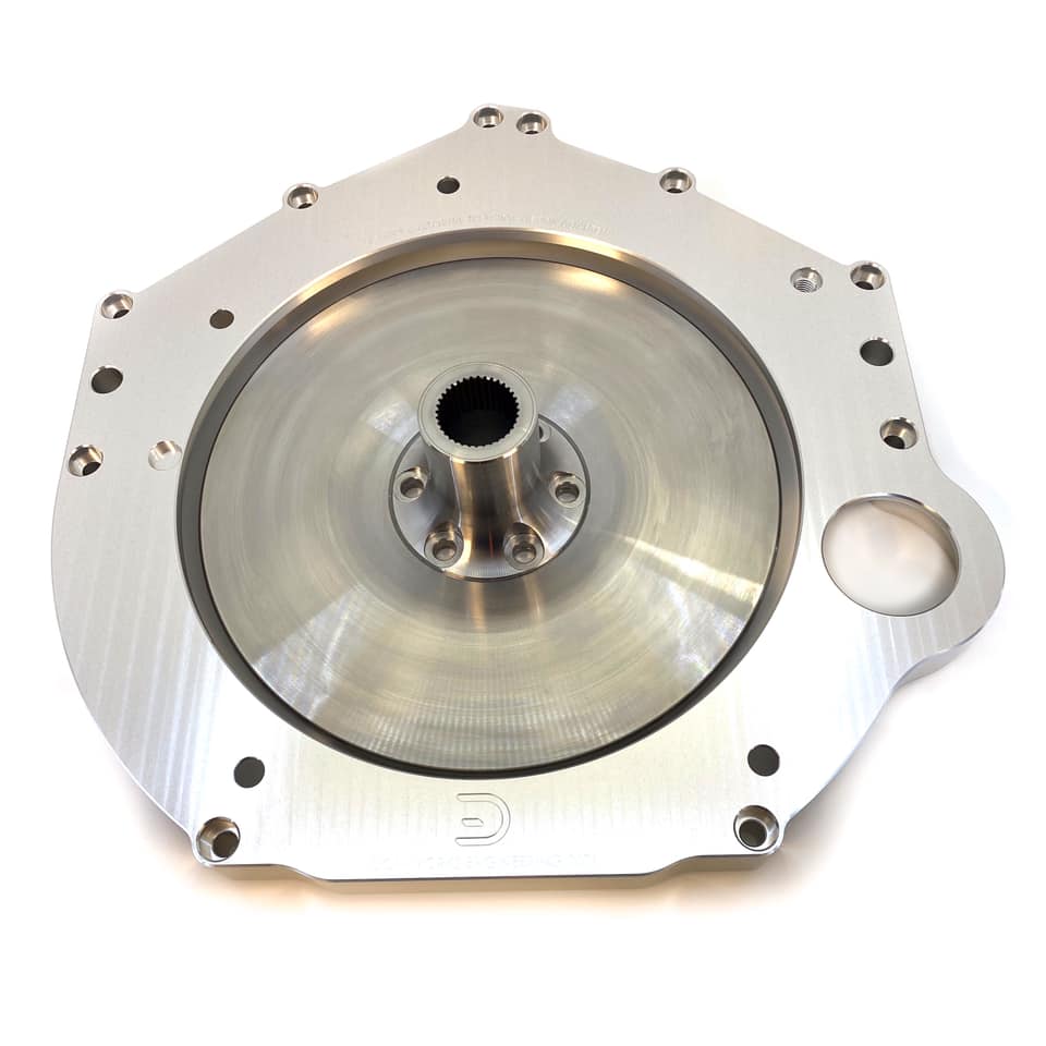

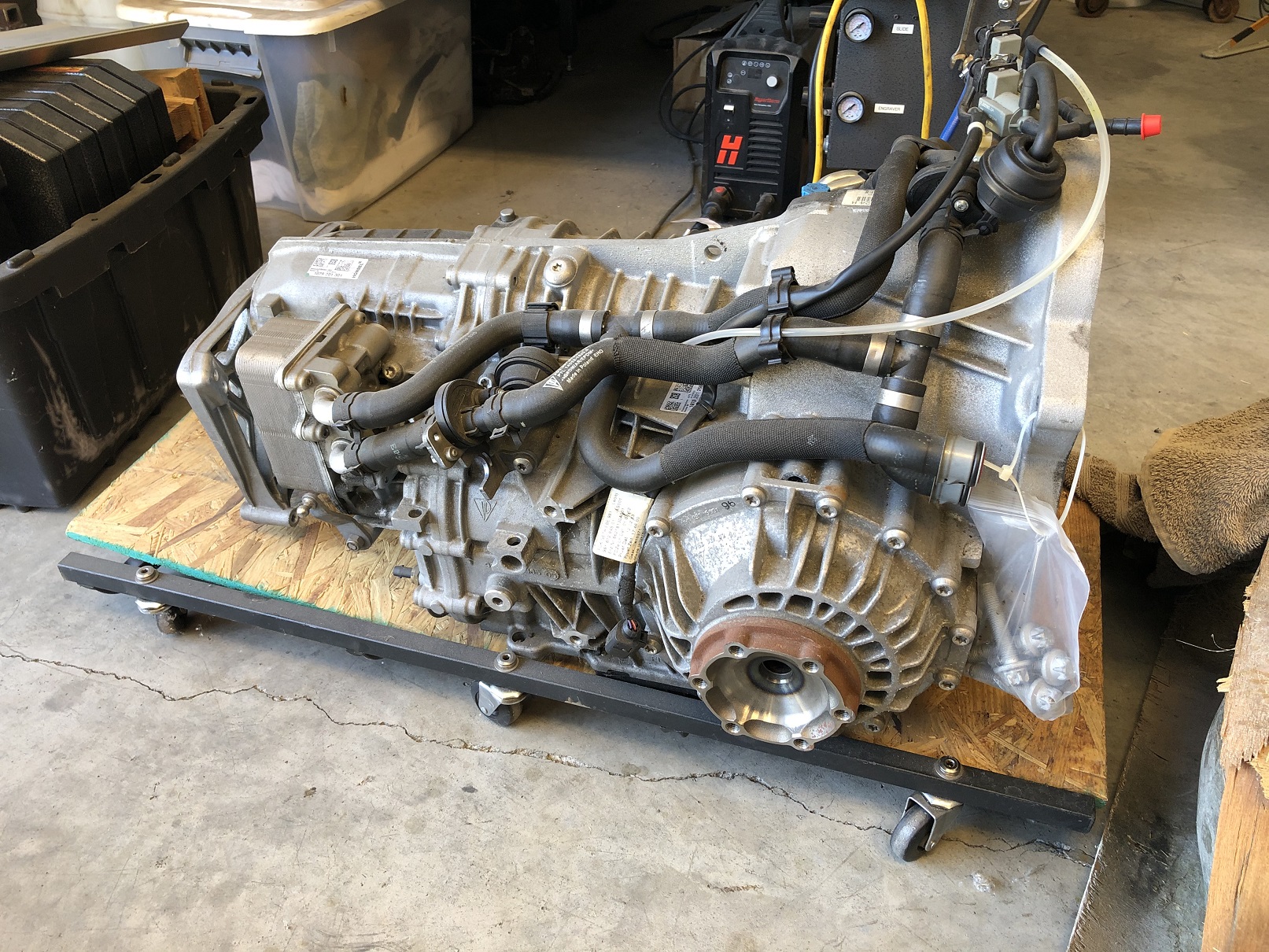

Now let's stir things up a bit, shall we? I wonder what the 914 Design Committee will think of this... (IMG:style_emoticons/default/happy11.gif)
Here's a Cayman PDK. It's sitting in my shop. Other pic is the PDK-to-LS3 adapter.
My tuner is working on a conversion "kit" that will enable my 8-stack induction to be converted to drive-by-wire. This means the PDK/LS contraption will do all that fancy stuff like auto-blip downshifts, etc.
What could possibly go wrong?
While it's true I've already purchased the PDK, I haven't fully committed to doing this.
More to come as I think it through.

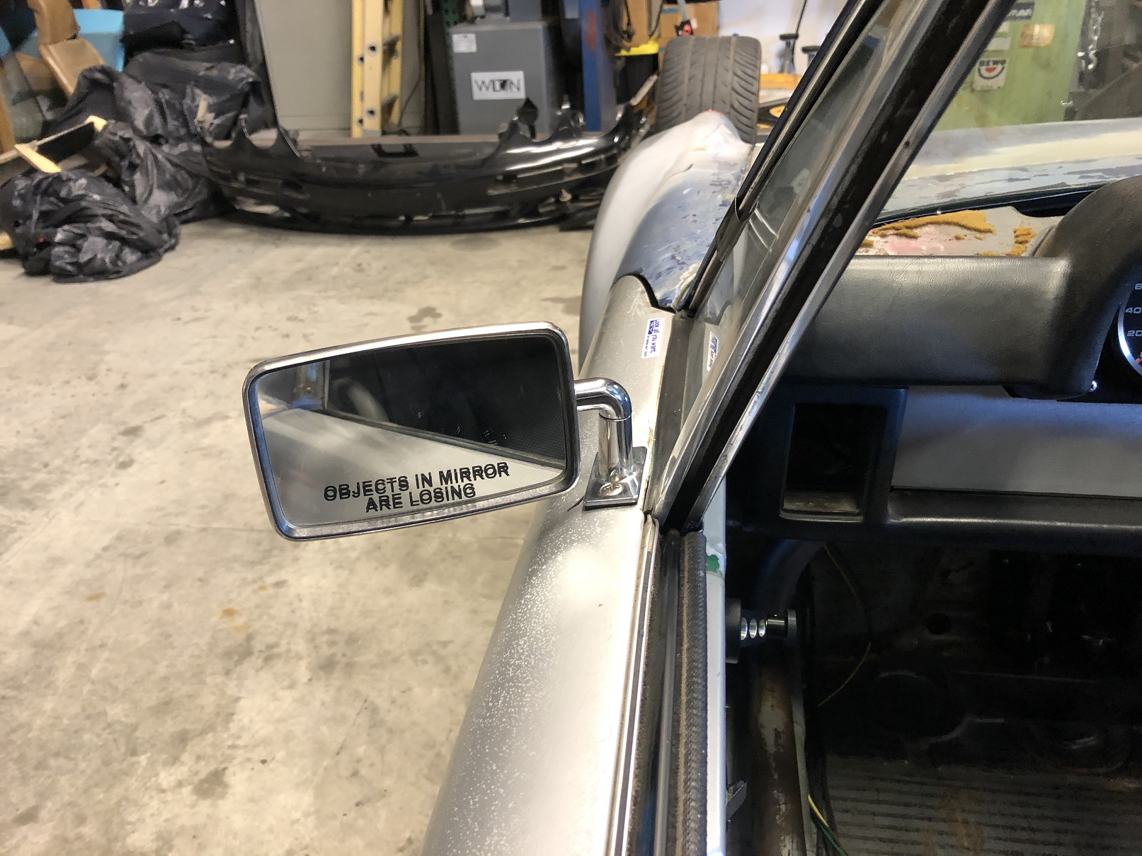

One thing I forgot to mention is that as I was driving home from S-Car-Go, I noticed they had added a sticker to my mirror.
They did test drive it and, apparently, agree it goes pretty good!
Pete @horizontally-opposed - Thanks for recommending this shop. Top quality work and a sense of humor - what more could you want? (IMG:style_emoticons/default/smilie_pokal.gif)

(IMG:style_emoticons/default/av-943.gif) I love it!

LOL, I love it. Obviously added after a run down their "test track." Not that I have ever partaken. (IMG:style_emoticons/default/bye1.gif)
Glad you had a great experience there. They've built some seriously good hot rods over the years, and understand street car suspension as few shops I've come across do.
