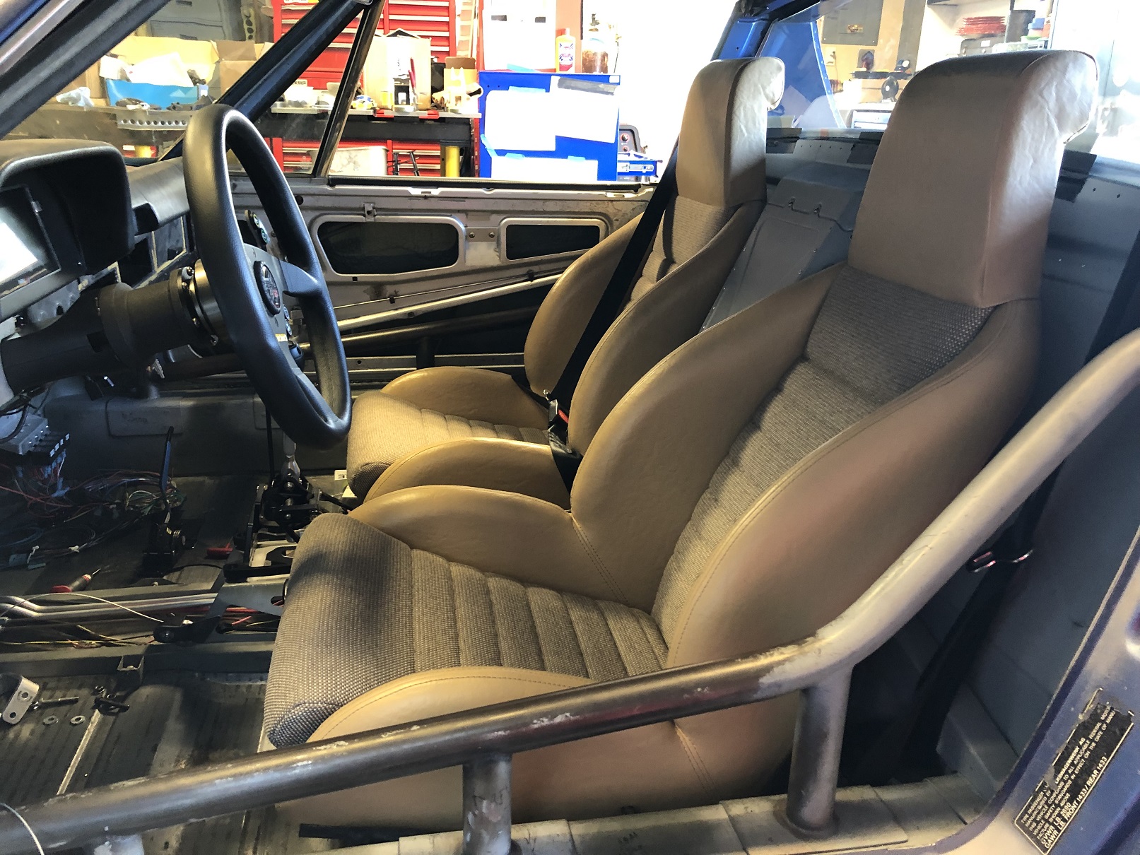

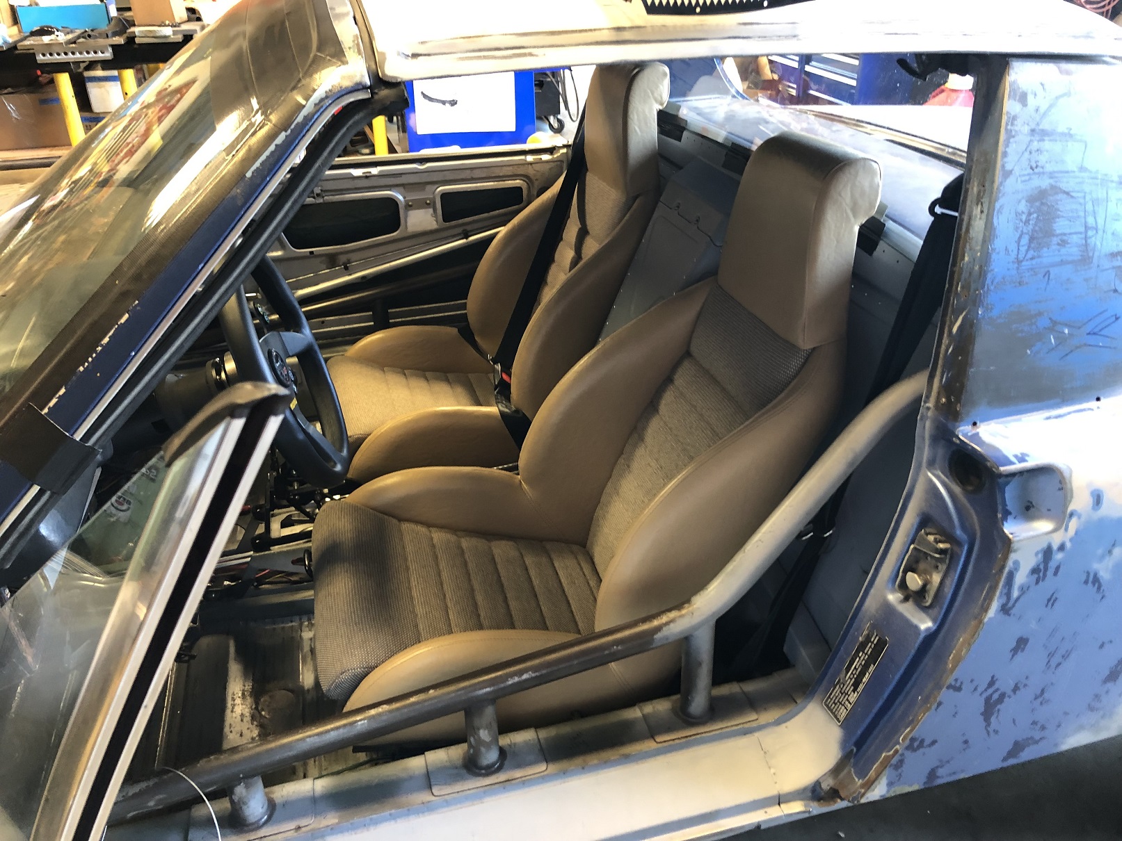

HUGE thanks to Bob @BIGKAT_83 for personally driving these seats from GA to CA! Bob, it was great meeting you and your wife. Oh, and your pup, Henry, too!
These are the seats I purchased from @fasthonda . They are super nice and more supportive in the upper bolster area than the GT Classics LeMans seats I have. But now that I've seen then in my car, I'm not quite sure if I'm digging the look, compared to the LeMans', so the jury is still out on if I'll keep them.
If I do keep them, I'll likely have them redone in black with appropriately colored tartan inserts. I'm leaning toward the GTI tartan pictured.
But again, I can't thank Bob enough for making this happen. It's always great to meet another 914 World member in person, put face to name and shake hands with a new friend.
Krieger
post Jul 19 2021, 10:30 PM
Post #3624
Posts: 4,879
Joined: 24-May 04
From: Santa Rosa CA
Member No.: 2,104
I like the look of those seats. What makes them look odd is the padding on the aft section of the headrest. The GTI upholstery looks good too. Especially if you go blue on the exterior.

I like the Le Mans seats more. Maybe, its the little medallion vents, (I don't know what they are called) that look classy. I'm leaning to getting the Recaros that were used on the Big Laguna car. I sat in them and was very pleased. I'm curious why are you even wanting to make a change from the Le Mans seats? Were they that bad?
tygaboy
post Jul 20 2021, 06:02 PM
Post #3629
Posts: 5,852
Joined: 6-October 15
From: Petaluma, CA
Member No.: 19,241
QUOTE(Curbandgutter @ Jul 20 2021, 09:50 AM) *
@Curbandgutter Rudy - The LeMans seat are REALLY comfortable for 90% of the driving I expect to do. But they do seem a little "loose" on me in the upper body area when the cornering gets spirited.
I wanted to try something else so I bought the Renegades, figuring I could always sell them if I opted to stay with the LeMans. The jury is still out so no decisions until I've got some miles on them.
I will also say you sit noticeably higher in the Renegades vs the LeMans. I may start with having maybe 1/2 the padding taken out of the bottom cushion. We'll see.

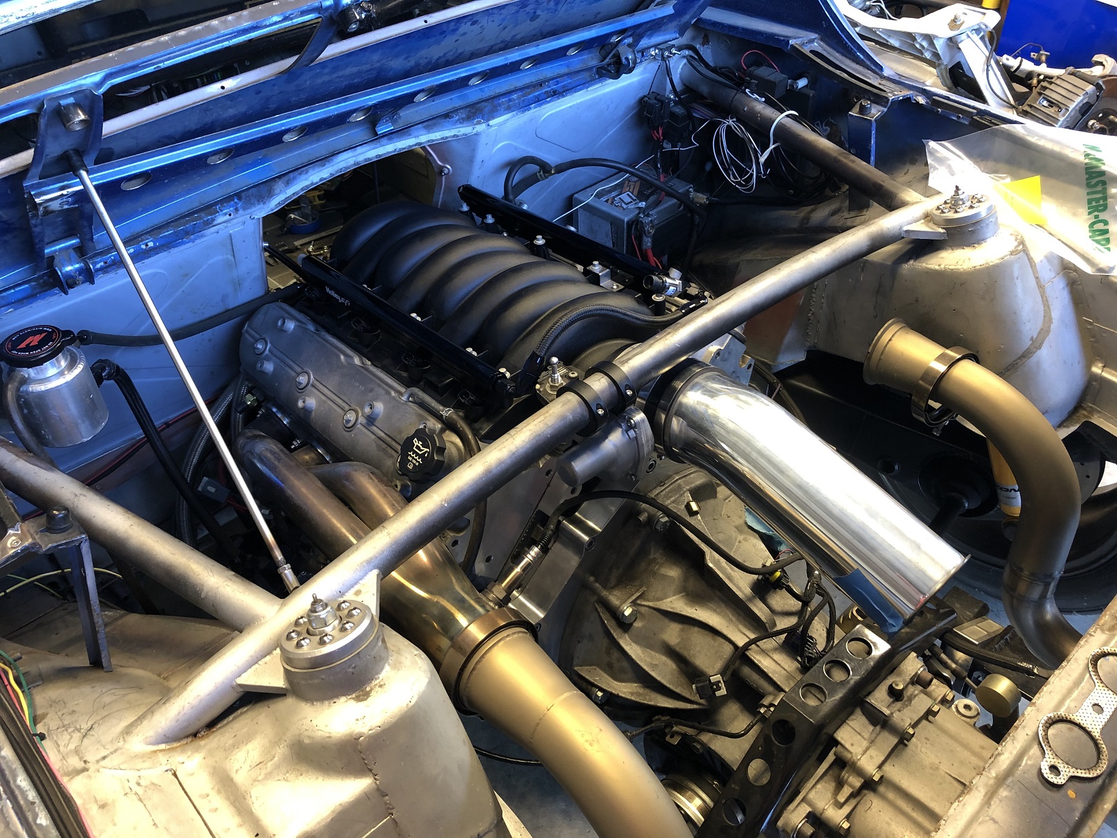

Well. Clearly not as cool looking as ITBs, but not bad.
I did upgrade from the stock fuel rails to the Holley set you (sorta) see here. This to keep the same return-based fuel system plumbing I already have in place.
I have a few additional things in mind to try and recoup at least some style points. Let's see how I do.

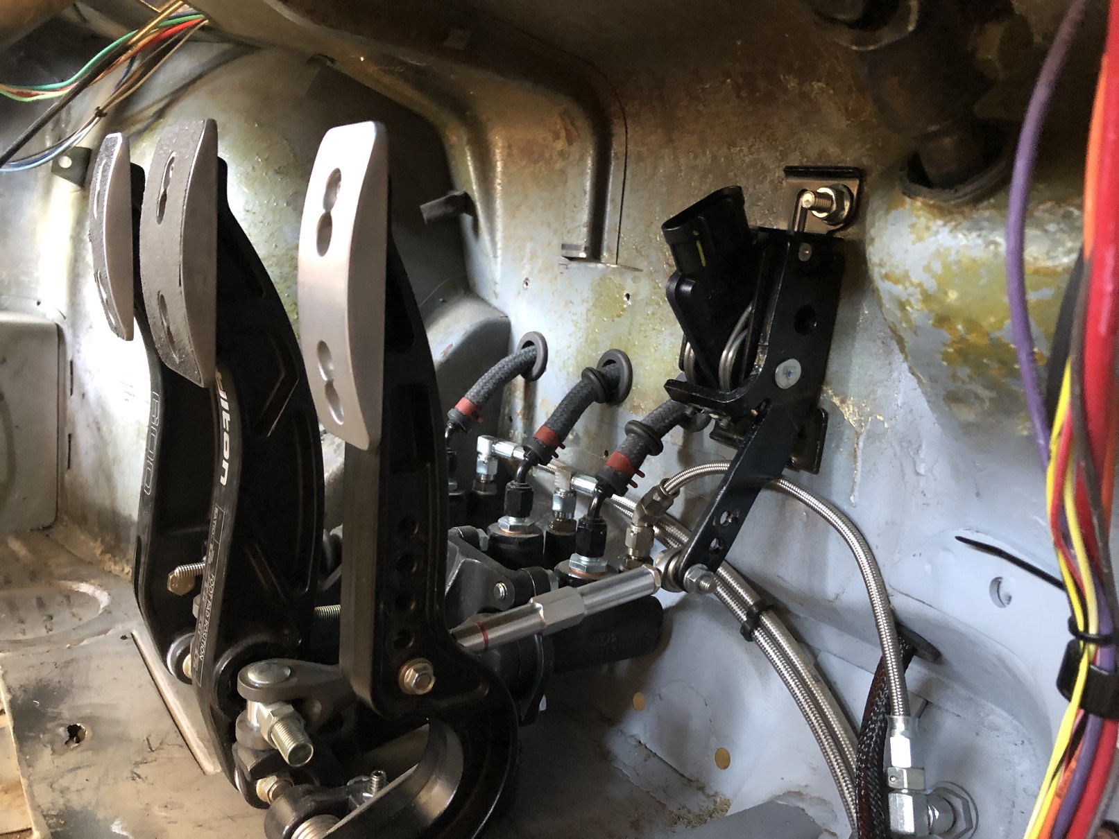

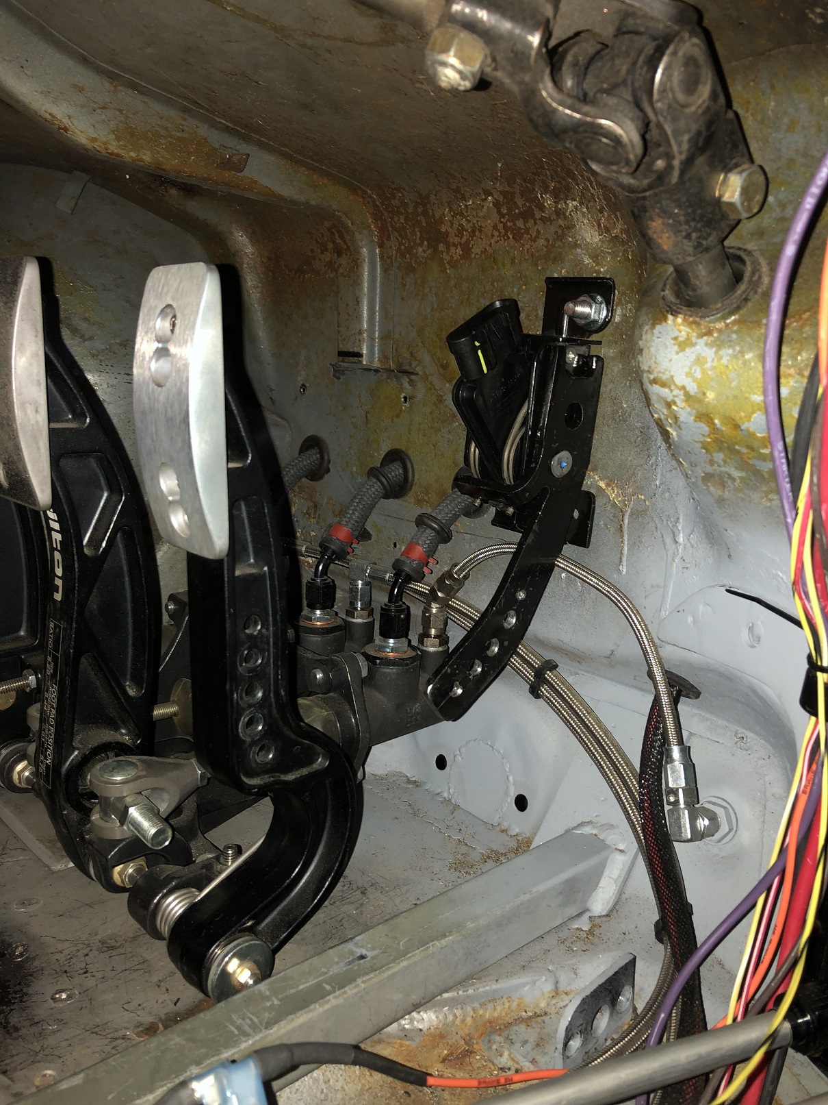

DBW mechanical connections all set. Really happy with how this turned out. There is ZERO slop or flex and the linkage ratio is adjustable over a pretty wide range so beyond being able to program how the throttle body responds to the pedal, I can also tune the physical pedal travel to feel just how I want it.
But maybe the best part is that red indicator toward the left end of the custom linkage bar. It's a shallow groove which was then colored red. Why? It's a visual reminder that it's the left-hand thread end. No more guessing which way to turn the jam nuts when adjustments are needed.
It's the little things... (IMG:style_emoticons/default/aktion035.gif)
Mueller
post Jul 24 2021, 03:15 PM
Post #3636
914 Freak!
Posts: 17,155
Joined: 4-January 03
From: Antioch, CA
Member No.: 87
Those pedals look so cool and high tech. Bummer about the ITB's but in the end you do want to drive the car and not be on pins and needles and worrying about the throttle input.
