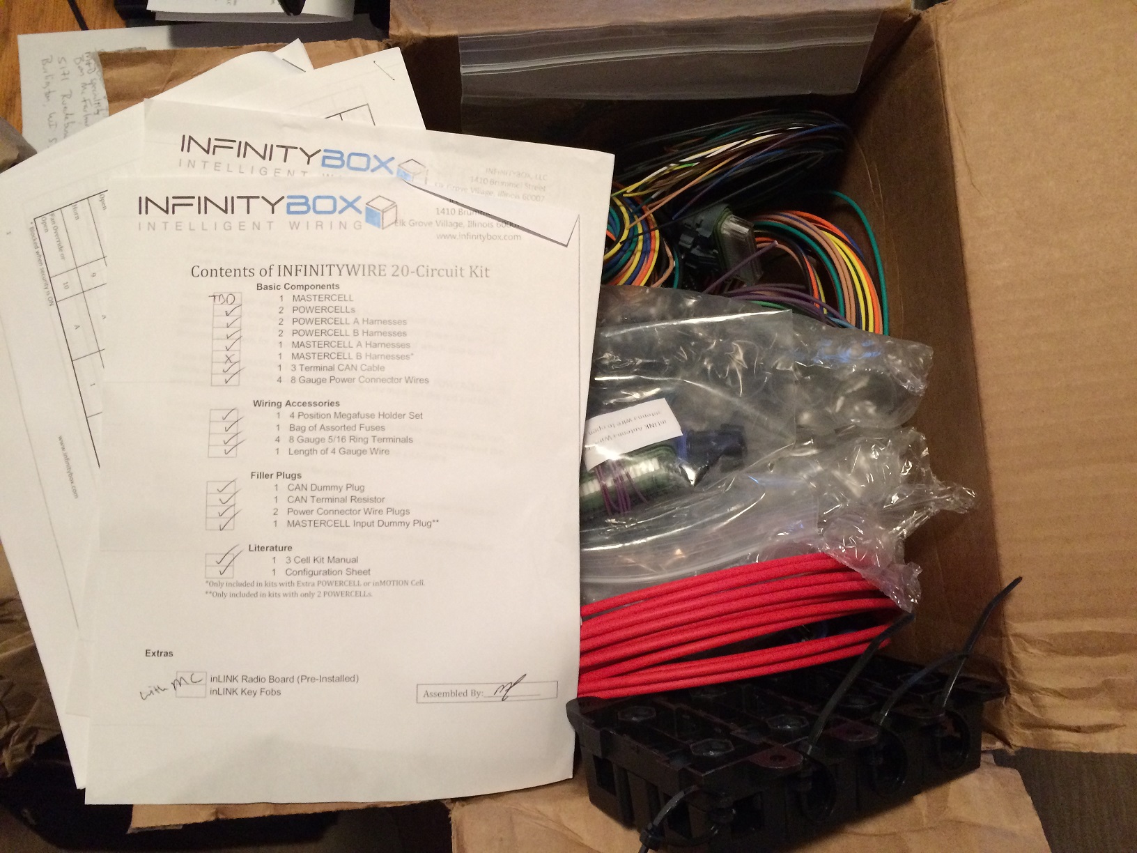

3 months and no progress. Injury and other priorities... Enough of that! I'm back!
Here we go... I know that for some of you, this wiring stuff is nothing. That ain't the case for me.
For the most part, I've avoided thinking about this part of the build. Specifically because I have virtually no skills/experience with wiring. So, it's a bit intimidating looking at a two medium sized boxes full of the stuff. (IMG:style_emoticons/default/wacko.gif)
For the main harness, I went with the Infinity Box 20 circuit with a couple upgrades. Current Performance supplied the stand-alone LS3 harness (set up for a reversed intake) and DBW throttle pedal.
With the arrival of this stuff, I have almost nothing left to purchase. What will I use for an excuse as to why this project isn't farther along? Oh yea, WCR prep! (IMG:style_emoticons/default/biggrin.gif)

Good Morning,
In the box it looks pretty daunting. Once you lay it out on the floor it will get easier.
This is what we use at RS to put the wires where we want them. They come in both a large and small size.
https://www.amazon.com/iExcell-100Pcs-Black...zip+tie+holders
post Jun 10 2017, 08:08 AM
Post #385
Posts: 13,380
QUOTE(cary @ Jun 10 2017, 06:53 AM) *
Good Morning,
I used the same when I laid out my harness. Laid out a sheet of plywood and put the harness down. It was extremely daunting in my project as I had a full modern day wiring harness to deal with (actually 3 of them)
After figuring out what I needed to I labeled everything and pulled it off or left it on for storage.

Are the wires all labeled ?
post Jun 10 2017, 08:14 AM
Post #387
Posts: 5,818
Cary, Andrew - Thanks for the encouragement...
What time can you be here? (IMG:style_emoticons/default/laugh.gif)
post Jun 10 2017, 08:16 AM
Post #388
Posts: 5,818
QUOTE(cary @ Jun 10 2017, 07:13 AM) *
Looks like it. The Infinity Box box arrived last night and I just opened it. Haven't taken anything out of either box. The instructions look nice and complete.

Nice stuff there, I looked at the Infinity Box products for my other car a few times. Had I only had 1 project car instead of 2 I might have pulled the trigger and bought it. Too bad about their name, they used to be iSiS , which I see they still have on a few products!

Well that looks familiar...the "40" has an iSiS system - still n the box - you will be a pro! (IMG:style_emoticons/default/biggrin.gif)
T
post Jun 10 2017, 09:47 AM
Post #392
Posts: 13,879
(IMG:style_emoticons/default/agree.gif) w/ Andrew. The plywood layout is infinitely adjustable and cheap. But more important is the preservation of ones own sanity. Start with what's easy or apparent. Then move on to the more difficult items. Often you will find that daunting items reveal their secrets, bit by bit, when working on some of the simpler items. Lastly, you will (IMG:style_emoticons/default/headbang.gif) quite often. Get used to it but don't let it defeat you. Sometimes the answers will come at 2:30 AM, sometimes they come from this board or another, but they will come to you if you have the tenacity. When the moment arrives that you power her up for the first time you will be shitting in your shoes and thrilled at the same time. "Onward thru the Fog", Oat Willie.

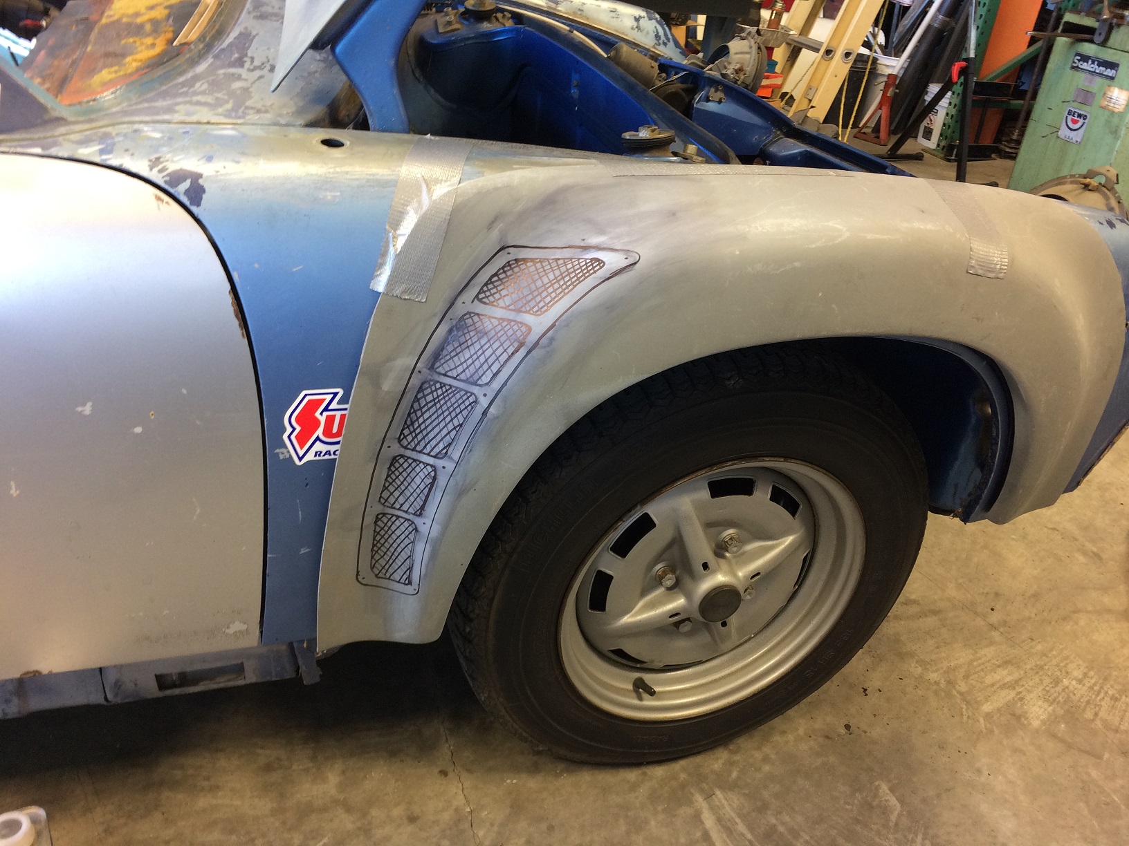

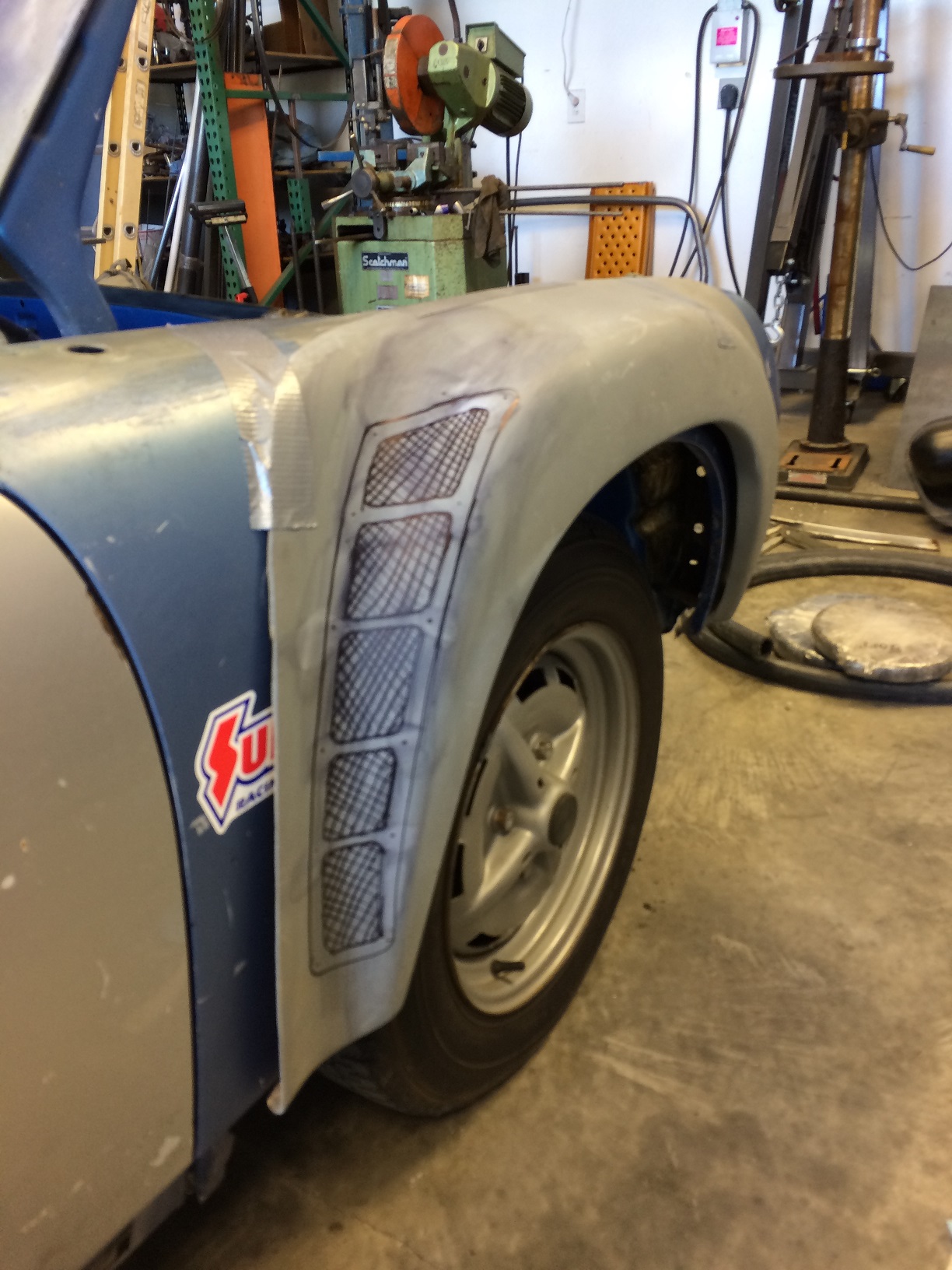

So it's been months since I worked on this project. WCR and yesterday's R Gruppe gathering have me back motivated. Plus, I've gotten (almost) caught up on various other commitments that have kept me from this effort. Anyway... back to it.
First, something totally unnecessary that will only distract, add complexity and additional time to the build... Sounds about right to me!
I've decided to vent the radiator through the fenders and NOT do a vent in the hood (at least for now) and I'd like to do something to help with the removal of hot air from under the fenders.
I just love the fender vents in the GT3 RS so I hung a crap glass flare on the front and started drawing. In the end, this will be added to the steel flares - again, this glass flare was just for idea mock up. I'm thinking an aluminum frame with mesh. Ideally, I'll relieve the opening in the fender so the frame sits flush with the fender.
This was totally free handed (like you can't tell!). I didn't measure anything so yes, the openings are all different heights. That'll get corrected in the final design.

QUOTE(tygaboy @ Jul 2 2017, 03:44 PM) *
Here's some more inspiration for you.

I like what you are doing. At one time I was thinking of adding the GT3 louvers on the tops of the fenders but I am going to evacuate the air through the hood. I know that the guys that run the air through the inner fenders have the gas tank heating up from the hot radiator air.
post Jul 3 2017, 08:27 PM
Post #397
Posts: 13,380
So long as you duct the air from the radiator to the fenders there shouldnt be any reason why the fuel tank will heat up.
I like the idea of fender vents, I think the design needs some work unless your going for the mechanical look on the car. Cant quite think of a better design in my head though.... Maybe taper the bottom some more like the GT3?

Just a personal opinion, but on a 914 I wouldn't want the fancy vents. The stealth factor is what makes a 914 supercar so cool. Venting out the inside fenderwells has been proven to work. Out the top of the lid can make more sense for downforce, but to me, stealthy is cool. Nothing as cool as a monster sleeper.
post Jul 4 2017, 07:20 AM
Post #399
Posts: 5,818
Andrew - Yep, (IMG:style_emoticons/default/agree.gif) the design needs refinement. As is usual for me, I need to see it, change it, try it, change it again. This is V1 so it's destined to be updated. From an overall look/feel, "mechanical" is actually something I'm after so I'm tickled that's how you saw it.
Rand - I am TOTALLY with you on wanting it to be stealthy. But I've always thought that once you add GT flares, 914s lose most, if not all their stealth. I was toying with moving the whole side of the car out 2" to fake a narrow body look and still have some tire to deal with the LS power. That's what I'd really like... maybe in the future.
So for this build, I'm going with a look that will be clearly identifiable as a "hot rod". That also opens up some other design options I'm looking to include.
Keep the cards and letters coming. In agreement with my approach or not, your input helps me clarify my thinking!
