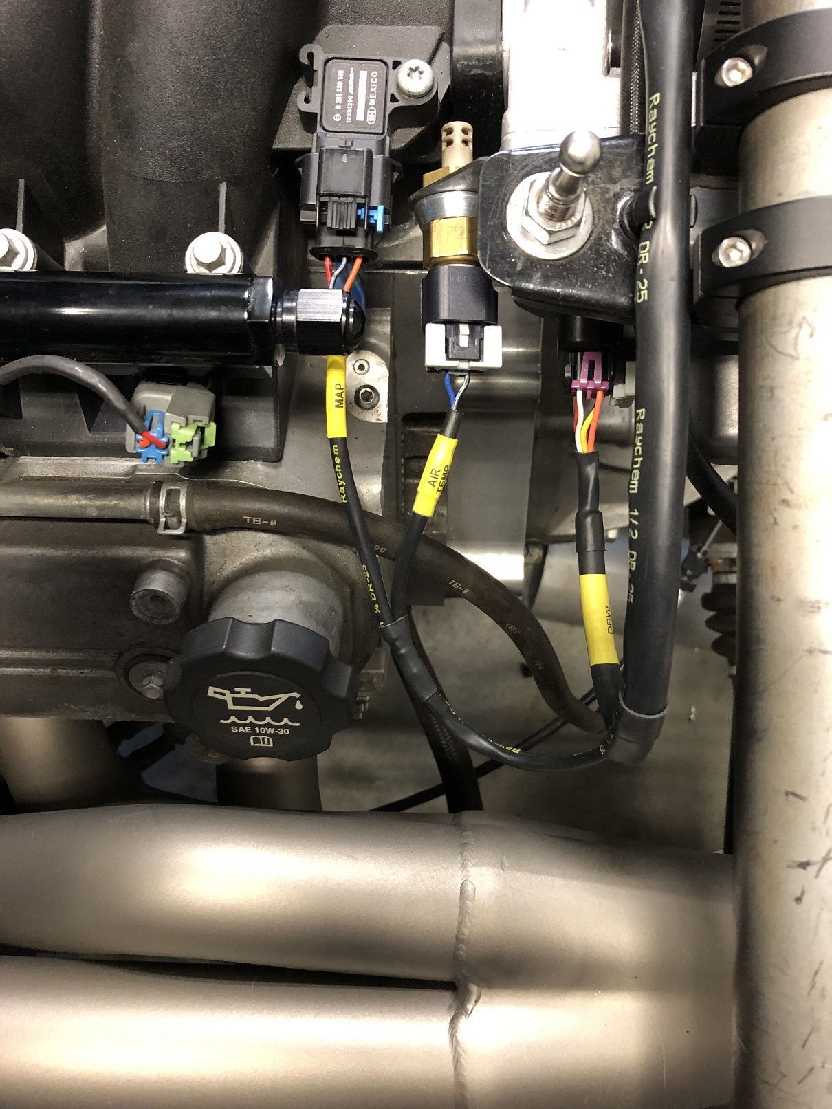

This is the first of the sensor branches to be completed and I couldn't resist a quick test fit to see how it's going to look. One thing to be more aware of next time is to do better at hiding the DR 25 labelling on the underside of the run. I tried but, just like Agent 86, I "missed it by THAT much!" Ah, well.
I'm a bit on the fence about the labeling. It's certainly looks the business and shouts "MotorSport", but it's not like I don't know what plugs in where! (IMG:style_emoticons/default/laugh.gif)
Anyway, with a bit of focused effort, I should be ready to try and fire it in a few days. It'll be good to get this thing back on the road! (IMG:style_emoticons/default/driving.gif)

I don't know about your brand but the stuff I used could be wiped off, but I don't recall which chemical was required at the moment.

I’ve never tried with dr25, but >90% alcohol usually removes printed labeling on rubber. I have done it with bnc coax jacketing which is a similar robustness.

@djway @jd74914 - The printed labels have clear heat shrink over them to prevent any damage.
I didn't think about trying to remove the DR 25 product labeling...

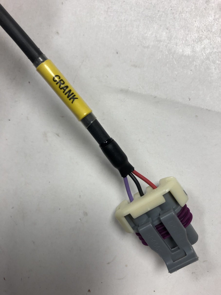

Detailed shot: labeled, clear heat shrink, sealed with SCL. Essentially my best work so far and it'll be completely hidden once installed. What else is new? (IMG:style_emoticons/default/laugh.gif)

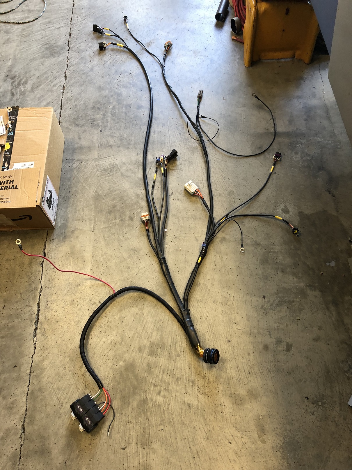

And... that's a wrap! (IMG:style_emoticons/default/laugh.gif)
Well, OK, I still have to do the boot at the connector but I'm going to wait on that until after the car runs - just in case I need to get in there to correct anything. Hey, it was my first attempt at this level of wiring so no, I'm not 100% confident I won't have any problems. Yes, I tested everything. Still...
I realized I've made quite a few changes since I last drove it. Fingers crossed everything comes together and it's a non-event come start time!
- new fuel tank
- updated filler cap
- new fuel filter/pressure regulator
- updated fuel lines to support above
- swapped in the LS3 DBW intake manifold/throttle body
- new ECU
- new engine harness
- replaced the fuse/relay panel with PMU
- updated chassis electrical harness
- custom transmission mount/support structure
- updated exhaust design
- new air box (still TBD)

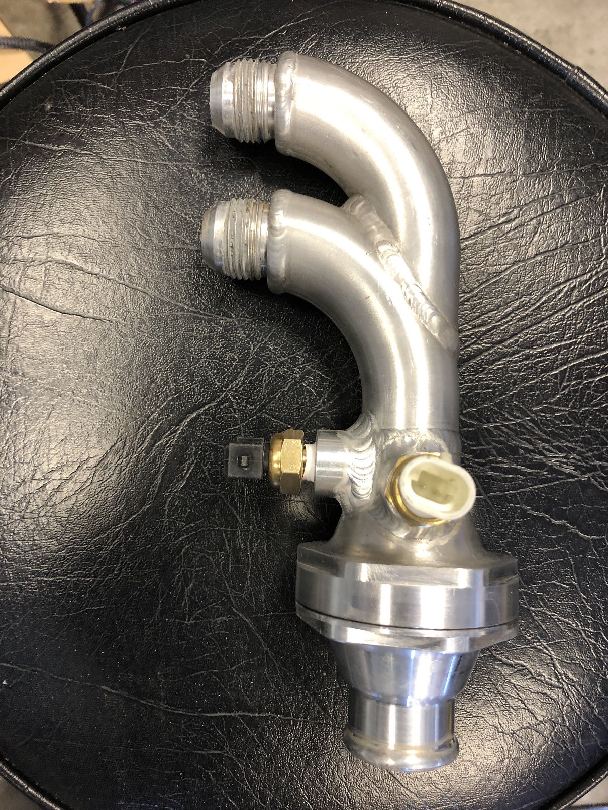

What's this? I added an NPT bung to the H2O collector in prep for swapping in a Davies/Craig water pump. It modulates the pumped volume based on temp from their supposedly proprietary sensor. This should address my "over cooling in cool weather" issue.
I still need the GM sensor to get coolant temp to the ECU which then sends it over the CAN bus to the dash.

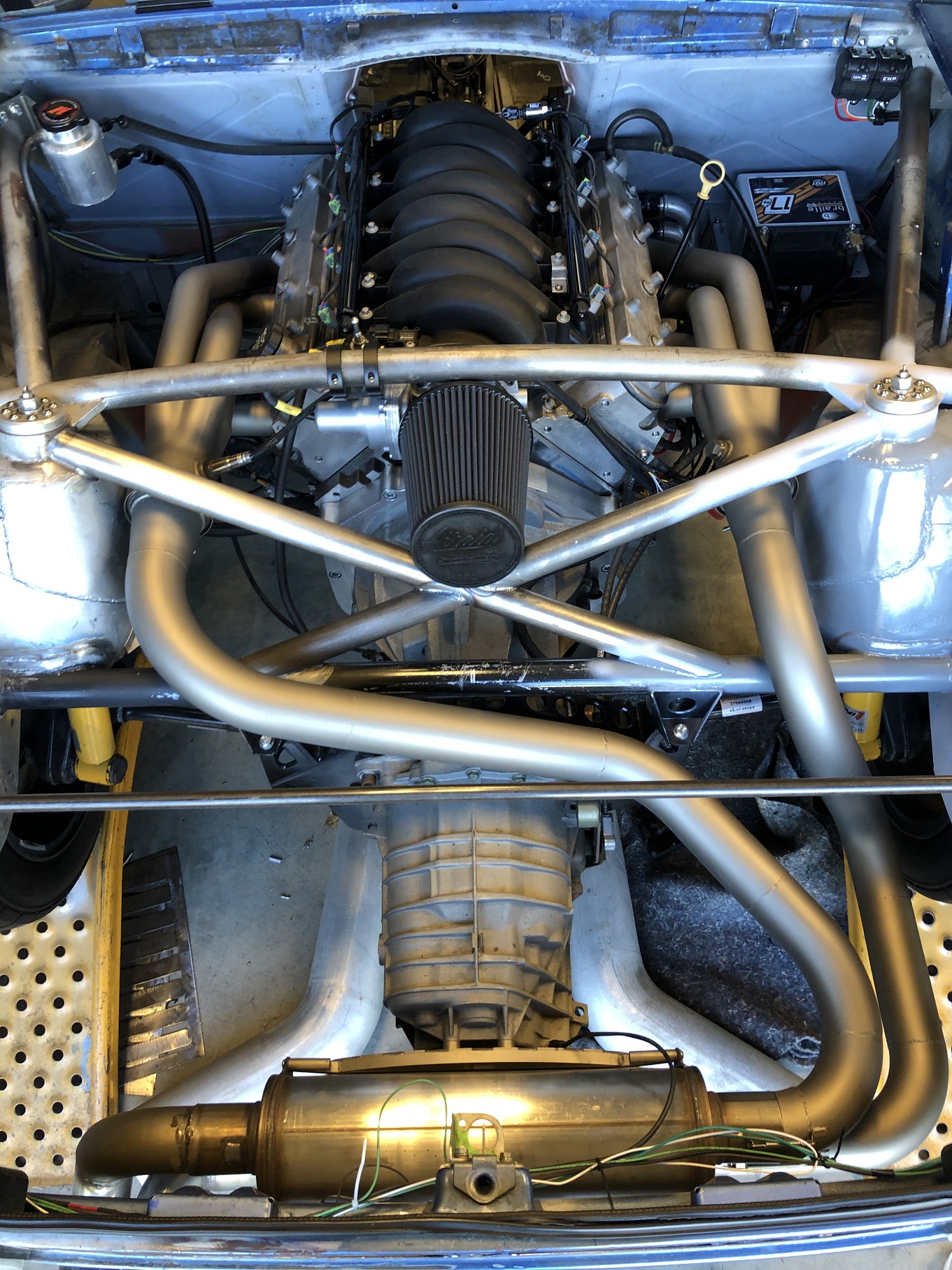

A picture I've taken what seems like a thousand times. I just never get tired of this view!
I really like the way the ceramic coating on the exhaust turned out.
And this version of the engine harness is even more tidy than the last. Note I didn't yet update the injector harness as I really want to get it running again first. Then I'll construct a new one with the labeling, etc.
Anyway, everything is buttoned up and ready for a remote session with the tuner.
We're targeting this Thursday. I made a lot of changes and I'm looking forward to seeing how I did. Wish me luck!

One little issue I see.
The air temp sender is usually located in the air box which is a controlled environment. Where you have it, it is likely to heat soak at lights and run lean or get wet, cool from evaporation, and run rich.
