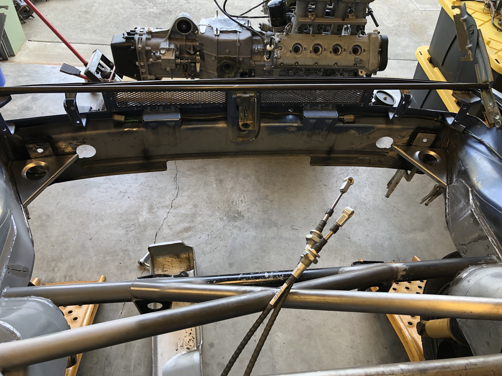

Both rear corner braces fabbed, fitted and ready to install. Maybe kinda looking like 911 engine mounts, as someone pointed out to me.
Gotta say, it's hard to focus on the braces with that drive train sitting there! (IMG:style_emoticons/default/wub.gif)

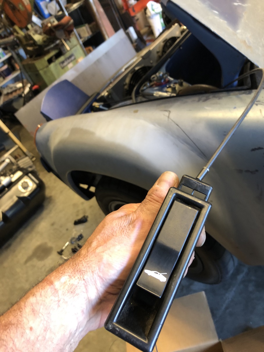

Who says you can't use a Ferrari 360 engine cover/rear hatch release as the lever to actuate your 914 GT headlights? (IMG:style_emoticons/default/happy11.gif)
This will most likely get used on the other build as the trunk release latch but I had to give it a go, just for fun. Good news is it worked.

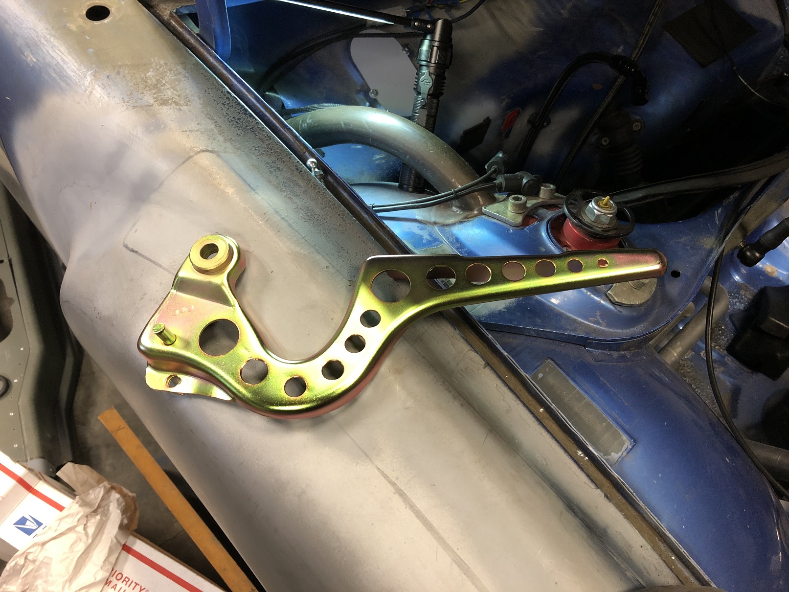

Waiting for the transmission allowed me to focus on a couple items I've wanted to redo.
One was my hood prop. Cool as I think it was, I completely overlooked the fact that the pit pin handle would get hot, what with being a foot from the radiator! Not fun when you go for a refuel...
Here's an early version of that set up, but you get the idea.

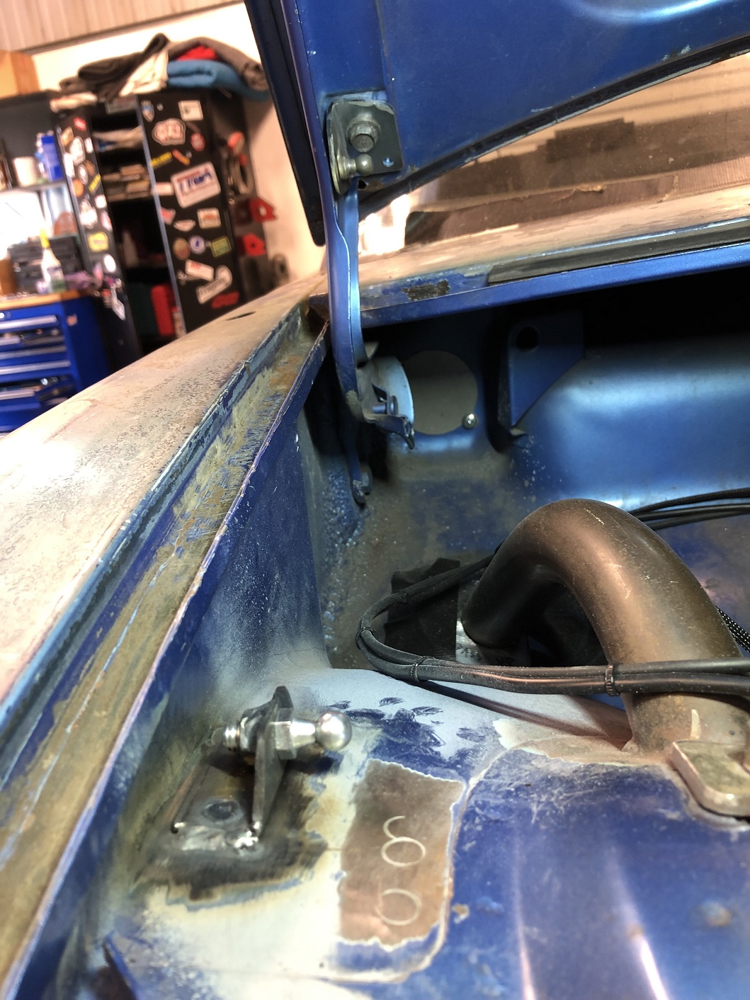

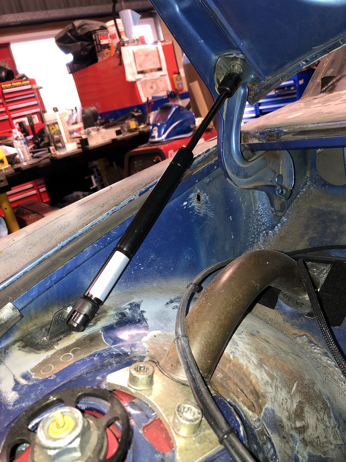

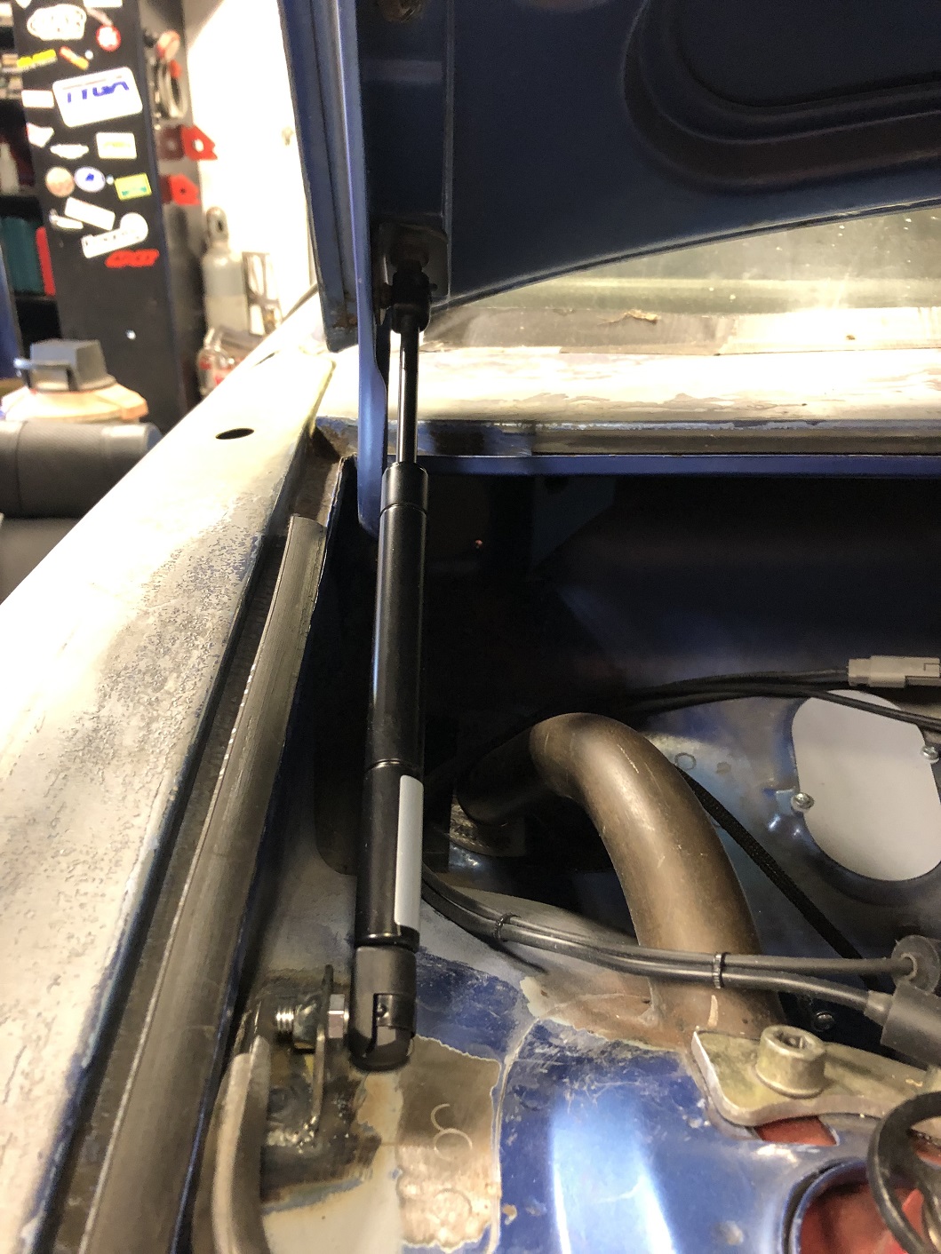

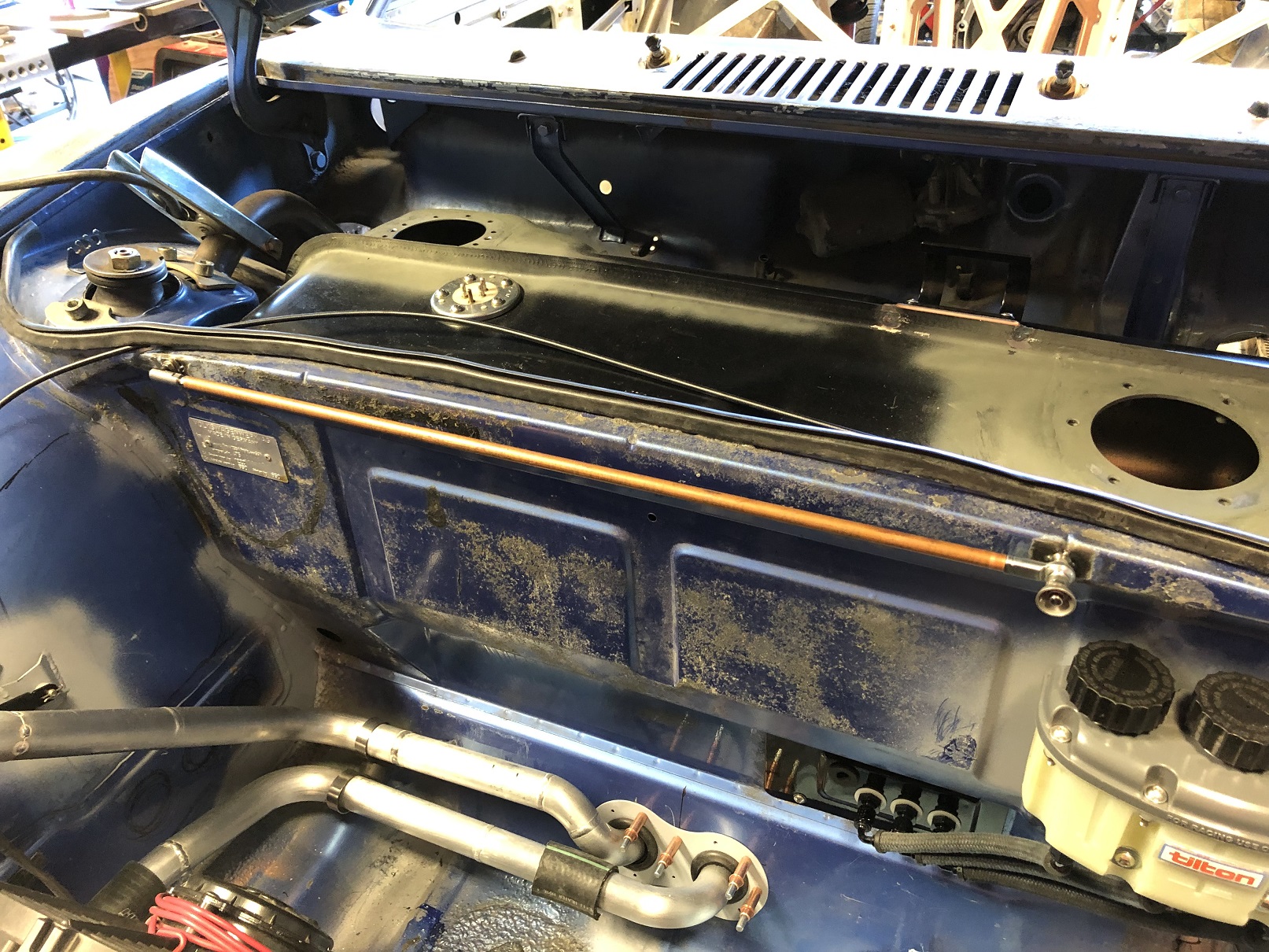

So I ordered the Camp914 hood strut kit - and then realized I'd removed my hood spring brackets. What to do?
First, I removed the strut ball pins from the bracket that bolts to the hood, reversed it and welded it back on. This moves the strut outboard. Now all I needed to do was fab a bracket for the other ball pin, worked out where it needed to be and weld it to the chassis. Done!
tygaboy
post May 17 2022, 09:06 AM
Post #4134
Posts: 5,853
Joined: 6-October 15
From: Petaluma, CA
Member No.: 19,241
All done here. Repeat on the other side and, she's complete.
On to removing / repairing all the mounting points for that original hood prop and looking forward to uneventful refueling!

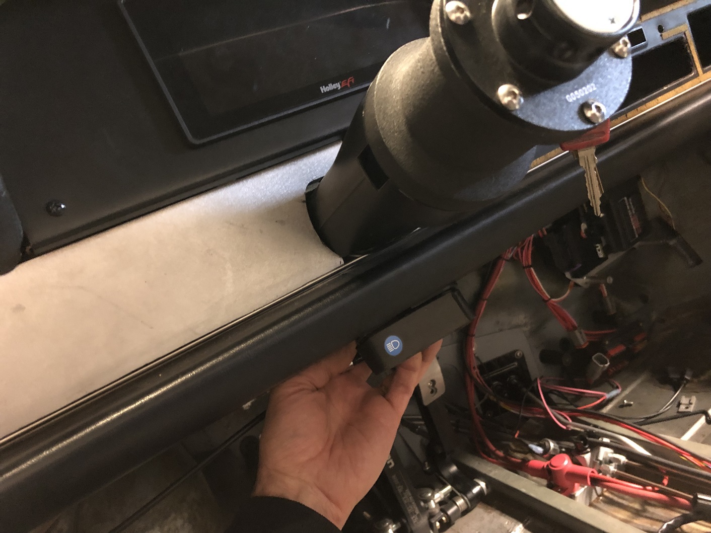

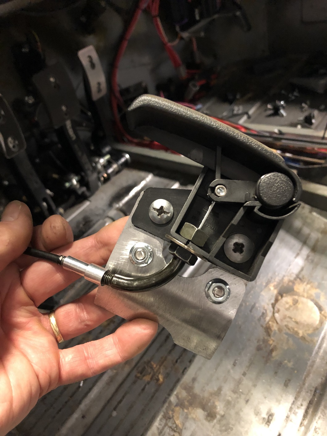

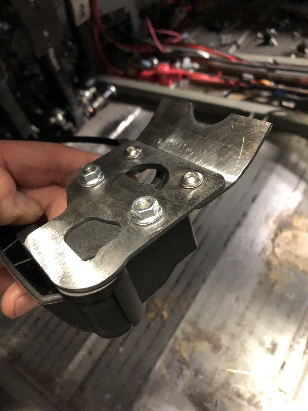

I'm getting a lot of the little projects done. Today it was working up a solution for the GT headlight pull. That Ferrari lever is way too big for what I wanted, plus it didn't really fit anywhere that I liked.
I wanted something a bit stealth and I ended up sourcing a domestic hood release latch ( Amazon ~ $10).
A bit of rummaging in the parts stash and a quick muttering of, "I swear I have one of those 90 degree throttle cable routing tubes..." Bingo!
Then I cut a mounting tab and removable mounting plate. Pay no attention to the mismatched fasteners - I need a specifically sized shoulder bolt and these were all I had laying around. I'll get matching ones, I promise. (IMG:style_emoticons/default/shades.gif)
Now, where am I going to mount this? (IMG:style_emoticons/default/idea.gif)

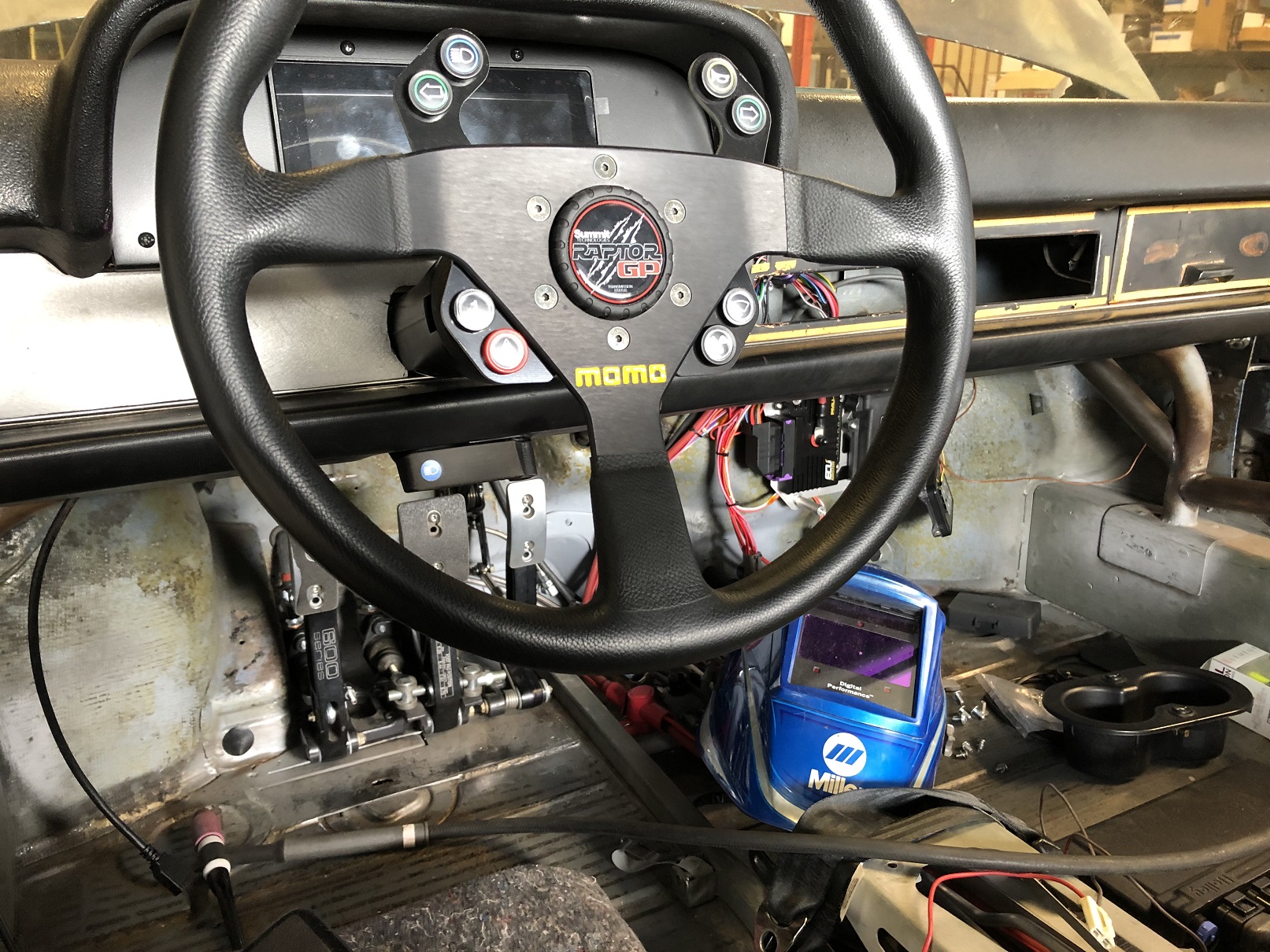

I love it when the stars align. Who'd have guessed that a randomly selected latch would fit perfectly in the lower dash pad indent under the steering column? Well, it does! And really nicely.
And just for fun, I applied a spare wireless steering wheel button sticker. Not sure I like it as lowers the stealth value. I may end up removing it. We'll see after it's fully installed and I can experience it with the car back together.
Now to weld on the tab and check this off the to-do list.

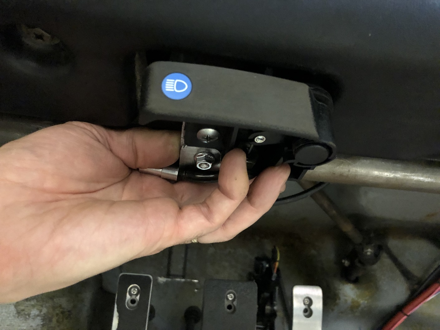

tygaboy
post May 28 2022, 11:39 AM
Post #4139
Posts: 5,853
From: Petaluma, CA
Member No.: 19,241
It took a bit of welding upside down while contorted in the footwell, using my shoulder to work the pedal... but with that fun session of "stunt welding" out of the way, the headlight release is fitted under the steering column.
