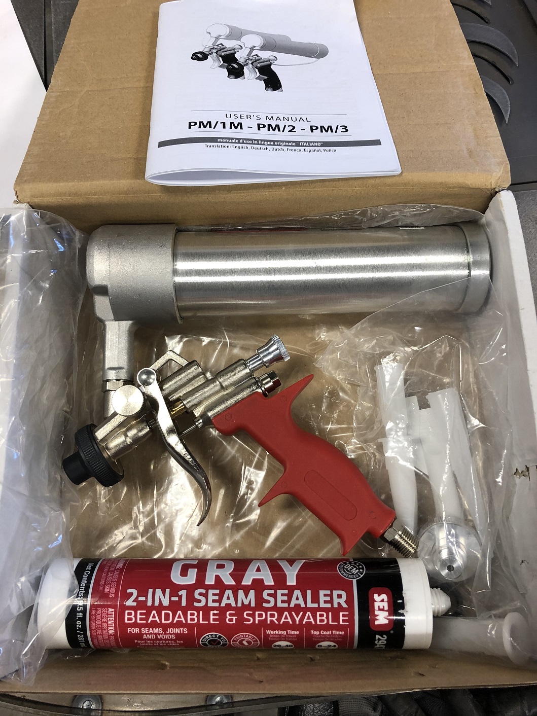

With all the panels I've changed out or removed, I need to get things sealed up ahead of paint so after a bit of research, I treated myself to an SEM pneumatic seam sealer gun.
This will allow me to essentially duplicate the look of the factory seam seal, as well as spray sound pad and other neat-o looks.
It also strikes me that I need to post a thread and announce some sort of "tool loan" program. I'm fortunate enough to have amassed some pretty cool tools and I was thinking I should let folks know they're available to borrow.
This seam sealer gun is a great example of something that makes all the difference in getting "the look" during repair/resto but that most folks wouldn't want to buy to use just once. Beyond my took whore-ness, I figured I could justify it based on needing it for my car, the Ferrari 914 build, RacerBenz and my E9, which needs floor pans and spare tire well repair. And @markhoward Mark will for sure want to use it on Smoggy!
Certainly some details to work out to ensure a successful loaner program, but it seems like the thing to do. Your suggestions welcomed.

Good on you! This tool in particular is one that begs for a rental/loaner program of some sort. Just one more of many examples of your generosity. (IMG:style_emoticons/default/beerchug.gif)

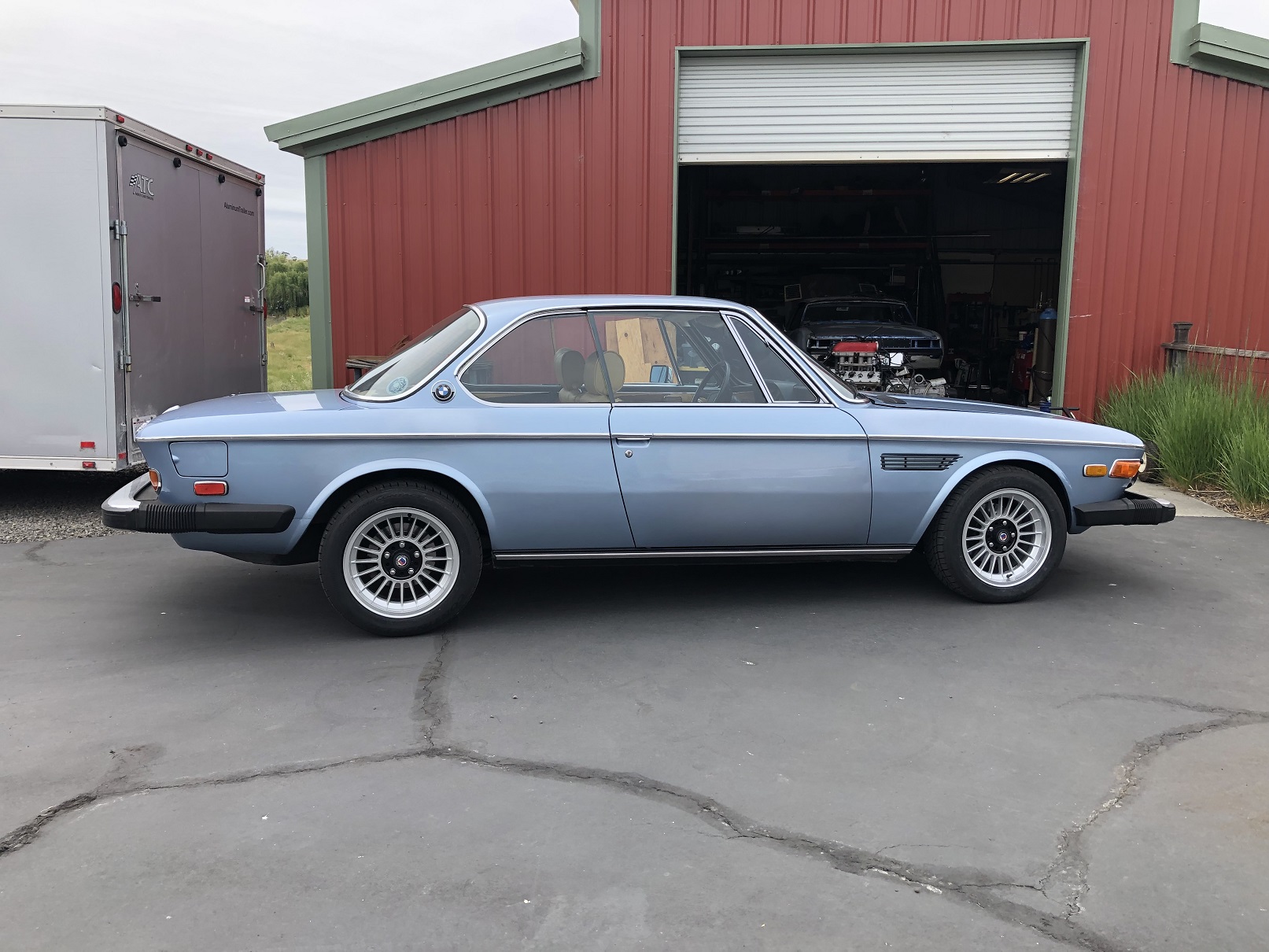

The E9 is back home. It's now a 3.5 injected 5-speed with a proper stance, new wheels and LOTS and lots of other stuff done to it. Euro bumper conversion in the works.
Probably as different from my 914 as another classic car could be.

Beautiful! I love E9s, and that's a great shot with the Ferrari engine poking up in the back and the 914 waiting its turn.

Wow, what a lovely E9. I dont know all the old BMW colors by heart, but is that Fjord Blue?
Euro bumper conversion will elevate it quite a bit. Love the M30 motor also.
Perfect two car solution LOL

@2mAn Yep, Fjord blue. It's a popular, well-liked color on the E9. Not my favorite, but it's growing on me pretty quickly. It certainly is pretty and suits the car well.

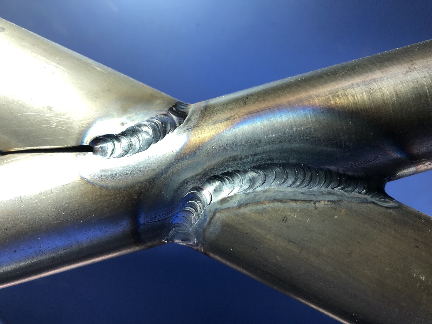

Back to the 914! Today was more "stunt welding". This time, it was the back/underside of the transmission mount X brace. I was laying on a board that was propped up on two tires. I had to wedge myself against the chassis to keep from sliding down the board. But I was able to get comfortable enough to get this result. The lovely blue background is the underside of my trunk.
Certainly room for improvement but I feel like I'm getting a reasonable handle on TIGing.
Please note that the driving reason I post stuff like this isn't to show off what may be a nice result. It's to point out that only a few years ago, I didn't know how to weld at all.
I hope what folks take from this is that if I can do it, you can, too. Give it a try, practice and...

Looking good, needs some more filler rod on the bottom one and you might get a cooler weld if you go a little bit faster. But to be honest, because it was upside down its really not bad! A bit of advice i got was work with higher amps faster rather than medium amps slow.

@tazz9924 - I've been trying the "hotter/faster" but absolutely need to get better at the faster part. It's what I've been working on. Just that much harder when out of position and overhead, as you know! Hey, that's my excuse and I'm sticking to it! (IMG:style_emoticons/default/shades.gif)

Nice welds. Clamped to a bench and working over it, I can't weld like that ...Or anywhere near that.

Man I love that E9, one of my favorite cars right there. Those are great welds on the brace, keep up the great work.

Chris looks good. As a welding instructor for over 20 years now I can tell you that your now have the hang of it. You will continue to improve as you weld more often. Its all about muscle memory. Keep it up.

The welds look fantastic to me. The BMW looks fantastic too. Can't wait to see it in person with the Euro bumpers.

(IMG:style_emoticons/default/agree.gif) those are some very nicely stacked dimes Chris.
