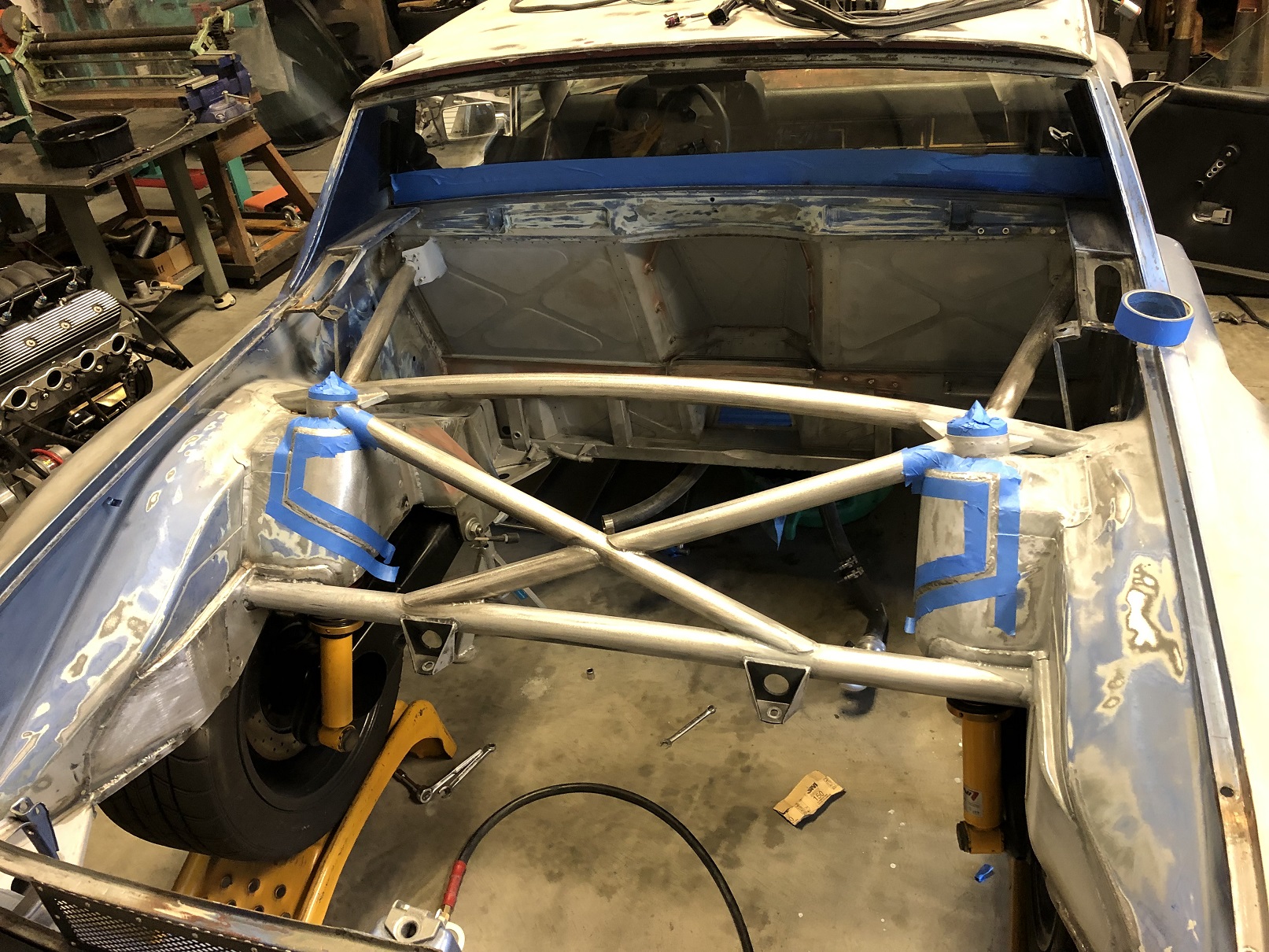

Actual 914 stuff: Prepping the engine bay for seam sealer and some primer.
Can I just say that I like fab work far more than paint prep... (IMG:style_emoticons/default/dry.gif)
That said, I can't wait to see things all tidied up and in a single color.

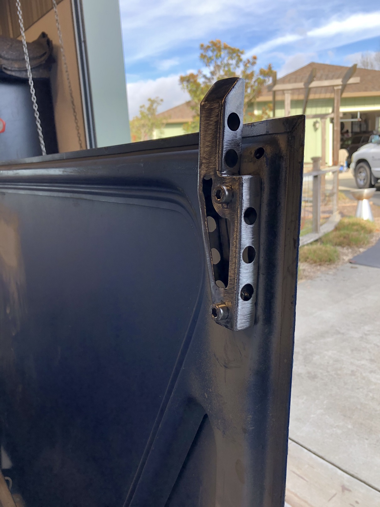

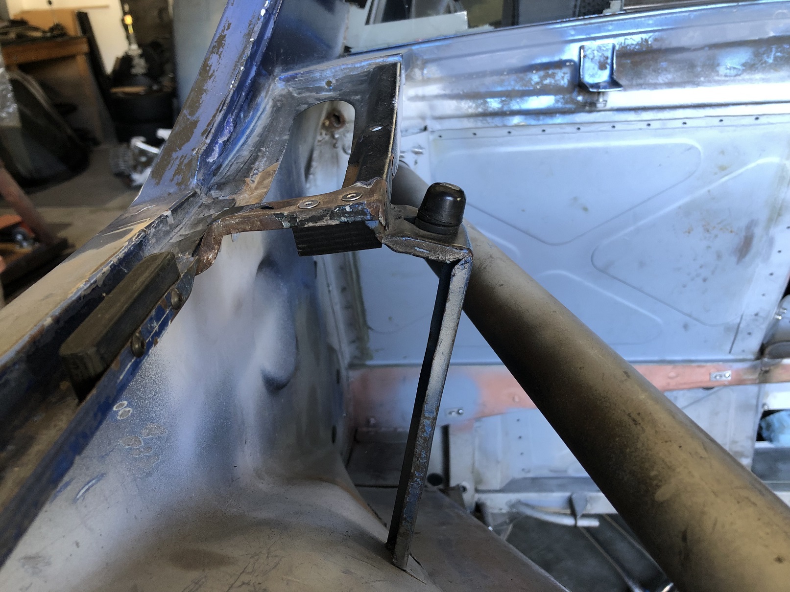

More fiddly stuff: With the reverse opening flip trunk set up, I didn't need any of the stock hinge mounting brackets - so out they came. It's getting pretty tidy in here!
And those little blocks you see? Those are my patent pending "914 Flip Trunk, Front Edge Positioning Pads". (IMG:style_emoticons/default/laugh.gif) They're Delrin.
I made up a couple brackets that mount to the standard hinge mount locations on the trunk lid. Those bracket are held down by the pads on engine lid side panels. And since they extend under that area, a bit beyond the pads, they also serve as safety catches.
That 2nd pic is of the initial, way too complicated version of the brackets. I didn't get a pic of the final version, but you get the idea.
The underside of the lid is then held up by the pad in the seal channel. I sized the pads to work in concert to position the front edge of the lid, with the smallest bit of interference, this to ensure no rattles.
Yep, just more little stuff that took forever to figure out. But it works like a charm!

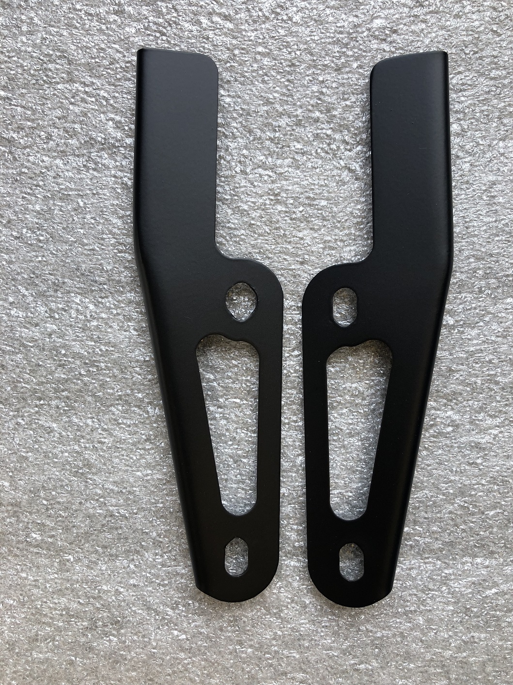

For those who may care, these are the final version rear lid latch/catch parts, just back from powder coat. A nice 1/2 gloss, sorta matte finish. I like the look! And as you can see, far simpler and lighter. A "less is more" example.

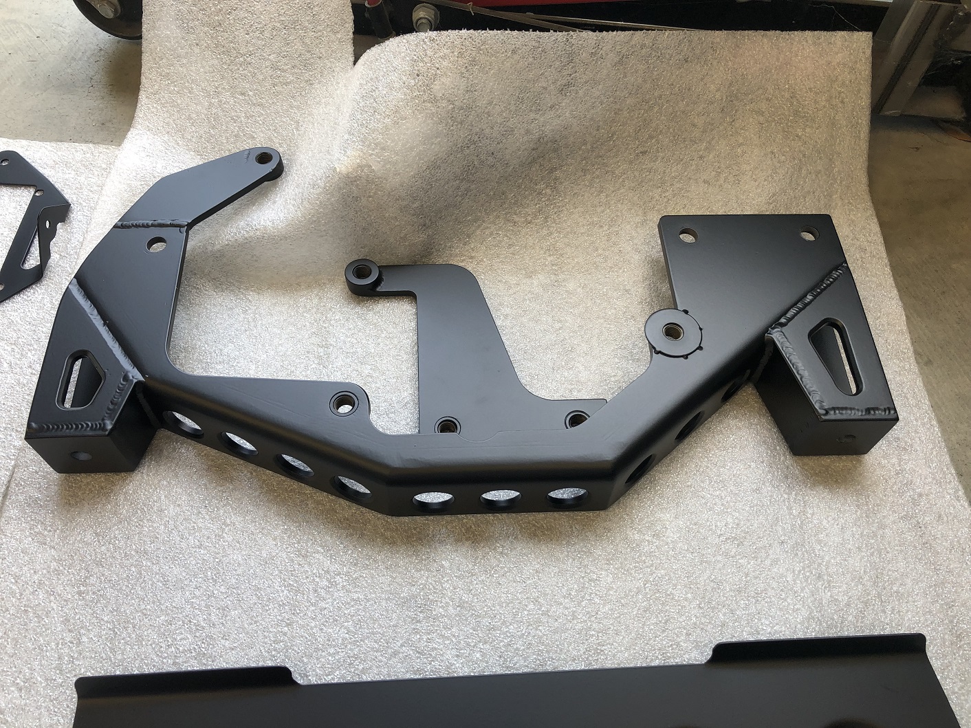

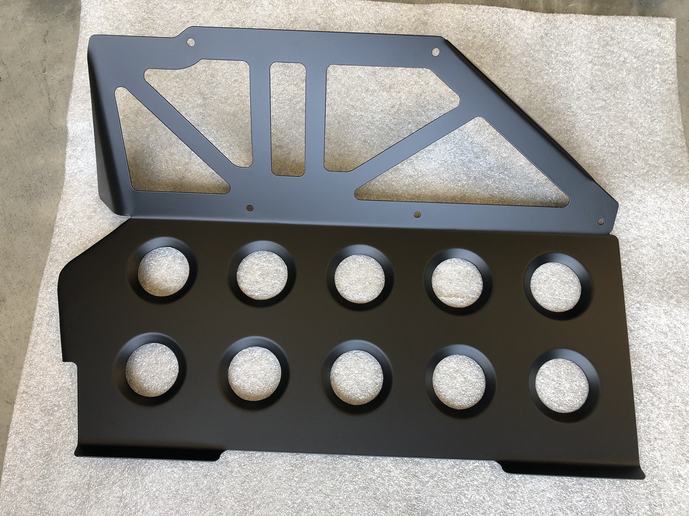

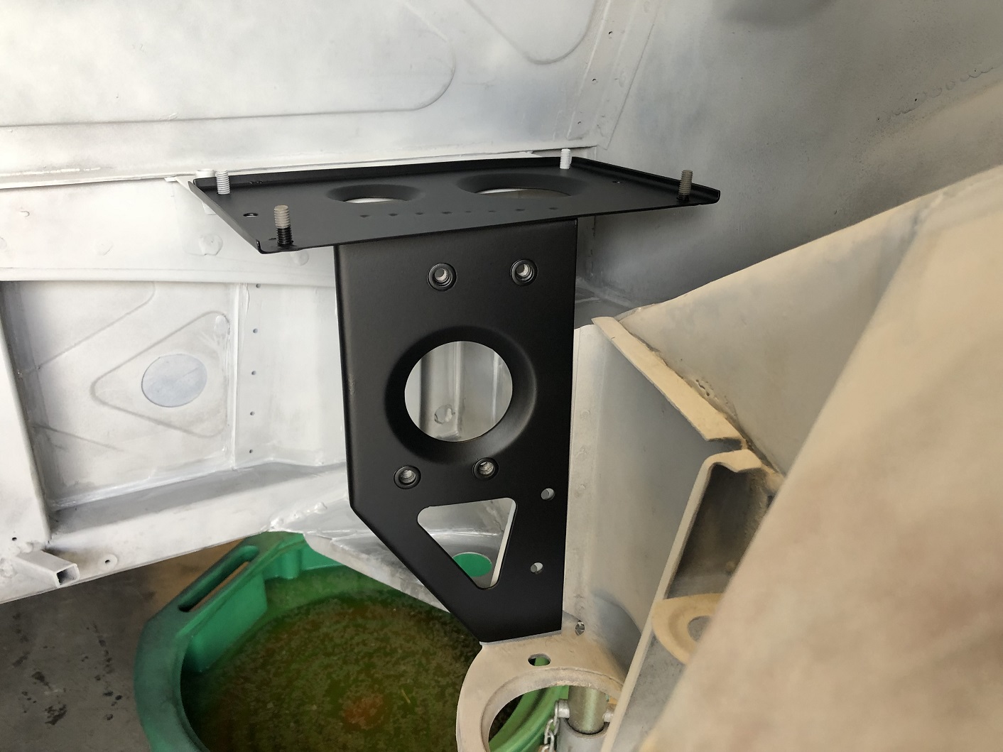

Speaking of finishes, here are a few other pieces I had done.
- battery tray/fuse mount
- passenger foot rest/electronics guard
- trans mount: this started out as a Renegade kit part but was modified to account for the elimination of the factory transmission mount in favor of a custom cross bar/suspension tower brace.
I have to say, it's satisfying to see all these bits I've made get all prettied up. Almost looks like I knew what I wanted! (IMG:style_emoticons/default/laugh.gif)

QUOTE(tygaboy @ Jun 22 2022, 01:29 PM) *
That trans mount is one hell of a piece!

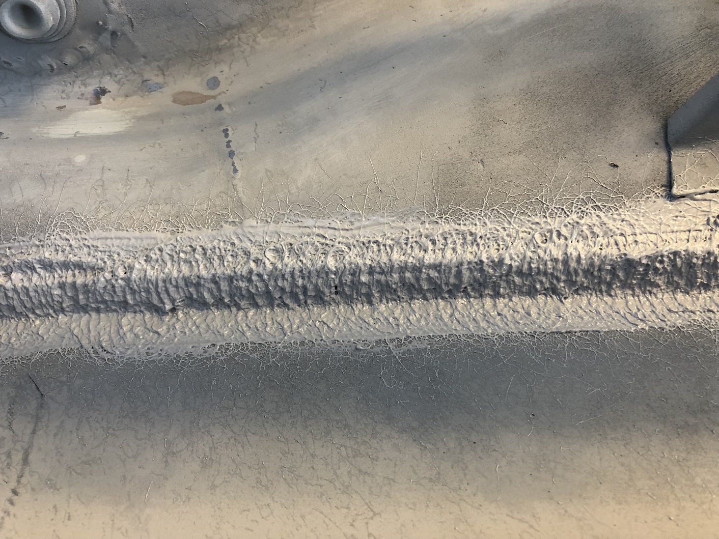

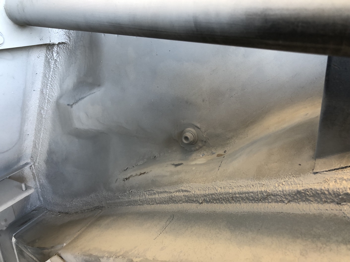

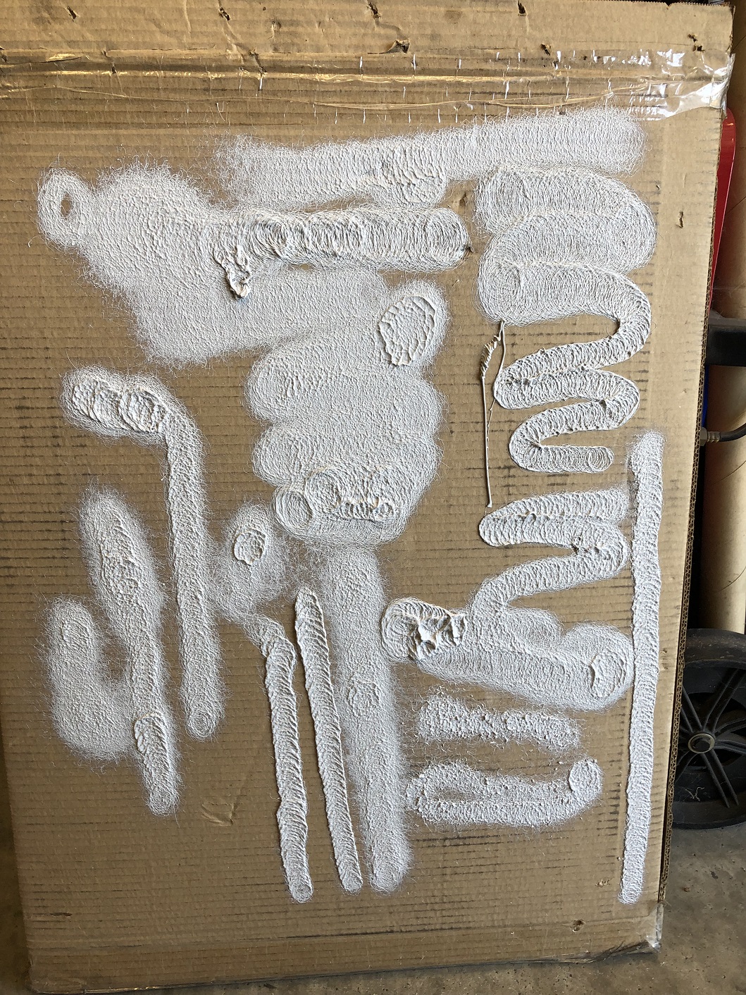

But what the heck is this? Well, I was trying to get to know the sprayable seam sealer gun ahead of taking it to my car.
With a quick turn of a knob, it sprays a wide "sound deadener" pattern to the other, narrower looks you see here.
Wish me luck, I'm going in... (IMG:style_emoticons/default/unsure.gif)
tygaboy
post Jun 23 2022, 12:53 PM
Post #4177
Posts: 5,853
Joined: 6-October 15
From: Petaluma, CA
Member No.: 19,241

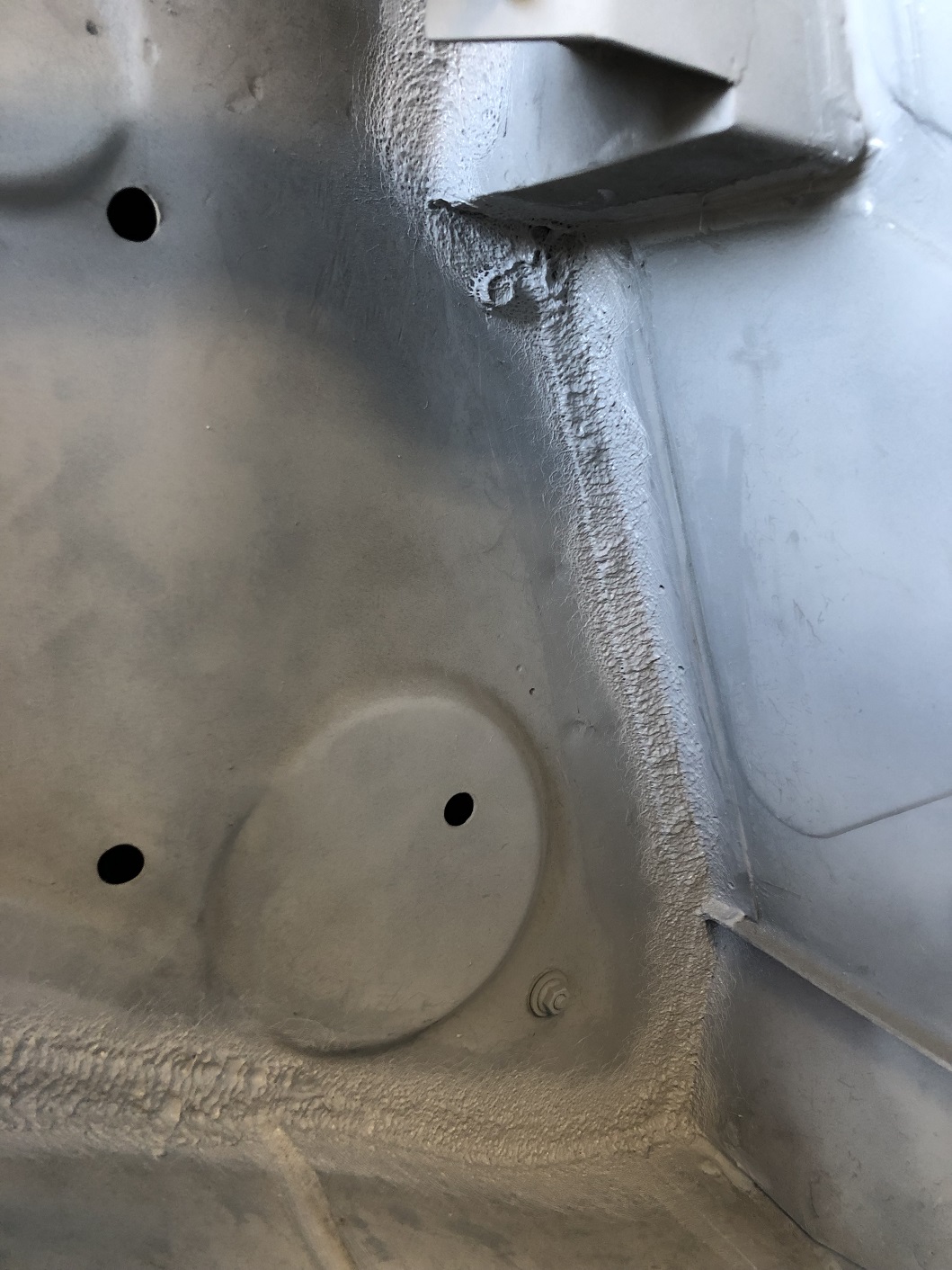

In typical fashion, what seems easy while you're practicing on nice flat surfaces with complete access ends up being a bit more challenging to pull off on the car.
But here's how it turned out.
I think once it's top coated, it'll be fine but I may try spraying another, very light layer of sealer to see if I can close up those little holes.
I plan to prime then paint, or perhaps, since my entire engine bay/trunk area is exposed to the elements, shoot Wurth Stone Guard over all the sheet metal. Still thinking about that.
