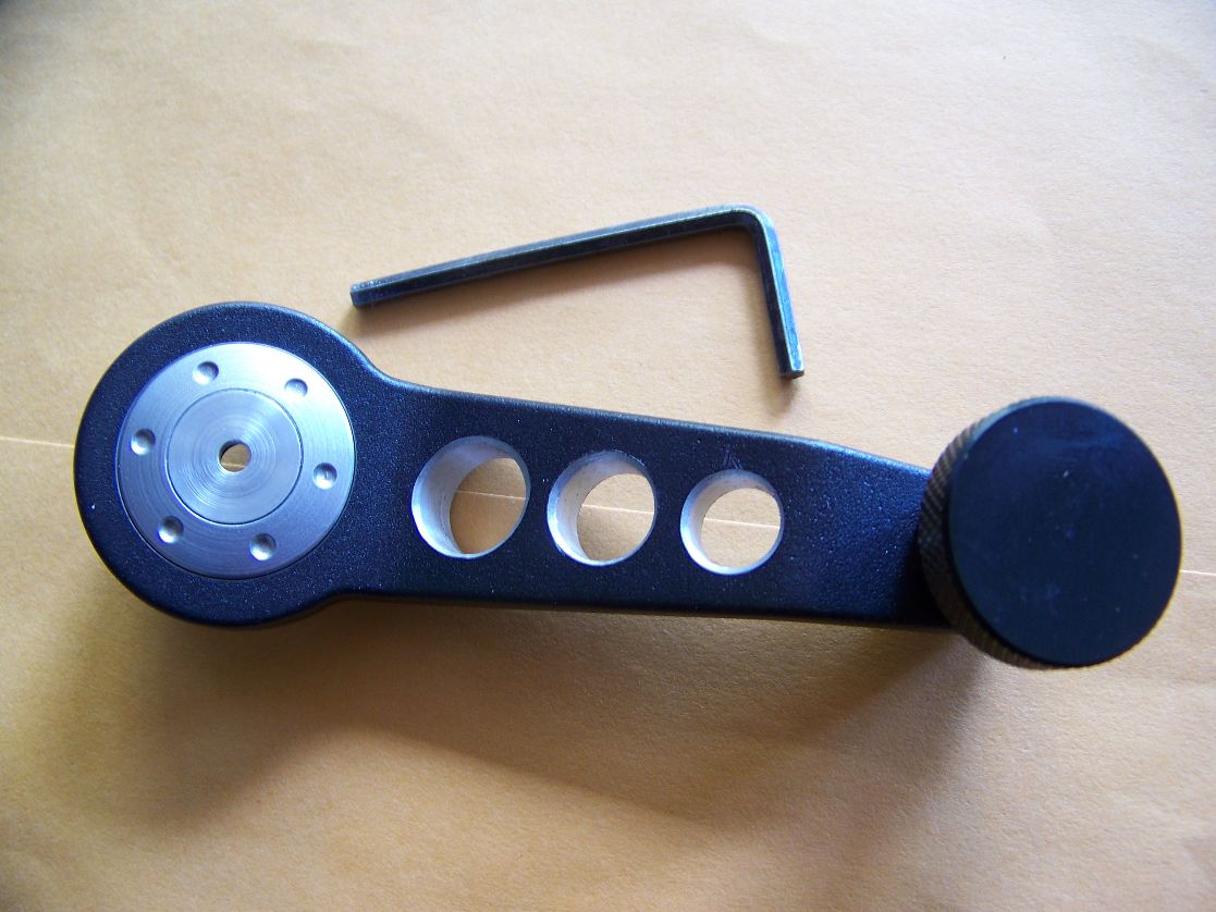

Thanks to all for the compliments. Again, it's nice - and humbling - to hear that others find my design direction attractive.

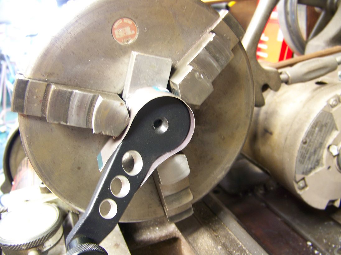

Time to get after finishing up the winders:
- work out getting them in the lathe (yes, the knob was removed prior to spin)
- use a parting tool clocked at 90 degrees to carve the "trench"
- glue in the helmet visor trim ring
- drop the fastener in, just to see how it'll look (yes, the knob is on the wrong side, just to hold the handle for the pic)
Yet another example of spending a LOT of time on a small detail.
And it turned out just as I'd hoped! (IMG:style_emoticons/default/aktion035.gif) (IMG:style_emoticons/default/wub.gif)
I wonder if there'd be a market for these? (IMG:style_emoticons/default/idea.gif)

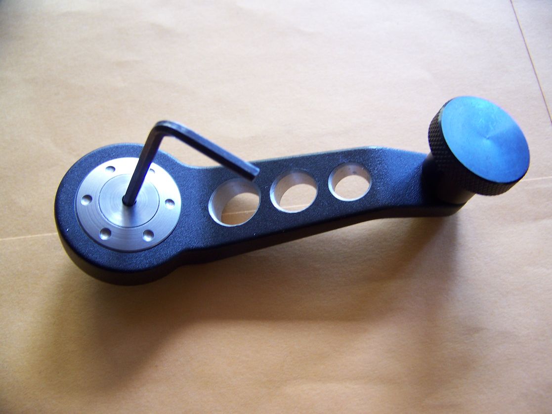

The winders just didn't look finished. So let's cap them off with... a cap!
These press in and capture the fastener, hence the hole. I'm claiming it's just another dimple (IMG:style_emoticons/default/shades.gif)
Version II of these trim pieces will likely be an all-in-one trim ring/cap that has the fastener built onto it. The dimples will actually be the receptacles for a small pin wrench for installation and removal. There won't be a center hole or that seam around the cap. THAT will be really stealthy!
But these'll do for now.

I realize that it's probably not really "your thing", but I really feel like you have fabricated several items recently that you could easily sell as aftermarket items...specifically, those window cranks, that passenger foot rest, and that center tunnel cover....all really works of art. I've only seen one aftermarket crank I like as much as yours, and the vendor wants $150 a set. Anyhow......great thread...awesome 914!

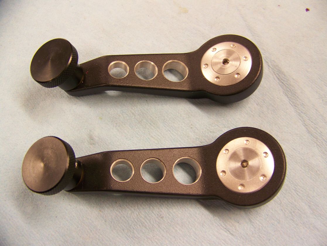

The pair done! (IMG:style_emoticons/default/cheer.gif)
Note the dimple rings aren't yet glued in so neither is clocked in its final positon, hence the dimples aren't aligned to anything.

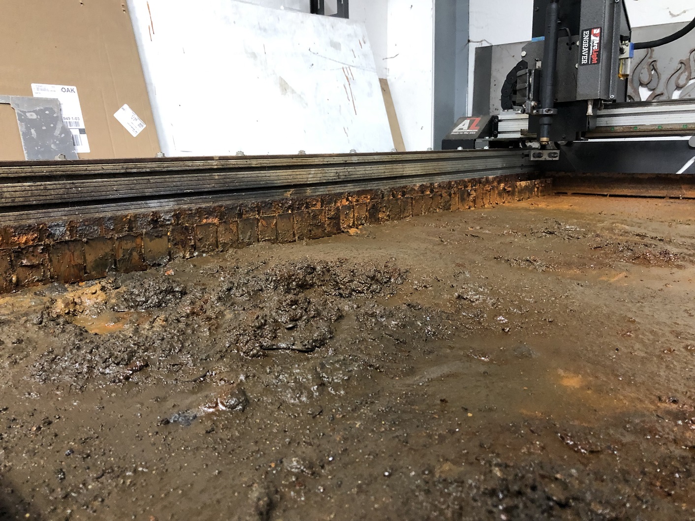

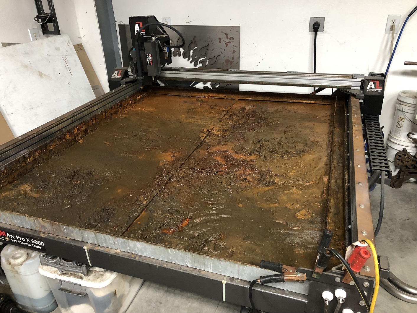

Reminder to self: Next time, don't wait so long to service the plasma table. Holy moley, I really dropped the ball on this...

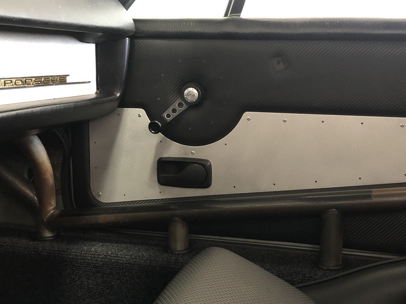

Window cranks installed. I'm happy with how these turned out.

QUOTE(tygaboy @ Oct 21 2022, 02:10 PM) *
Looks like ecto-plasma…

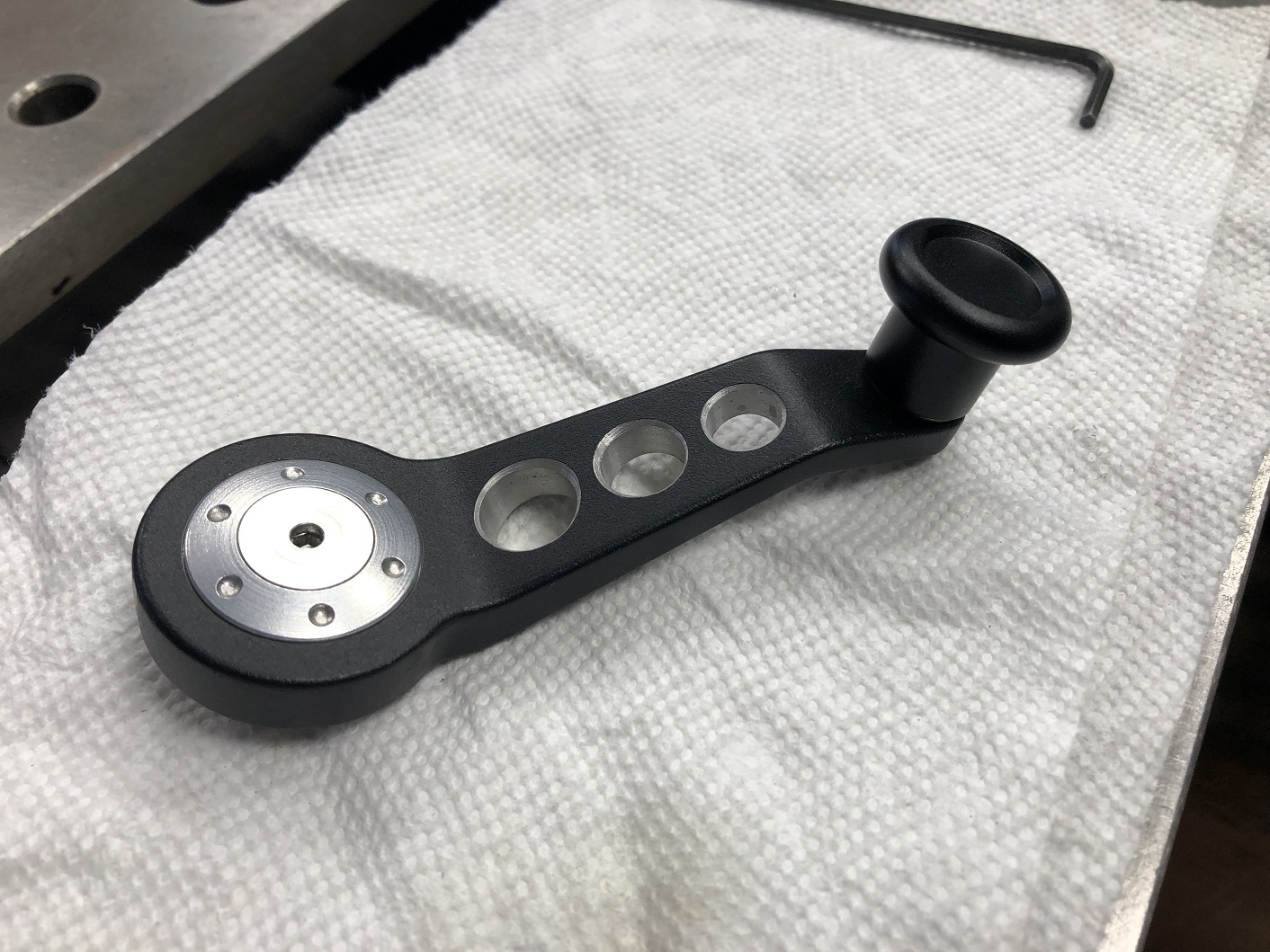

Member No.: 19,241
Here's a close up of the completed assembly with the optional, softer-edged knob. I think it looks more finished and is better in keeping with the look I want.

Here's a close up of the completed assembly with the optional, softer-edged knob I opted to use. I think it looks more finished and is better in keeping with the look I want.
Looks very nice, Well done!

I wish the stock window cranks were that well made. (IMG:style_emoticons/default/beerchug.gif)

QUOTE(tygaboy @ Oct 21 2022, 01:10 PM) *
Don't throw all of that concoction away Chris. I think we can make a good gravy or roux from some that! (IMG:style_emoticons/default/happy11.gif)
