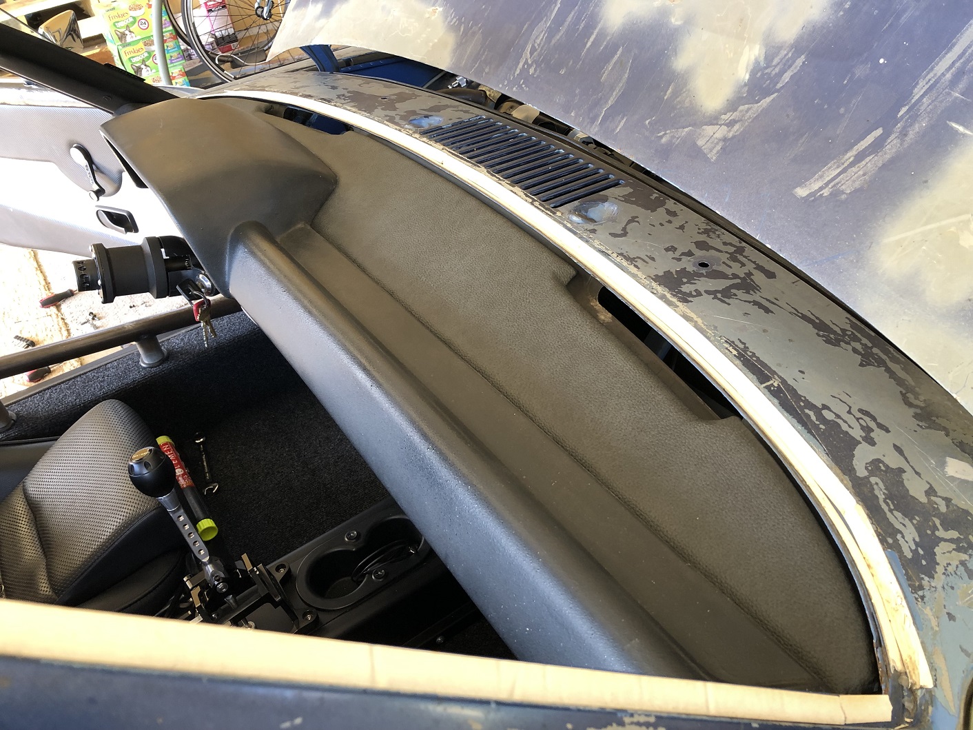

A bit of composite repair work on the driver side carbon fiber long panel then I cover it with carpet. Hidden carbon fiber. Just one more thing my car has in common with a Singer. No wonder it got accepted for Luft! (IMG:style_emoticons/default/av-943.gif)
Hope you enjoy the jazzy music vibe during the time-lapse segments.

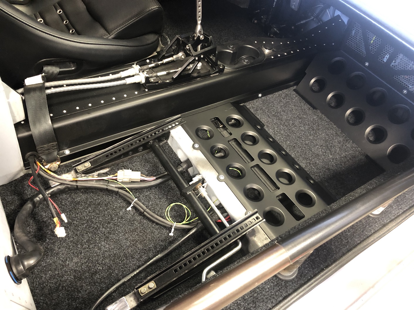

Getting this thing "ready" for Luft is like putting a band-aid on a bullet hole.
The car isn't even painted, but hey, it's now got carpeting under the seats! (IMG:style_emoticons/default/av-943.gif)

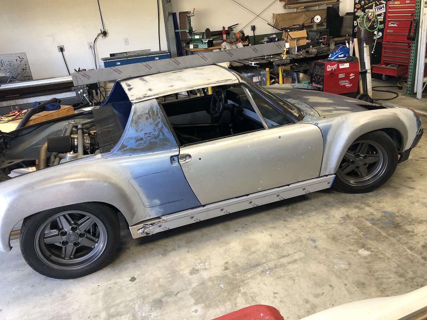

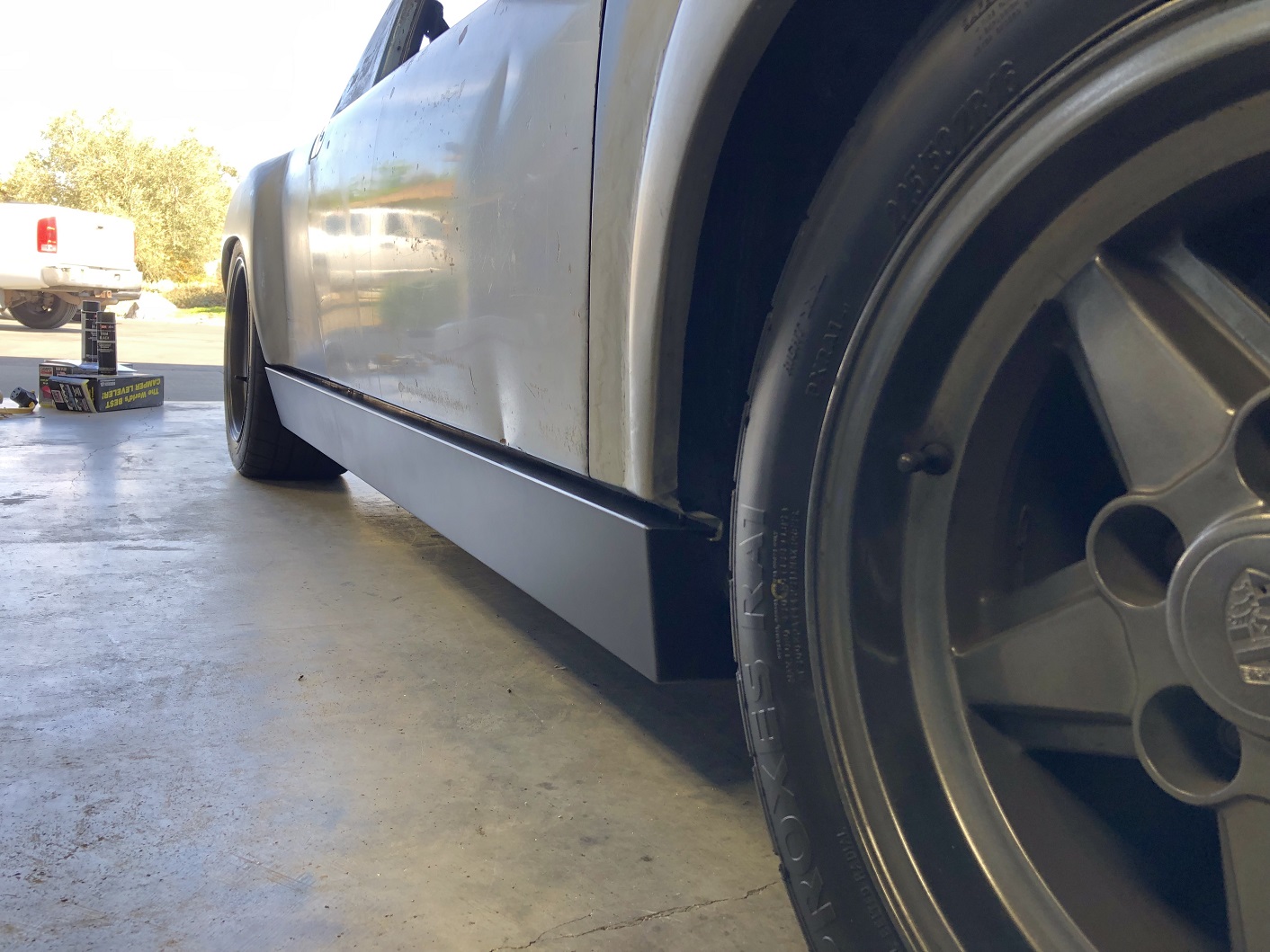

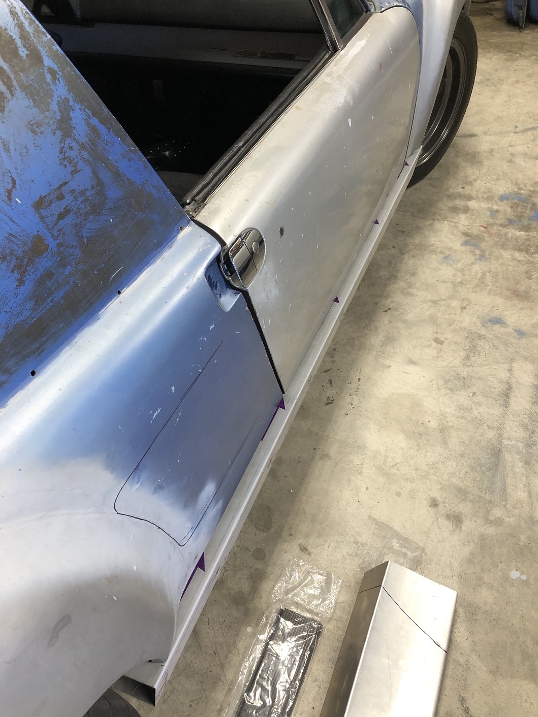

One last thing I may be able to complete for Luft: rough fitting a simple set of boxed rockers. My brake can't do a piece this long so I spec'd it and Van Bebber Bros, my local metal supply place, bent up the aluminum for me.
I'll trim them to length then add returns that match the shape of the return on the flares.
I think it's cool, the way they came with purple arrows already painted on them. Seems pretty "full race" looking to me! (IMG:style_emoticons/default/aktion035.gif)
tygaboy
post Apr 26 2023, 04:23 PM
Post #4409
Posts: 5,853
Joined: 6-October 15
From: Petaluma, CA
Member No.: 19,241

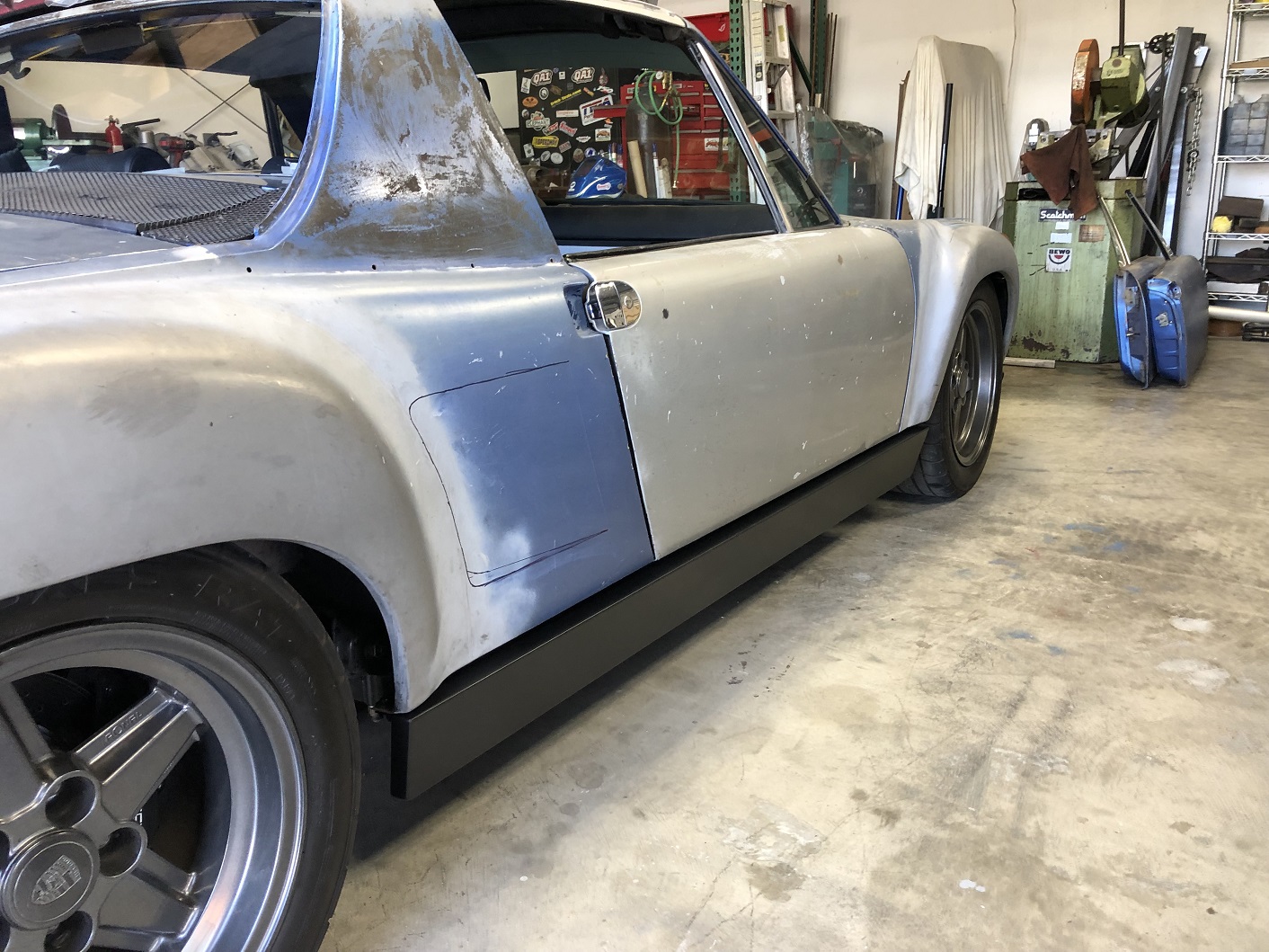

The rear is closed off and all but finished.
tygaboy
post Apr 26 2023, 04:25 PM
Post #4410
Posts: 5,853
From: Petaluma, CA
Member No.: 19,241

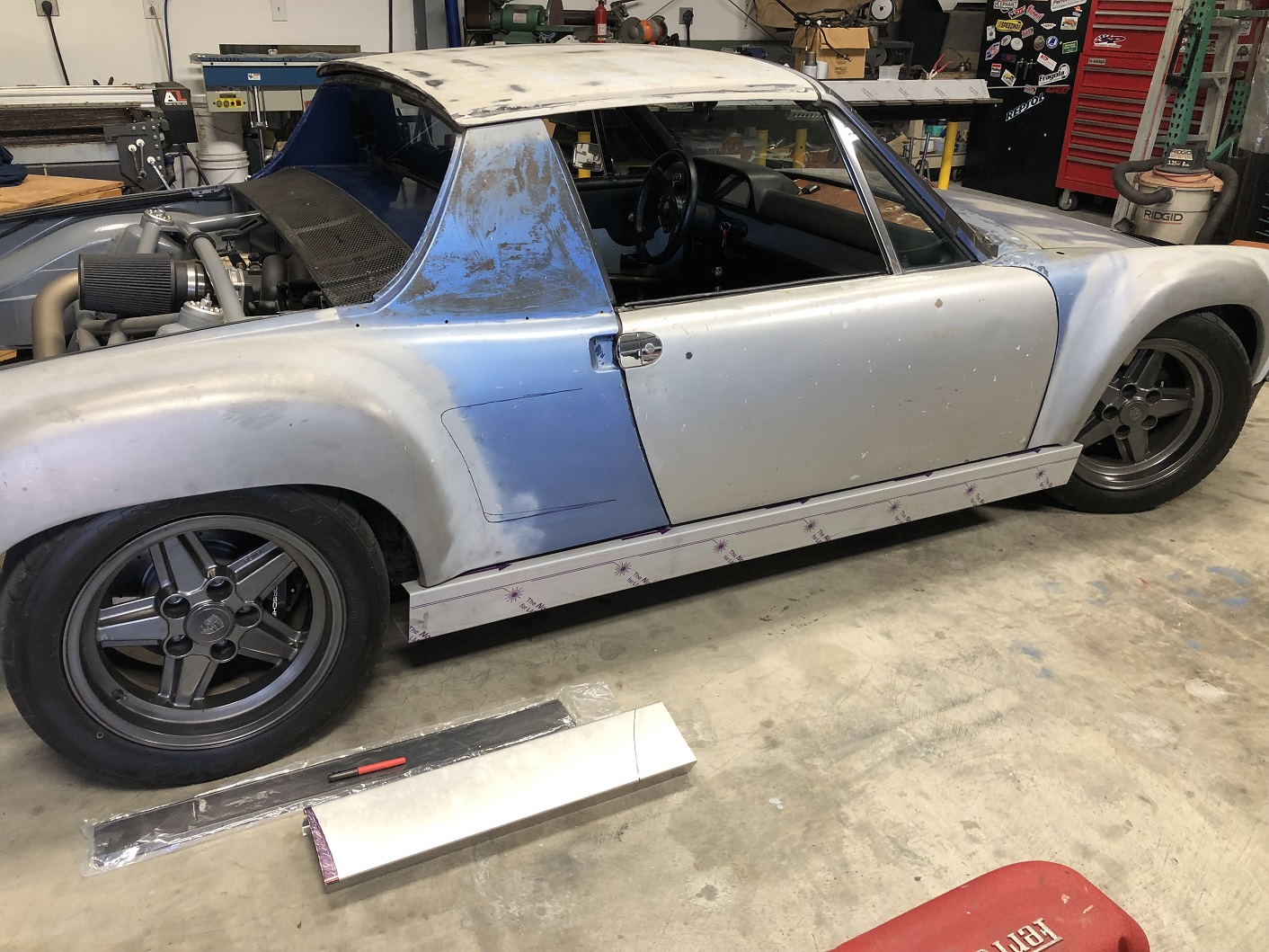

Playing with how I might close the front. The very bottom of the flare and the return will be tuned to tidy up how they look with the rocker covers in place.
tygaboy
post Apr 26 2023, 04:26 PM
Post #4411
Posts: 5,853
From: Petaluma, CA
Member No.: 19,241
Almost there on the first side. The car will be sporting at least one cover for Luft! (IMG:style_emoticons/default/aktion035.gif)
tygaboy
post Apr 27 2023, 05:21 PM
Post #4412
Posts: 5,853
From: Petaluma, CA
Member No.: 19,241

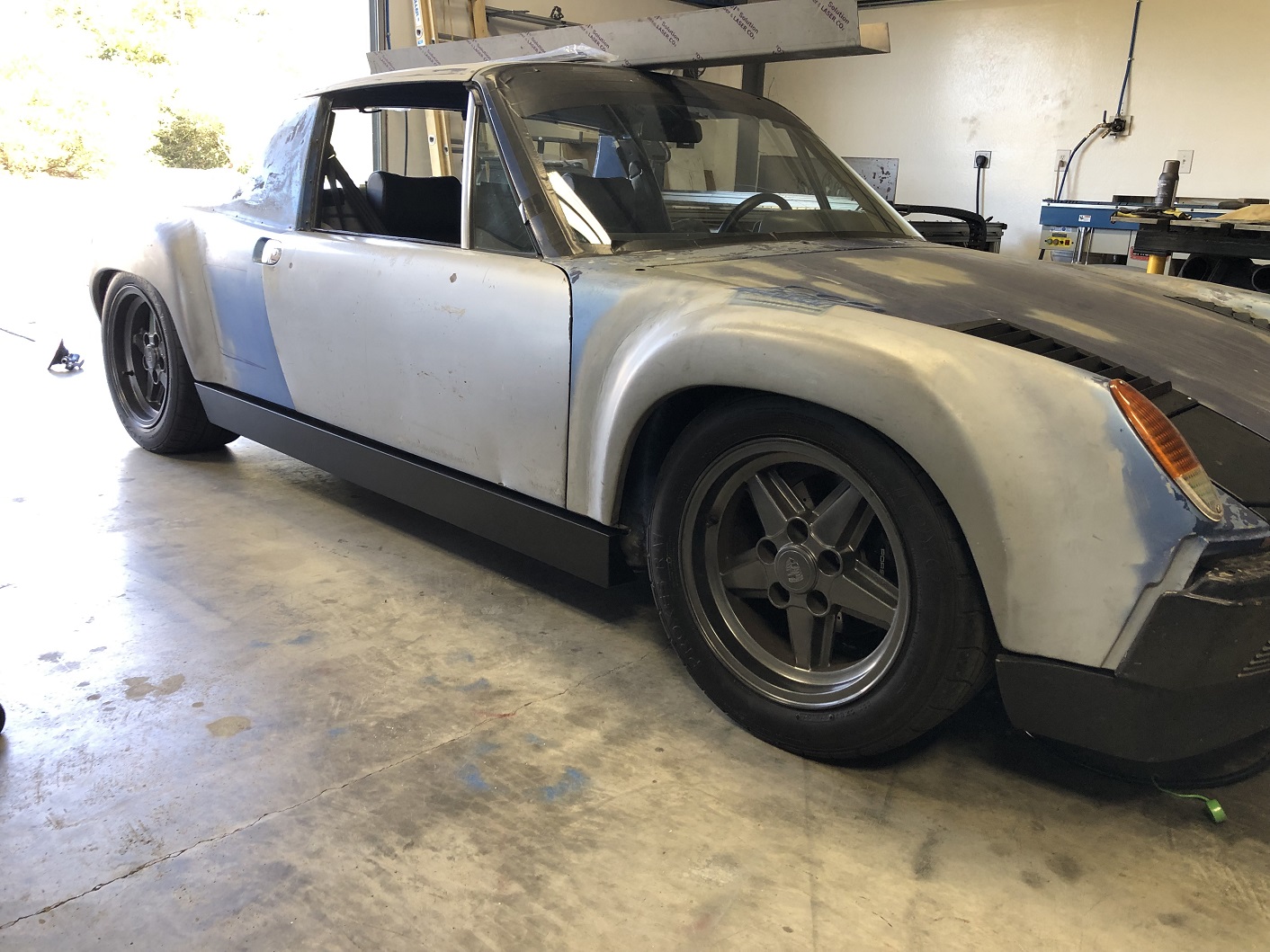

Everything wrapped up and treated to a little SEM Trim Black. Well, the first side, anyway.
I think they look pretty good from most angles. If there's a V2, I'll go with a very slightly rolled face (like the factory covers) and slightly larger corner radii - even though these are essentially the same as the factory corners.
What I didn't take in to consideration is that with the stock covers, you can't really see the upper radius since it tucks in under the door a bit. Plus, they angle inward more steeply than mine. making my lower radius appear sharper than the factory piece.
Just more lessons learned on the never ending journey that is this build.

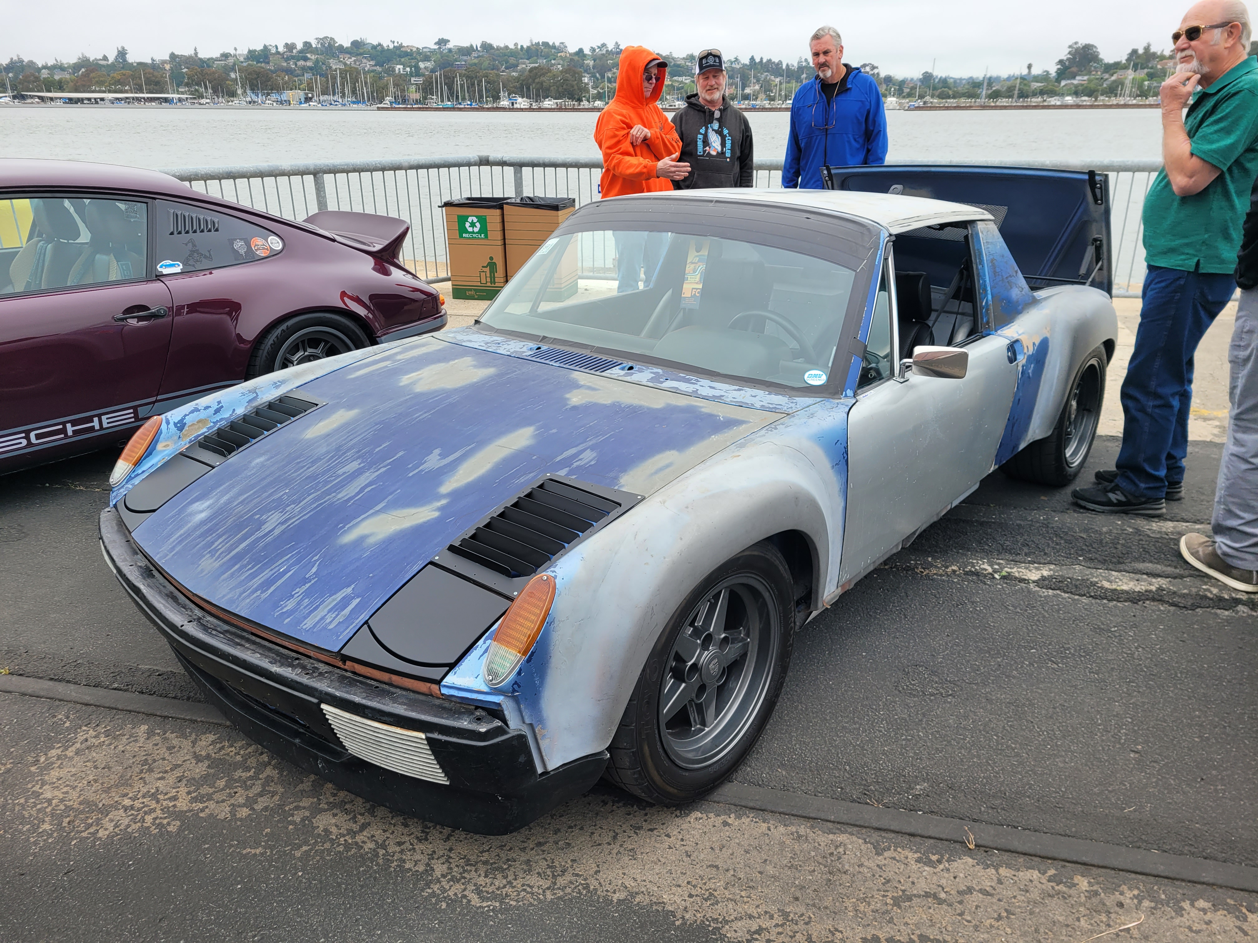

Luft 9, April 29, 2023. Matt Farah and his "The Smoking Tire" podcast picks my car as his "favorite so far". Are you f-ing kidding me... Worth watching the whole thing but the section mentioning my car starts about 1:03:30.

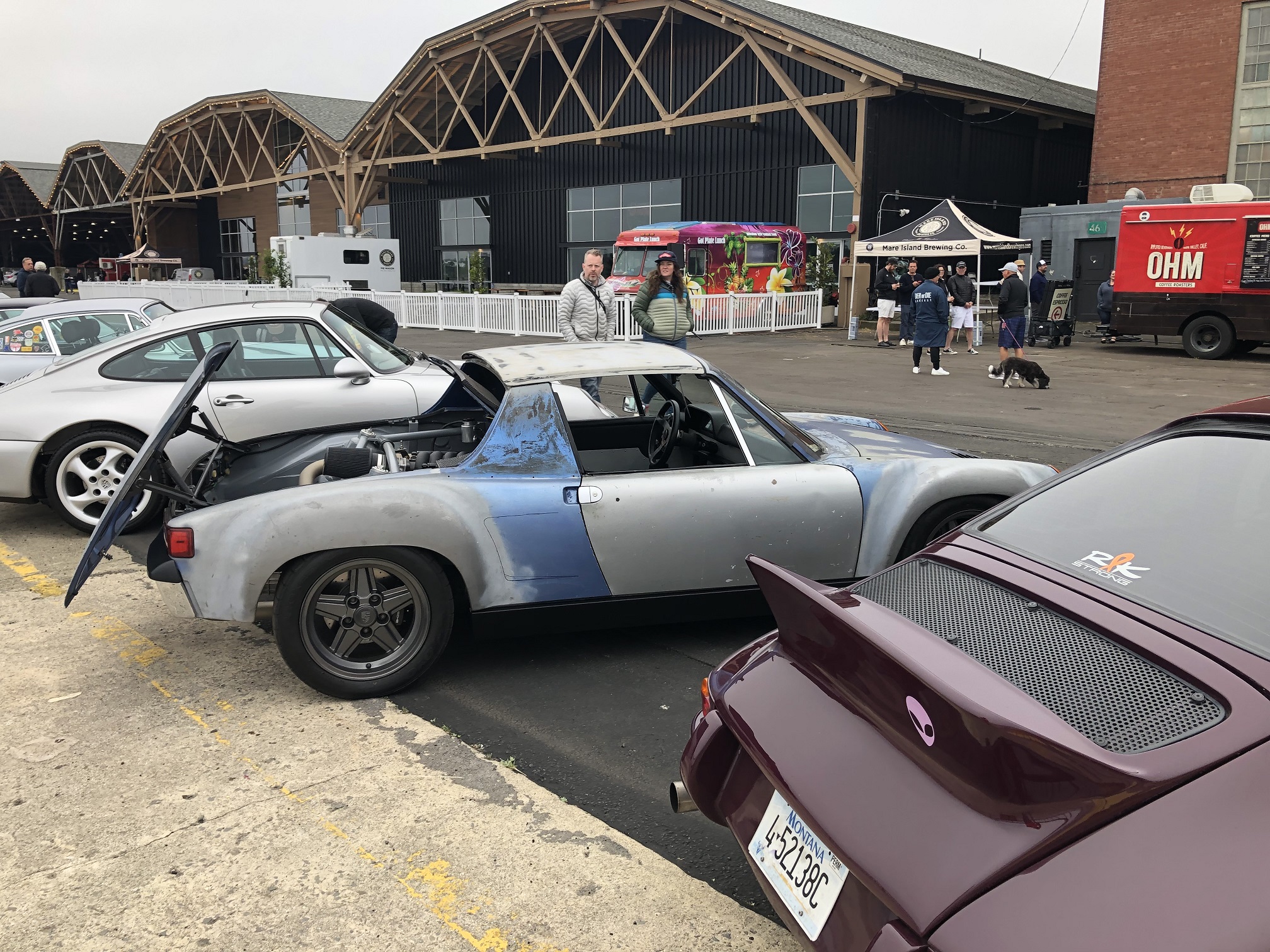

Car had a crowd around it all day Saturday.Attached Image

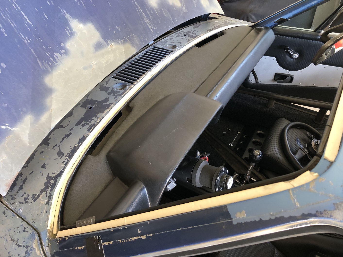

Forget Luft. Everyone knows the people we REALLY need/want to impress are the folks who're headed to WCR in a couple weeks! (IMG:style_emoticons/default/biggrin.gif)
That pressure means I need to be sure the LS car is looking its best. So, a quick viewing of @iankarr Ian's "How to Restore the Dashboard" YouTube instructional video and my dash is looking pretty nice. Big thanks, Ian!
And another shout out "Thanks!" to @buddyv Robert for directing me to JoAnn's Fabrics where I picked up the foam pad and lovely vinyl. ~$25 and, wow. So. Much. Better!
Gotta say, it's the people on this site that make all the difference! Thanks guys.
