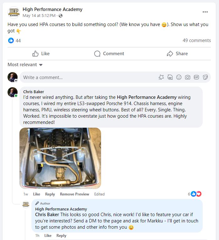

OK, so this is pretty cool. I just messaged them so no idea what'll come of it but "it's an honor just to be nominated..." (IMG:style_emoticons/default/laugh.gif)

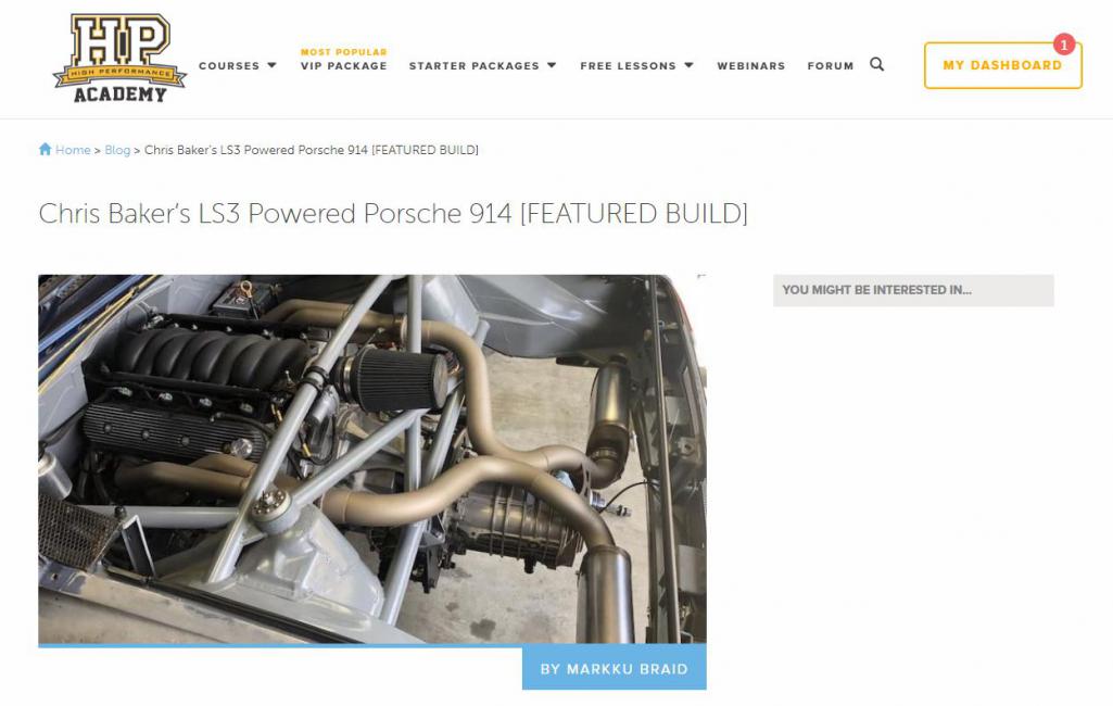

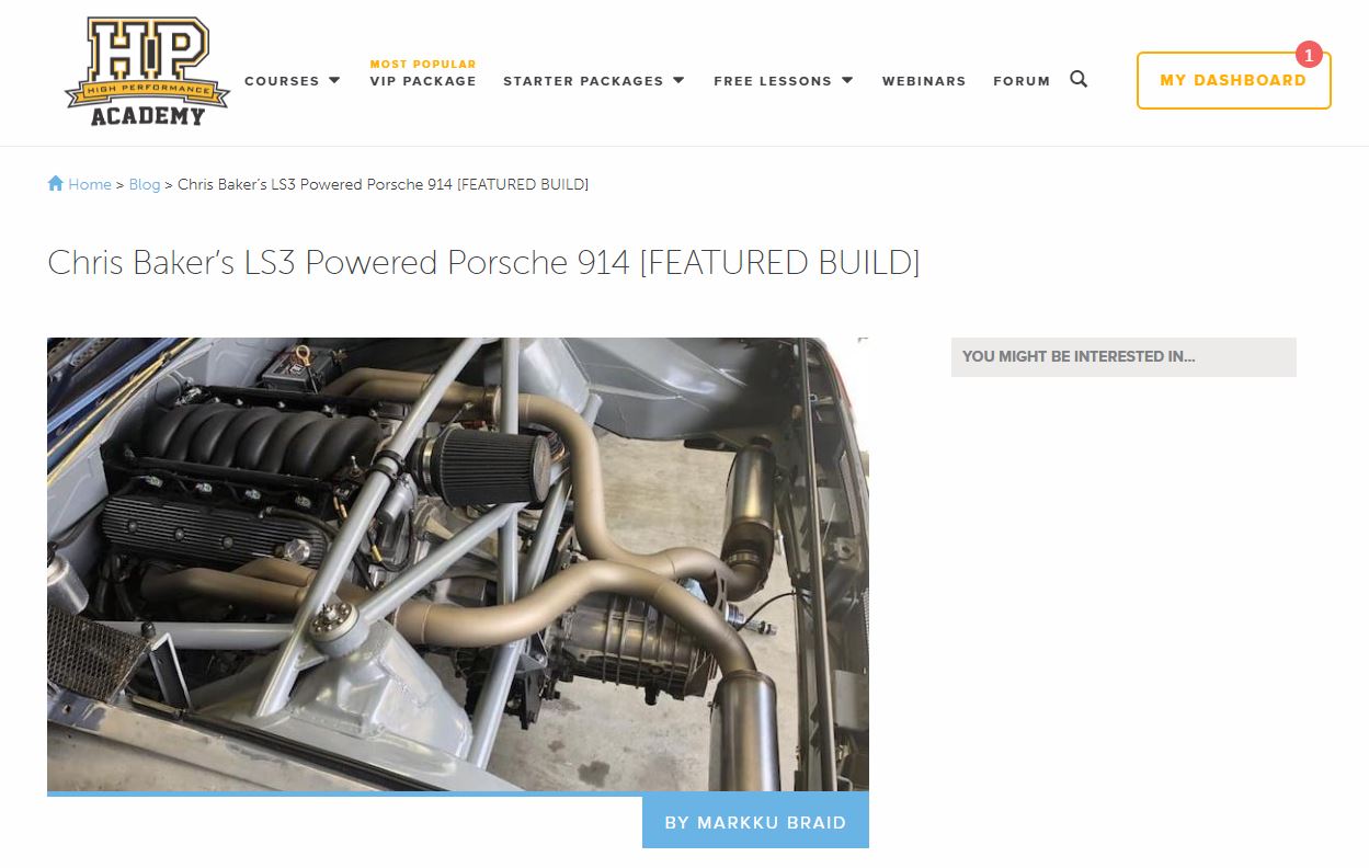

The HP Academy article on my LS build is live:
https://www.hpacademy.com/blog/chris-bakers...ed-porsche-914/

Glad to see your work getting recognition. Also, glad to see this build thread making an appearance again!

Congratulations on the article Chris. Well deserved. Man, 3 projects going on! (IMG:style_emoticons/default/first.gif)
Looking forward to more.

Cool article; congratulations Chris- well deserved. (IMG:style_emoticons/default/smilie_pokal.gif) (IMG:style_emoticons/default/beerchug.gif)

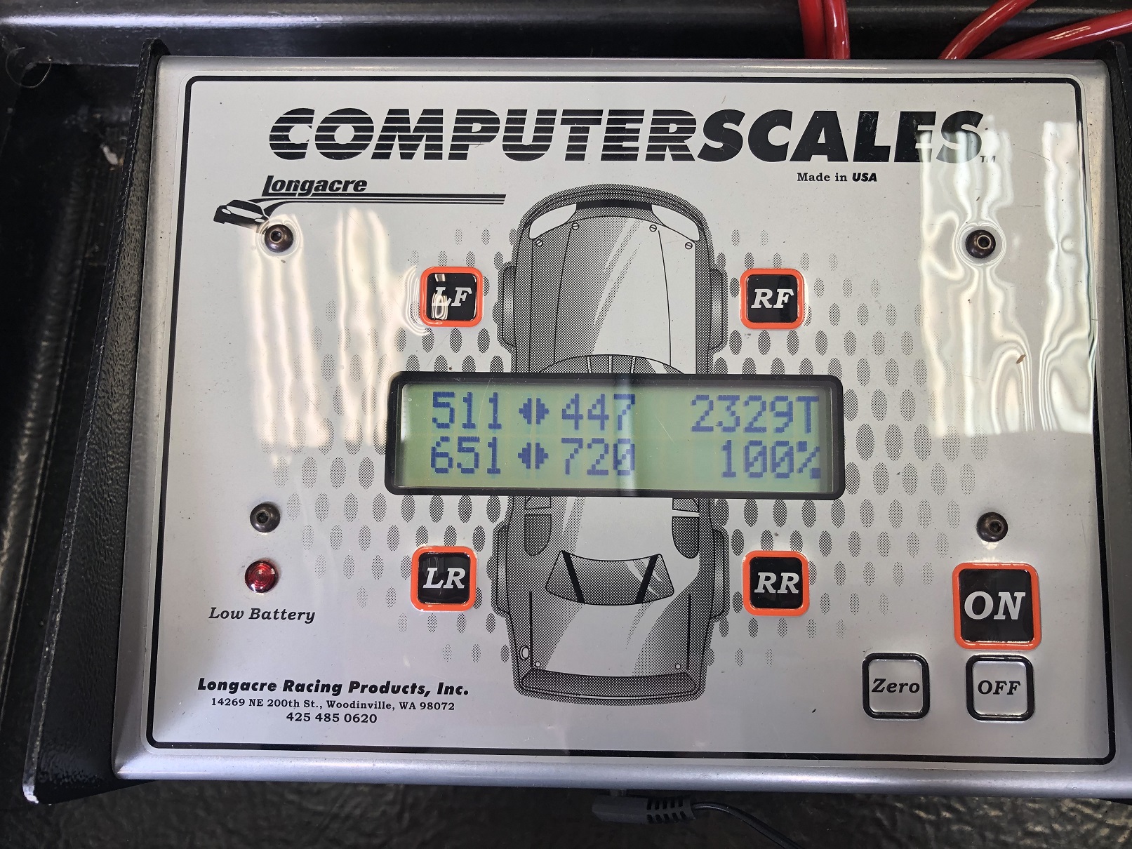

After a lot of work on the 914 Ferrari, it's time to give some love to the LS car.
There are a hand full of things that need improving and it's time to get started on those.
You'll hear all about it in an upcoming "At The Red Barn" YouTube episode but for now:
- replace the clutch master cyl. It needs a smaller bore size to decrease the needed force/lengthen the engagement travel.
- upgrade the dampers. I'm going all in on 3-way adjustables. Not sure which brand but contenders are Moton, Tractive, KW and maybe others.
The suspension shop I'm working with needs a data to set a baseline for spring rates a damper valving. This includes:
- motion ratio of the trailing arms (wheel travel vs shock travel)
- unsprung weight values
- overall weight info
So I borrowed a set of scales to get started. Just over 2300 lbs wet isn't too bad! Pay no attention to the corner balance. All that set up stuff has yet to be done.
Ideally, lessons learned on the LS car will likely transfer to the 914 Ferrari.

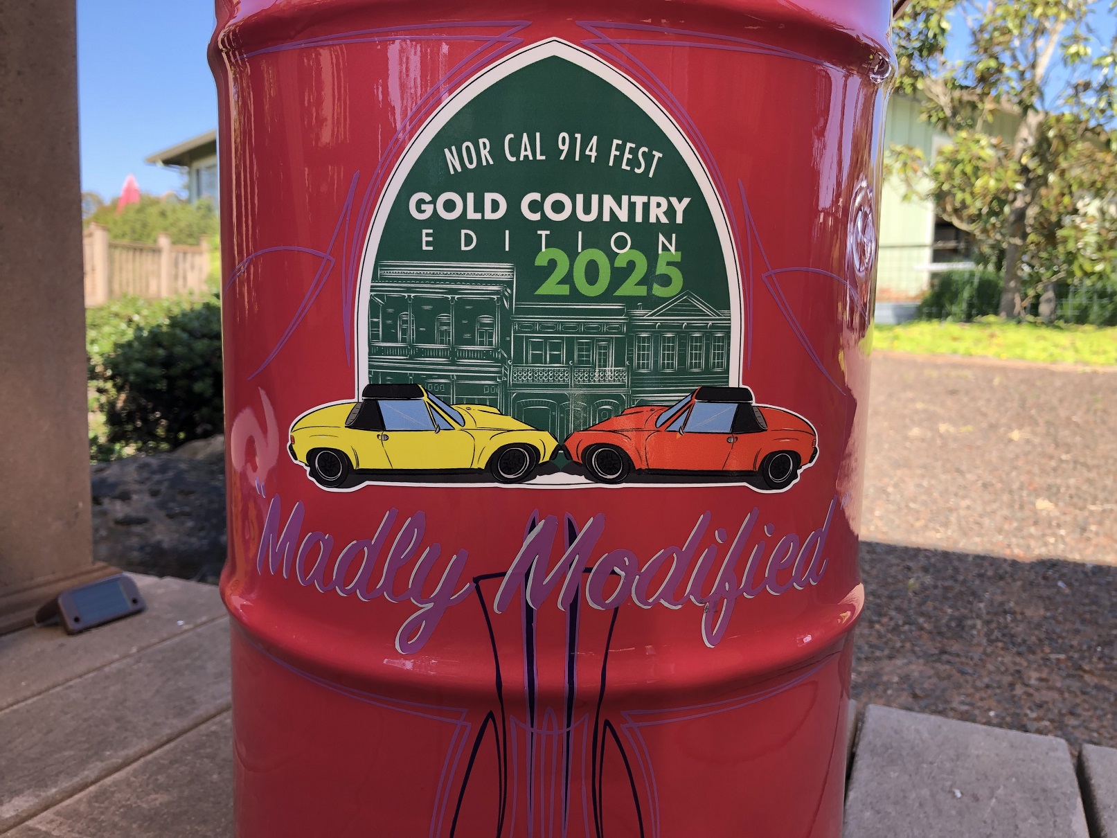

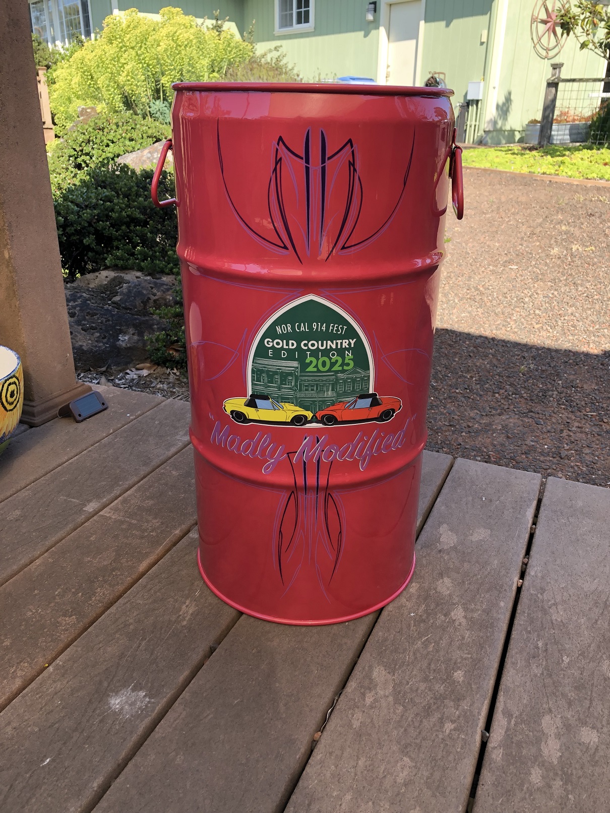

Great weekend spent at the NorCal 914 Fest! The organizers did a wonderful job: cool people, great cars (3 factory 6s, including @Cairo94507 ) a couple 6 conversions, 4 V8-swaps and a bunch of nice 4-cyls.
Saturday was a lovely 140 mile drive through the Gold Country, excellent driving conditons, very little traffic. Each meal was more delicious than the last and we ended the day with a fun awards dinner/raffle at Red Bus Brewing in Folsom.
My LS car was awarded the "Madly Modified" trophy: An awesome shop garbage can with the event badging and featuring some very cool pinstripe work done by a local artist.
It's even raspberry and is all but an exact match to the Ferrari build! (IMG:style_emoticons/default/aktion035.gif)

Way to go Chris! Way cool trophy. (IMG:style_emoticons/default/first.gif)

Getting props on Haltech vid is fantastic Chris congrats !! Def a fresh/exciting addition to their usual drag / drift/ JDM coverage. Love the 'Petrol barrel trophy>> have your local upholstery shop make a cushion seat for it...perfect for the work bench (IMG:style_emoticons/default/first.gif)
