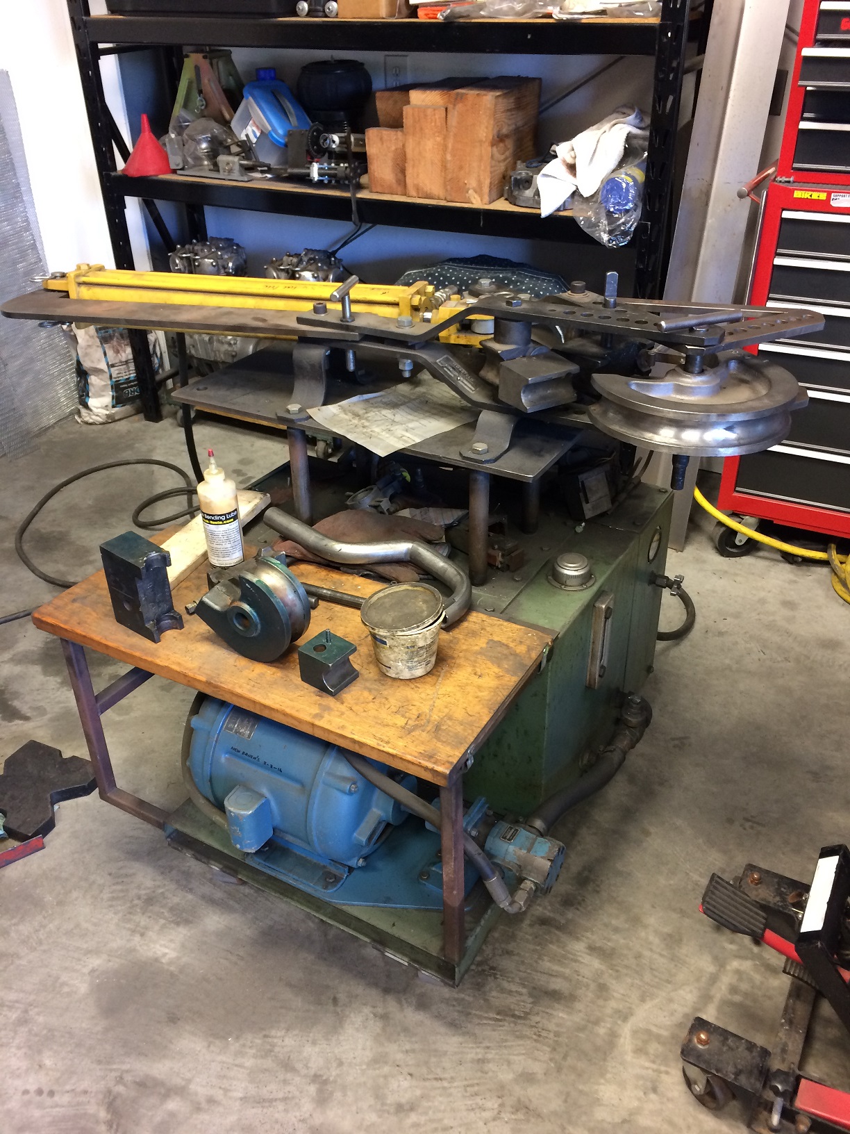

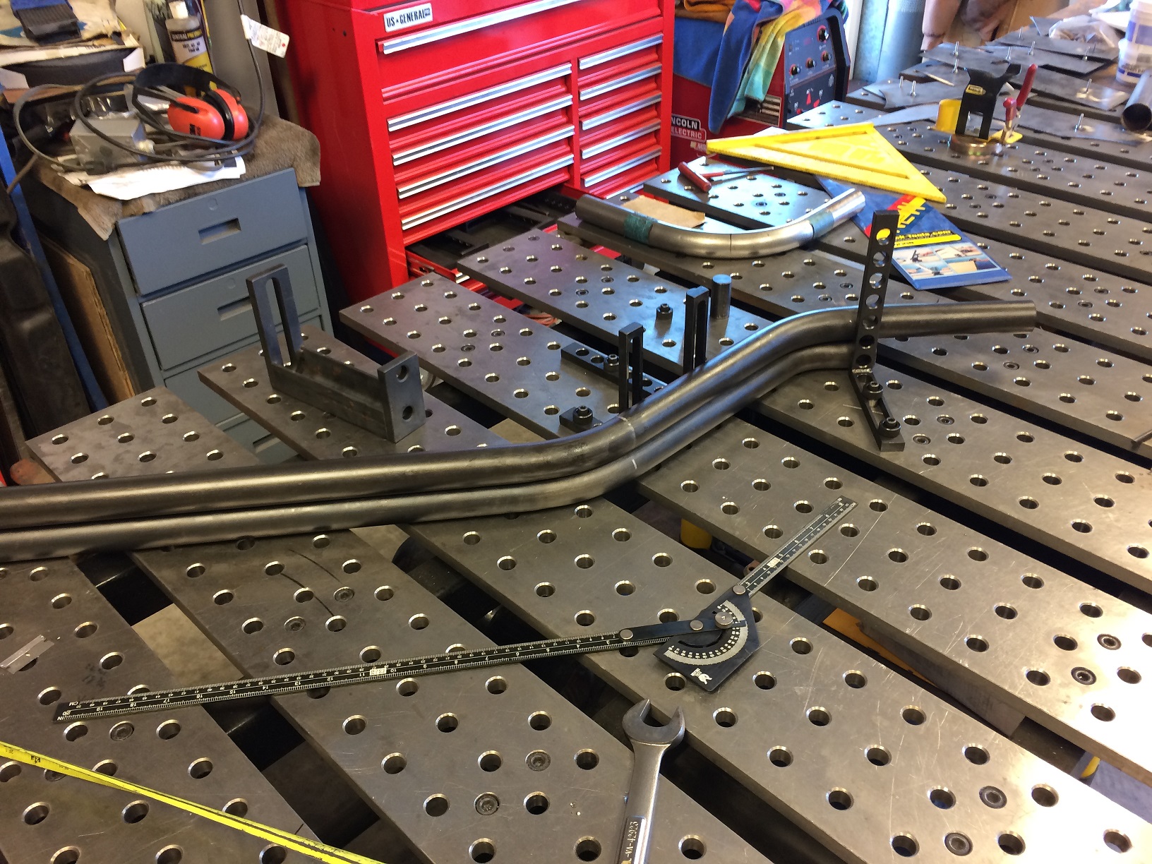

Decision made! I'm going with the one piece door bar.
So, time to bend up the final pieces. Here's the mighty, mighty bender. It's a beast.
tygaboy
post Jul 29 2017, 06:02 PM
Post #490
Posts: 5,818
Joined: 6-October 15
From: Petaluma, CA
Member No.: 19,241

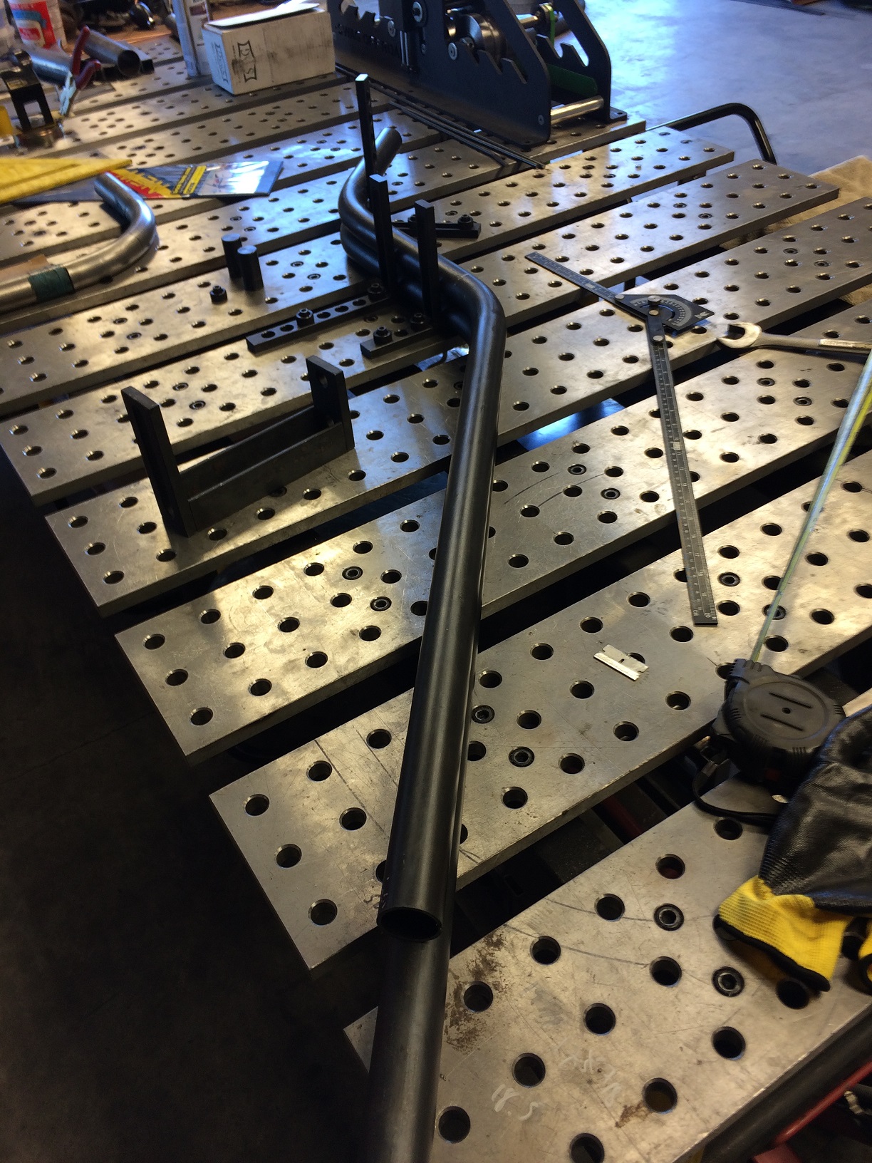

Gettin' jiggy wi't it! (See what I did there?)
Got the first one done and then it's time to make an exact match. Well, as exact as I can get it... but the fixturing table is like cheating. It makes things like this so much simpler.
First bend and so far, so good!
tygaboy
post Jul 29 2017, 06:06 PM
Post #491
Posts: 5,818
From: Petaluma, CA
Member No.: 19,241

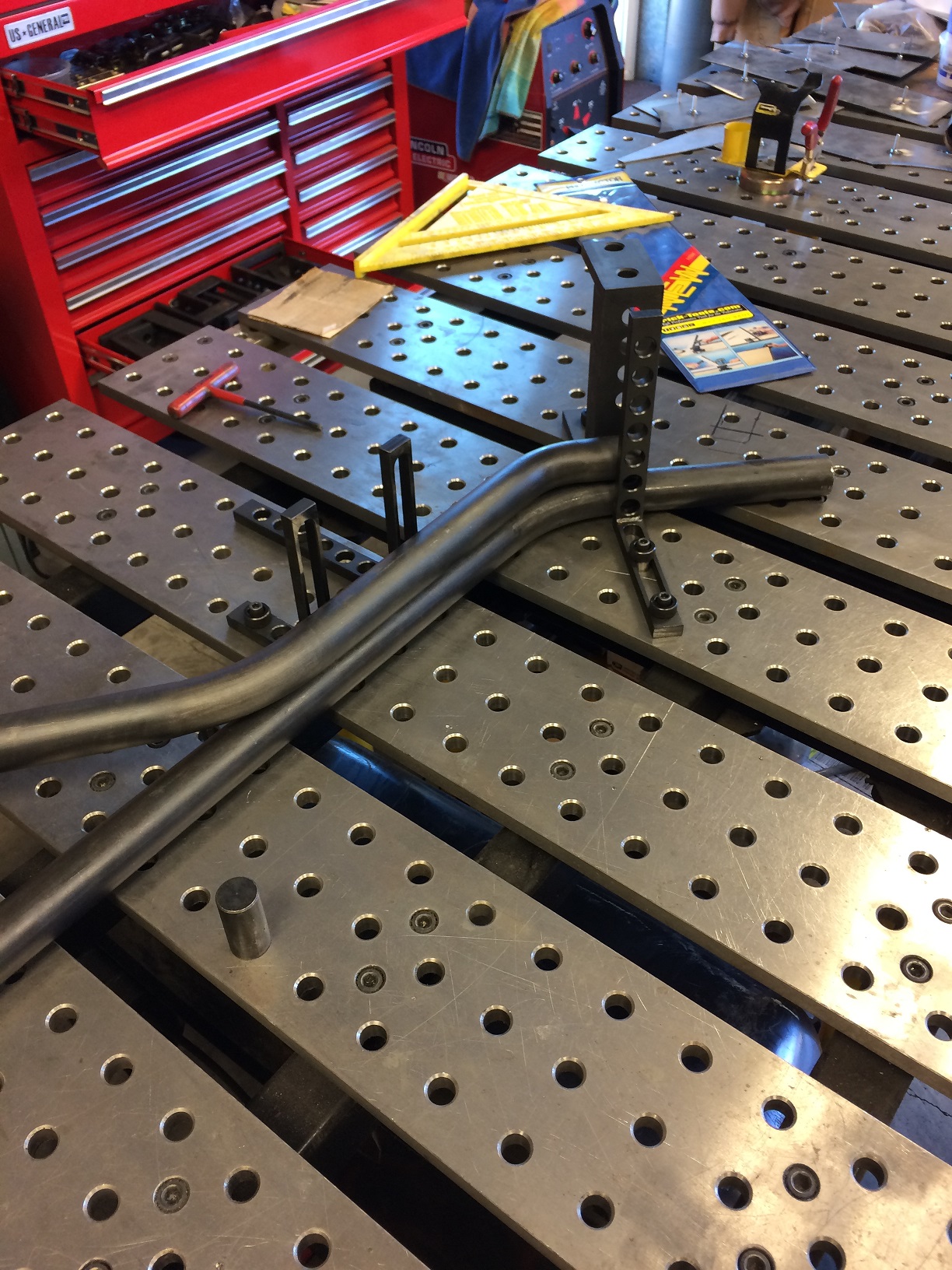

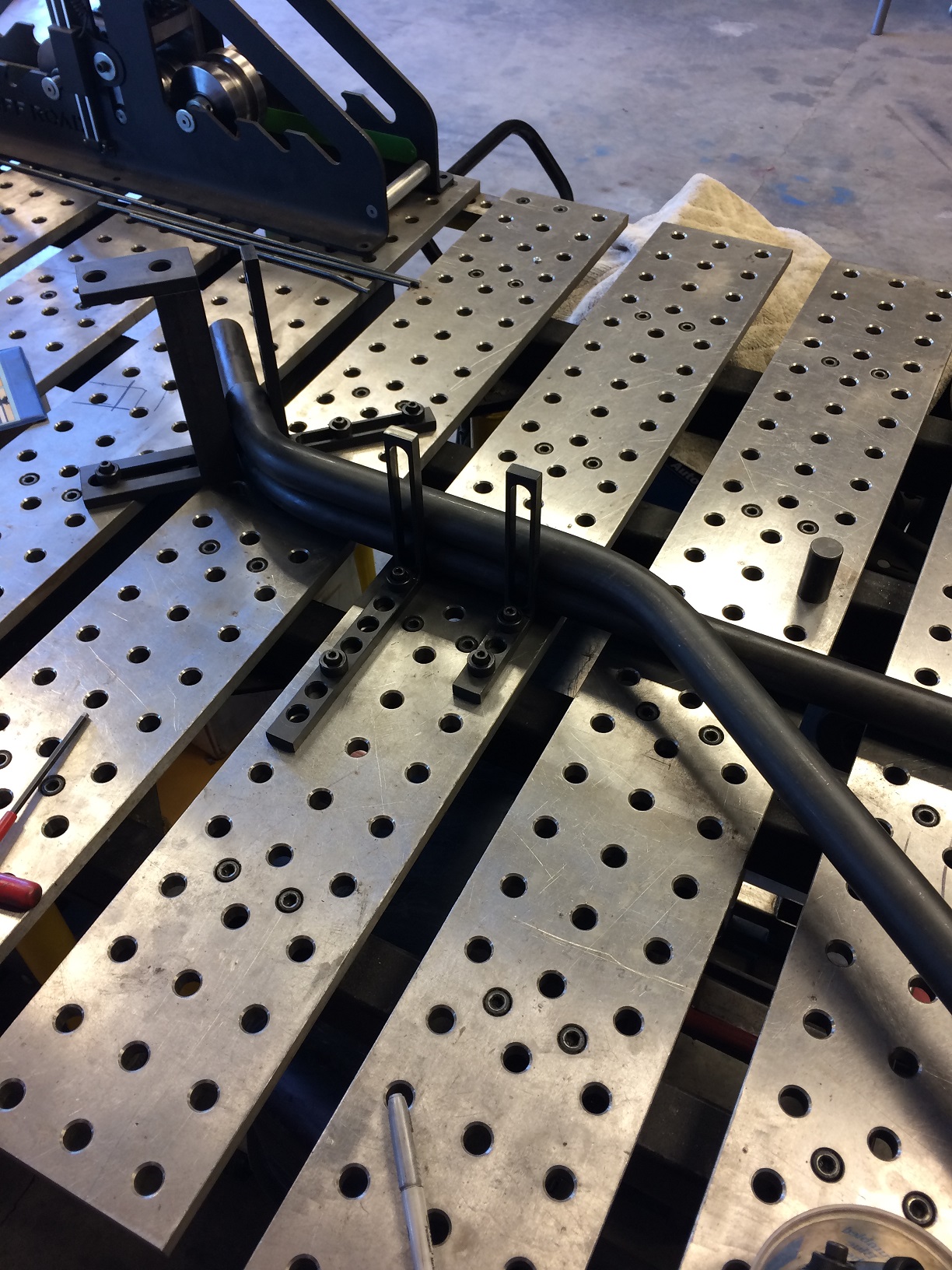

Next bend. I end up sneaking up on it. There are marks on the ram assembly that I use to measure how far it's extended. I check the bend as it's bending by holding the big protractor over it and eyeball it 'til it looks close. (This bender doesn't have a degree gauge on it.)
Then I pull the bar and check it in the jig. If I need more angle, I put it back in the bender, extend the ram to the previous measurement and give it just a bit more!
Here's the result after three rounds of the ol' "in and out".
Yea! Nailed it... (IMG:style_emoticons/default/cheer.gif)

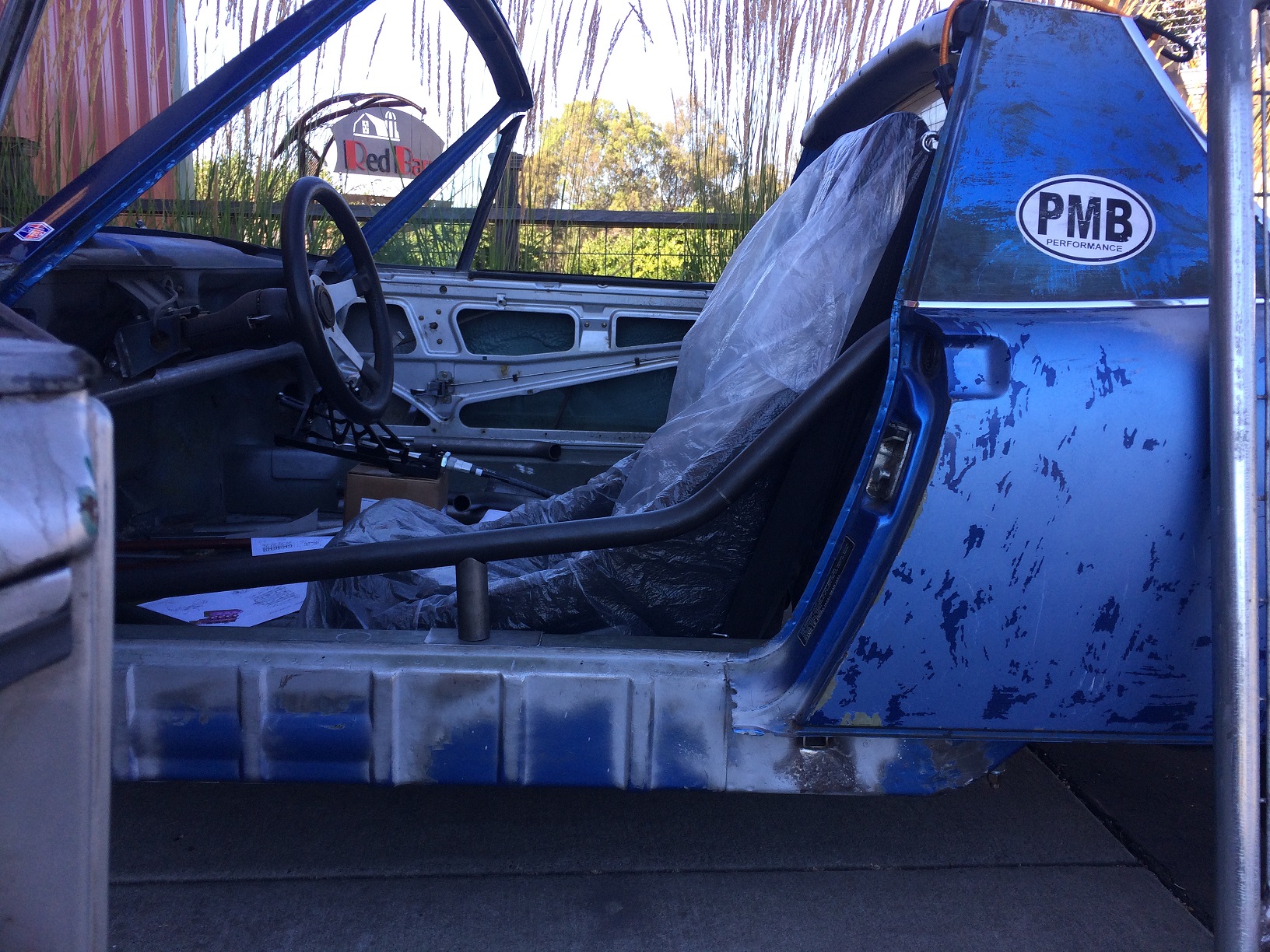

Mock up.
I really like this. The angle is nicely aligned with the seat back and when I'm in the seat, it turns out the bar is an awesome arm rest!

And credit where credit is due:
Tony - thanks for suggesting I mock up the bar with the down angle! (IMG:style_emoticons/default/pray.gif)

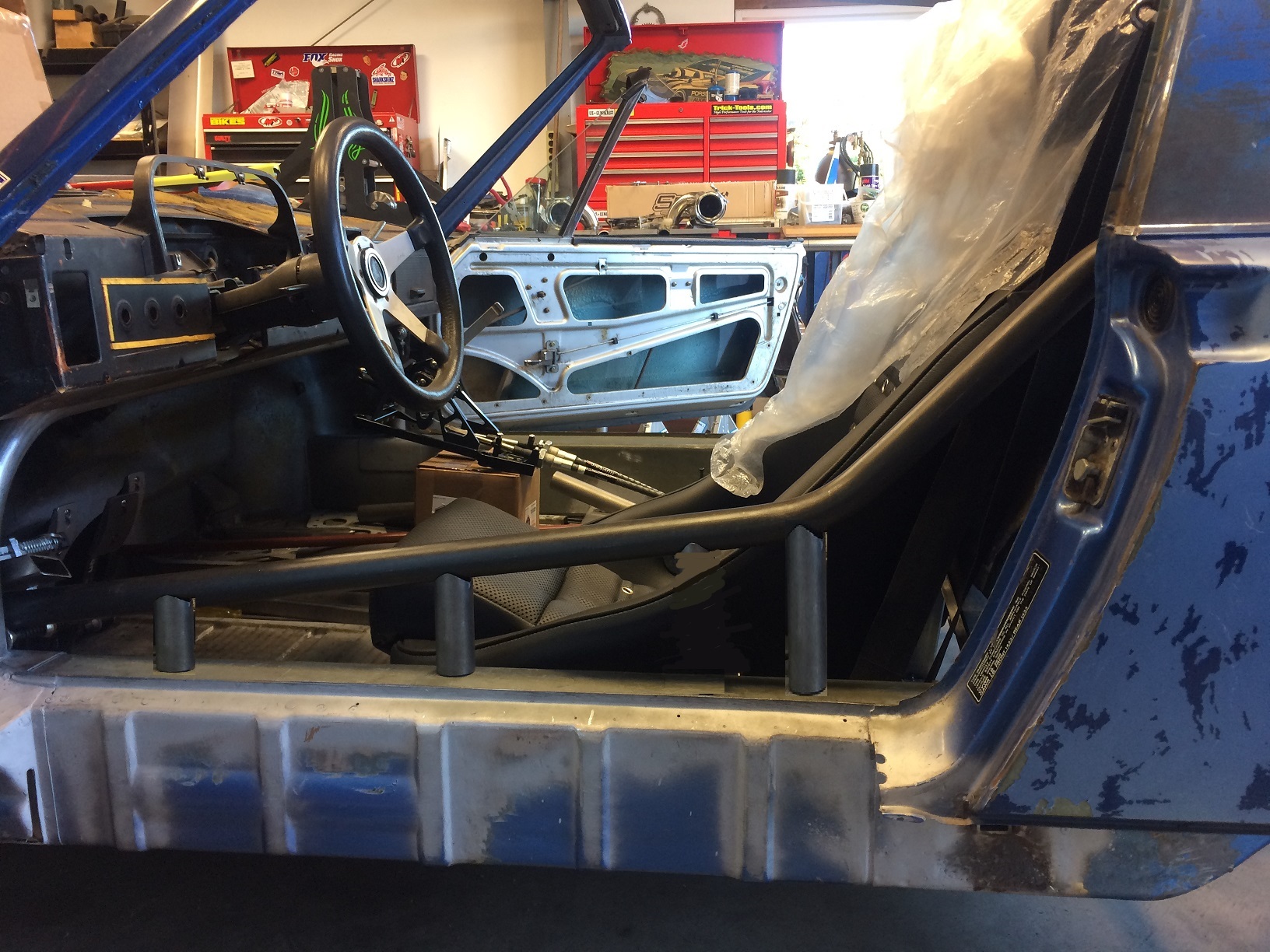

Shall I pack your chute with a pound of feathers or a pound of lead? I didn't mean recklessly, dorkwads. (IMG:style_emoticons/default/poke.gif) (IMG:style_emoticons/default/tongue.gif) Surely you push your car enough to start losing grip (in a safe place to do so) to know where the edge is, then find ways to tweak and make it faster. Don't you? Well, Tony might not, and Rudy's isn't on the road yet. (Teasing you Rudy... Gotta give it back a little ya know. Can't wait to see your cool beast driving!!)
The down angle is perfect! One more short tube from the lower elbow to the long in front of the firewall, BAM. Might even eliminate the need for the short vert piece in the middle.
Beautiful work, Chris.

Rand -
Thanks for the continued kind words and encouragement. I'm a believer in the whole "nature abhors even numbers" thing so the plan is for three verts.
Just looks more balanced to me... But I'll play around with it as final fitting happens.
(oooh, maybe no verts and just a panel of dimple died holes... (IMG:style_emoticons/default/laugh.gif) )

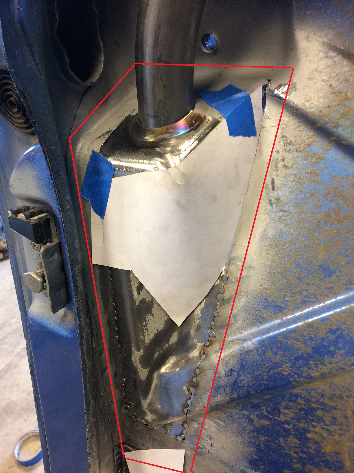

A little help, please? With the change in plan for the main hoop, I need to patch the firewall. Rather than jump in and fab something I thought I'd first check to see if I could find some factory metal:
Anyone have a suitable donor car and the willingness to slice out this chunk? I need the same part for both sides
PM me if you can help. I need to complete this before I can install the door bars and I REALLY want to install the door bars so I'm a motivated buyer...
(IMG:style_emoticons/default/wub.gif) the beast.
