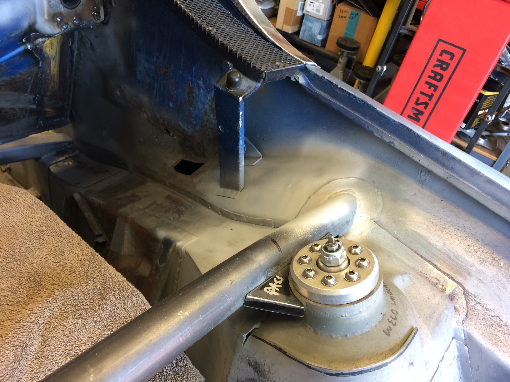

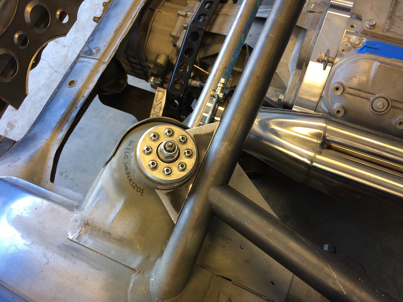

Shocking news! Nearly impossible to believe: I changed my mind about the way I'm going to tie the cross bar into the suspension towers. I was going to construct a box around the whole area but upon reflection (and thinking about the earlier points about weight and complexity), I'm opting for something simple:
A tidy little gusset between the tower and cross bar, right in line with the main load path into the bar that runs to the fire wall.
I'm almost done with the fabrication and fitting of all the pieces needed for the chassis stiffening. Then it'll be a full day (or more) of welding to complete the install.
Much as I enjoy the roll bar fab stuff, I'm ready to move on a different area of the build.

I like it! That area really doesnt move near as much as some people think.
The lower trailing arm pickup moves significantly more.

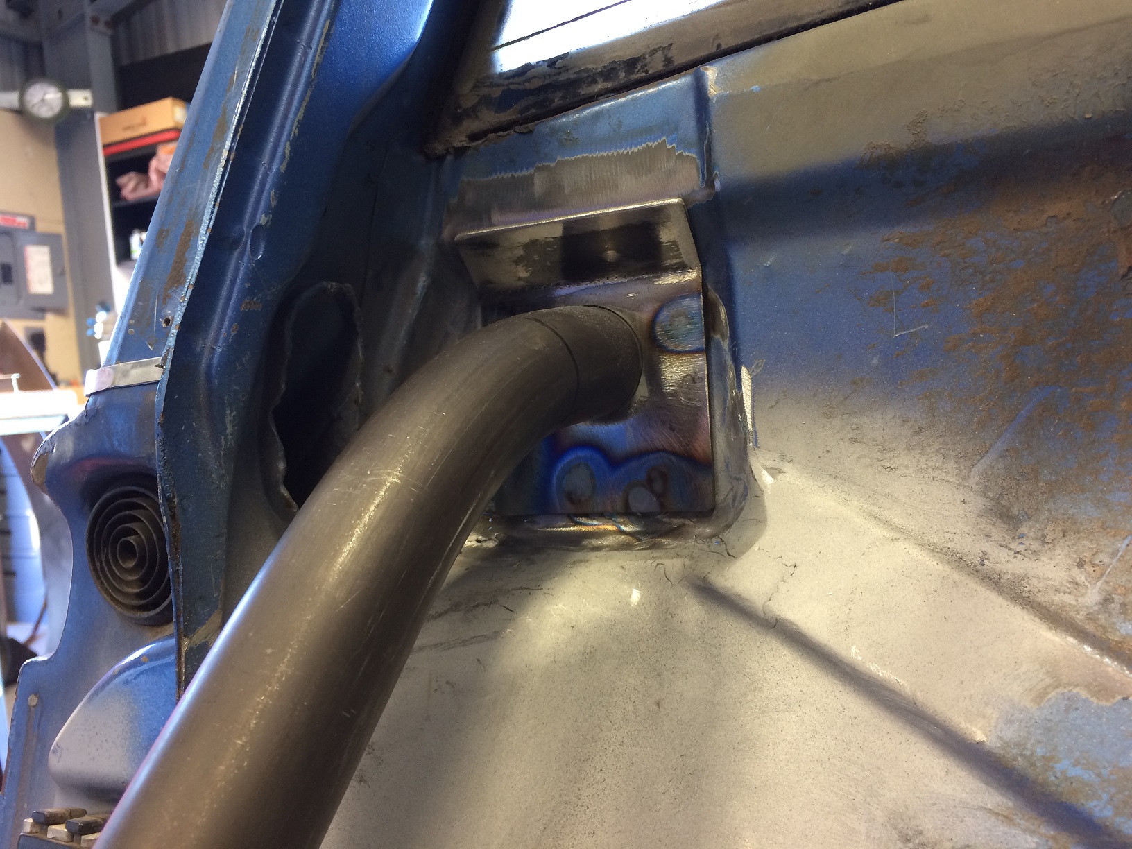

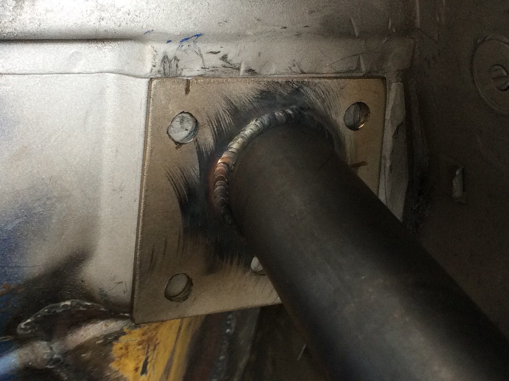

Final fitting of the passenger side door bar. I welded in the inside plate as I need to firmly fix the bar so I can get a repeatable location as I fit the verticals.
tygaboy
post Aug 27 2017, 02:41 PM
Post #565
Posts: 5,818
Joined: 6-October 15
From: Petaluma, CA
Member No.: 19,241

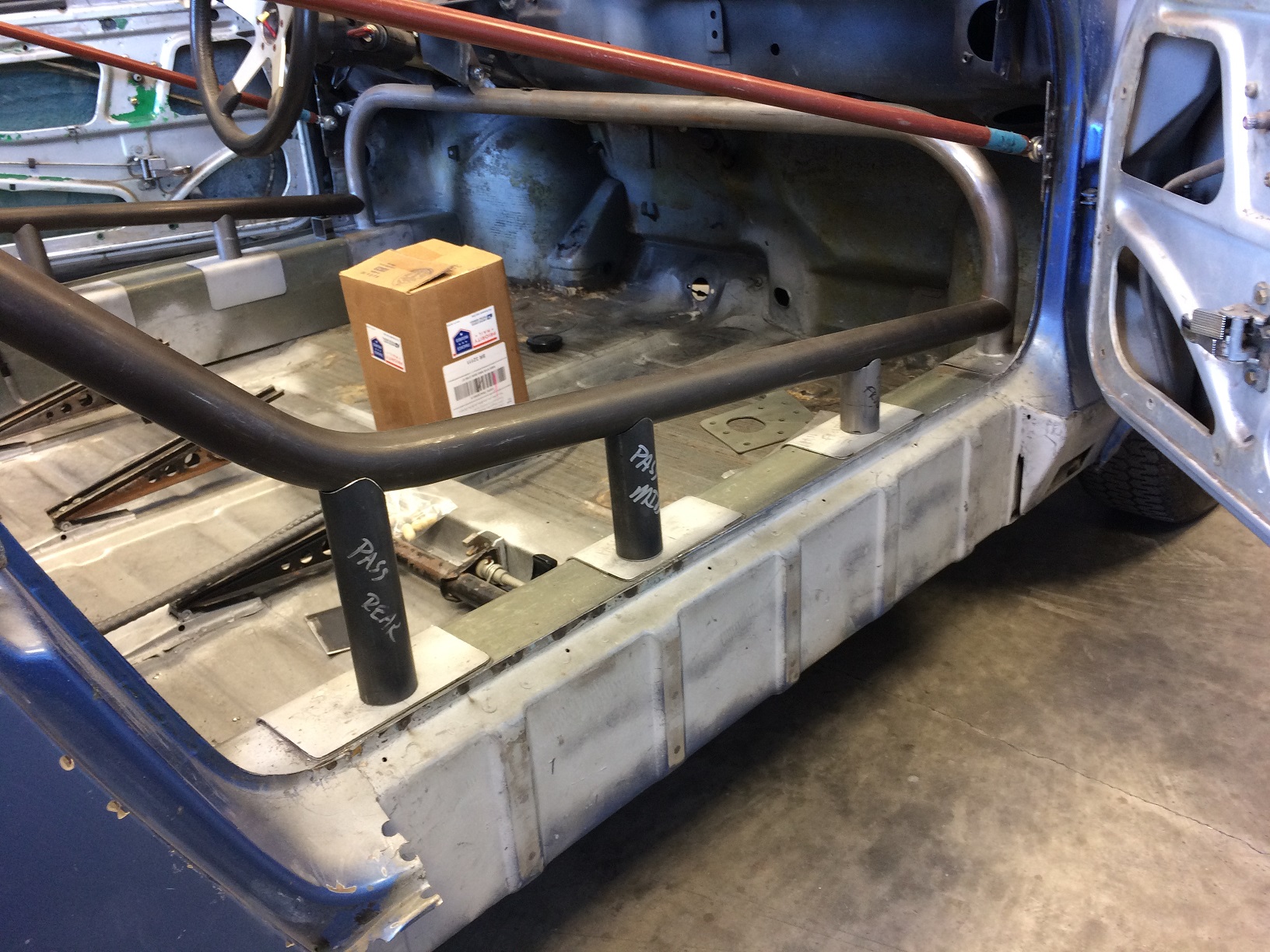

Fore and aft verticals are trimmed to final size.
You can see that the mid vertical is sitting back, out of positon (the pad is positioned properly). I'm leaving the mid vertical trimming until the door bar is welded in. Why?
Having only two verticals will allow the bar to set into position and if the there's any welding distortion on the door bar (and I'd expect there to be some) I can tweak the mid vertical for the best possible fit.
We'll see how it goes as the welding actually commences.

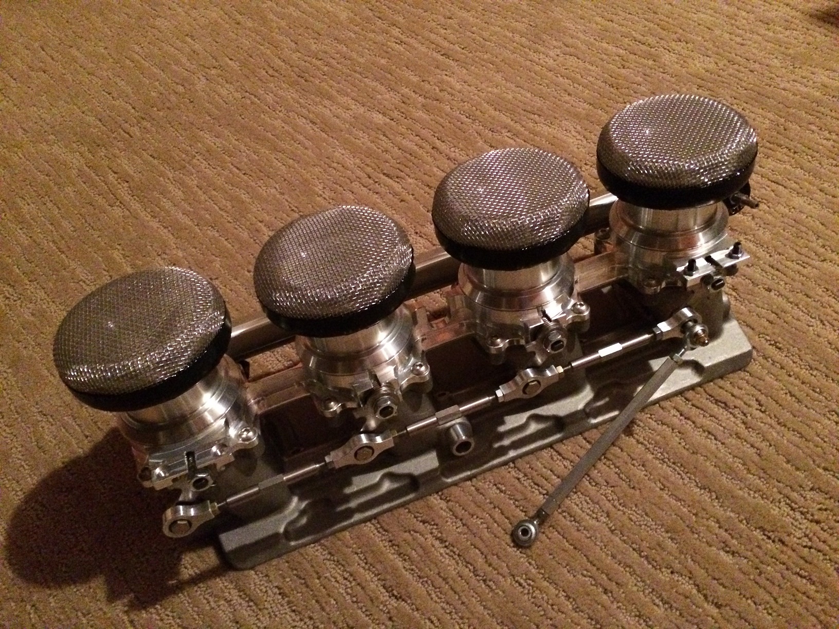

Bill B Racing (BBR Filers) filters showed up today. Recommended by Borla and apparently minimal HP loss. They certainly look the business and fit perfectly.
Not as cool looking sitting on my office floor vs on the engine, but I want to keep the delicate stuff safe while all the fab work is going on.

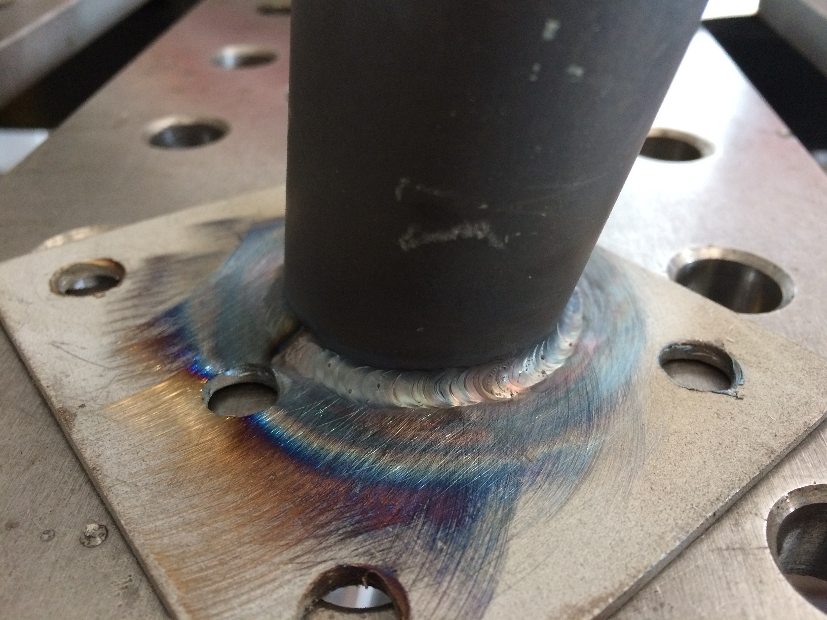

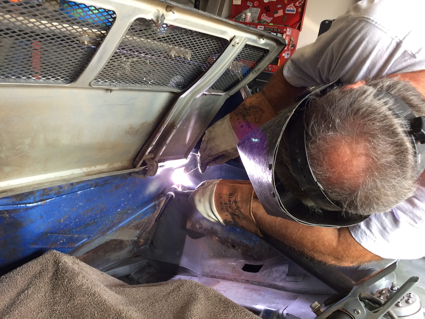

Well, as usual, things take longer than I imagine they will. I'd hoped to get the chassis stiffening done today. Didn't quite make it but made BIG progress.
Final fit all but the front hoop-to-front suspension tubes, all tubes tacked in and a couple items final welded.
MAJOR MILESTONE! I'm feeling really good as it comes together.
It would be all but impossible to get all the way around some of these tubes. So after dry fitting the rear suspension-to-firewall bars and support plate, the bar/support plate were tack welded while everything was in position.
tygaboy
post Sep 1 2017, 09:21 PM
Post #578
Posts: 5,818
From: Petaluma, CA
Member No.: 19,241
Then the bar/support plate is welded on the bench.
Beautiful! (IMG:style_emoticons/default/welder.gif) (IMG:style_emoticons/default/wub.gif) (IMG:style_emoticons/default/pray.gif) (IMG:style_emoticons/default/smilie_pokal.gif)

Then it was on to fitting and tacking the door bars.

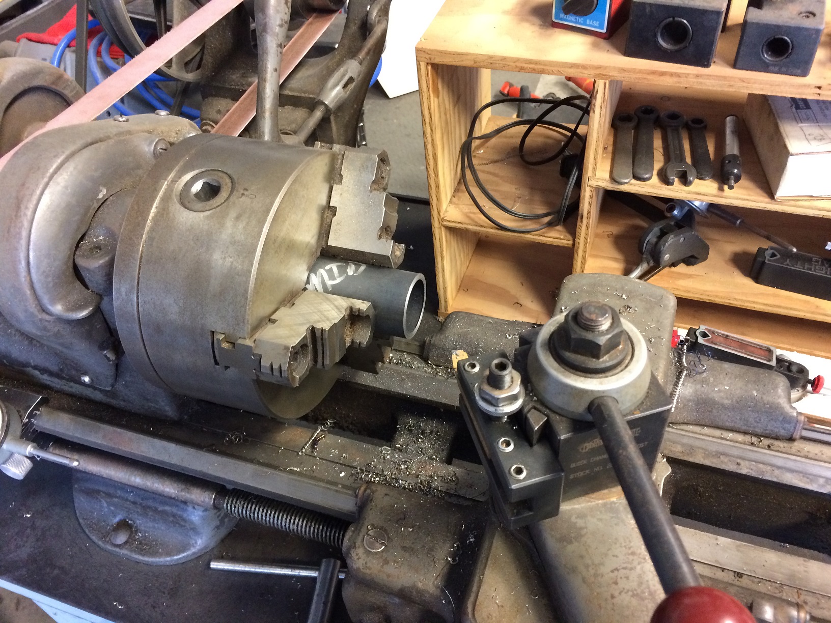

First, all measurements were triple checked then the vertical's support pads were rosette welded to the longs.
I got to use my new-to-me South Bend lathe to final fit and square up the verticals.
