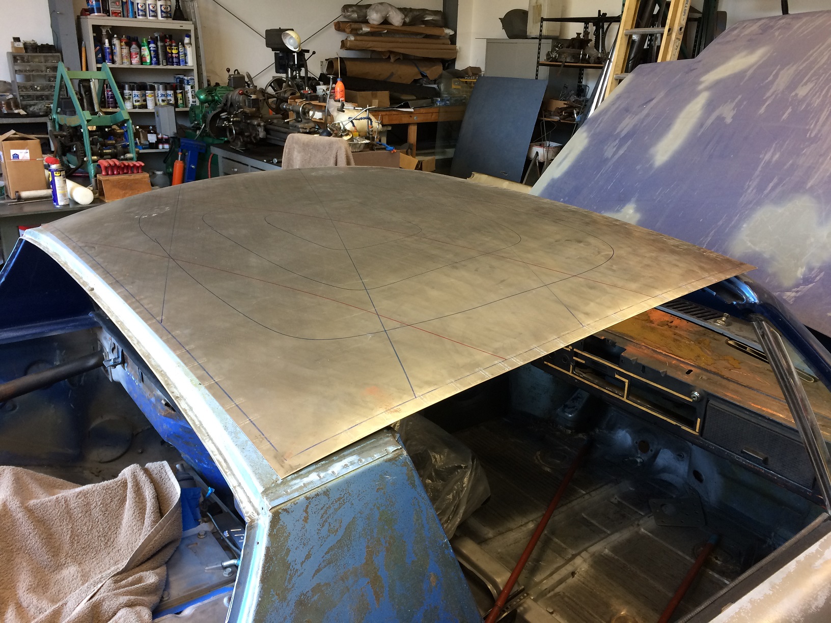

What's going on here...? (IMG:style_emoticons/default/idea.gif)

Oh boy now you are going to make me want to do that. Maybe as i finish up my welding on my car this will be the next project.
You using 20ga? Or 18?

Hold on now Chris...I thought you were trying to get the car on the ROAD? You just can't help yourself...a different take on ADD!

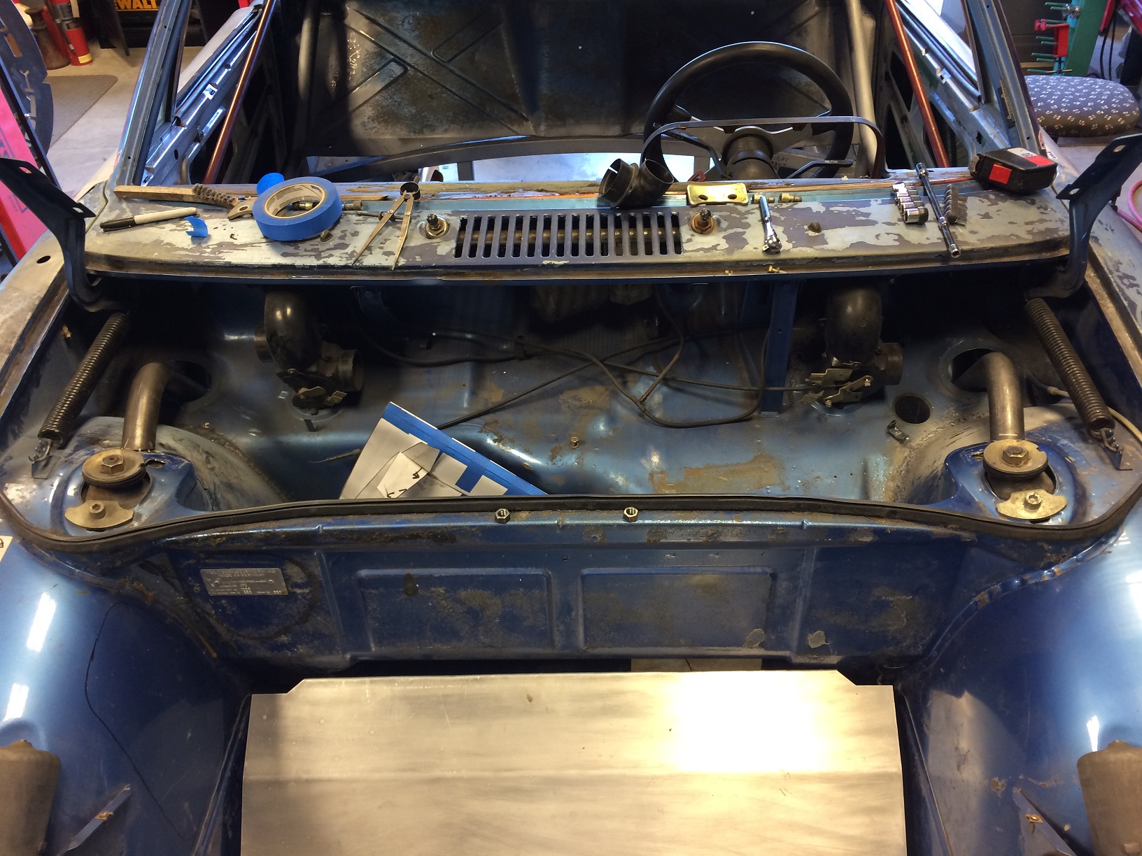

The Dirty Dingo LS low mount A/C kit fits! Using the mini compressor seems like the way to go, given everything else that's happening down there.
The mock up shows no interference, but I do have to get my shift cables thorough there somehow... (IMG:style_emoticons/default/idea.gif)
And I may decide to move the passenger side firewall upright.

QUOTE(mb911 @ Sep 17 2017, 01:56 PM) *
Ben -
To be honest, that "top" is a practice piece and is actually a 33/34 Ford door skin!
I tossed it up there just to see. But I do now plan to do a steel roof. Having had two skin cancer surgeries on my face has me knowing I'd never have the top off anyway. Plus, it'll be a fun and challenging project.
I plan to use 18ga and have already acquired the materials. I also plan to either clip off the flange that runs around the back of the targa bar or fab steel parts and weld them in to keep the stock dimensions. But either way, I'm losing the stainless trim.
A few folks have done the "cut it off the flange" approach - I was able to see it in person on Krieger's (Andy) car - and I think the "no stainless trim" is just the right look for my RaceRod.
I have lots of planning before I do anything but I'll be sure to post all details and pics.

QUOTE(Cracker @ Sep 17 2017, 02:01 PM) *
Tony
Tony - The good news about this is that it won't prevent me getting the car on the road. And don't worry, I'm staying focused on completing the chassis stiffening then getting it off to media blasting.
In fact, with all my main clearance concerns addresses, today I pulled the drive train in prep for all the final welding and installation of the Tangerine trailing arm "raise 'em up" kit.
I hardly thought about the roof at all! (IMG:style_emoticons/default/poke.gif) (IMG:style_emoticons/default/biggrin.gif)

QUOTE(tygaboy @ Sep 17 2017, 01:22 PM) *
Making me jealous!!!
I think thats an awesome way to go.

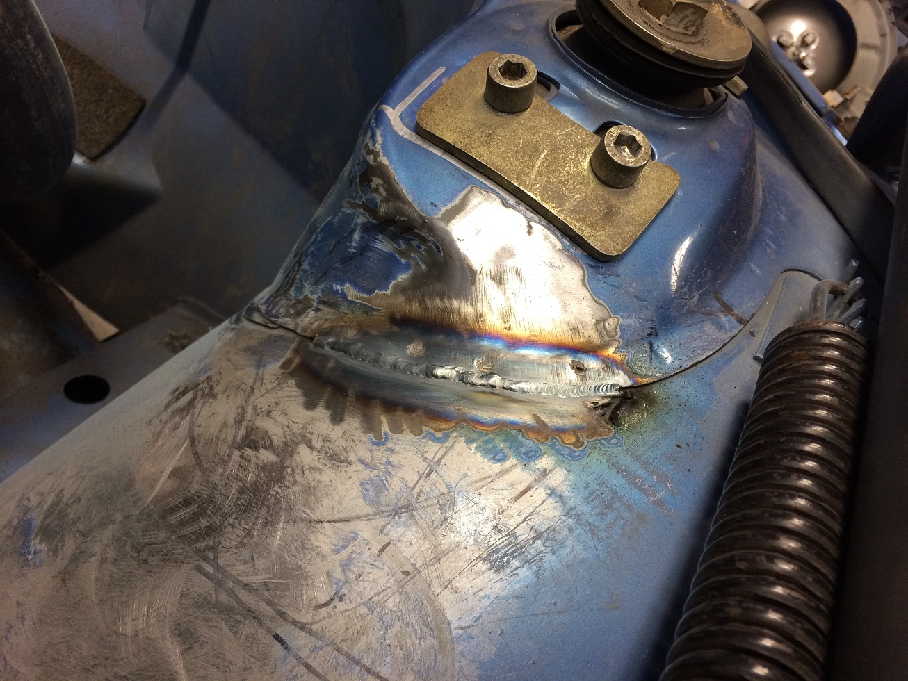

And now for something completely different: I'm working on the front of my car!
Spent a good part of today doing the final bending, notching and fitting of the front hoop-to-front suspension chassis bars.
These were tough to fit. A pretty steep angle coming off the front hoop then the bend had to be just right to land it on target. LOTS of fiddling to get them right.
Here's a pic of the first bit of seam welding, prior to tacking in the bar passenger side bar. More will be done. This was just to avoid having to weld under the bar, once it's in.

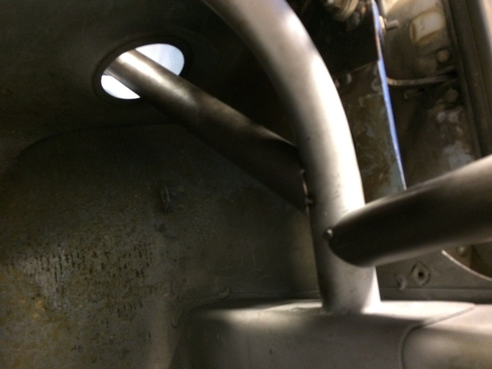

One side tacked in. And before you climb all over me for not putting pads down first, this isn't a safety cage, it's for chassis stiffening. There's a fair bit of structure in that tower so for my purposes, I'm good with this approach. I'm also looking at adding some gusseting.

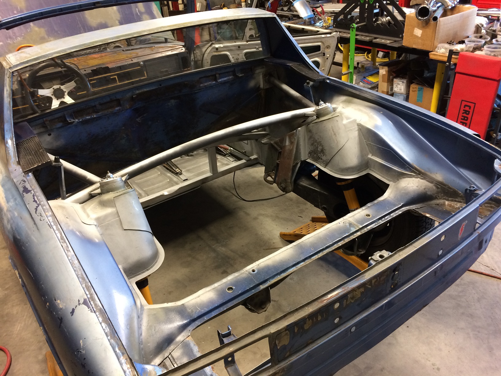

Tubular!

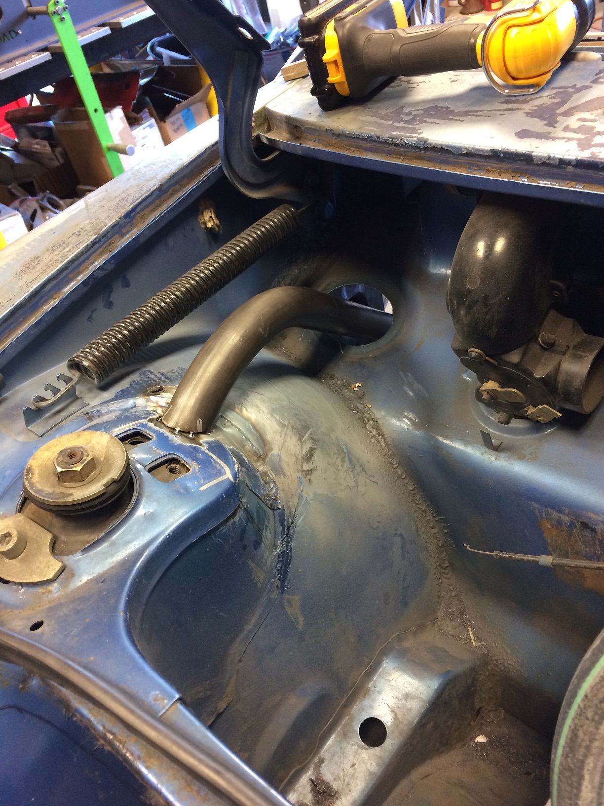

Upskirt... (IMG:style_emoticons/default/laugh.gif)
