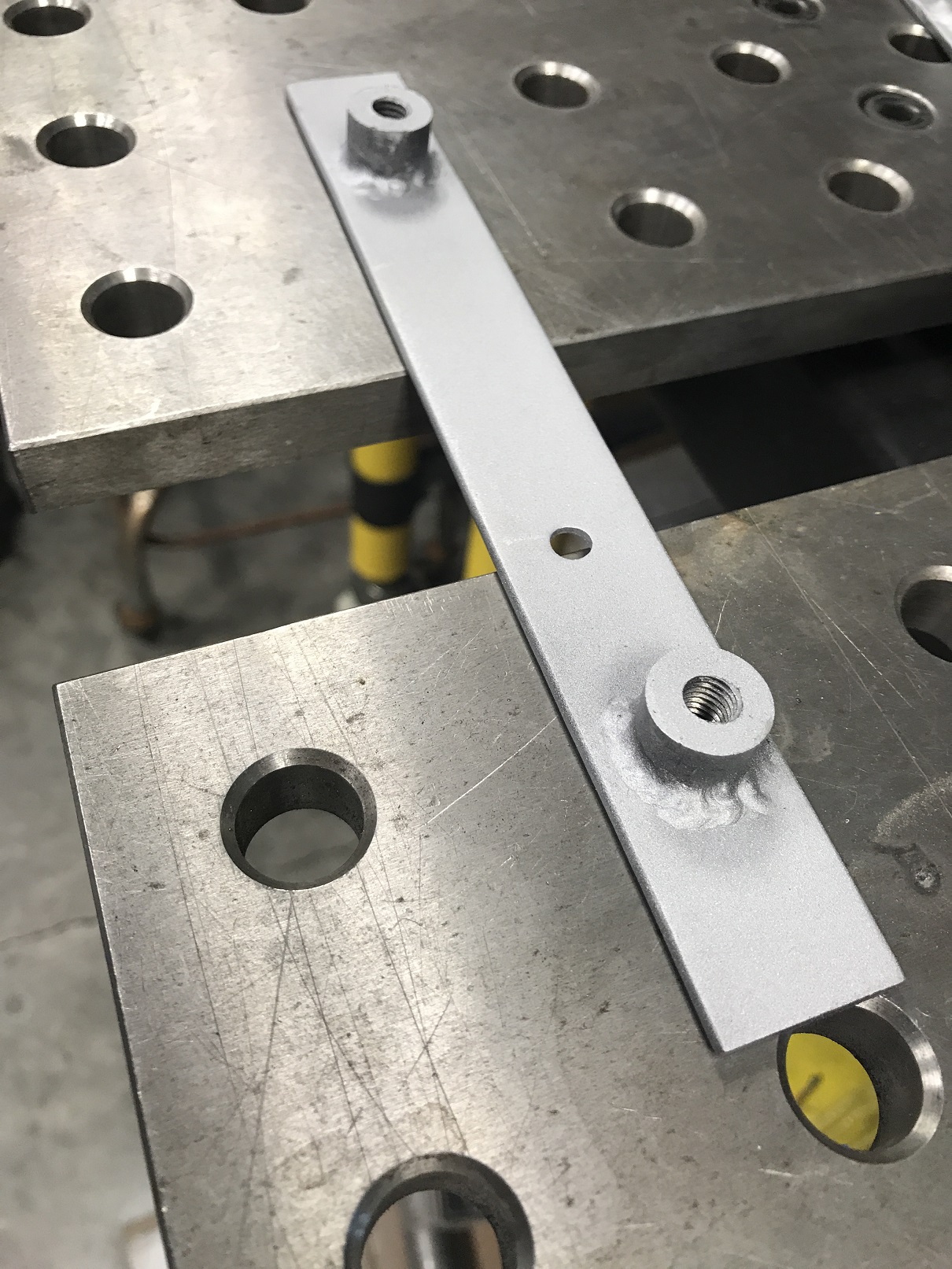

I'm trying to sneak in an hour here and there to keep things moving along during the week. So this evening, I was able to get the flip trunk bosses cut down and welded to the reinforcement plates. Boring, yes. But it's all gotta be done.

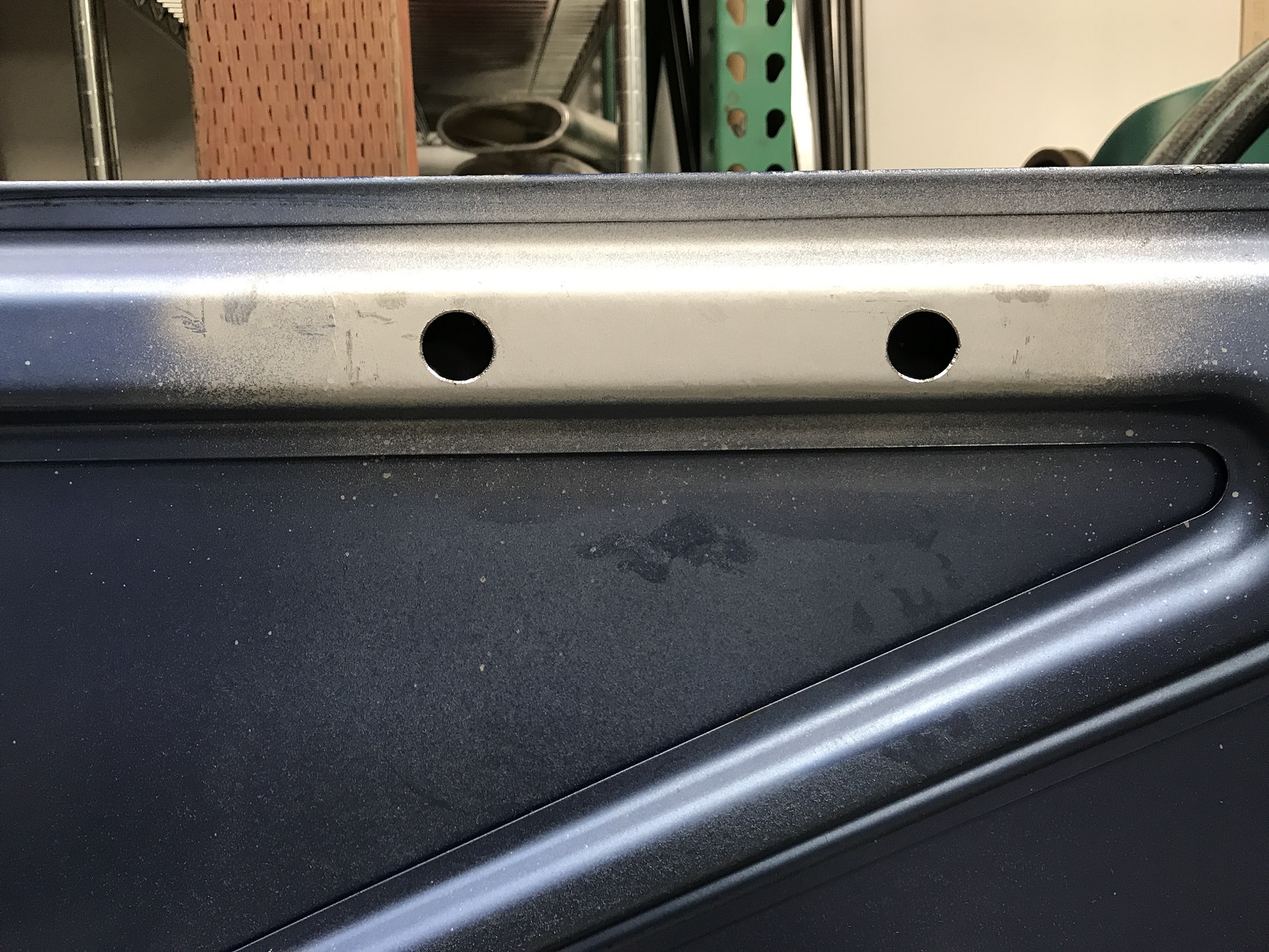

Final steps in the flip trunk.
First, figure out the location of the threaded bosses and drill for clearance.
post Nov 4 2017, 10:44 AM
Post #751
Posts: 5,818

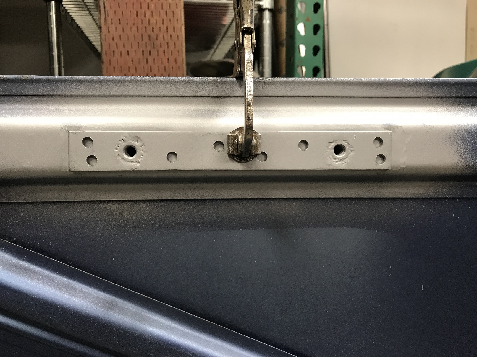

I removed all the paint under the stiffener plate and sprayed weld-through primer on the trunk lid and back side of the stiffener.
Then clamp for location. Very light clamping pressure, please!

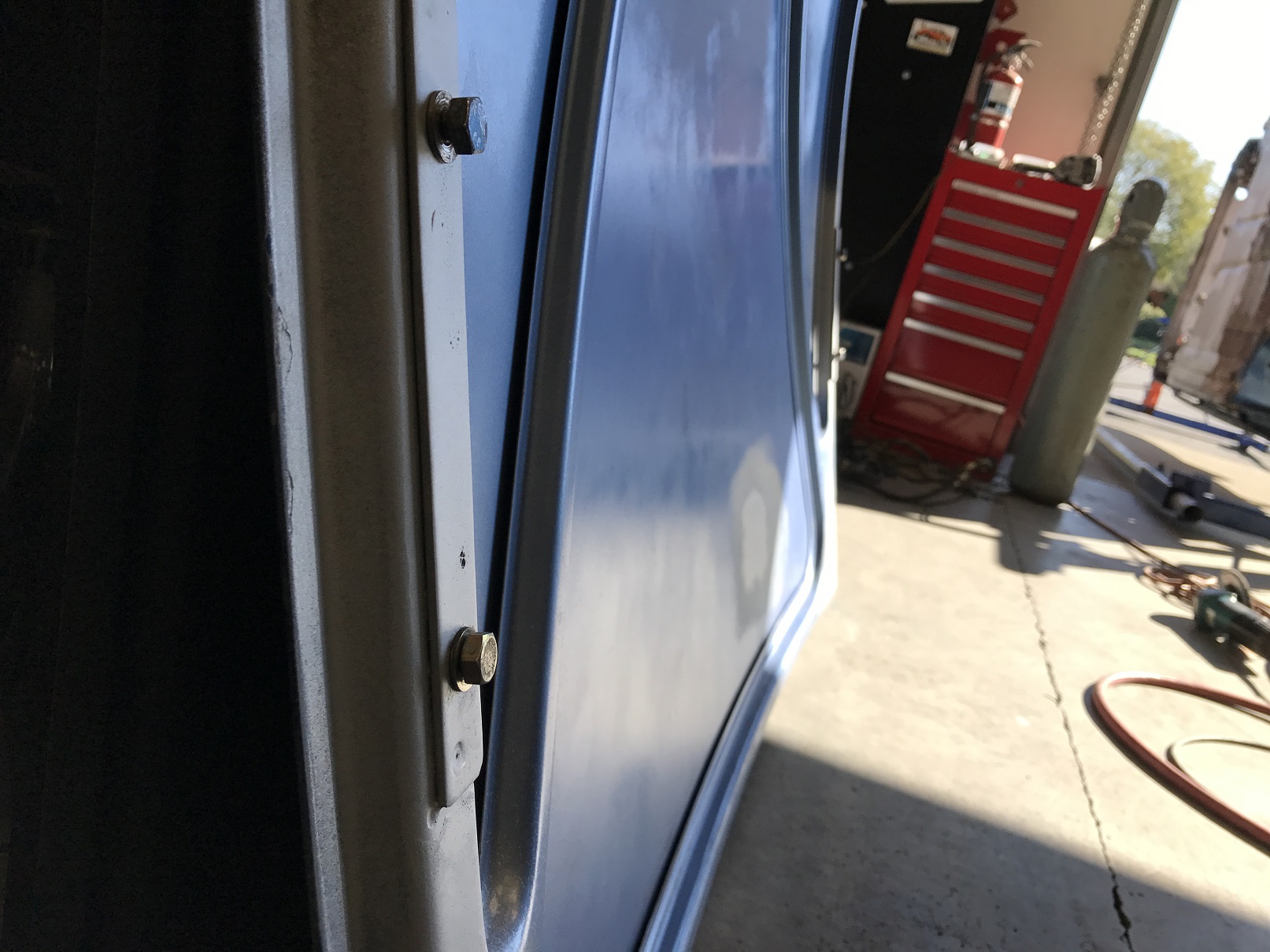

Finished welding the support pads to the trunk.

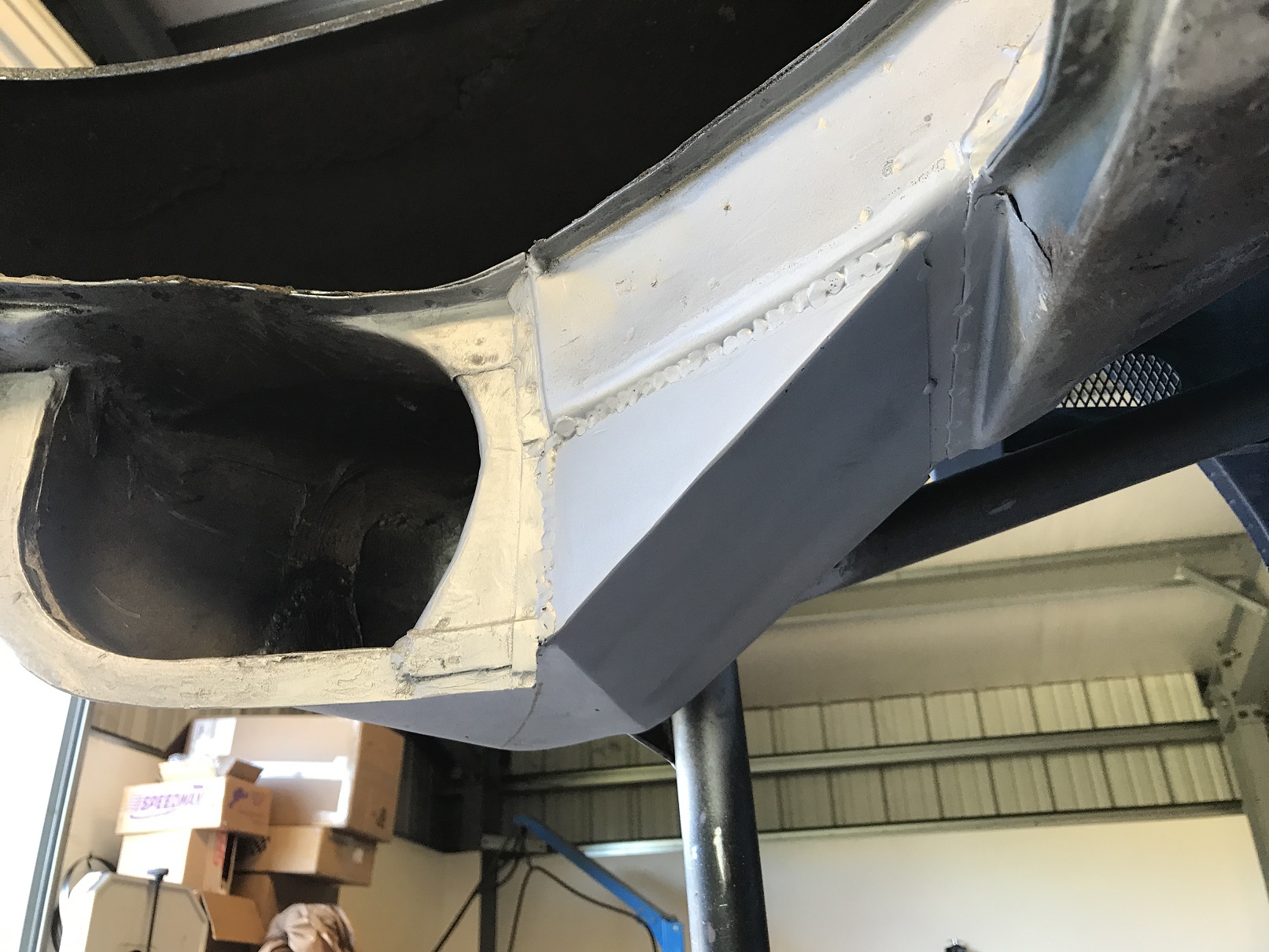

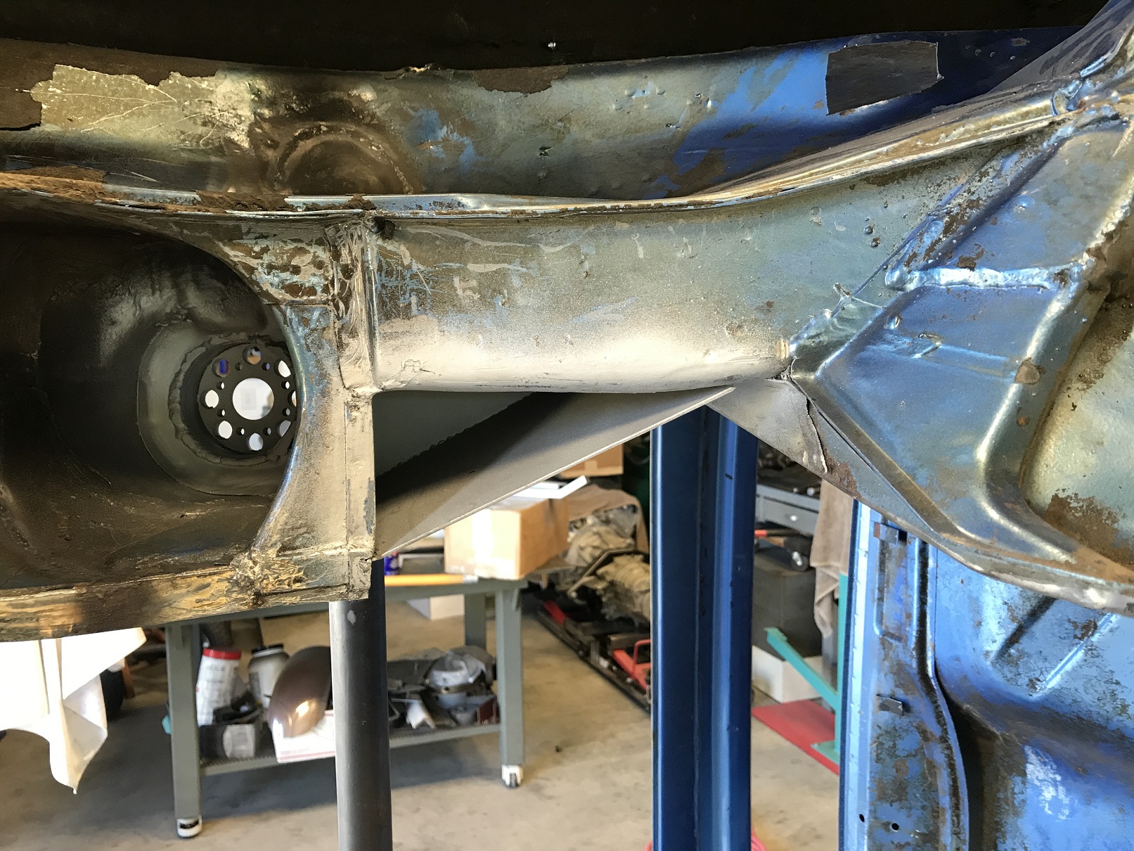

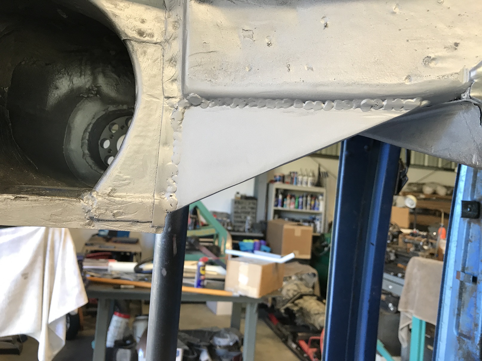

Then I started on closing up the underside of the rear suspension tower stiffener I added way back when. Here're the before and afters.

Then I trimmed and seam welded the top side of the passenger rear suspension tower stiffening panel. The driver side is on the schedule for the next shop session.
I also got the passenger side front bumper brace welded in. As a BUB car, my chassis didn't have them. I salvaged the pieces from the '72 parts car.

QUOTE(tygaboy @ Nov 4 2017, 09:44 AM) *
(IMG:http://www.914world.com/bbs2/uploads/post-19241-1509813842_thumb.jpg)
Chris, this looks like a simple solution for mounting the alternate hinging hardware. I was thinking along the same lines for what I'm doing with Mini Cooper hinges.
Project is looking great. Keep at it.

QUOTE(tygaboy @ Nov 5 2017, 03:23 PM) *
Yours stiffeners are prettier than mine... (IMG:style_emoticons/default/sad.gif)
