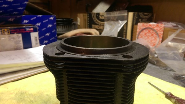

Mueller   Picture "borrowed" from brand new post o...   Oct 27 2016, 09:36 AM
Dave_Darling   Picture "borrowed" from brand new post ...   Oct 27 2016, 05:15 PM

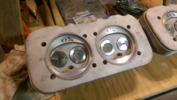

Mark Henry   My personal engine, 102mm X 78mm, nickies with JE ...   Oct 28 2016, 12:49 AM
KeithVonLaws   My personal engine, 102mm X 78mm, nickies with JE...   Oct 28 2016, 02:23 AM
Mark Henry   "nothing really trick" of the four engi...   Oct 28 2016, 07:48 AM
Mark Henry   Some head work I posted way back when this site st...   Oct 28 2016, 01:23 AM
injunmort   "nothing really trick" of the four engin...   Oct 28 2016, 04:40 AM
