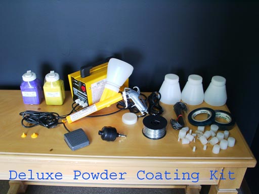

I'm about 3 hours into my first powdercoating adventure. Man, this stuff rocks. Again, Ginter is right. If you have a garage, and don't have your own setup - you might want to rethink that.
My setup from Columbia Coating, including about 8 pounds of various metallics/clears was about 200 bucks. Pam picked up some extra natural corks (because she saw it on American Chopper). They seem to work as well as the synthetic/plastic corks for plugging bolt holes.

My source for powdercoating is:
Columbia Coatings
Their website needs some professional help, but the product is good. If you check the Online Store for the Chicago Electric powder kit, it's the best deal. $135.00.
It comes with powder, PC masking tape (the good green stuff), plugs of various sizes and hooks.

Rusty,
wha's the electro-gizmo thingy for in that setup? what is the procedure (readers' digest style)?
