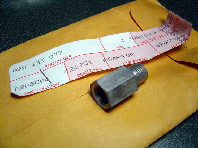

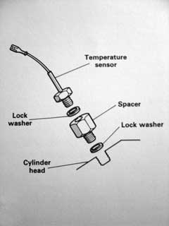

I want to cover all my bases here. I have purchased the new GB CHT sensor from 914Rubber to try.
So, I think I will buy a spacer from Brad Mayeur to have the option. From what he says it should:
"Porsche 914/4 Cylinder Head Temperature Sensor Extension.
This little device slows down the heating of the sensor and improves warm up drivability.
I do have "warm up drivability" problems = Low idle RPM until the VDO CHT hits about 250*F. So it seems like my problems don't need the warm up to slow down, it needs to SPEED UP. (IMG:style_emoticons/default/WTF.gif)
914LTD.com
Also found on RATWELL (scroll down to WORKAROUNDS)http://www.ratwell.com/technical/TempSensorII.html#parts

bretth   If I understand it correctly it is meant to keep t...   Oct 25 2016, 09:22 AM
Mikey914   Exactly. I have one also and may reproduce these.   Oct 25 2016, 09:26 AM
BeatNavy   I do have "warm up drivability" problem...   Oct 25 2016, 09:28 AM

BeatNavy   It doesn't slow down the engine warming. It s...   Oct 25 2016, 09:45 AM
pbanders   OK, I have one of these and have been using it for...   Oct 25 2016, 04:19 PM
malcolm2   From this and other research it seems that I may j...   Oct 25 2016, 06:52 PM
