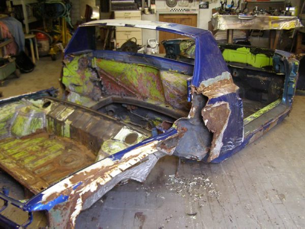

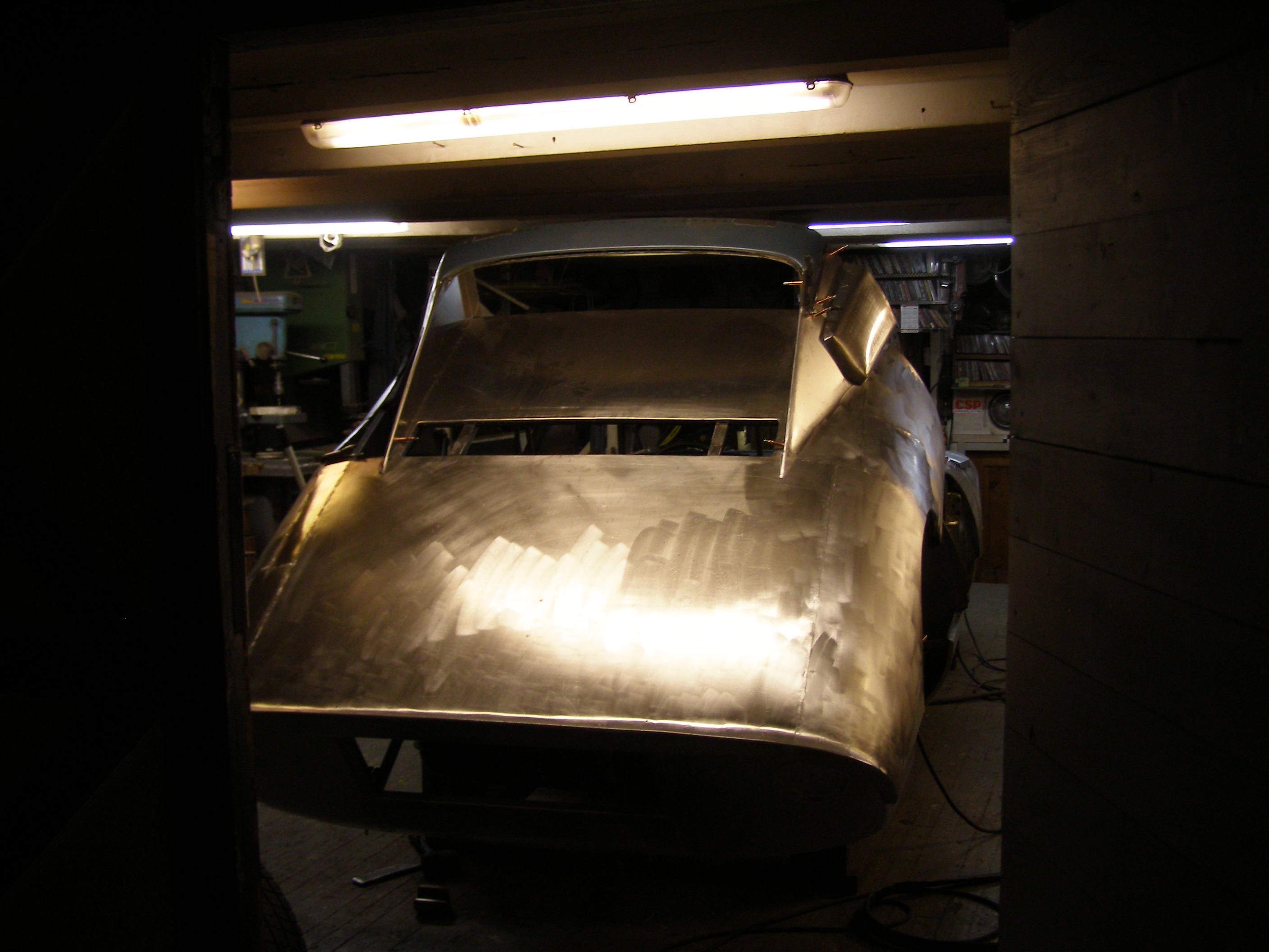

Hi everybody from Norway.I'm starting a new project here as I found the remains of a 914 for 300 usd.It was cut into three parts to make it easier to bring it to the scrap yard.I lost my job,so I have plenty of time and less money.
This car has nearly nothing left of the outside body panels,so I feel free to make some fun out of it.There is very much structural rust to fix first and thanks to Brians Machine Service I have a 911 roof I want to weld on top of the 914 chassis.
This is a long term project I want to shear with you.I have a plan....
Lets put on some good music in the workshop and start up the welding machine.

fordb132   I found a few more pics of my 914 for you.Thi...   Nov 14 2016, 03:04 PM

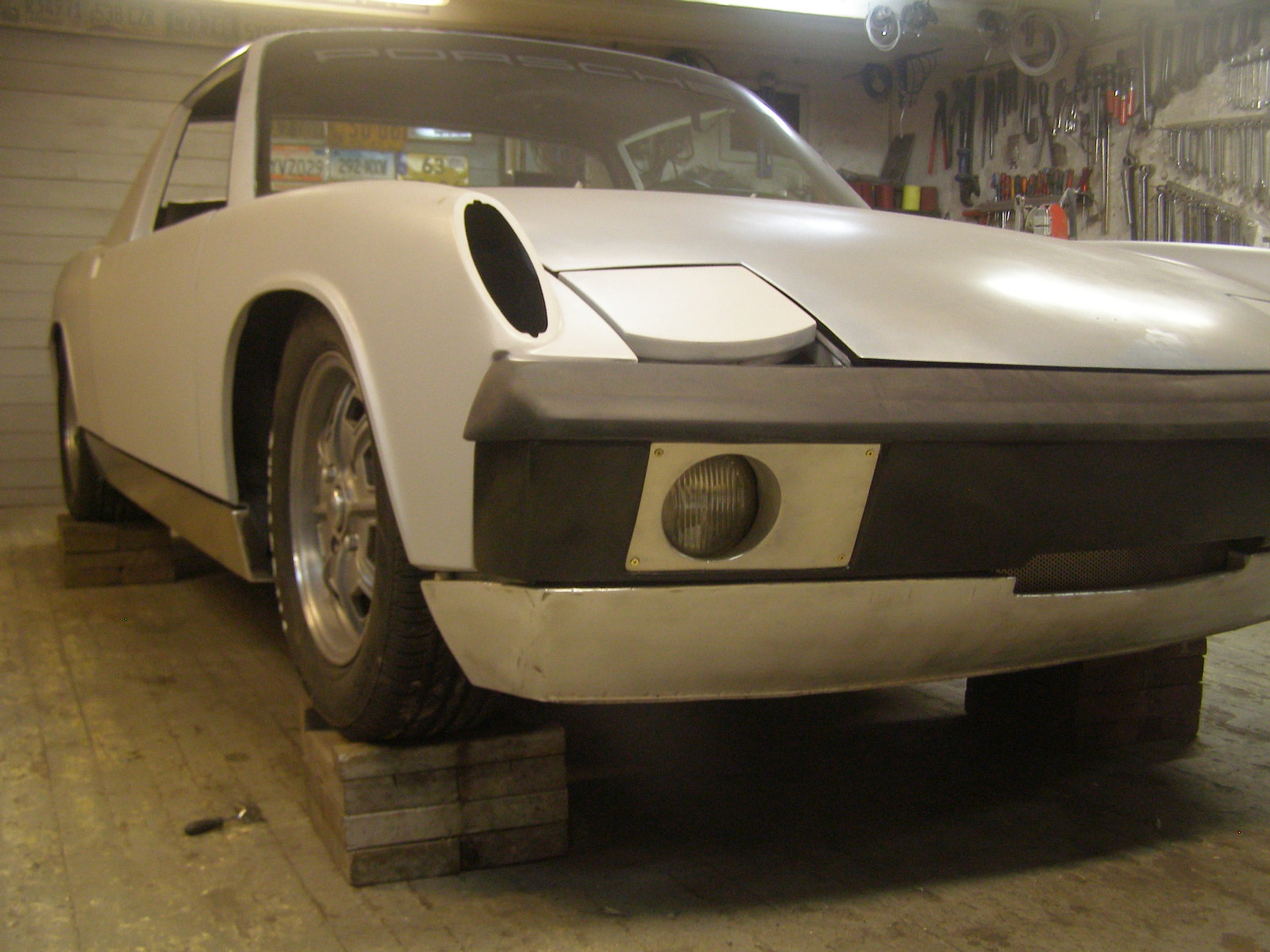

fordb132   Thanks for the welcome and a pic of the wreck w...   Nov 15 2016, 12:09 PM
Garold Shaffer   Thanks for the welcome and a pic of the wreck ...   Nov 17 2016, 08:07 PM
tygaboy   Wow - that 911 roof looks nice! Let's see...   Nov 15 2016, 12:23 PM
flat4guy   It looks soooo much better with a roof and wheels ...   Nov 15 2016, 02:17 PM
fordb132   I'm only using the front part of the roof,so t...   Nov 15 2016, 02:32 PM

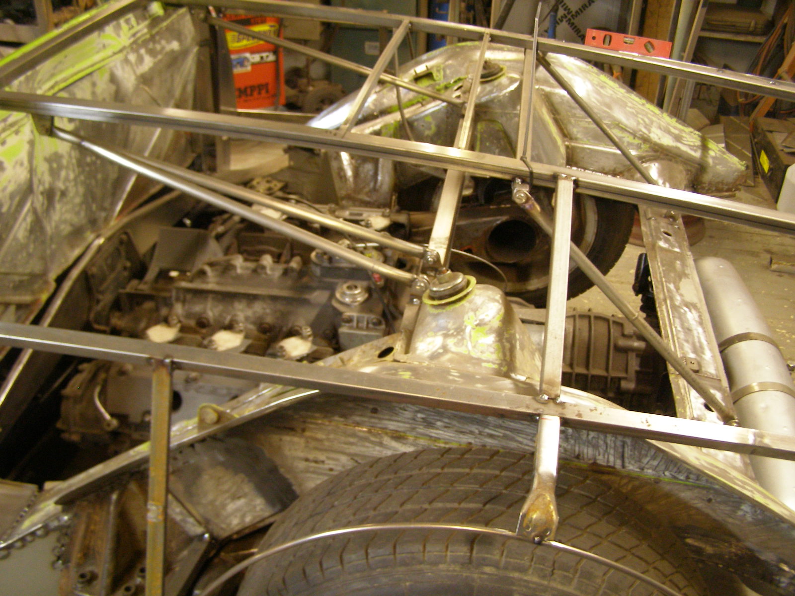

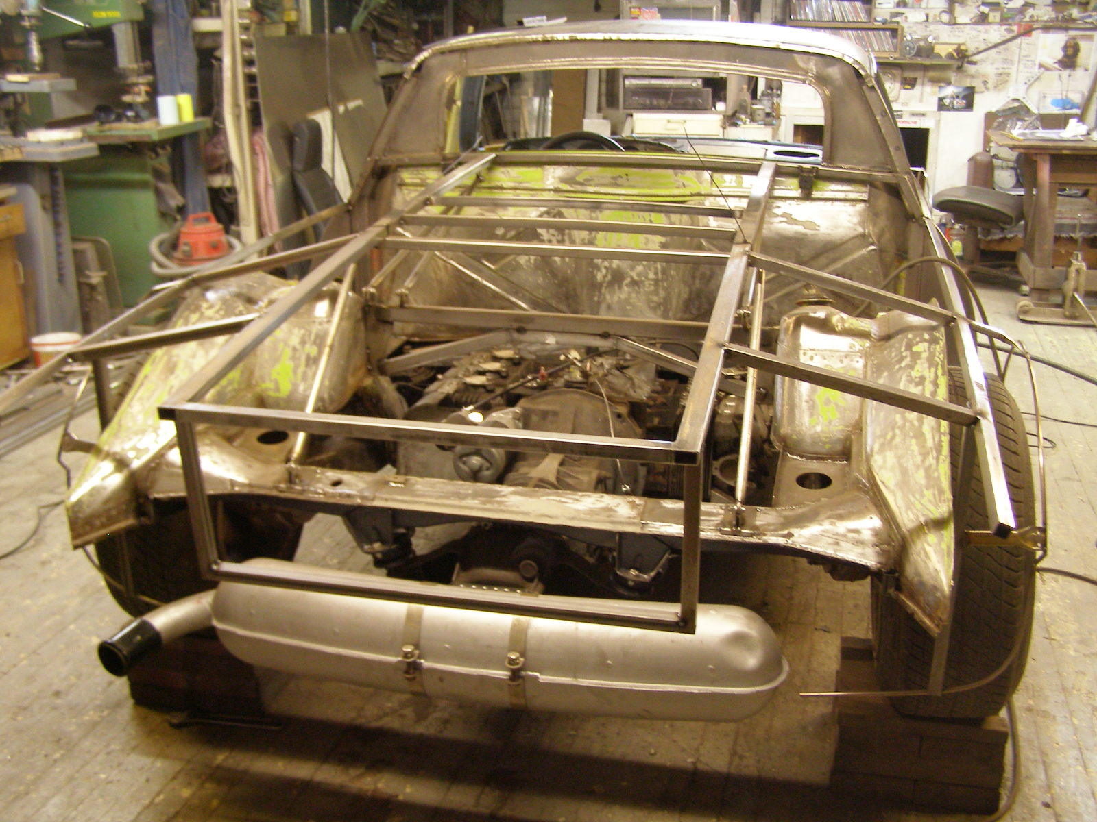

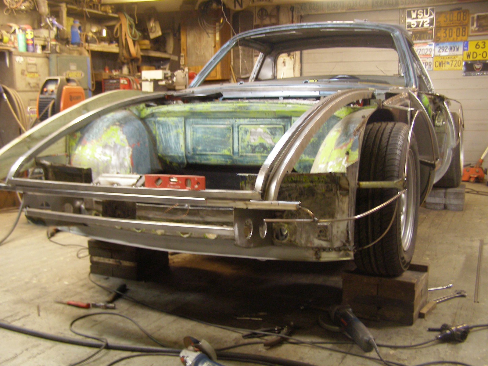

fordb132   Body structure coming together.Time to star...   Nov 17 2016, 03:57 PM
tygaboy   That is soooo cool. LOVE IT! Keep posting and ...   Nov 17 2016, 04:58 PM

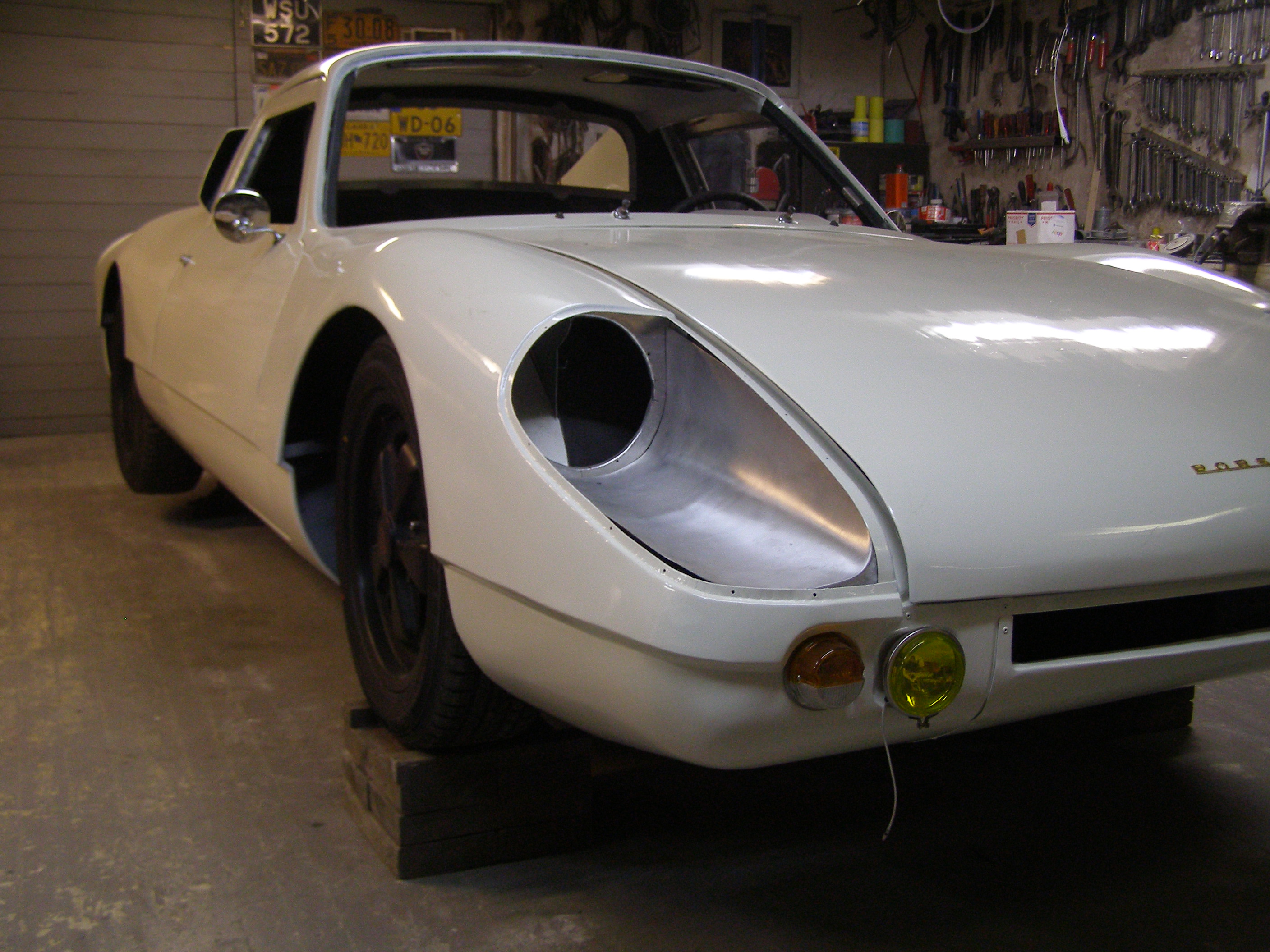

fordb132   Hi again folks. I thought I was doing OK,until...   Nov 18 2016, 11:41 AM
mbseto   ...Well,Mr. Krieger.I have been nuts for many yea...   Nov 18 2016, 01:06 PM
restore2seater   Since you're using aluminum for the skin how a...   Nov 18 2016, 02:30 PM
daytona   Wow, I am impressed with the ambition and skill. I...   Nov 18 2016, 03:18 PM
KELTY360   Serious panel beating skills! :smash:   Nov 18 2016, 05:26 PM
fordb132   I'm thinking of folding the alu skin aroun...   Nov 20 2016, 05:13 AM

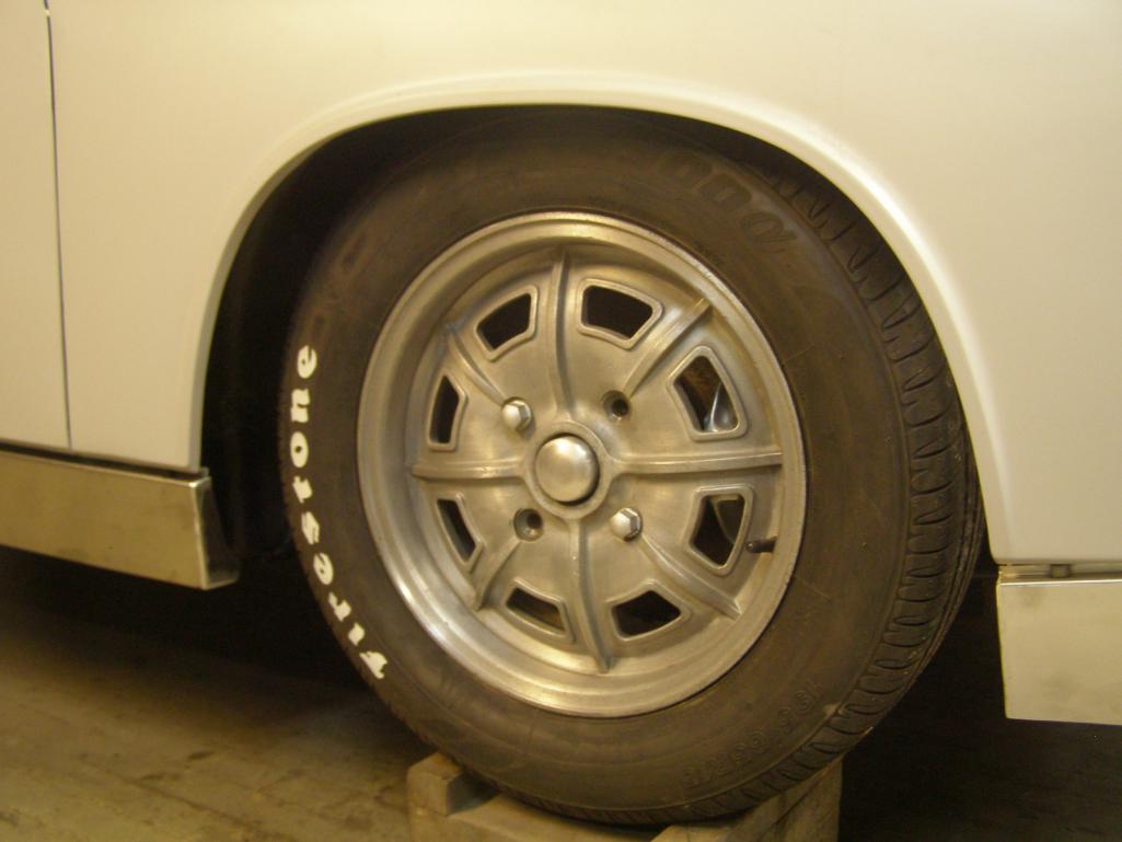

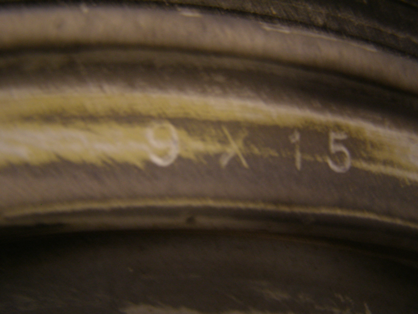

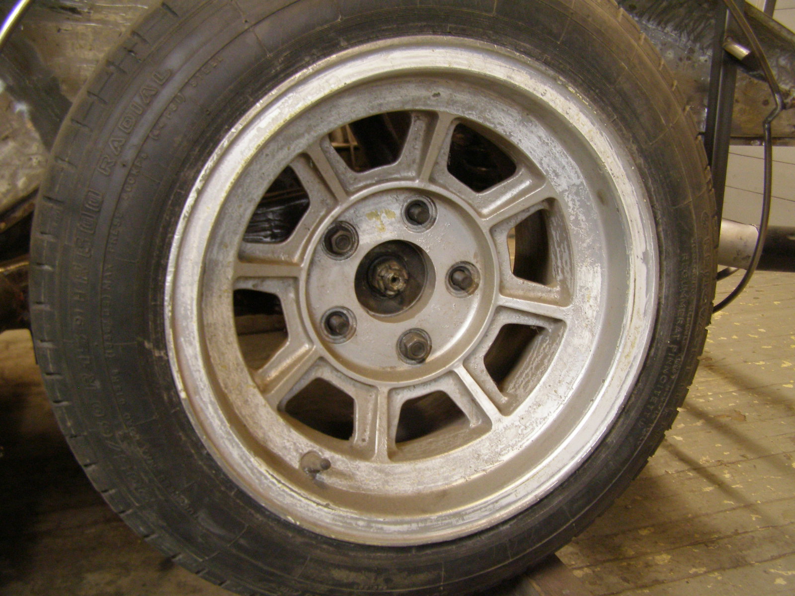

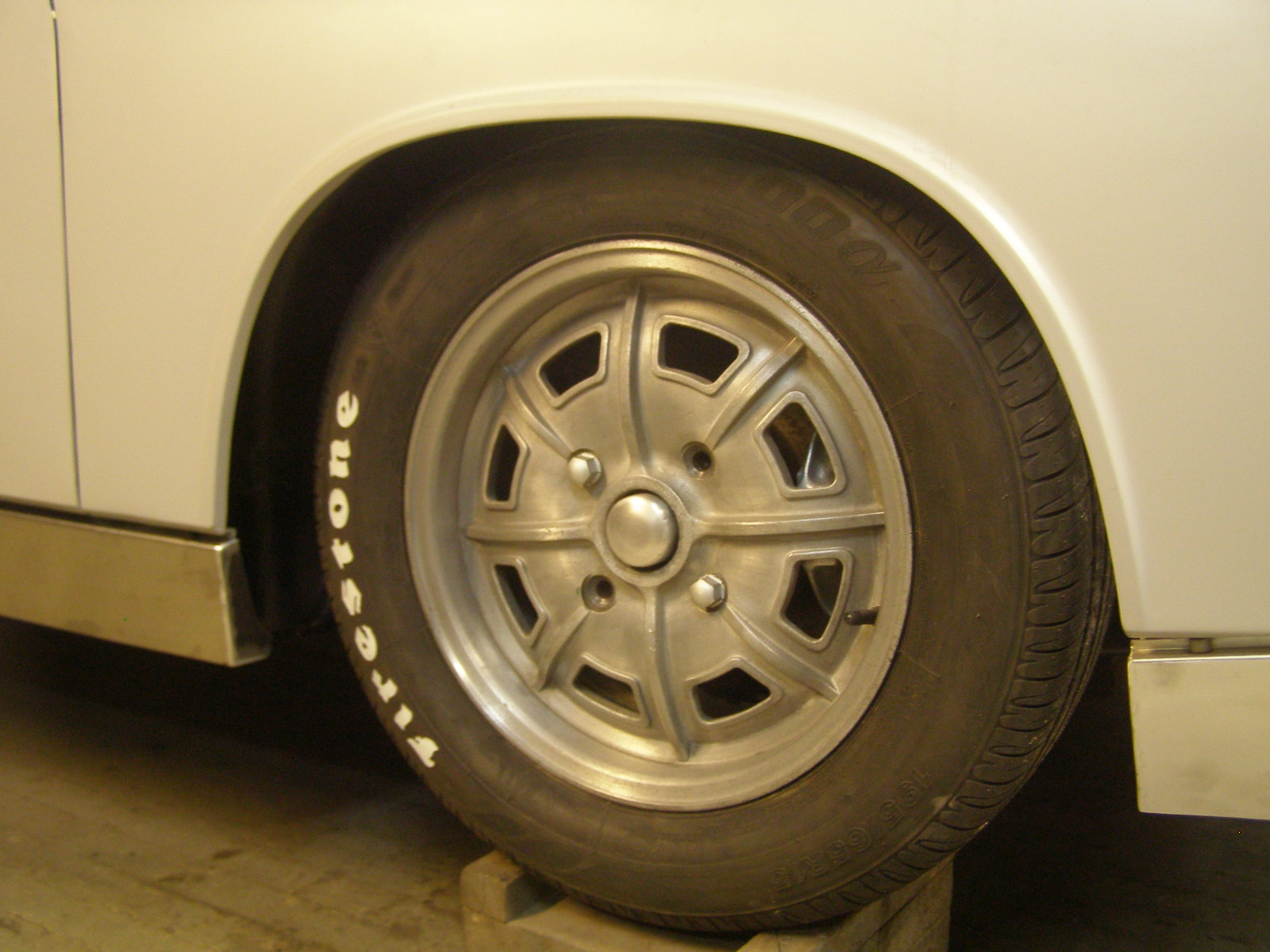

horizontally-opposed   Do you know what kind of wheels this is?They a...   Dec 13 2016, 02:40 PM
jmitro   amazing! serious metal fab skills!   Nov 20 2016, 08:19 AM
914forme   :agree: I do see an English wheel. But most oth...   Nov 20 2016, 09:26 AM
rick 918-S   Nice progress!   Nov 20 2016, 09:34 AM
sixnotfour   Campagnolo wheels, Yes grp 4 makes replica...   Nov 20 2016, 11:16 AM

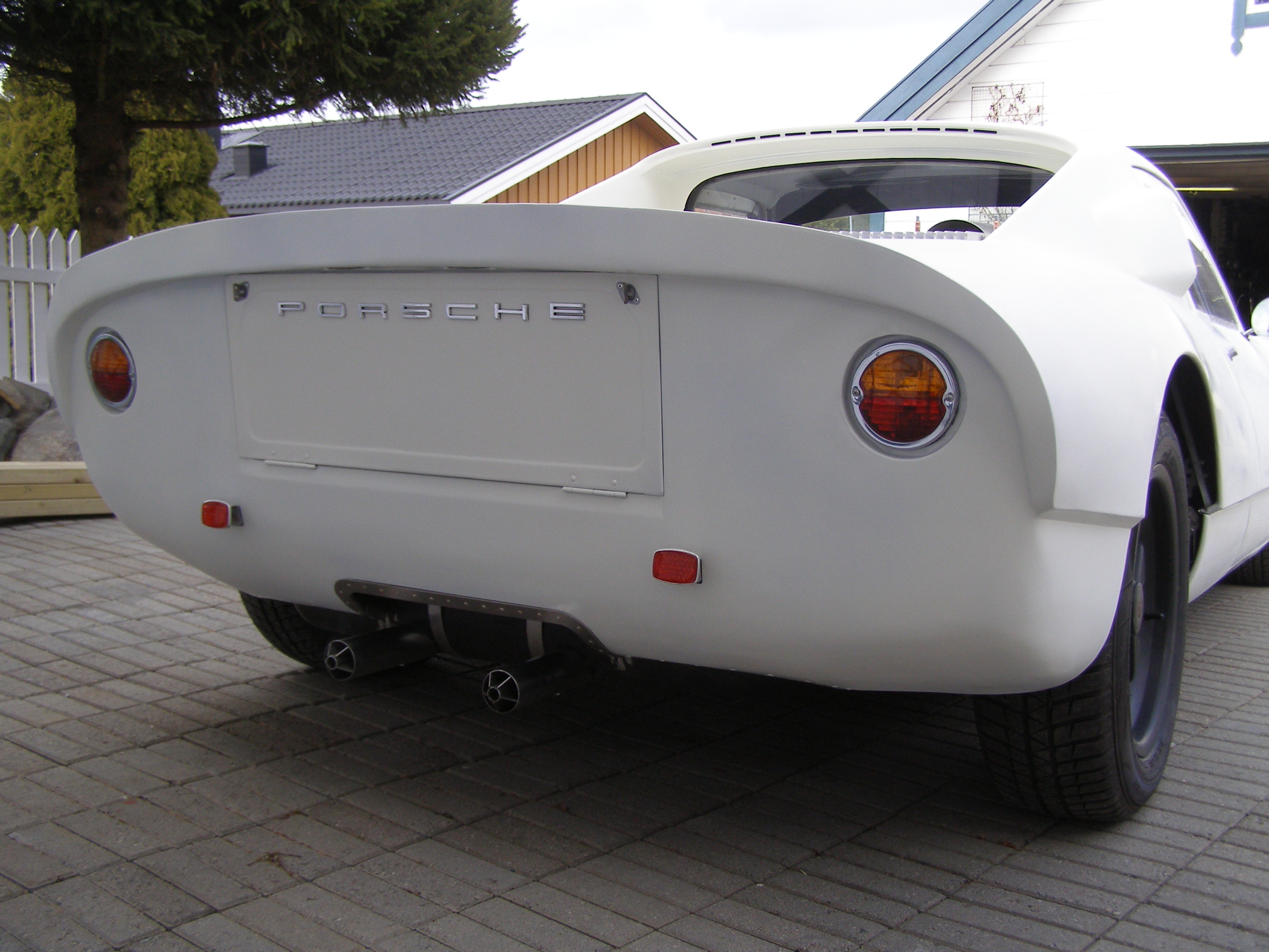

fordb132   Rewelded the engine mount so it cleared the shi...   Nov 21 2016, 08:20 AM
Krieger   Wow again! I have never seen anyone make thei...   Nov 21 2016, 09:28 AM

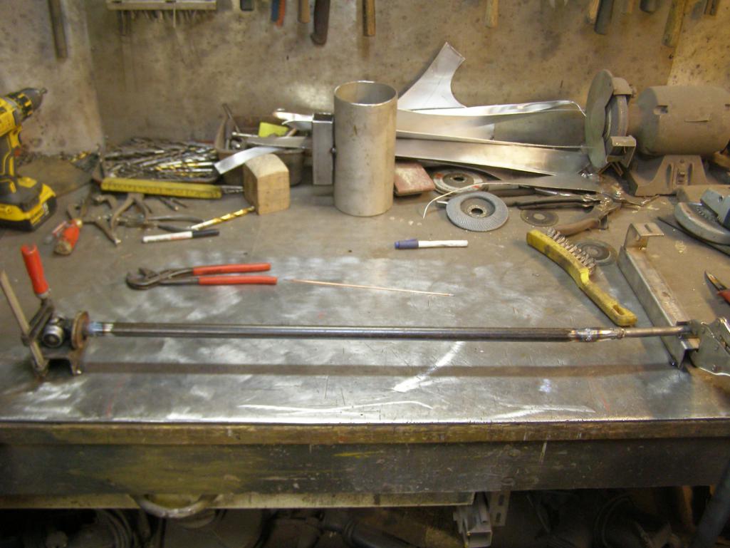

fordb132   I have a homemade wheeling machine,the old,engl...   Nov 22 2016, 11:54 AM

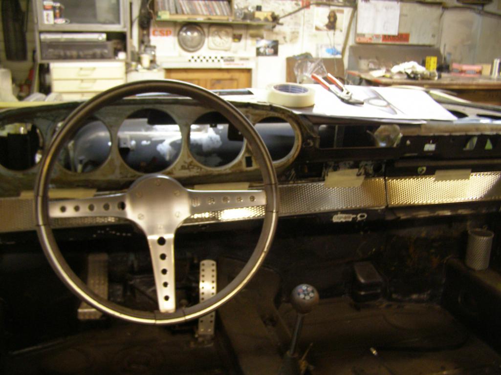

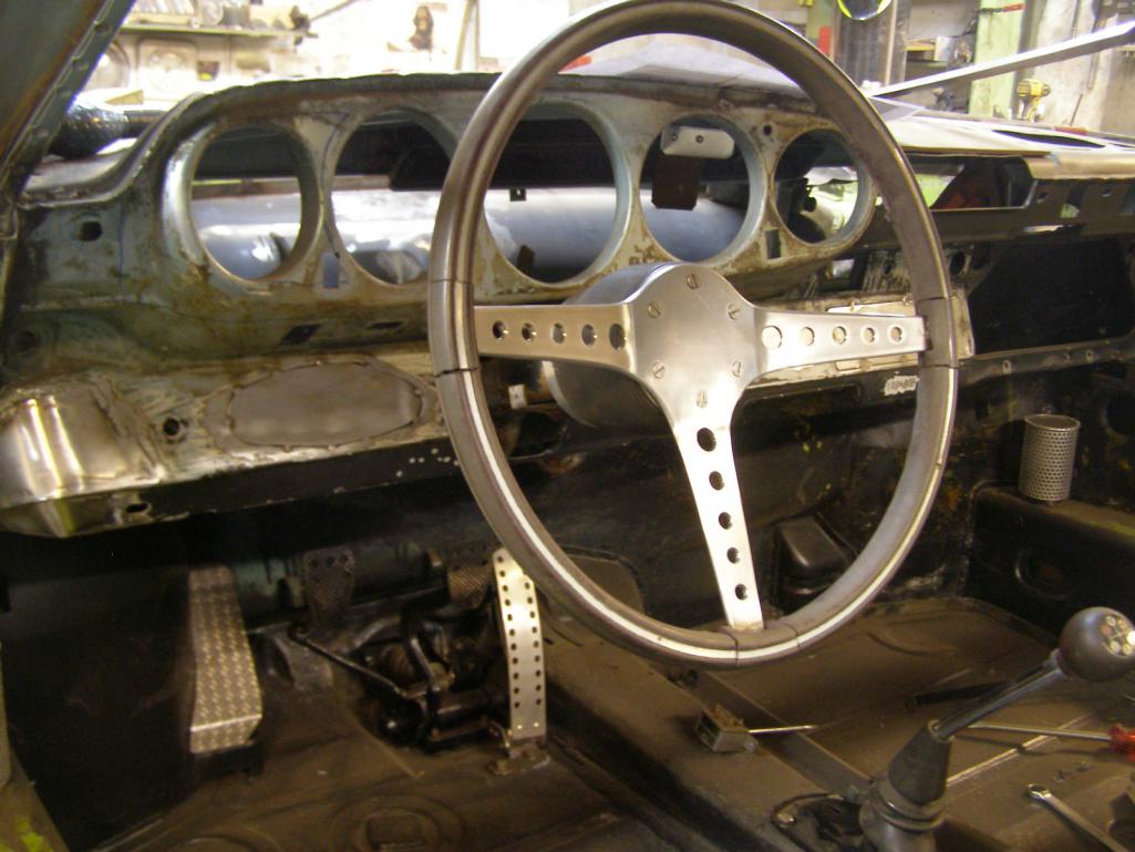

falcor75   Keep the five instrument holes and use the ones yo...   Nov 23 2016, 12:11 AM

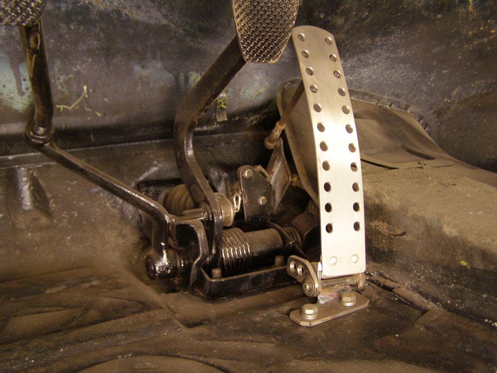

fordb132   That gas pedal is made from 2 mm ss,glued a pie...   Nov 24 2016, 10:06 AM

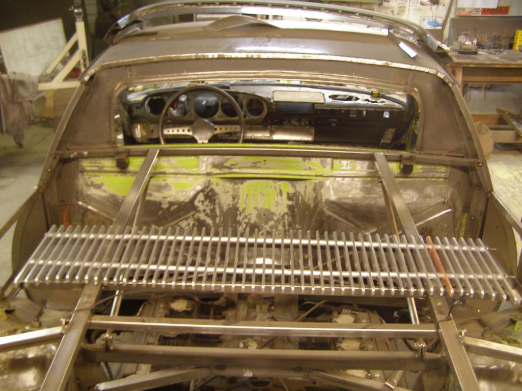

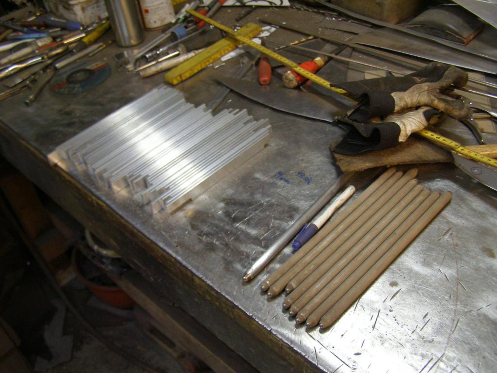

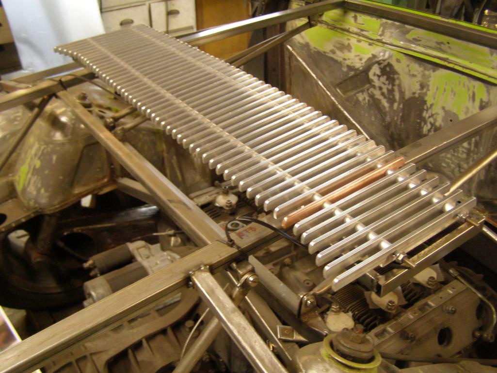

Frankvw   "Engine lid grille is made from original part...   Nov 30 2016, 08:16 AM
fordb132   914 Forme...Yes I rolled a cylinder,cut into two h...   Nov 30 2016, 12:23 PM

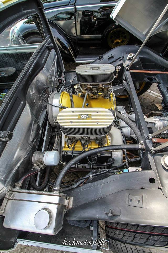

fordb132   Hi again.Some pics of my V8 you find here,rgalia: ...   Dec 6 2016, 10:36 AM

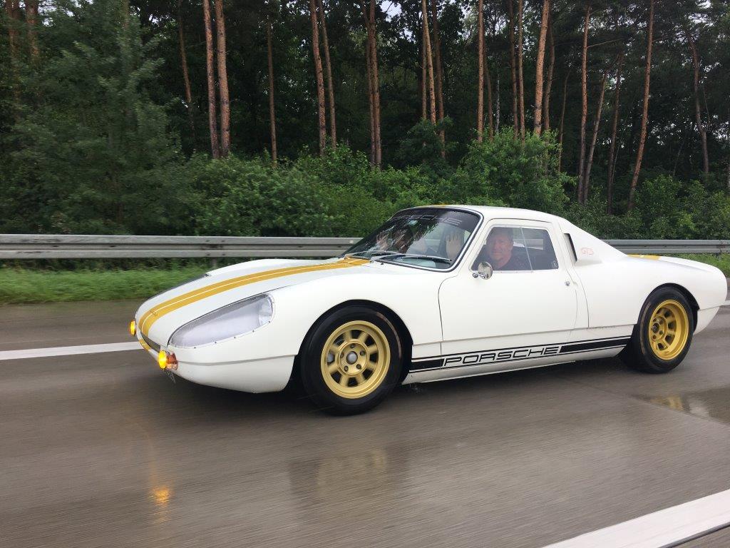

fordb132   So you like german air-cooled...do you recognize t...   Dec 7 2016, 11:42 AM

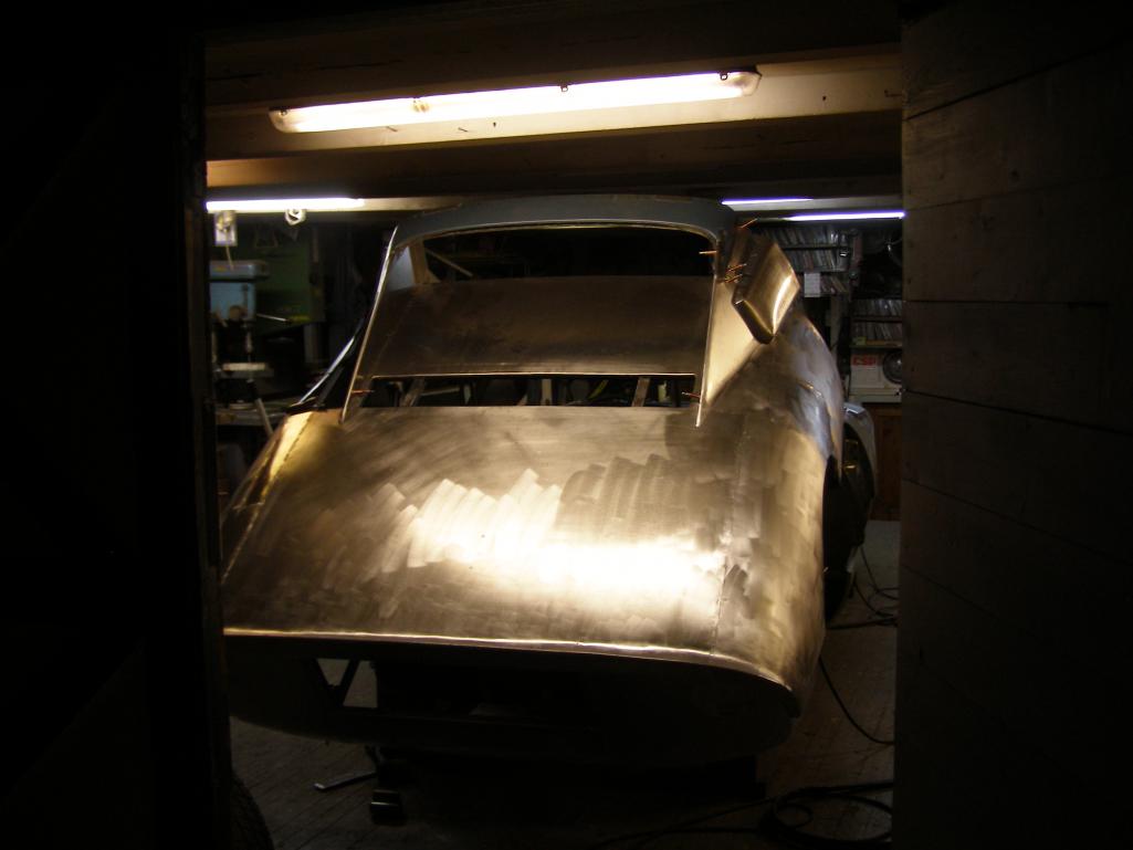

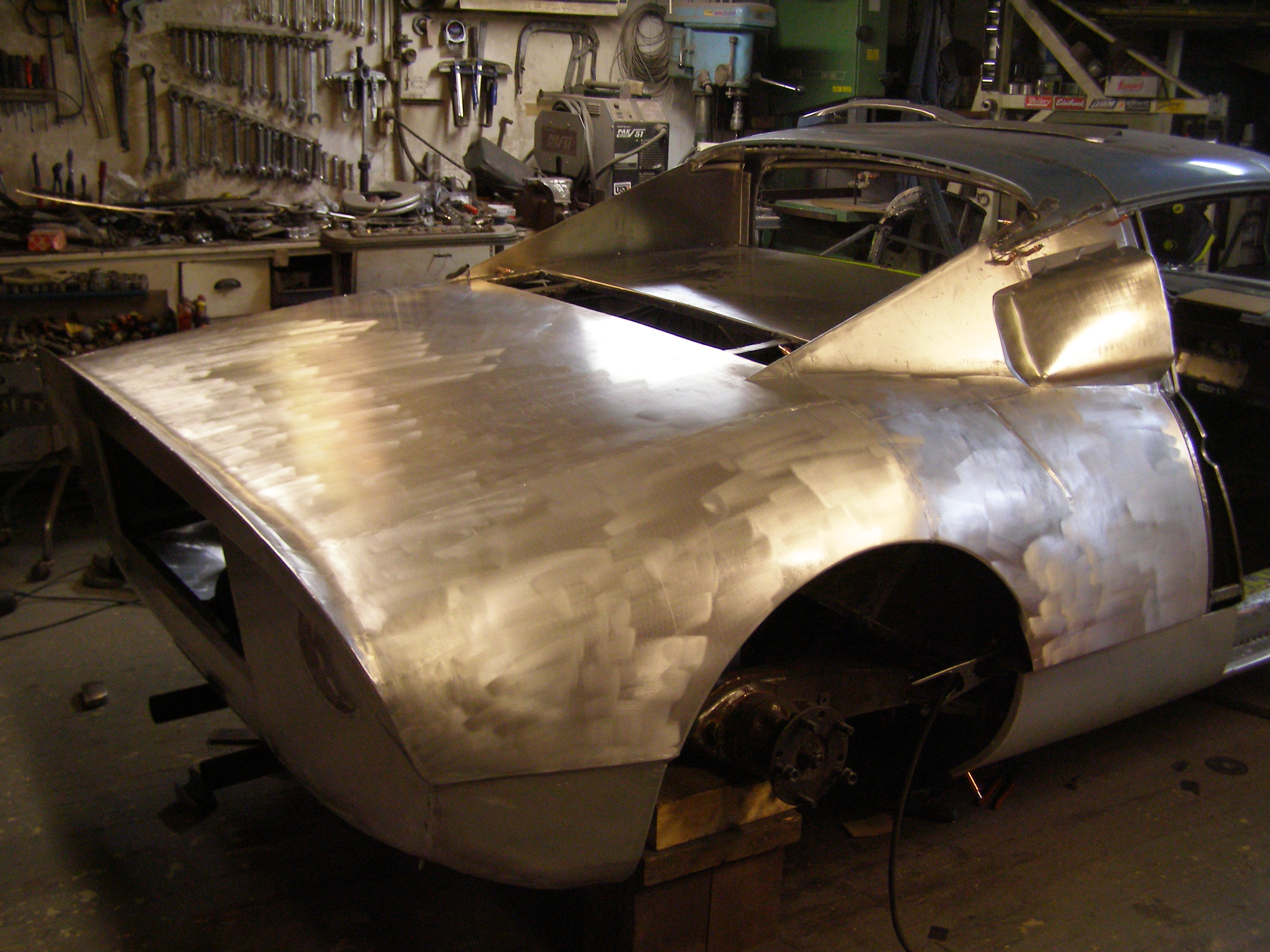

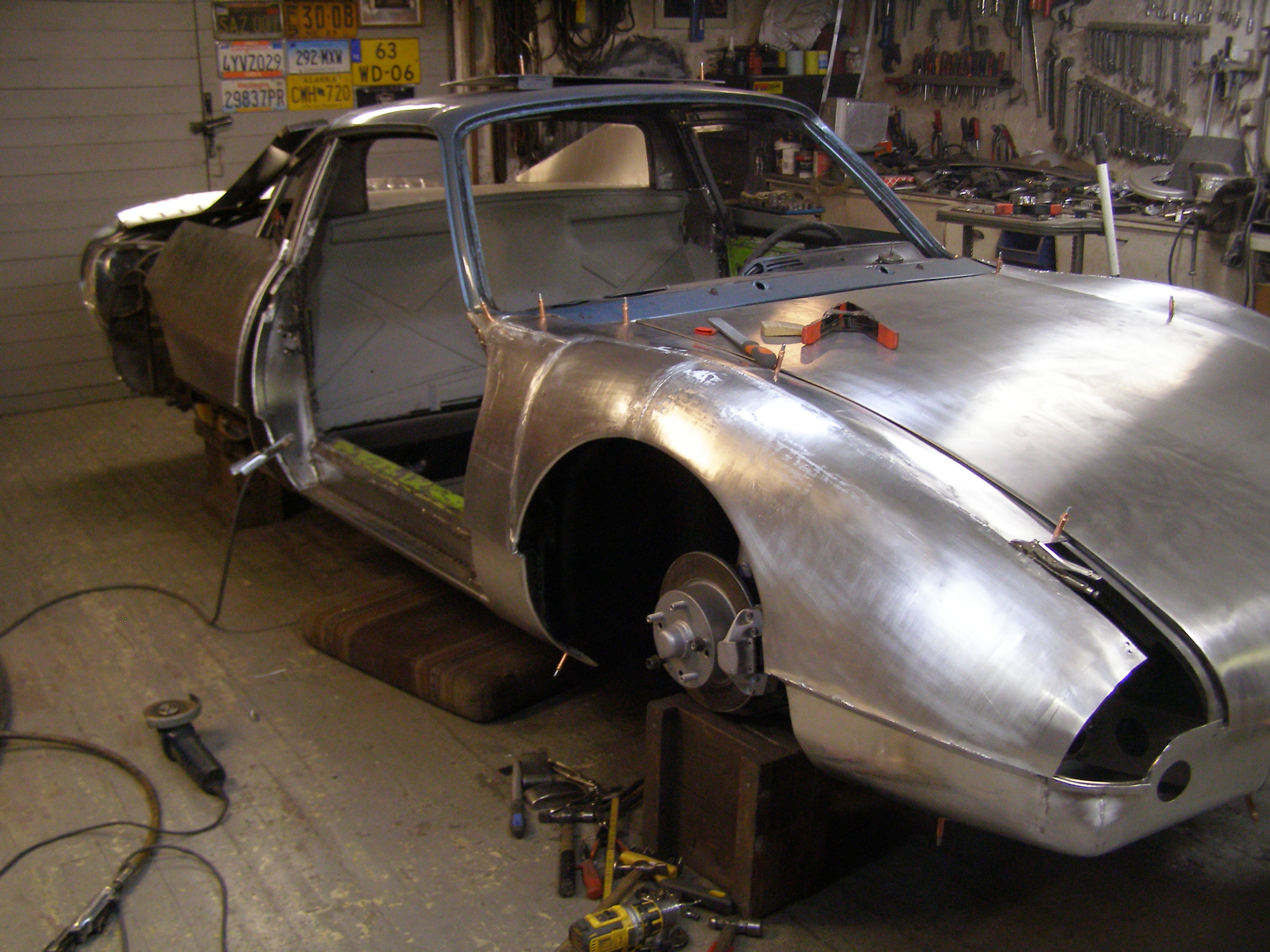

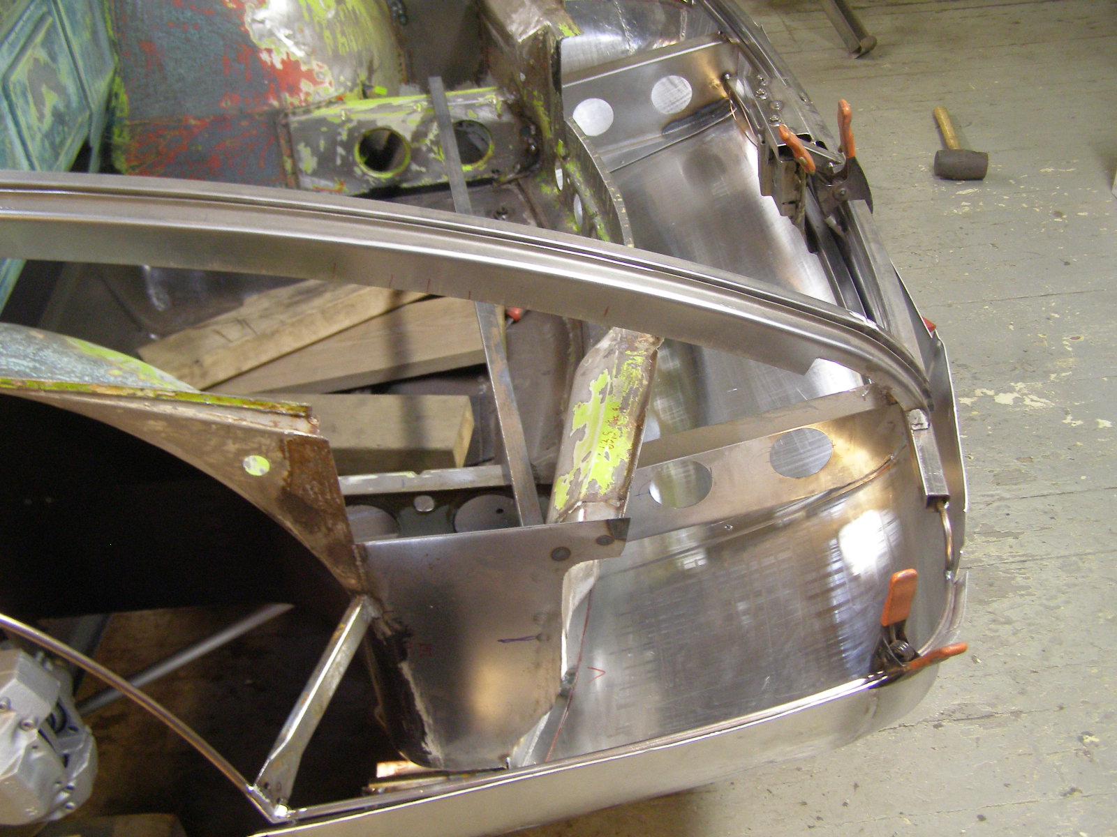

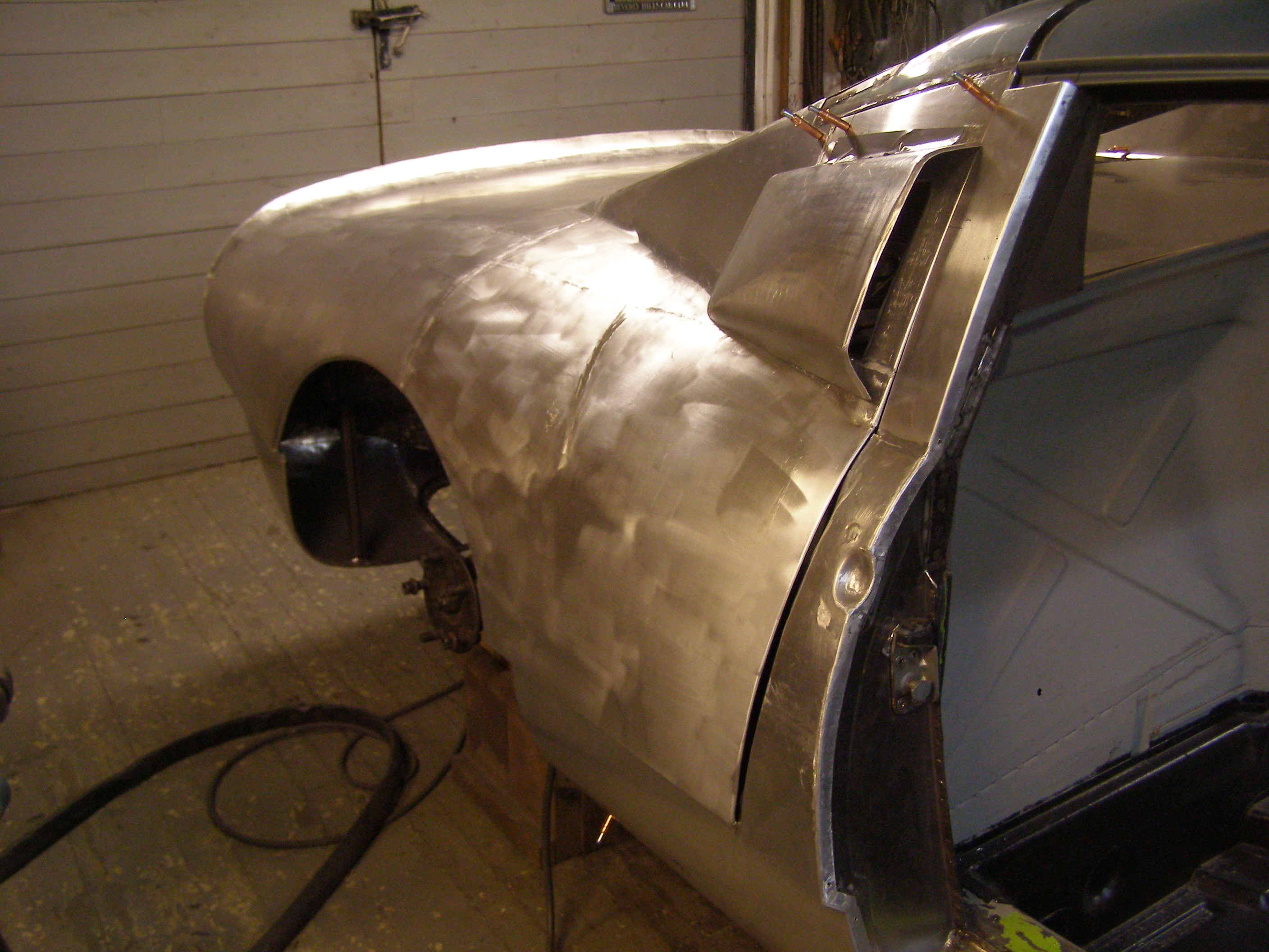

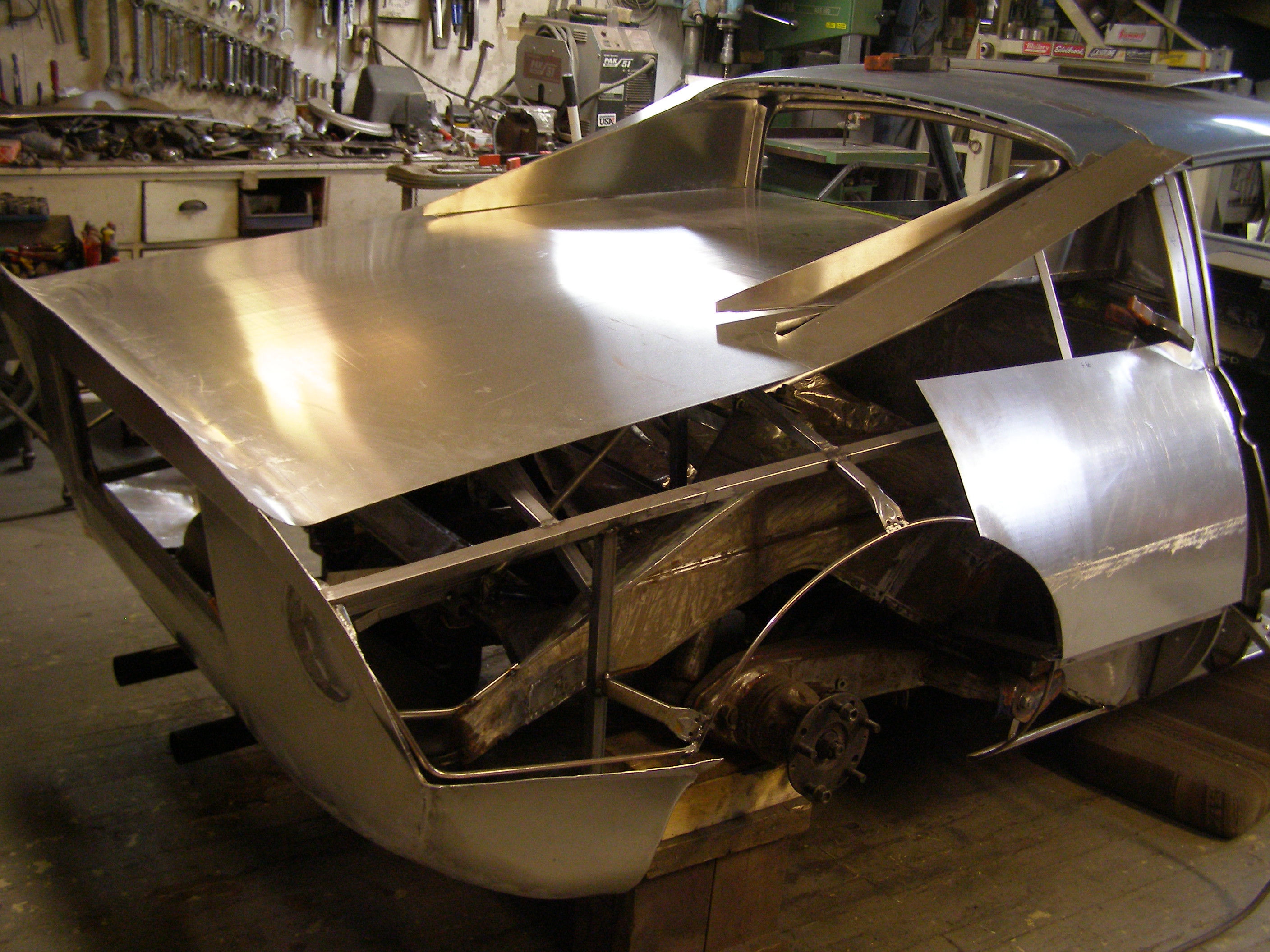

fordb132   Started on the first front fender today. Looks li...   Dec 9 2016, 05:00 AM
Porschef   Still trying to figure out how ten guys can fit/wo...   Dec 9 2016, 05:27 AM
