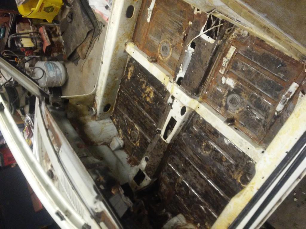

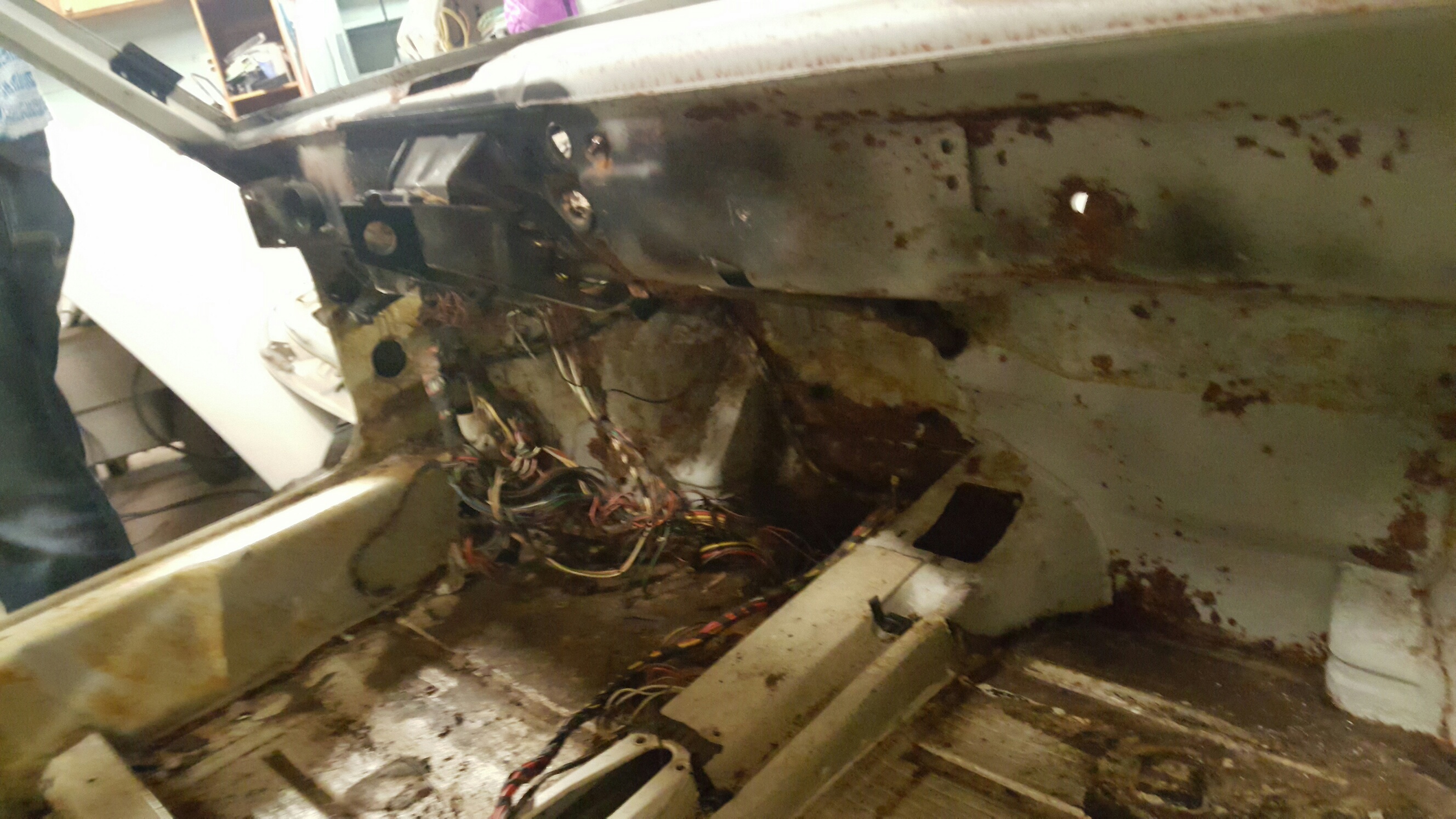

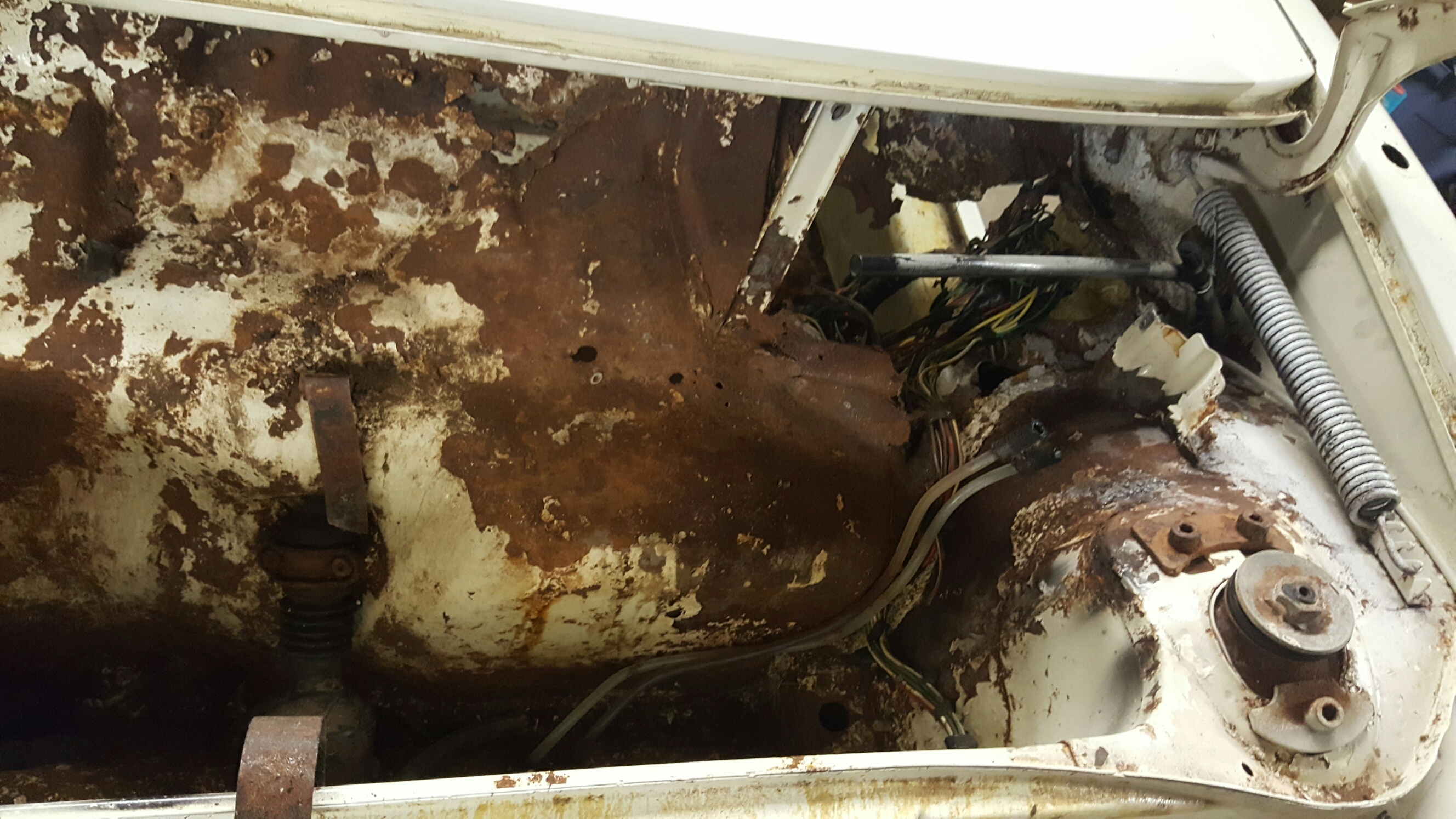

Wes was nice enough to hook Taylor up with a roller project. He drove down to Mendocino to get it about 3 weeks ago. We finally have it in a place we can work on it and started the clean up.
The backstory is that Wes got it in Oakland where it had sat behind a rib joint for some time. Apparently, some rodents made a home in the air box. They also acquired a taste for ribs. It appears the brought a few back with them. They were there for some time, and urinated eating the bulkhead out. The hell hole and floorboards look good. The pan is intact and looks good.

cary   Looks like the heater hose hole and the trunk pull...   Nov 15 2016, 01:02 AM
Mikey914   Yes pretty much gone. Need to buy / build a rotiss...   Nov 15 2016, 09:31 AM

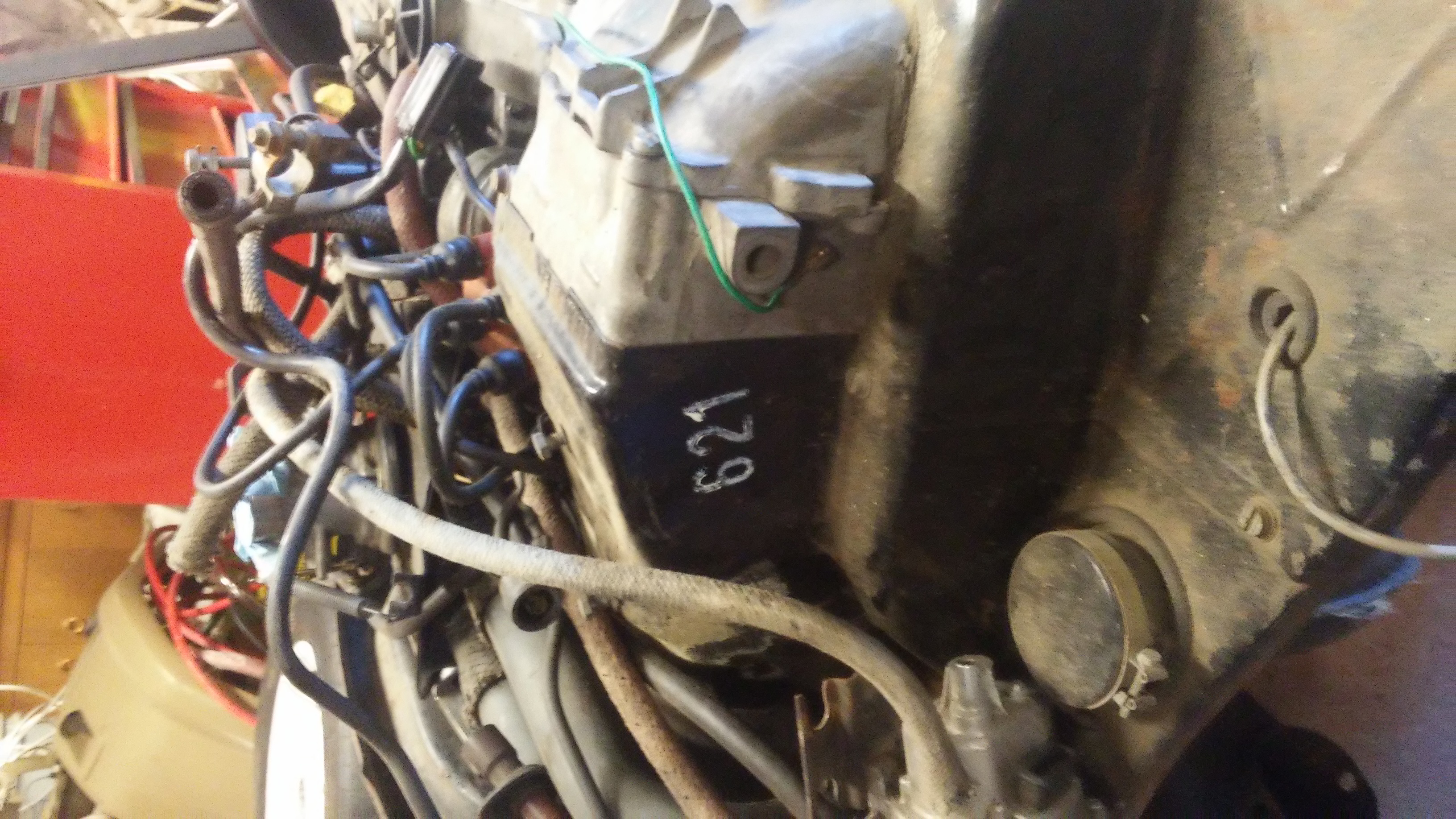

Taylor.914   Just got back from california to pick up the motor...   Feb 11 2017, 06:05 PM
wes   Just got back from california to pick up the moto...   Feb 11 2017, 06:55 PM
Larmo63   Yes, that is a factory stamped control number.   Feb 11 2017, 06:11 PM
Mikey914   There is also an I.O. stamped in the front of the ...   Feb 12 2017, 10:07 AM

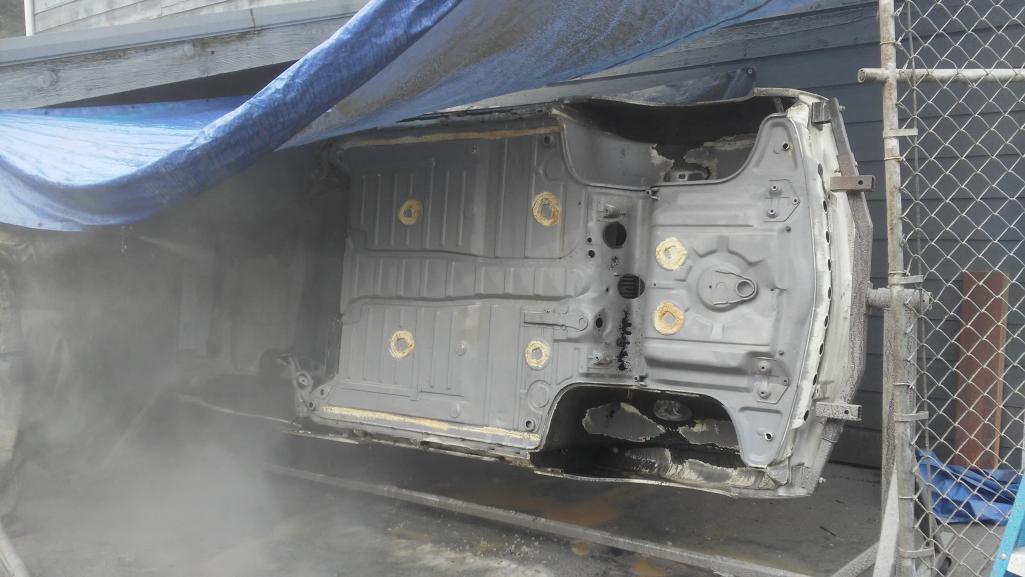

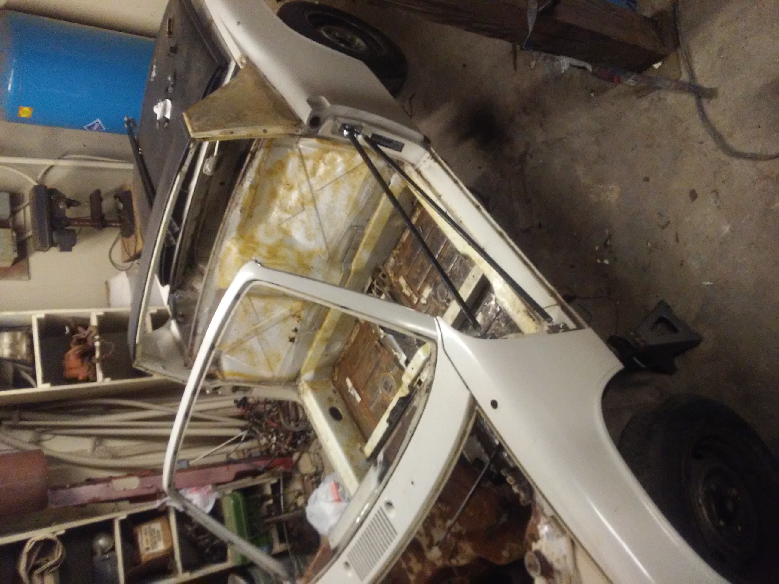

Taylor.914   Just a taste more pic later. finished the blasting...   Feb 27 2017, 07:44 PM
cary   Lookn good .......................... Hope to cut ...   Feb 27 2017, 08:24 PM

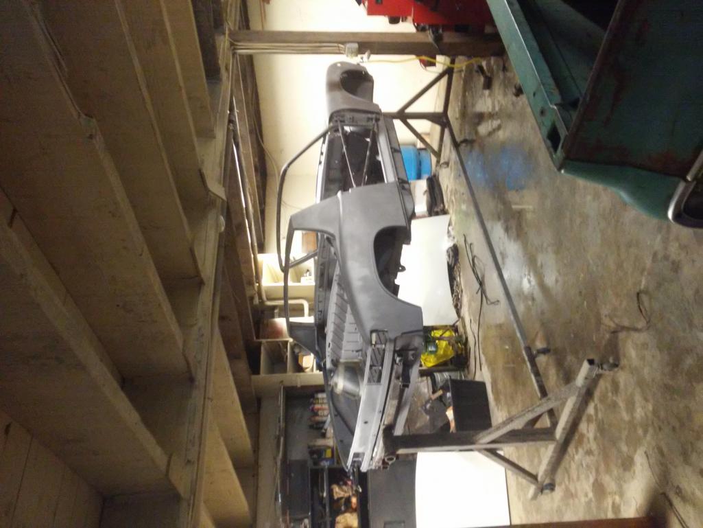

Taylor.914   Here is the up date. Had a bit of a sawzall party...   Apr 29 2017, 09:31 PM
Taylor.914   RE: Taylors new project thanks to Wes   Apr 29 2017, 09:32 PM
porschetub   Wow clean looking tub,dam those rats that's a ...   Apr 30 2017, 04:09 PM

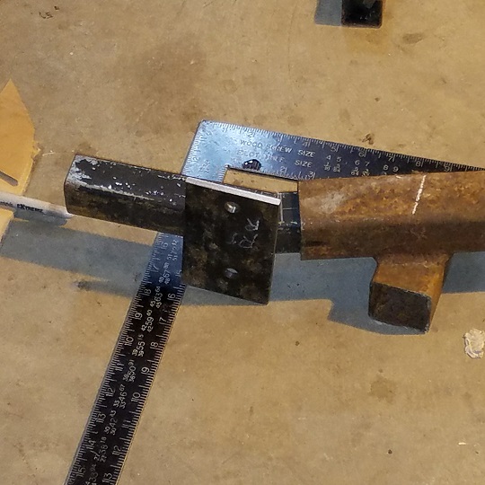

cary   Well I went to the geometry expert for some inp...   Jan 10 2018, 11:10 PM
rick 918-S   Nice work Cary. It's always interesting and ch...   Jan 11 2018, 03:06 AM
tygaboy   Nice work Cary. It's always interesting and c...   Jan 11 2018, 09:03 AM
cary   Well after all the measurements, pictures and emai...   Jan 11 2018, 11:01 PM
rick 918-S   Always enjoy a challenge. :smash: :sawzall: :wel...   Jan 12 2018, 07:06 AM
cary   Here's all the geometry .............. ...   Jan 13 2018, 08:44 AM

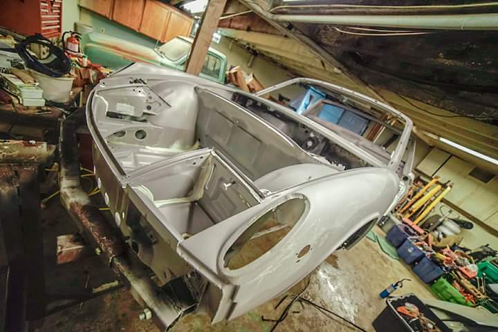

Taylor.914   Have not been very active on the forum but still m...   May 6 2018, 12:33 PM
Taylor.914   koo   May 6 2018, 12:39 PM
Taylor.914   RE: Taylors new project thanks to Wes   May 6 2018, 12:40 PM
cary   I feel bad. I've been so busy in the other roo...   May 6 2018, 01:20 PM

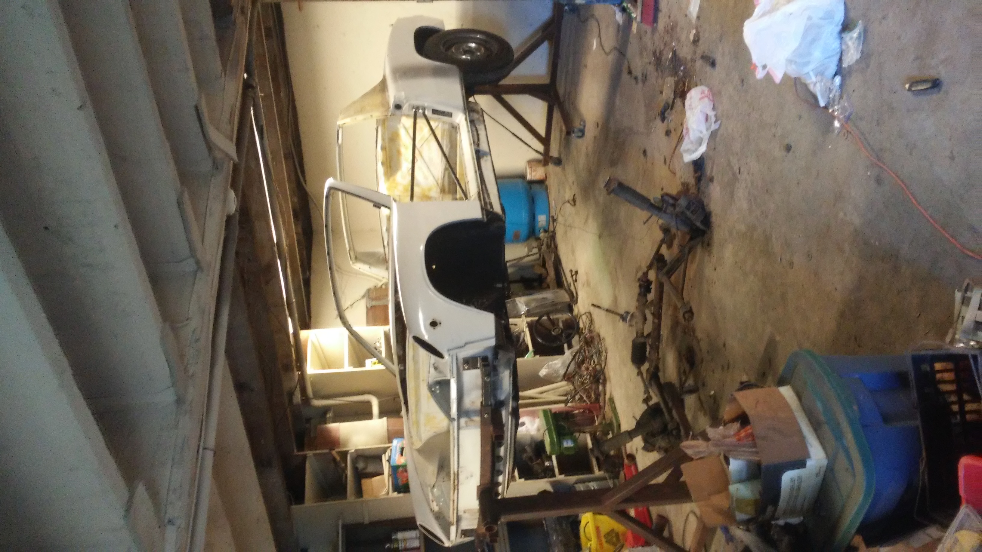

Taylor.914   Some good progress was made this weekend on firewa...   Aug 6 2018, 09:25 PM
Taylor.914   RE: Taylors new project thanks to Wes   Aug 6 2018, 09:26 PM
Taylor.914   RE: Taylors new project thanks to Wes   Aug 6 2018, 09:27 PM
Taylor.914   Prepping the donor.   Aug 6 2018, 09:29 PM
Taylor.914   RE: Taylors new project thanks to Wes   Aug 6 2018, 09:29 PM
Mikey914   just ordered up the passenger side engine tray sec...   Aug 8 2018, 04:52 PM
wes   Amazing work, turned out the car had more rust tha...   Aug 8 2018, 05:07 PM
