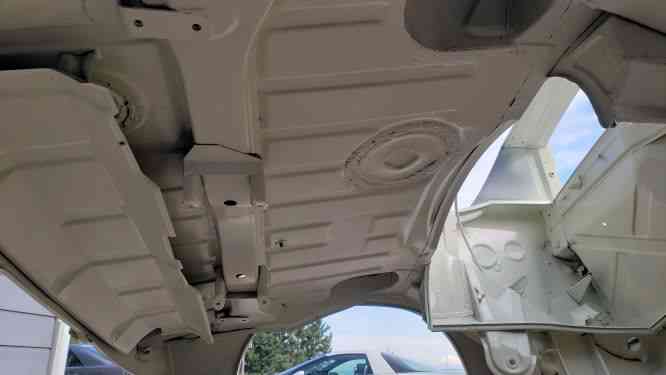

Wes was nice enough to hook Taylor up with a roller project. He drove down to Mendocino to get it about 3 weeks ago. We finally have it in a place we can work on it and started the clean up.
The backstory is that Wes got it in Oakland where it had sat behind a rib joint for some time. Apparently, some rodents made a home in the air box. They also acquired a taste for ribs. It appears the brought a few back with them. They were there for some time, and urinated eating the bulkhead out. The hell hole and floorboards look good. The pan is intact and looks good.
He has a bunch of work ahead of him, but it will get restored back to stock ivory white.

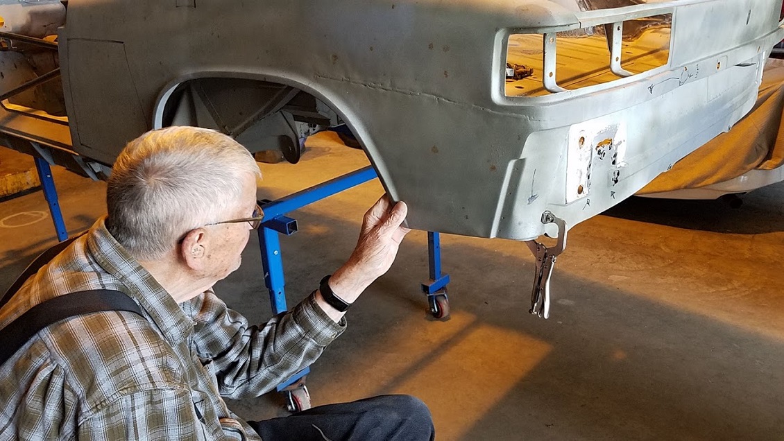

cary   With Super In Law awaiting his release, its time t...   Dec 26 2017, 10:05 AM
cary   Getting off to a chilly start ..................br...   Dec 26 2017, 11:35 PM
cary   After a little more inspecting .................. ...   Dec 26 2017, 11:43 PM
cary   Next it was time to cut out the right fender pee p...   Dec 26 2017, 11:48 PM
Mikey914   Thanks Cary, Looks like it was a little worse ther...   Dec 27 2017, 01:56 AM
cary   Got all bundled up and got back to work. Still 40 ...   Dec 27 2017, 11:26 PM
Mikey914   Good news is it's supposed to be warmer tomorr...   Dec 28 2017, 12:37 AM
cary   Started with tidying up the thin spots created by ...   Dec 29 2017, 10:55 AM

cary   Next was the tune up of the hinge support and dash...   Dec 29 2017, 09:42 PM
cary   Forgot to post Sunday's work. Started the day...   Jan 1 2018, 10:42 PM
cary   Next onto the seriously dented cross-member mount....   Jan 1 2018, 10:55 PM
cary   Then it was time to start fitting and trimming ......   Jan 1 2018, 11:02 PM
cary   Let the fun begin. Tuning and tacking ...............   Jan 1 2018, 11:05 PM
