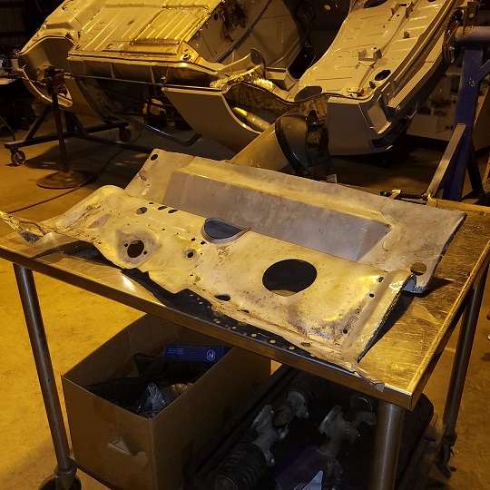

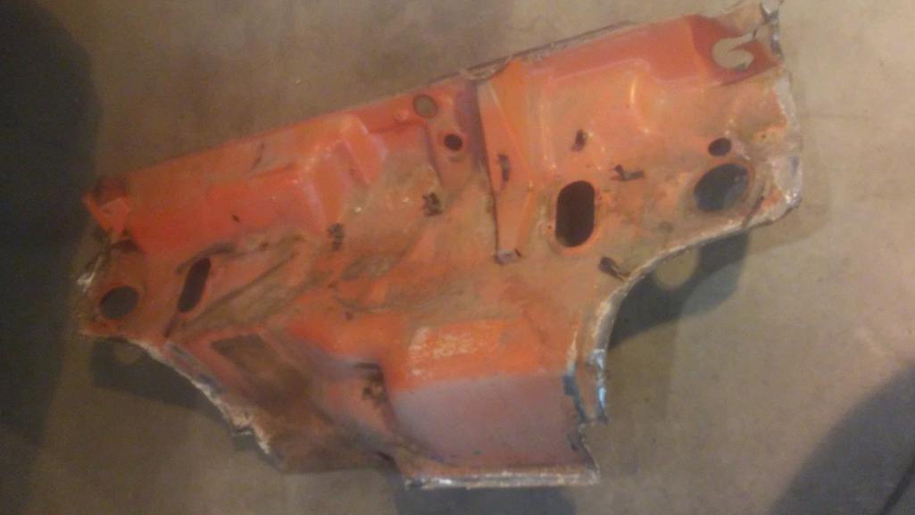

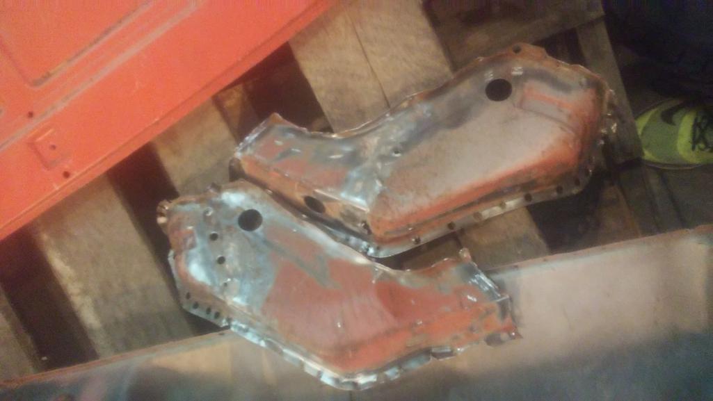

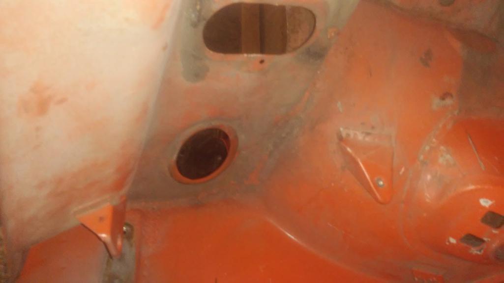

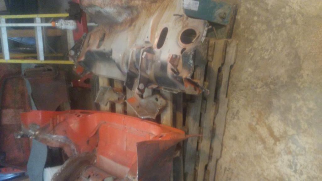

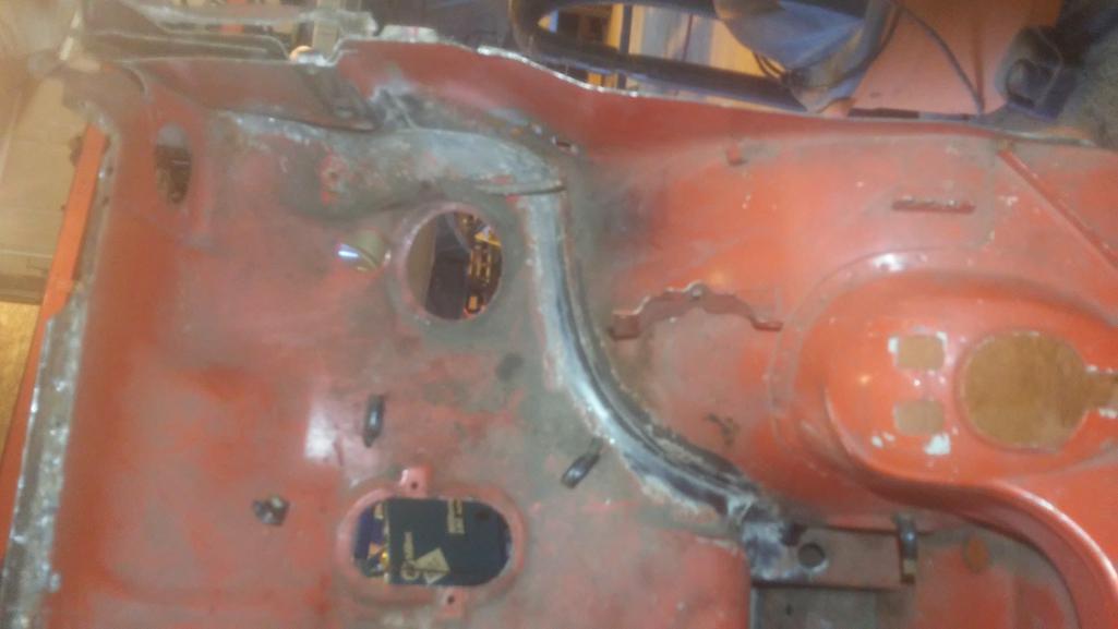

Making some more progress. Got the front end of the donor separated into pieces and now time to figure out what im going to use. Its been a a long process but i can see the end in sight. Hopefully a few more months and she will be ready for paint.Attached Image Attached Image

Taylor - Those of us who have dissected these cars know how much work (very careful work (IMG:style_emoticons/default/sawzall-smiley.gif) ) you did to get that panel out... Nice job, good on you.
Keep on posting and know we're out here rooting for you! (IMG:style_emoticons/default/smilie_pokal.gif)

QUOTE(tygaboy @ Aug 7 2017, 09:53 AM) *
And chris is particularly talented at drilling spot welds.. Thanks again.
And looks good..

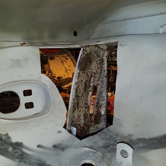

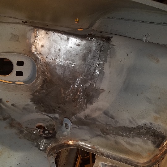

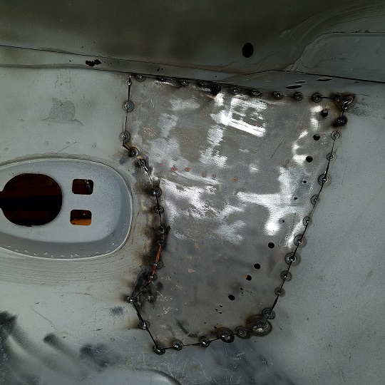

Time to switch from coach to hired gun.

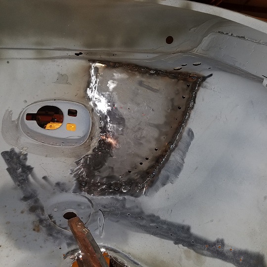

Cut out the destroyed section. (IMG:style_emoticons/default/sawzall-smiley.gif)
It takes quite a bit of nip, tuck and cuts to get the patch piece fitted. You what it tight enough for a nice weld. But you need enough room to take it in out 100 times to get it trimmed up. (IMG:style_emoticons/default/sad.gif)
In went the new section. After sending Super In Law home head down and back to work. I was bound and determined to get the replacement portion tack in. (IMG:style_emoticons/default/biggrin.gif)
From inside the fender.
Topside shot. Seam along the wall was a bit tough to fit. Back corner cut out was a little over-sized, but the copper backer took care of that. Looks like I cut it back far enough to get good weldable metal. I do have a few impurities coming out from between the layers on the shock mount. (IMG:style_emoticons/default/evilgrin.gif)

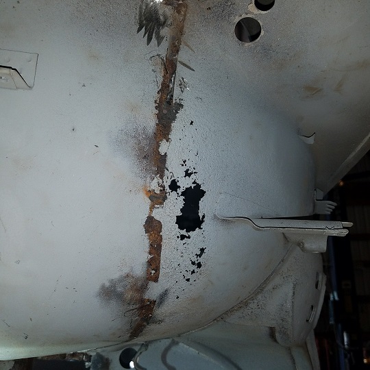

Monday the right fender will get a close inspection. No holes per say, but quite a bit of degradation. Might be ok.

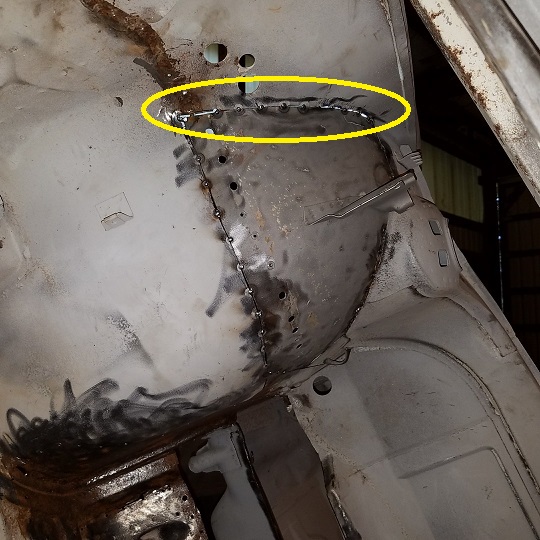

Started Labor Day doing my least favorite task, outdoor media blasting. (IMG:style_emoticons/default/mad.gif)
I blasted the lower portion of the front firewall that we'll be using for our patch panel.
Hopefully it made it easier for Taylor to remove the spot welds.

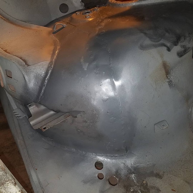

I got the fender patch welded in. I did it from the inside so I wasn't fighting the cowl.
I did a couple test sections of smoothing the weld from the top side. Looks like they finish up real nice.
Taylor did a nice job of removing the trimmed off fender portions and hammered out a wrinkle that we didn't see originally.

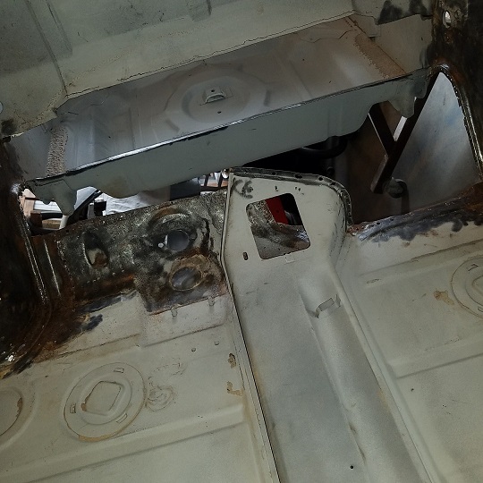

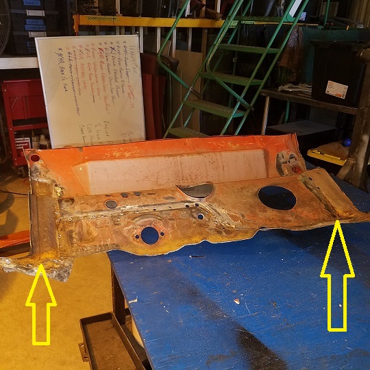

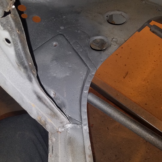

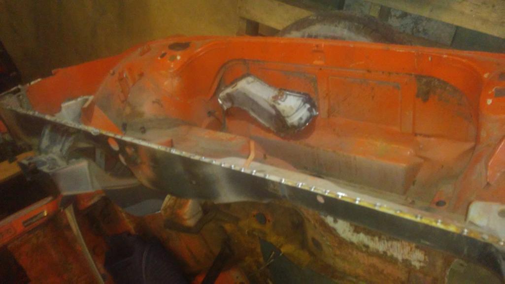

Here's a shot of where we're at on Taylor's car . Your looking thru the targa bar down into the front firewall and into the frunk. The panel had to be seperated to be installed.
Everything is kind on hold till I finish up Doug's project and or add another welder to the shop. Super In Law gave Taylor a MIG welding lesson and he's been tuning up the spot weld cutter holes on the parts we're going to put back in the car.

QUOTE(cary @ Oct 4 2017, 07:13 AM) *
Wow, You dont see that too often! Rarely does the front firewall have to be removed...
Great looking project!

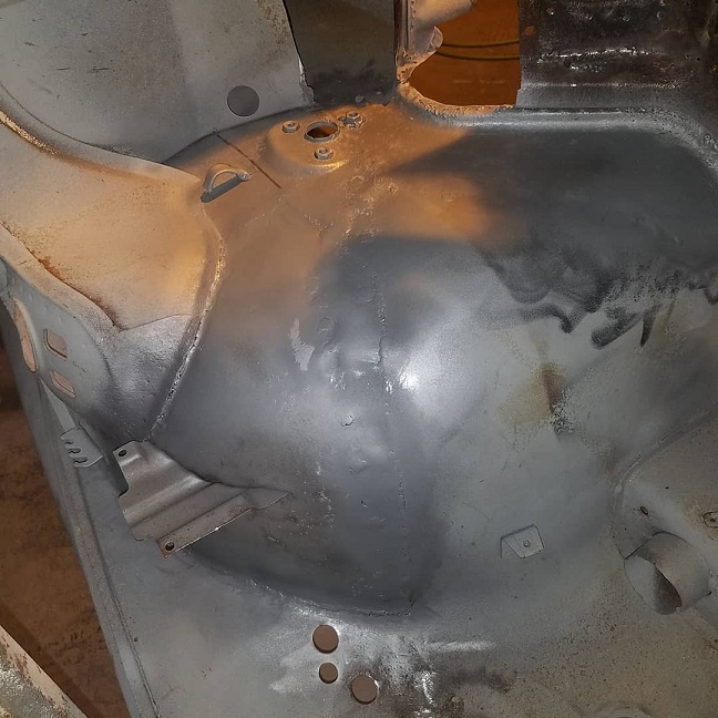

Getting off to a chilly start ..................brrrr

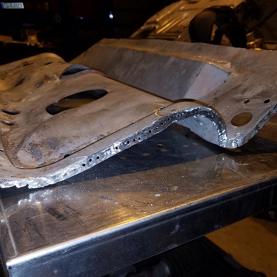

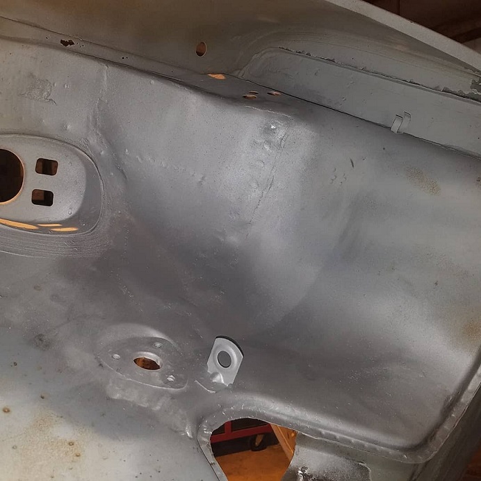

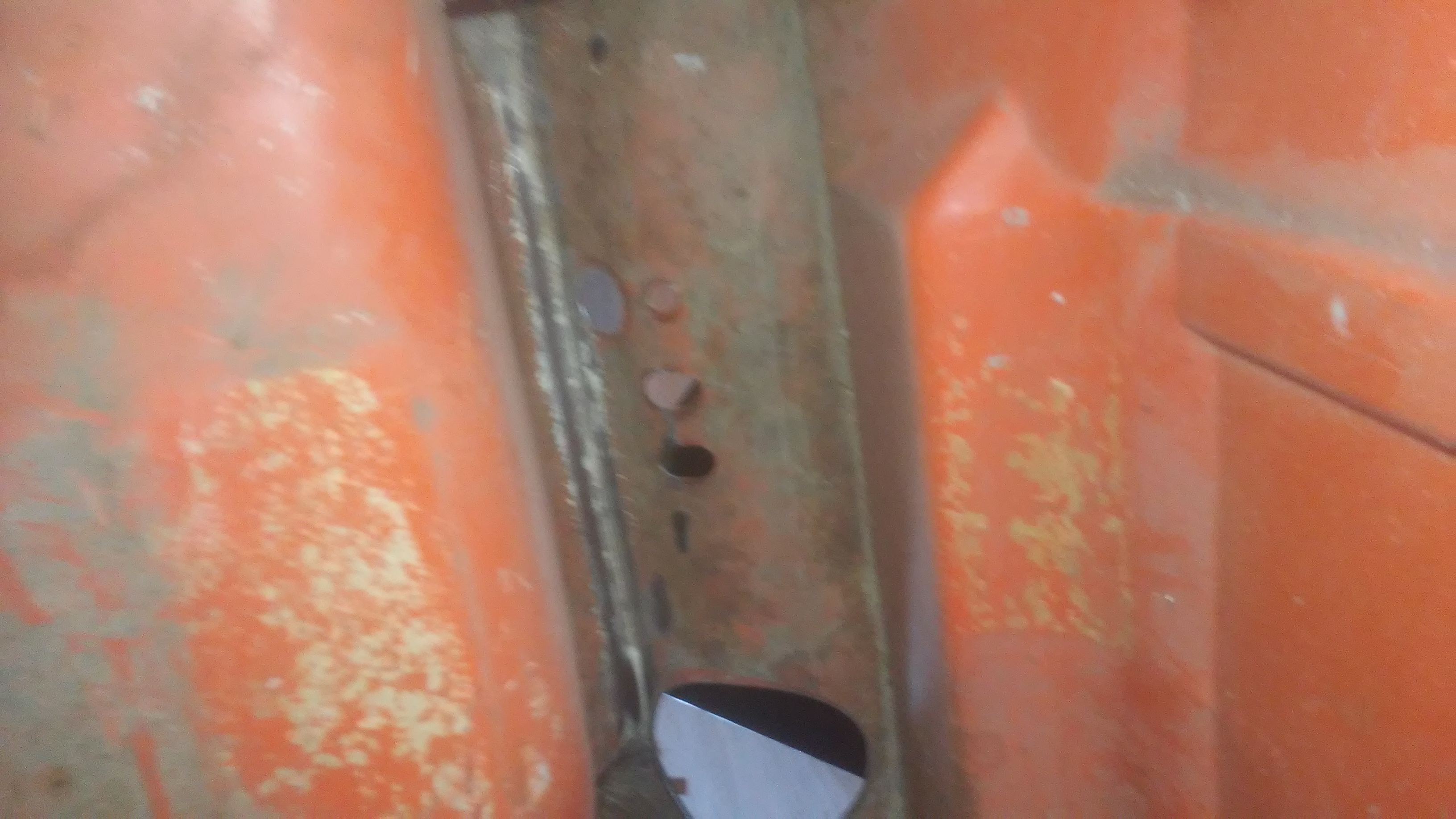

Started with grinding and sanding the seam welds. Then onto welding up all the spot weld cutter holes.
Needs a little and dolly work. But turned out pretty good considering where we started.
As long as was there I tuned up the door frame / tub wall.
