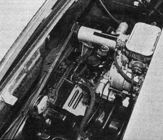

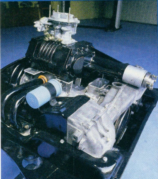

Found the article. Pics to follow. The car was built by Jay Richardson of RPM German Autowerks in Port Orange (Daytona) FL. It's a positive dispalcement B&M 66CID roots style blower running 6 lbs of of boost, with what looks like a custom shaft extension and mount. Up top is a Weber 36DFAV 2 bbl progressive carb. The assembly is mounted on a modified 2 bbl carb manifold. 75' 2.0 motor has 8:1 mahle p&c's, and stock cam. To handle higher rev's the case, connecting rods and crank were blueprinted and case was shuffle pinned. Looks like a relatively simple set up, especially compared to a turbo install. Article claims 170 hp with instant response and states..." under full throttle, the SC914 spins the wheels enthusiastically while the blower sounds like blender one click sbove "puree"." SCHWEEEET! (IMG:http://www.914world.com/bbs2/html/emoticons/rocking nana.gif)

'Nuther one.
