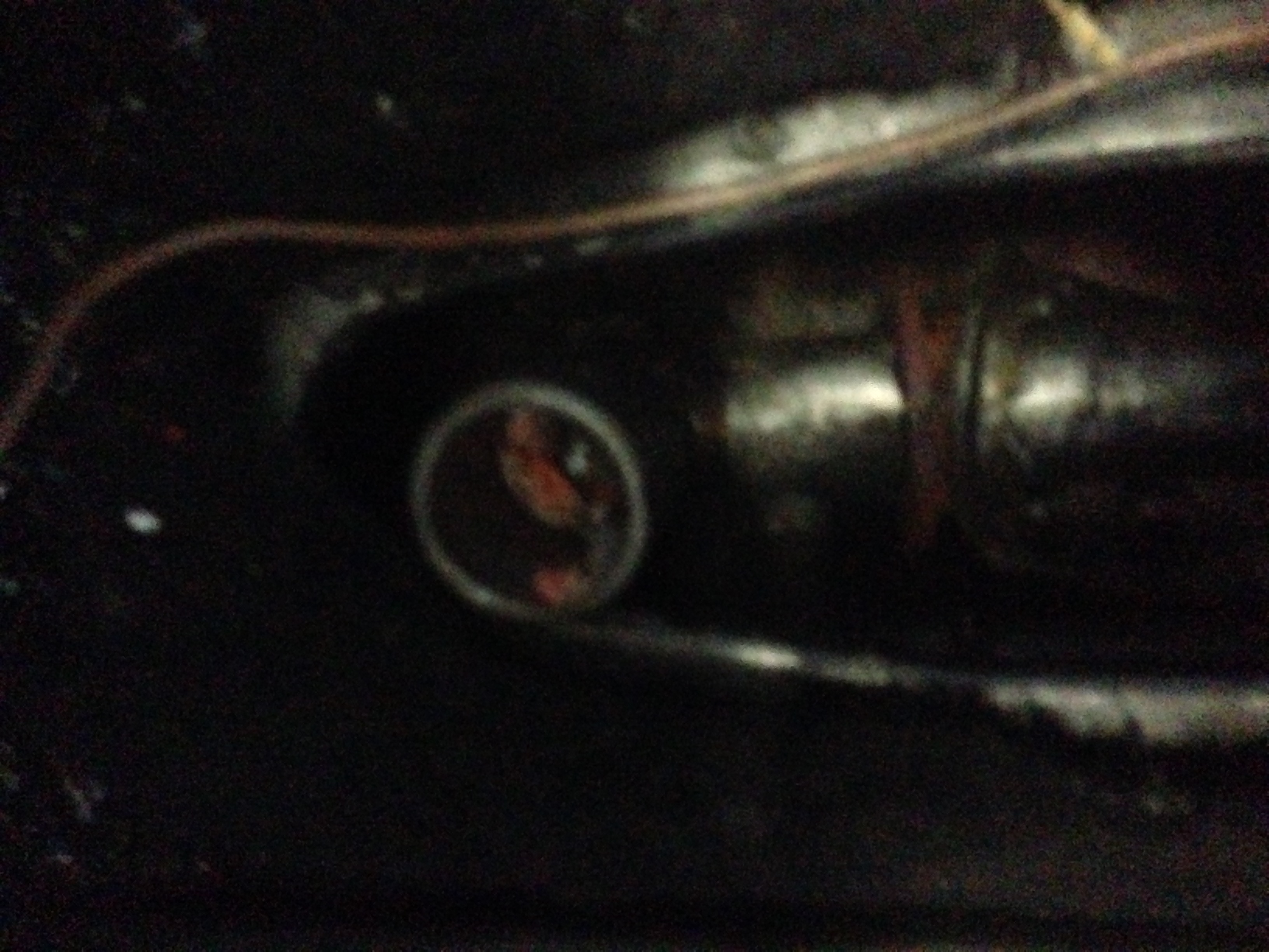

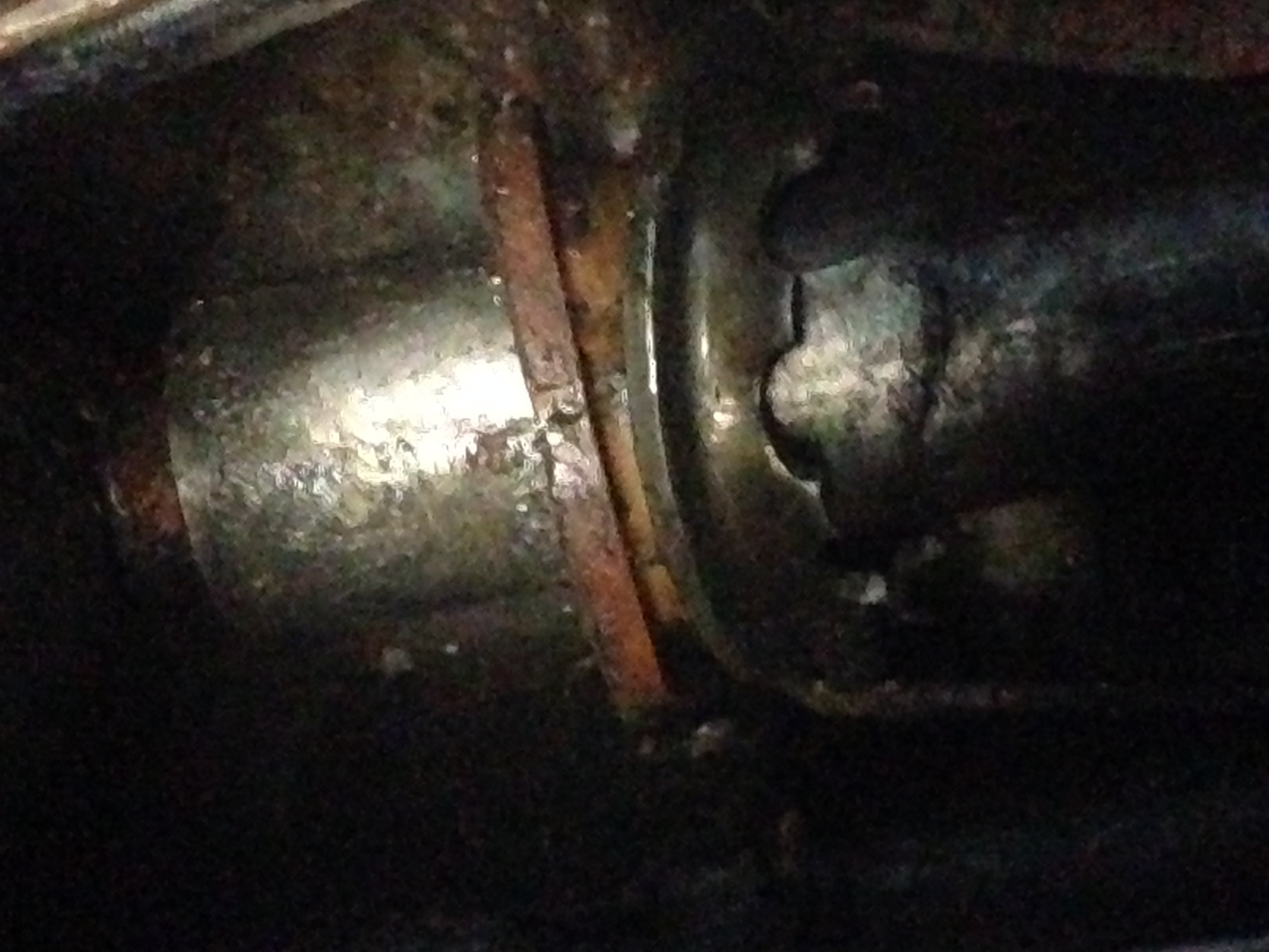

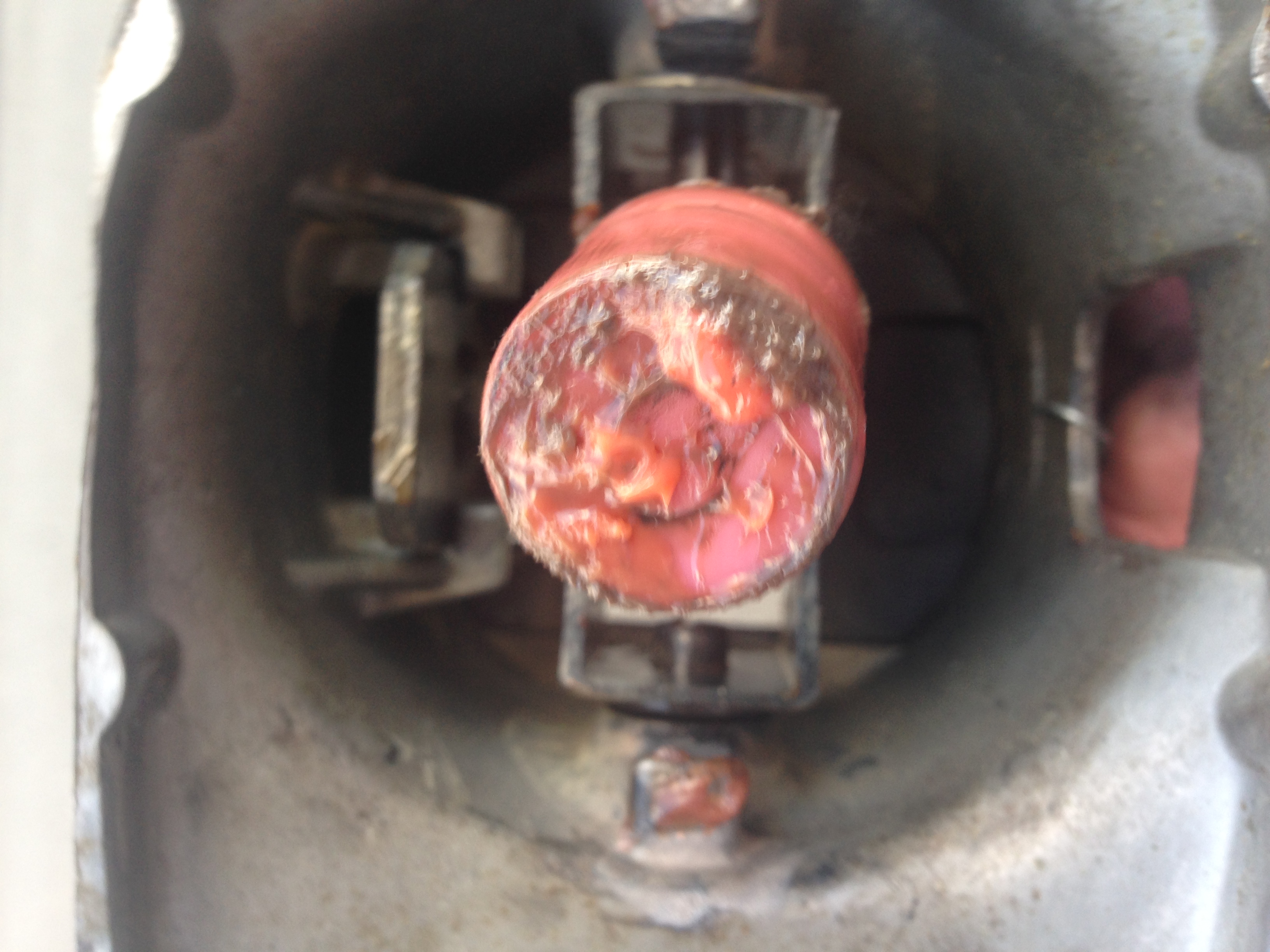

This is part update / more questions. 915 shifter and transmission connected to Chevy 330ci. Could not get in reverse so recommendations were to look at bushings and coupler.
So far, it looks like the two bushings on the shifter assembly are shot. Please see attached pictures and please confirm they are toast. What is the guk build up - is it the plastic breaking apart?

The 'gunk' is probably some sort of lubricant, and the bushing is definitely toast. The firewall bushing replaces from the engine side, the guide bushing under the shifter is easy once the shift tower is off, and placing them in some boiling water before trying to install it will lessen your frustration ( and cursing) when installing them. Might as well replace all the bushings at the same time as they're inexpensive and it'll shift much nicer.
post Nov 20 2016, 04:46 PM
914-6 GT in waiting
Posts: 19,956
Joined: 19-September 09
Member No.: 10,825
(IMG:style_emoticons/default/agree.gif) each bushing is under $10. New is good.
