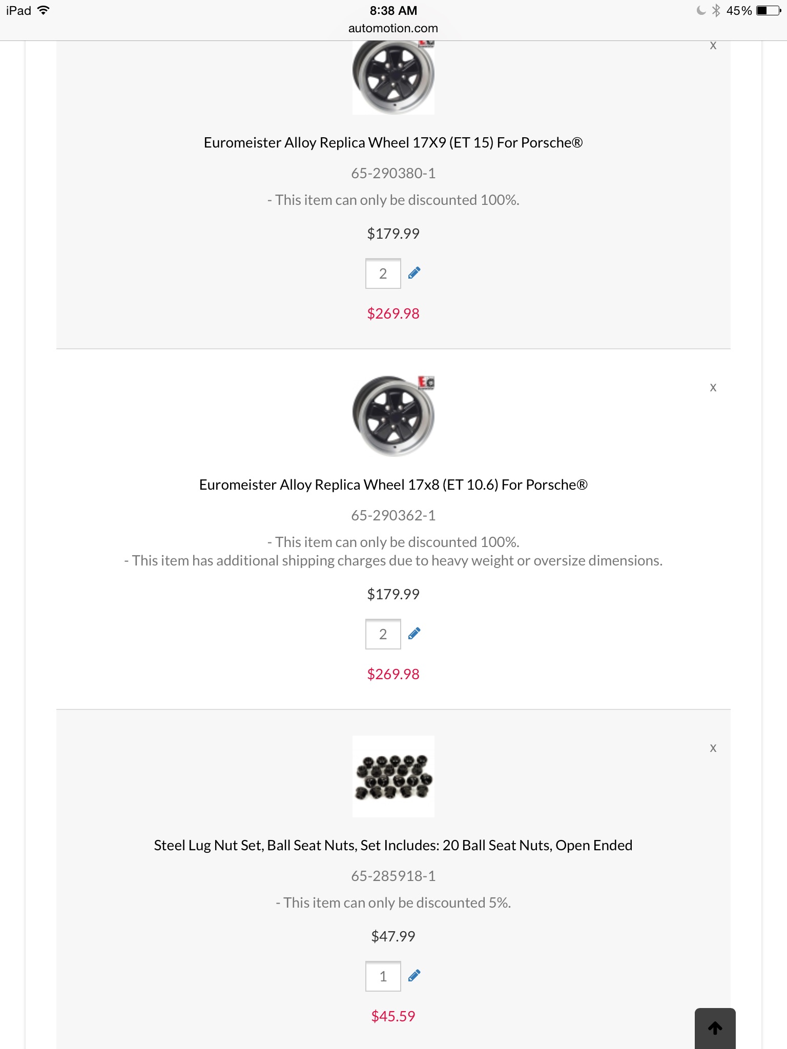

I'd ask them for the 100 percent discount they indicated... (IMG:style_emoticons/default/blink.gif)

I wish I had more coupons to approach 100%. I felt pretty good getting close to 50% off. I'd be lucky to get one 9" Fuchs at what I paid for an entire set of Euromeisters with lugs shipped to the house. After I sell the 16x7's I can get some tires.
I wanted to keep the 16's but there was only 3 tires to choose from in a staggered set. With the 17's I have close to 40.
