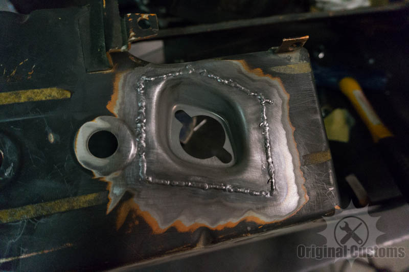

About a year ago I struck a deal with Pete at Restoration Design to start reproducing the 914-6 dash piece. I gave him a discount on a fuel injection system in trade for the die development costs. He finished these up awhile ago, and they're now available on his web site. But it wasn't until now that I had time to install one. It's a pretty easy process that I'll detail here.

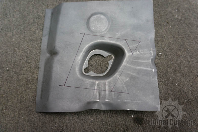

Here's the repalcement piece from RD. I intended the design to be cut apart and not installed as one piece. The idea is that you can mark the lock section and cut it out. And then what you're left with is the new piece and a template to mark the location where the new piece goes. The switch 'bump' and the little notch at the bottom of the dash are the alignment markers. It's not idiot proof though, so measure twice and cut once.

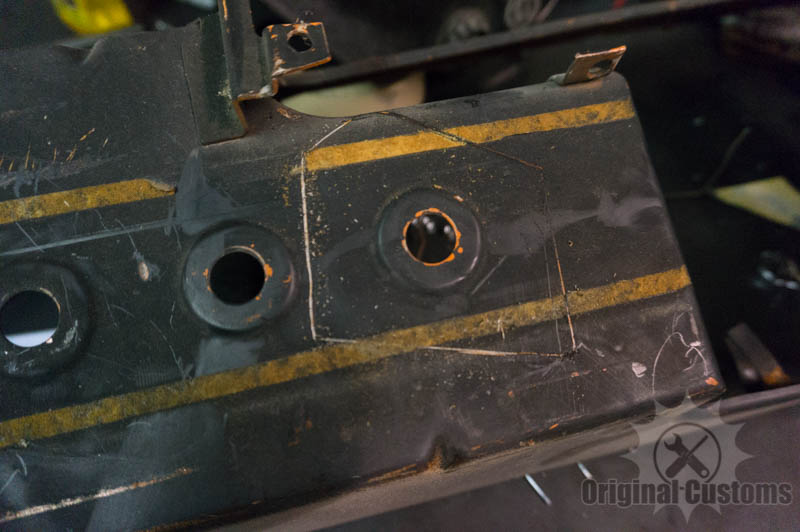

Marking where I want the cuts.

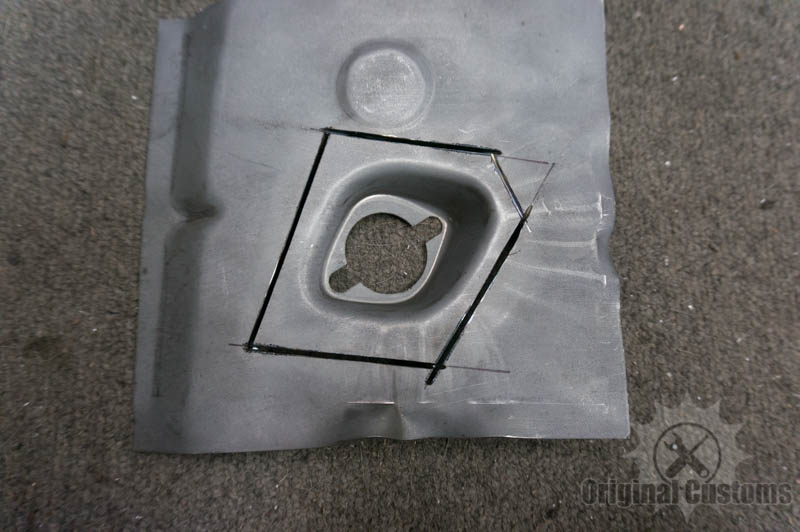

Precision cutoff wheel work. (IMG:style_emoticons/default/sunglasses.gif)

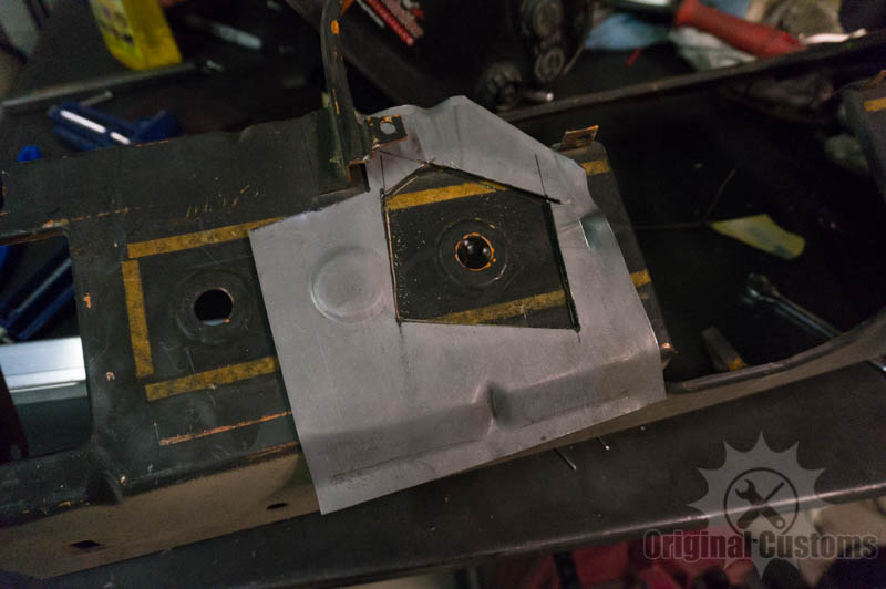

Template in place to mark dash for cutting.

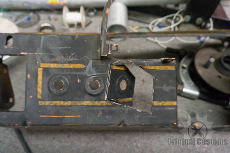

More precision surgery. (IMG:style_emoticons/default/av-943.gif)
Replacement piece fits in the hole.

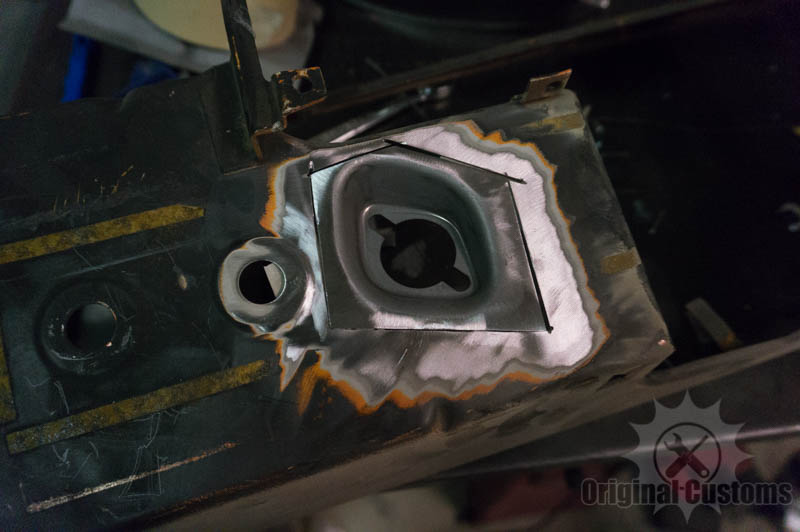

I TIG welded it, but MIG works fine. Go slow, take brakes. Heat is the enemy.Attached Image

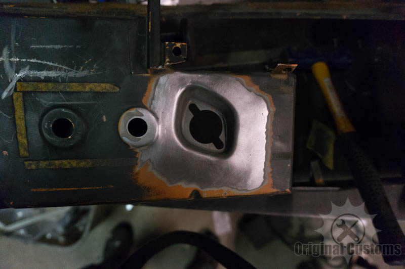

Grind and smooth to a no-filler needed finish.
All in all, it took me almost exactly 2 hours to install the piece. It's lined up perfectly with the other holes and it's ready for install.
