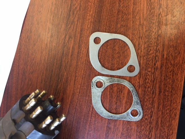

Is there a member with a six that that is willing to send their reinforcement "washer" to McMark so he can have these laser cut

QUOTE(Harpo @ Mar 14 2017, 01:21 PM) *
I have this piece and also a laser.
I can work on this and sell it with the other stamped piece.
Pete

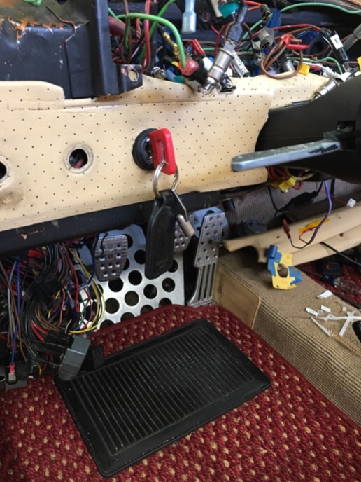

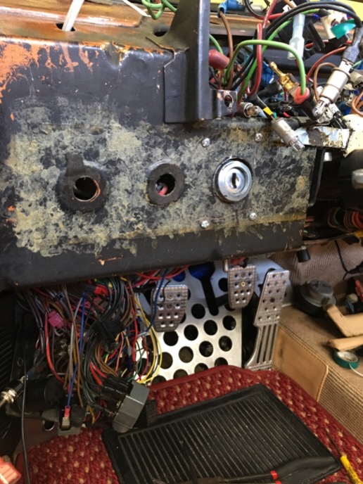

Installed the Jeff Hines left-side ignition kit.

That's my support ring in the photo and bought it last year via Mittlemotor at the time it was still available
Pete, for any reason if you can't find yours / NLA I would be happy to post over

Yes I borrowed sixerj photo to help emphasize my point

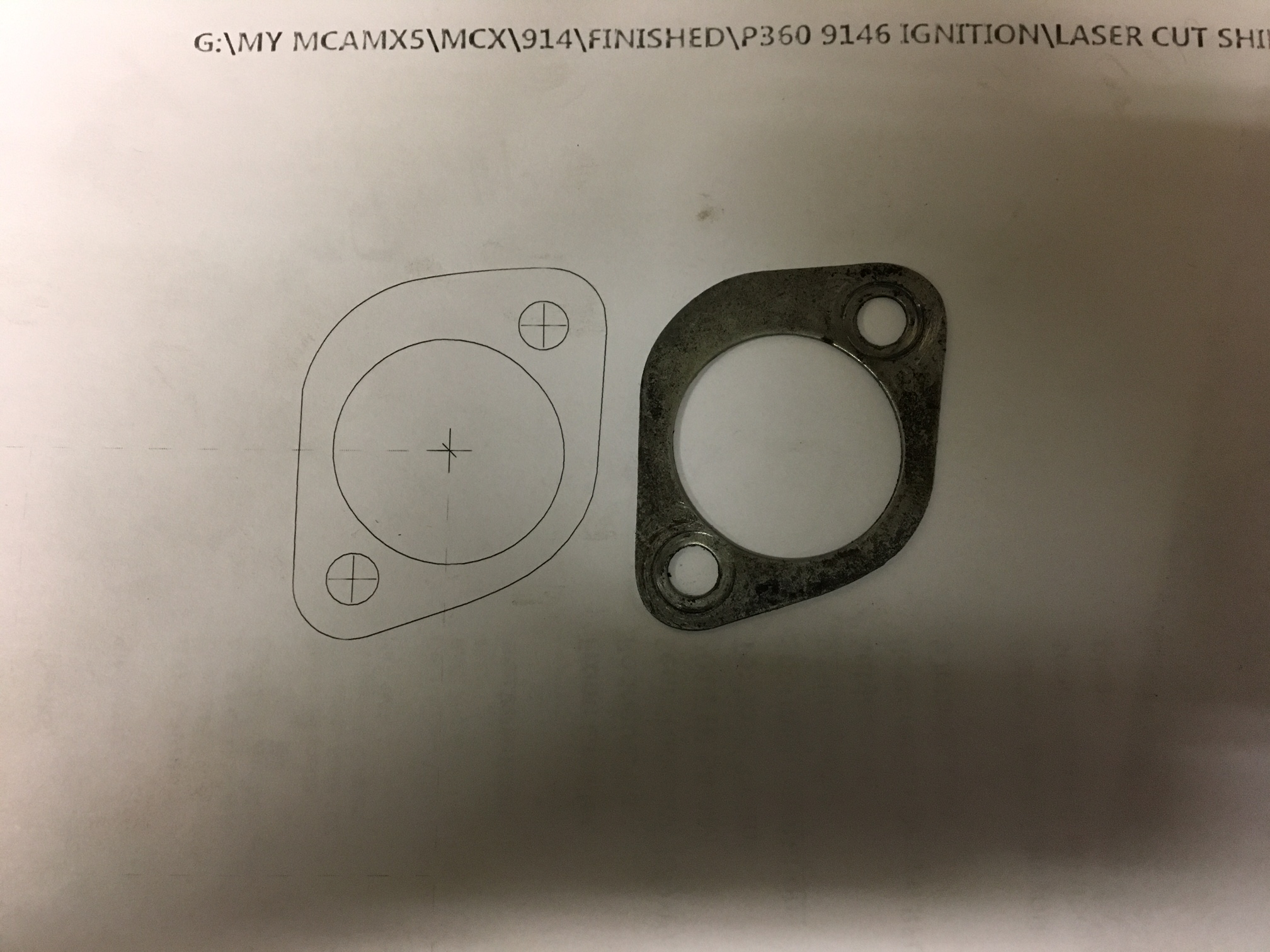

Here is the preliminary drawing. In the next couple days I will cut one out on the laser and see how it matches up to the OEM piece.
Pete

QUOTE(peteyd @ Mar 16 2017, 10:57 AM) *
Pete
Please add me to the list; I will order 1

I cut out the shim today.
It fits on the ignition nicely and matches up the original piece nice as well.
Next week I will cut them out of the proper gauge steel.

Good afternoon Pete,
Is there any chance you would consider making the "washer" a little thicker?
Thanks
David
QUOTE(peteyd @ Mar 16 2017, 09:57 AM) *
