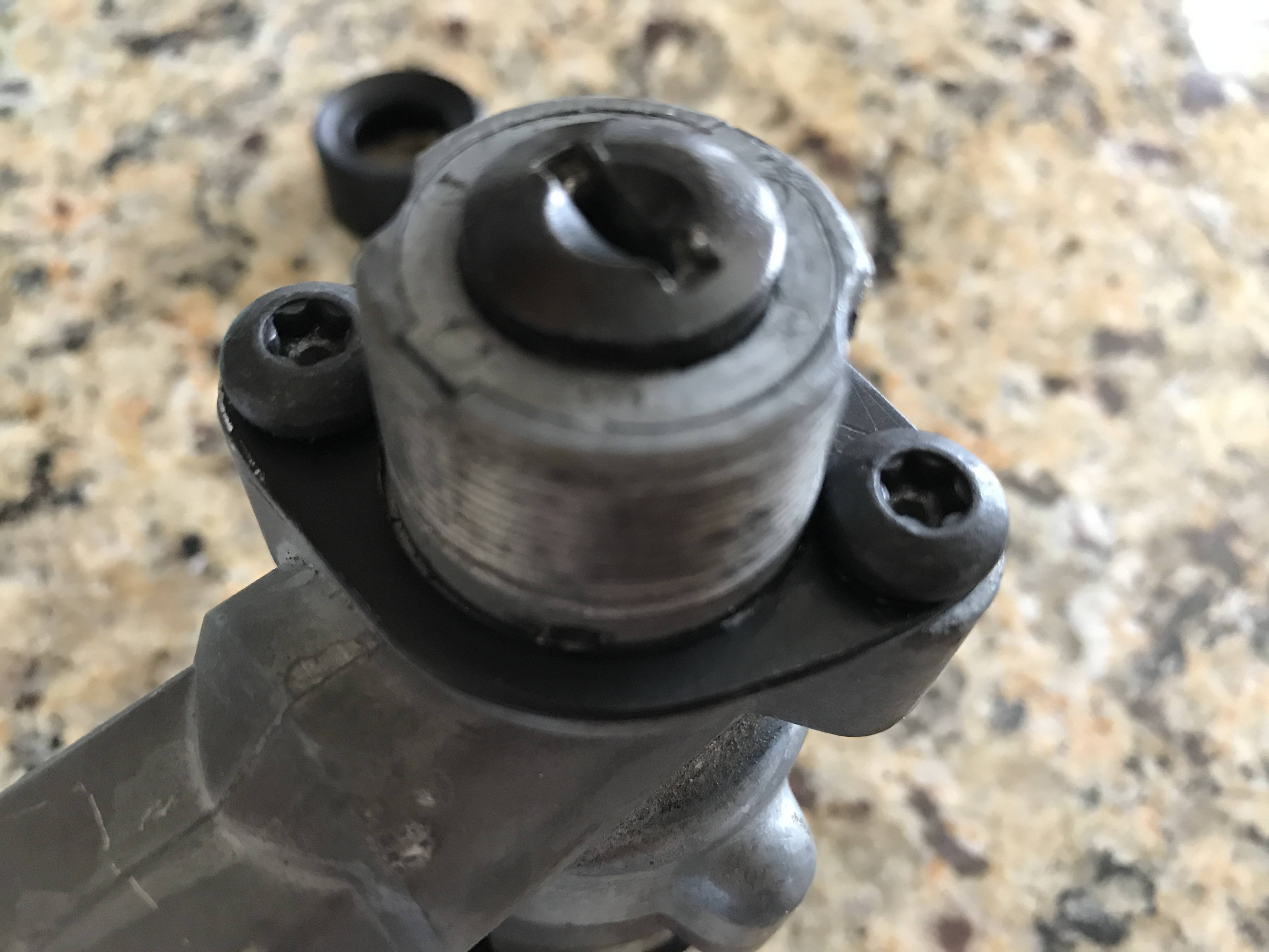

Originally the thickness is .035"
What do people want? I have material that is .045" and .032" It will be cut out of galvaneel steel, which wont rust so there is no need to paint it. It also polishes up pretty nice with some scotch brite
I can cut either thickness, but I don't want to cut both.
Pete

QUOTE(peteyd @ Mar 18 2017, 12:07 AM) *
Pete
Pete, I would be really tempted to do it out of the thicker material. My new one I recall is very thin and yours looks like it has pulled up in where it has bolted up. I can't see that it's going to make a difference in mounting up, clearance with the plastic escutcheon etc
Thanks for doing this BTW and demonstrates exactly why this site and members are great (IMG:style_emoticons/default/beerchug.gif)

For those that have requested a thicker gauge metal, this may have been deliberate by Porsche. I've had a few of these and some customers' as well. When they distort they are very easily flattened back with a standard hammer and a flat surface and are good to go.
Don't forget that this is a malleable fixing plate to install the heavy unbalanced 911 style ignition. The weight and design of this ignition, and the way these older cars go down the road make the ignition move a lot even when properly installed. I think the thinner gauge and softness of the metal are supposed to behave more like a crush washer so the plate takes the impact and vibration from daily driving, instead of the soft threads of the mounting holes in the zinc casting of the steering lock housing.
This is just my opinion and reasoning. Then again maybe Porsche just cheapened out, but I would rather save the threads and have the plate give out, not the $950 ignition assembly.

Because you have the .045 in stock that would be my vote.
A class 8.8 M6 bolt requires a minimum 9.6mm of threads of engagement. There are 18mm of available threads in the lock. Therefore with a 20mm long bolt the risk of damaging the threads in the lock are minimal. I under stand tweet's post it is a very expensive part.
I have found a suitable black pan head screw and I have extras if anyone want some for their clone or real left side ignition. If interested please send me a PM

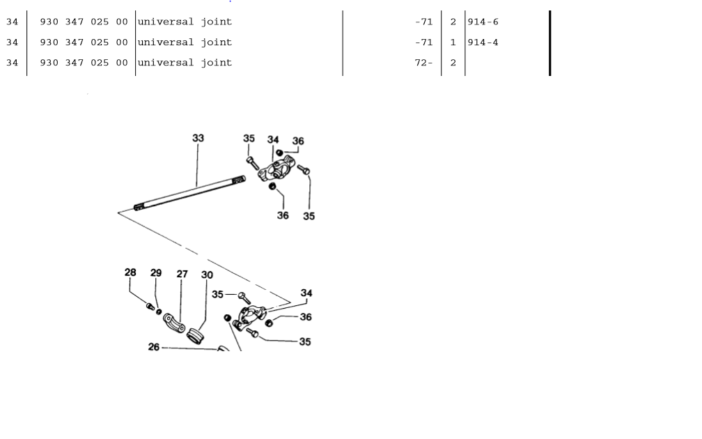

If the u joints are the same between the 914 & 914-6 then why wont my 911 steering shaft slide on to my U joint? I can't find any burrs or damage and it will slide on to my 914 steering shaft?

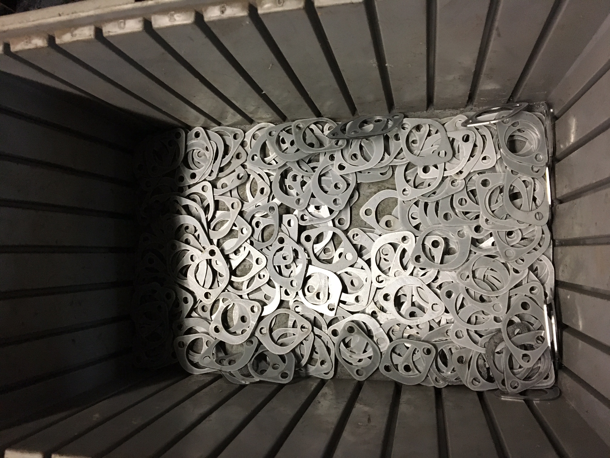

We finished cutting out the shims today.
They are cut from .045" thick material.
They will be sold with the dash depression piece I already make. If you want to buy one separately they will be $8. they are not on the website yet, so if you're dying to get one fast, then call and ask for Pete

That is great news since I'll need one too. I just wish it would have happened a couple of weeks ago when I ordered my dash depression piece.

I will bring a handful to Hershey if that helps anybody.

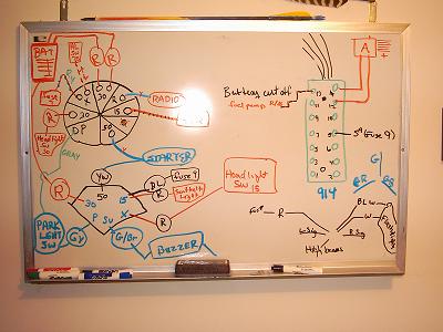

The electrical connections for the ignition switch and the wiper/turn signal stalks are obviously very different when converting to the 911 column.
Does anyone have a chart with the pinout locations?
Jeff B

QUOTE(jkb944t @ Mar 22 2017, 04:52 AM) *
Jeff B
I did a pin-out ID for the Ignition Switch; will take a pic and post later
Steve

This is all that I have been able to find so far
