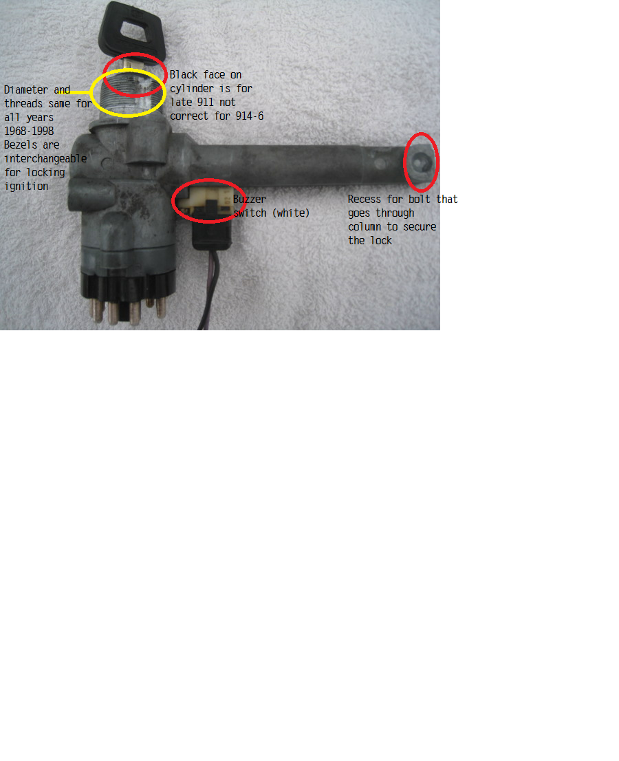

QUOTE(jim_hoyland @ Nov 26 2016, 07:04 PM) *
QUOTE(Larmo63 @ Nov 26 2016, 10:06 AM) *
I found this older 911 switch and thought it might work?
Will that lock use a regular 914 key ?
No, that is K100/K300 style 356/911 key. The 914 uses an HC/NC key profile. They are not interchangeable. The face of the lock is also distinguishably different. A show judge would notice it immediately. That ignition lock also has spade connectors. The 914-6 ignition switch has bullet connectors like the 911.

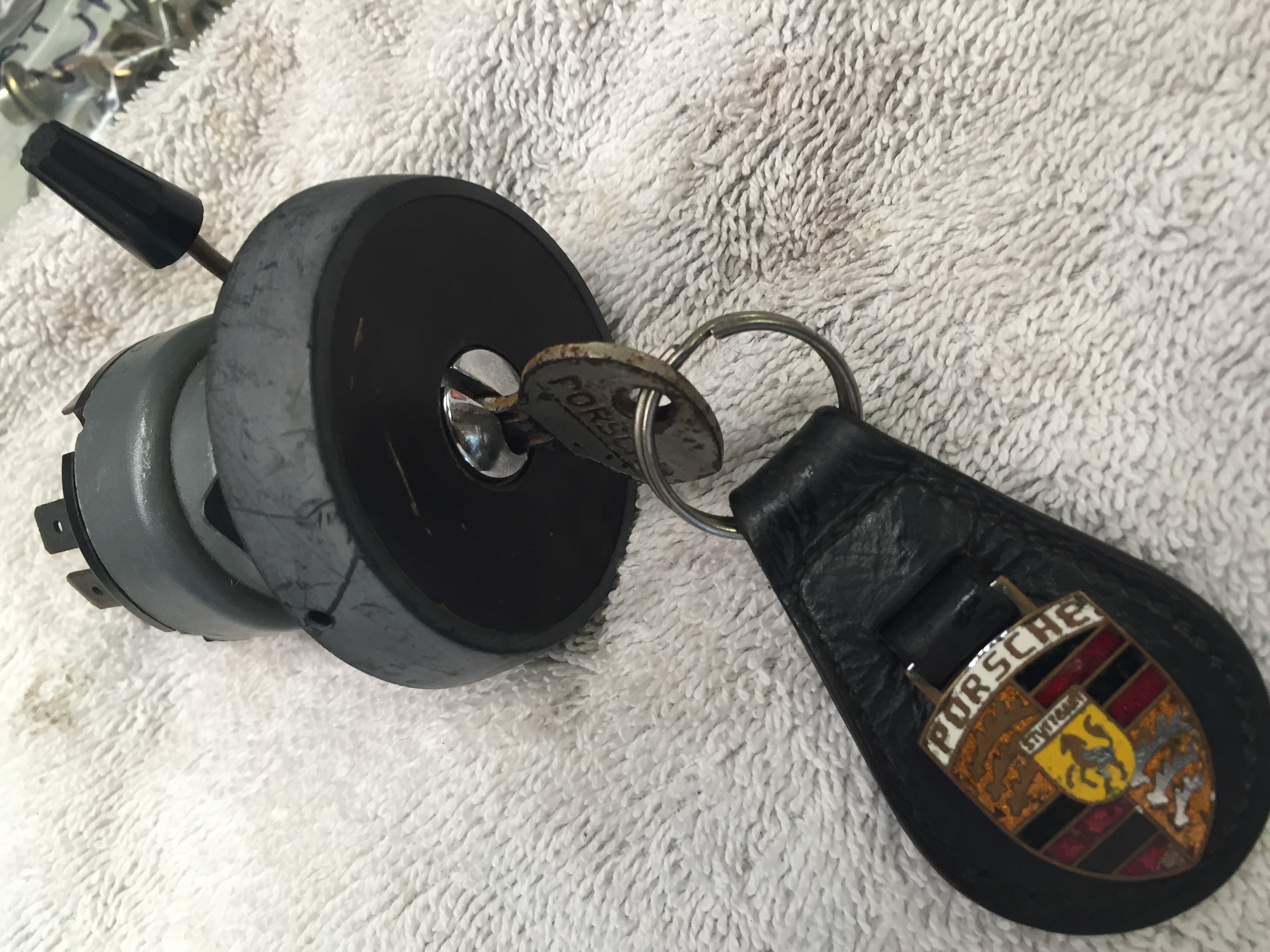

QUOTE(sixnotfour @ Nov 28 2016, 12:00 PM) *
its the same as the same year 911, but the PN is superseded to the later aluminplate
911-347-621-00 SS 91134735901 911,347,359,01
That aluminum plate acts as a retainer and a spacer. It is for late 911 ignition locks. The later style uses a shallower (flatter) all plastic bezel. The earlier locks had a couple of different versions of retainer; just punched metal. The bezel is thicker and has a black metal insert or polished steel insert (like the picture above).

QUOTE(jim_hoyland @ Dec 5 2016, 06:19 PM) *
QUOTE(Steve @ Dec 4 2016, 12:04 PM) *
What if you don't care about the column switches. Can't you just cut the arm off of the 911 ignition switch. Keep enough of the arm to use the buzzer switch?
Is the buzzer switch the part to the right of the main tumbler ? IIRC the mechanism at the end of the arm will have to work; spring loaded ?
The 911/914-6 steering lock will all mount the same way, but there are subtle differences throughout the years. It's up to the owner if they want to be period correct in appearance and have correct profile key. Early locking ignition had spade connectors not bullet.

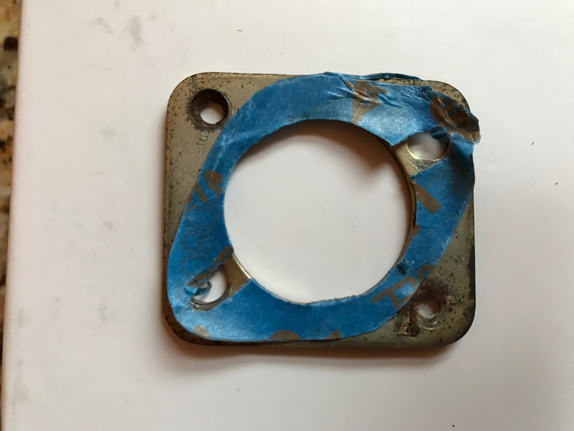

Hey Mark any luck with this reinforcement plate? Otherwise I will modify an old 911 to fit with marginal results. I made a crappy pattern of the inside of the 914-6 dash and transferred it to a 911 piece
Harpo
post Jan 16 2017, 01:10 PM
Post #77
Posts: 1,304
Joined: 21-August 11
From: Motor City aka Detroit
Member No.: 13,469
Certainly not perfect but it will work in the short term
Attached ImageAttached Image

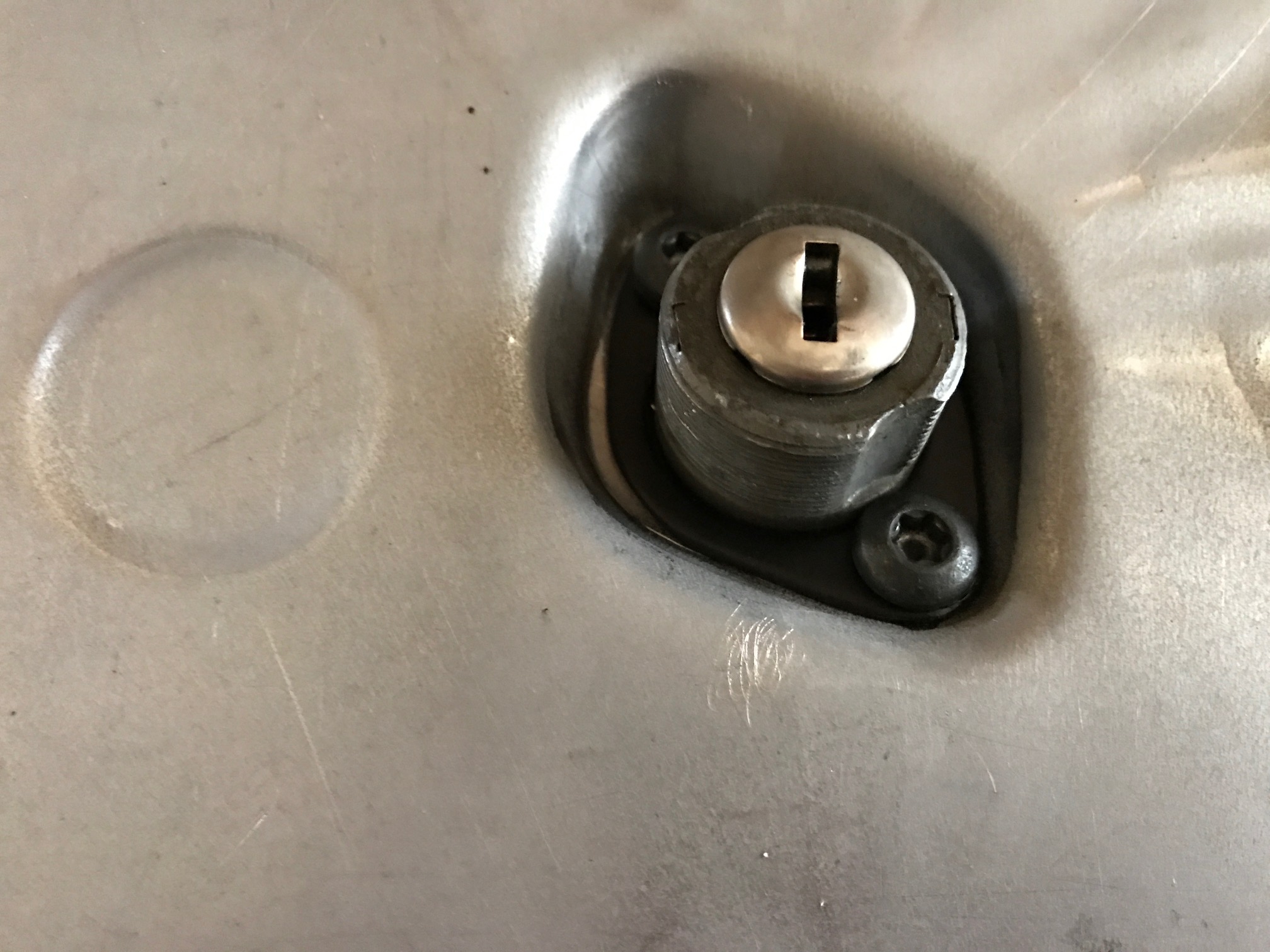

Member No.: 9,892
How come the -6 dash as such a deep recess versus a 911 ?
Harpo
post Jan 16 2017, 04:31 PM
Post #79
Posts: 1,304
Member No.: 13,469
I believe it has to do with the angle of the dash.
