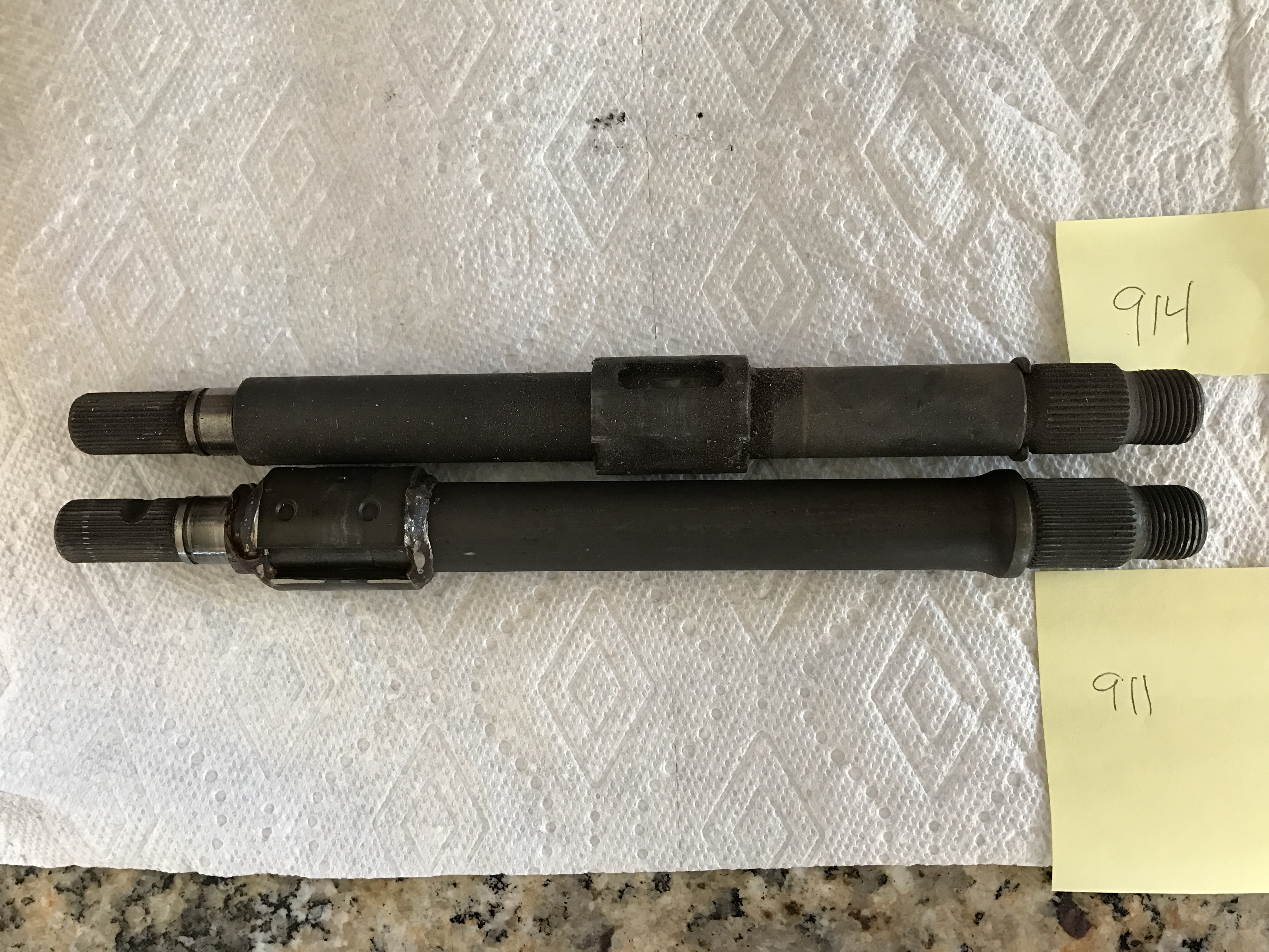

It appears that the 914 & 911 column are very similar. The lugs are certainly different between the 914 & 911. Has anyone confirmed if everything else is the same. Same goes for the lower bearing, they appear to be interchangeable.
Thanks
