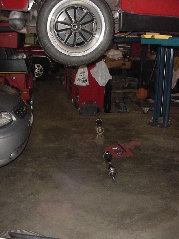

Yup they are 911 axles. I pulled them out tonight.
Attached image(s) ![]() |

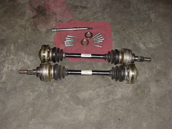

Another Pic. I took out the spacers and got the axles back in tonight.
I still need to torque the axle nuts when I put the car back down on the ground. Attached image(s) ![]() |

Did you find any dimples or dents on the caps?
John |
#14
member? what's a member? ![]() ![]() ![]() ![]() Group: Members Posts: 3,393 Joined: 30-January 04 From: Evansville, IN (SIRPCA) Member No.: 1,615 Region Association: None ![]() |
No there were no dimples or dents in the caps. They looked good to me, so I put them back in.
