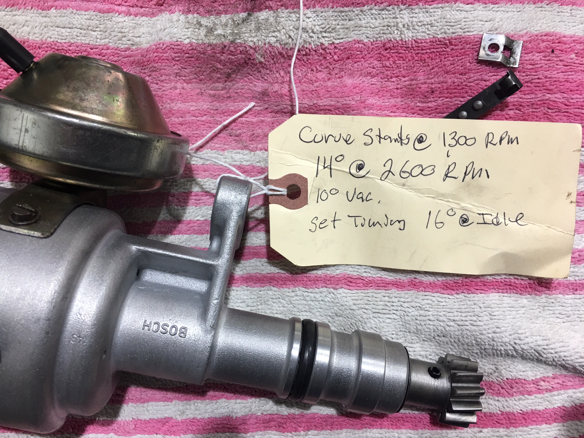

Revisiting some of my old posts and updating them...
So, I had an issue with my distributor (will make a separate post on this) and ended up swapping distributors and going back to points from my Crane XR3000 system (which had been replaced after failing, but that's another story). And guess what? No more run-on/dieseling after the ignition is switched off. So, yes, it was the Crane that caused the problem.
