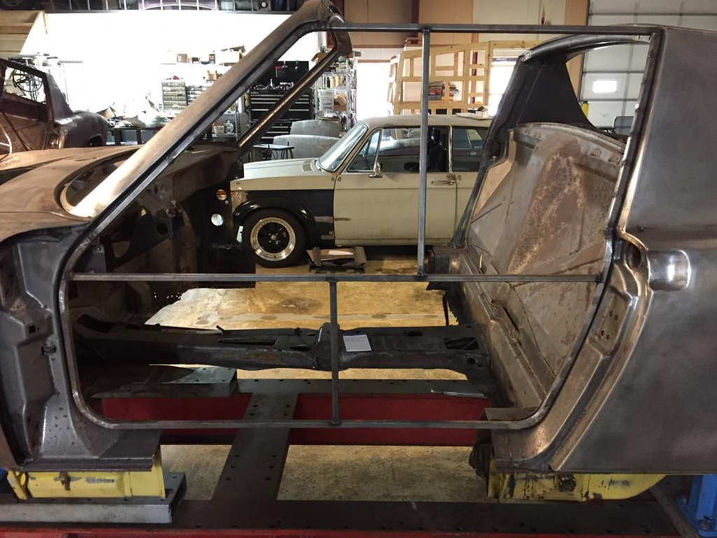

The driver side long was straighter, but still bent. And that became really evident when I cut into it and all the stress released. Practically popped from the bound up stress.
Floor pans weren't terrible either, except by the time I patched all the little rust spots I might as well do the whole thing. Plus I can clean and check inside the center tunnel.
It's pretty amazing how solid everything else is though. Not a bit of wobble or mobility to either half of the car. I (IMG:style_emoticons/default/wub.gif) my Celette bench.
Good thing we had that straightening party... (IMG:style_emoticons/default/lol-2.gif)
Seems that way for sure. But really that helped a ton. I'm pretty dang happy that this is all I have to deal with. What Andy and Yeoman put into this car already was the hard part. This part is relatively easy.... I said relatively! (IMG:style_emoticons/default/lol-2.gif)

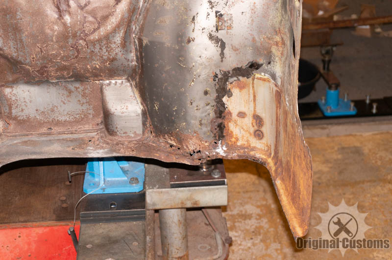

Cleared out the last remnants of the longs. There's quite a bit of minor straightening to do on the right side. I might cut out the bent up dash section next week. I suspect there's quite a bit of stress hiding there. And fitting up the replacement panel may illuminate a few more alignment issues. We'll see.

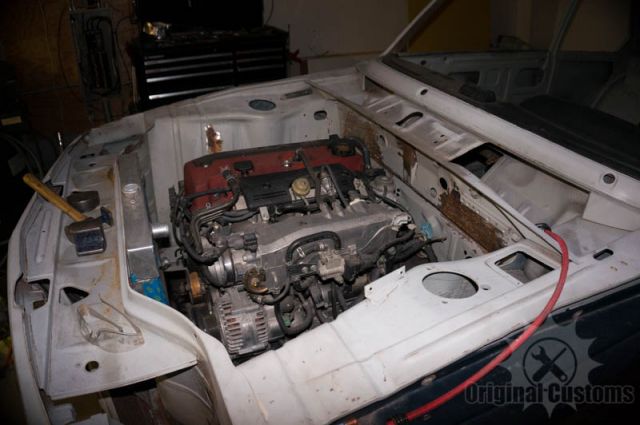

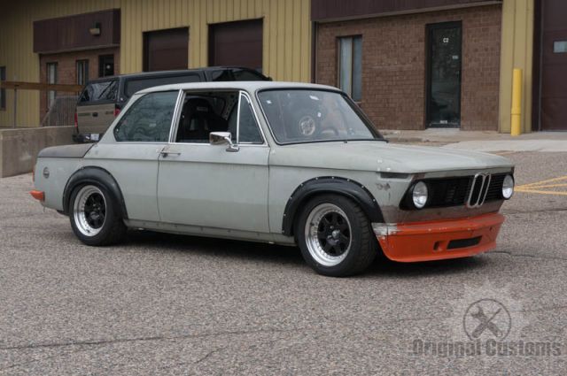

1973 BMW 2002 - 2003 S2000 motor/trans swap running stock Honda injection, fully integrated wiring. Custom lowering front and rear. Custom front valence. blah blah blah (IMG:style_emoticons/default/shades.gif)

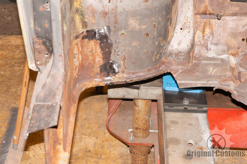

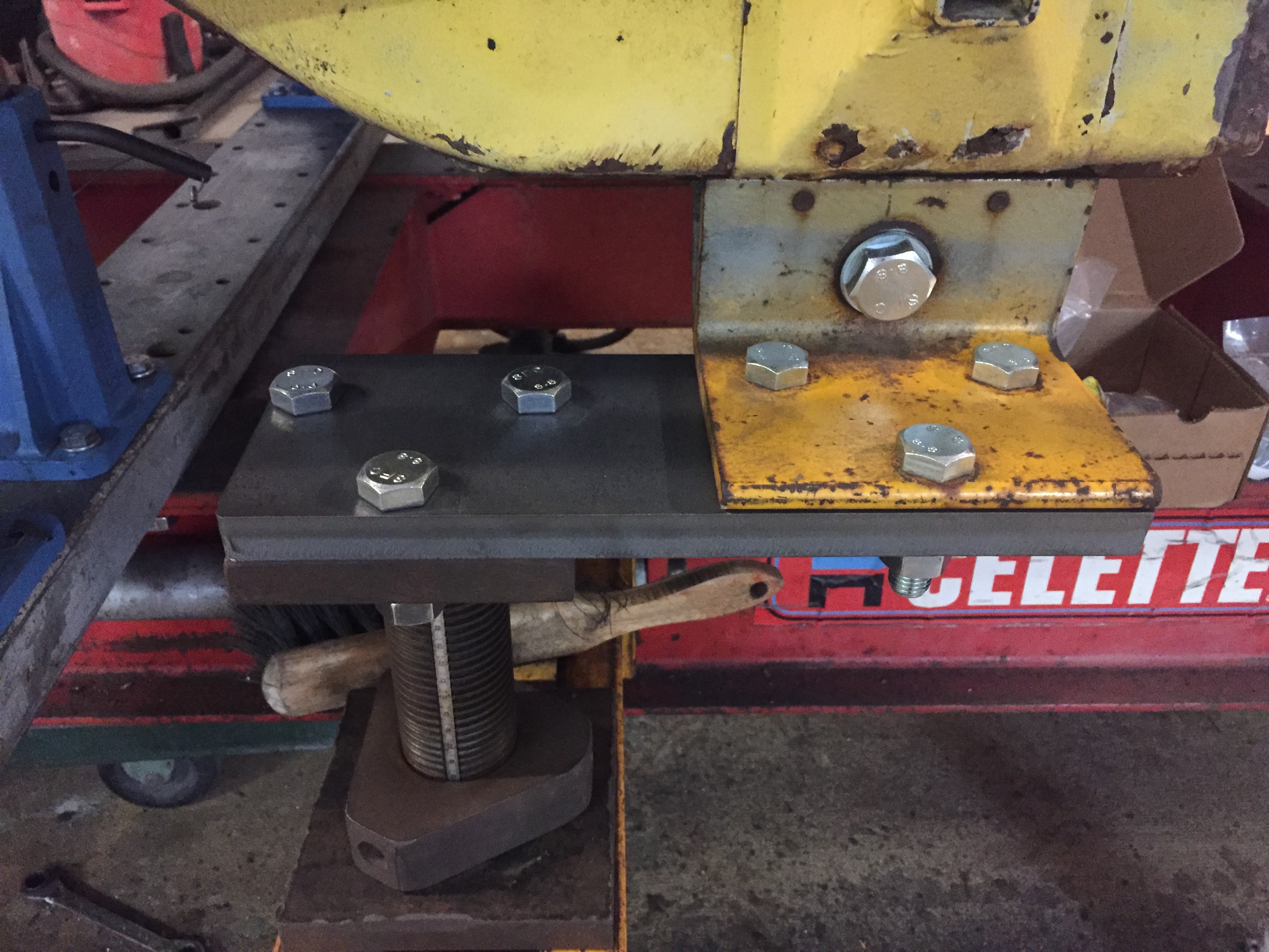

Another aspect Celette didn’t consider with the MZ towers. The rear pinch clamps don’t reach. So I had some 3/4” plate laser cut to extend the clamp forwards.

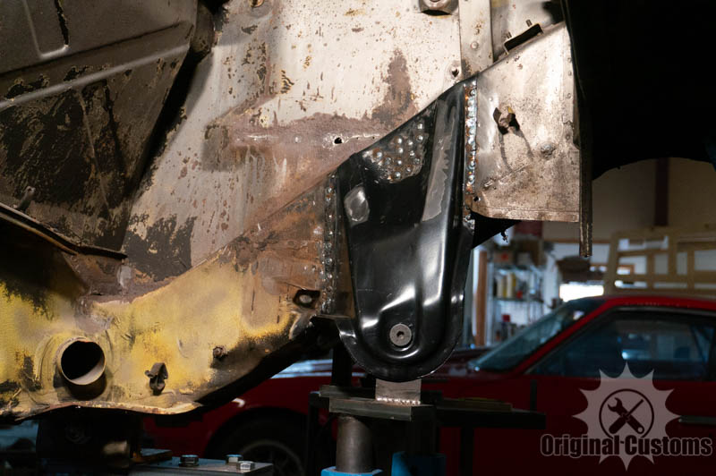

The first bit of new metal! (IMG:style_emoticons/default/boldblue.gif)
