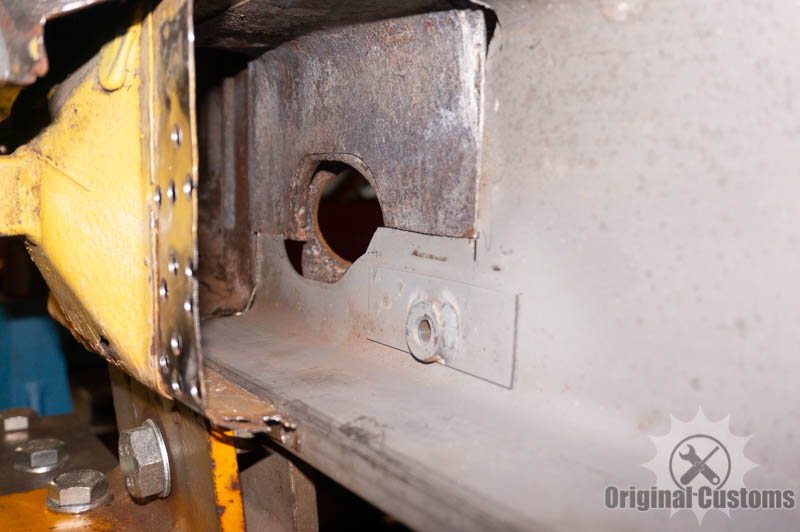

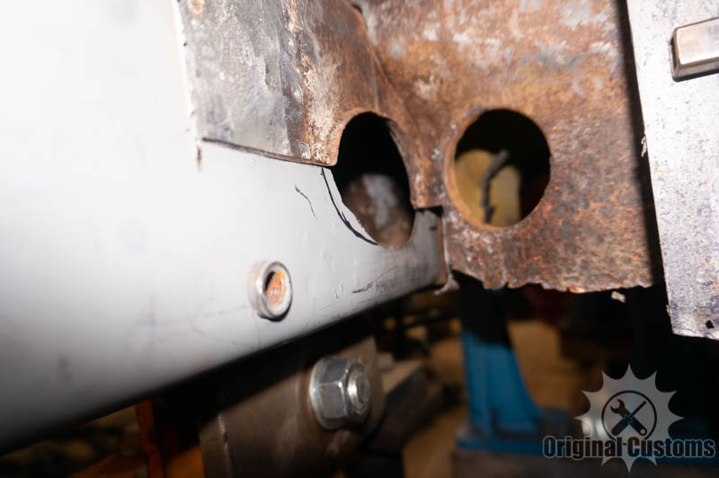

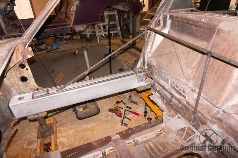

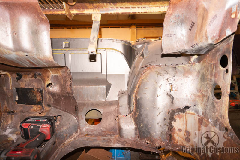

Moved on to the front end. We have a cut section from another car to swap in. The right fender well is gonna need a lot of massaging to bring back into place. This will give me access, and as I mentioned previously, fitting the new piece will illustrate any minor misalignment.
More work to do here, but the next big step will be fitting the new longitudinals.

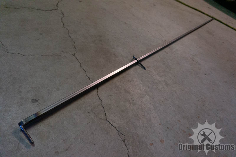

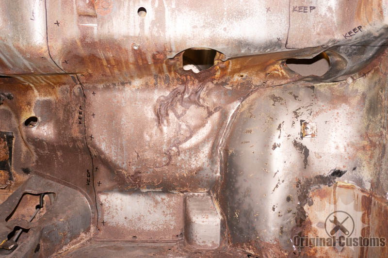

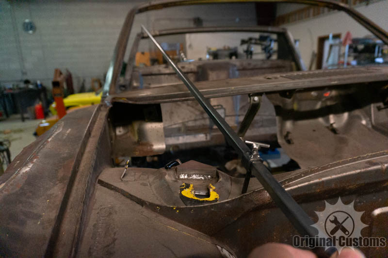

Little more progress. Got a few small wrinkles worked out of the center tunnel.
Attached Image Attached ImageAttached Image
Also built a measuring device (I've since learned it's called a tram gauge) to check measurements left to right or from my purple car to Andy's 6. So I made a few adjustment tweaks to pull the front shock towers into alignment.

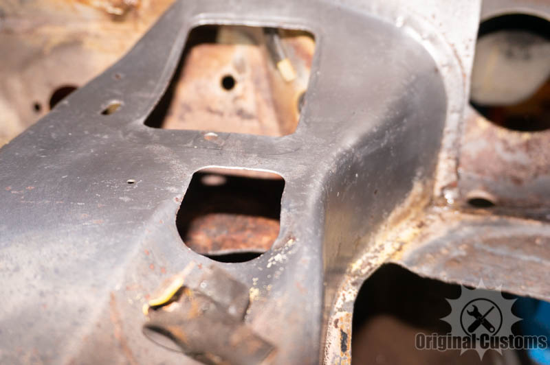

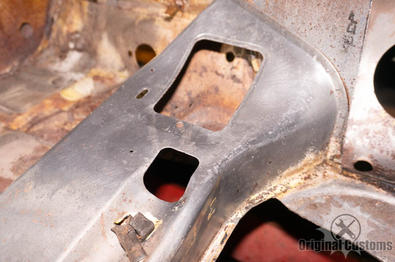

Yeah, I'm still alive...
Built a lot of jigs, measured a lot, and scratched my head a lot trying to make sure everything will line up where it needs to go. Finally got to the part where I start putting metal back into place. And guess what I learned? This inner long piece is about 0.25" shorter than the original. (IMG:style_emoticons/default/dry.gif)
Gotta figure out how I'm gonna deal with this. Maybe there's another brand, or maybe I'll CAD one up and have my CNC lasercut & bending shop make me a custom one. (IMG:style_emoticons/default/head_hurts_kr.gif)
