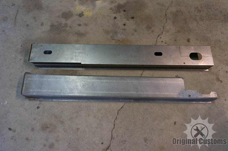

This inner long piece is about 0.25" shorter than the original. (IMG:style_emoticons/default/dry.gif)
(IMG:style_emoticons/default/headbang.gif)
(IMG:style_emoticons/default/sad.gif)
Is it an 'R-D' piece? (IMG:style_emoticons/default/confused24.gif)

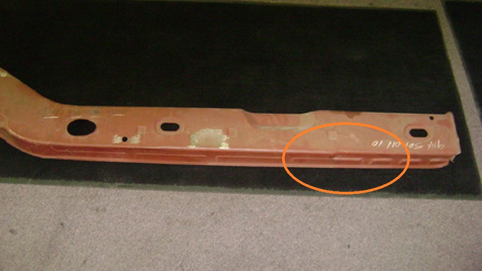

Pretty sure that's a AA piece. I had that same piece and then purchased the long section from Germany. It's a repo to the factory part but it was also shorter.
I finally found the right factory section for my 6 repair. It's not gonna be an easy fix. As Mark has stated lots of measuring. I recently purchased a set of 914 chassis fixtures which should help in fixing my 6.
Mark, when I was looking at using that long section from AA I found a few problems with it. The seat belt mount location was off, hot air tube hole was way too small, and needed a lot of fitting to fit proper. Hope it works out.
Sounds like we're talking about the same part. That's my complaint list too.

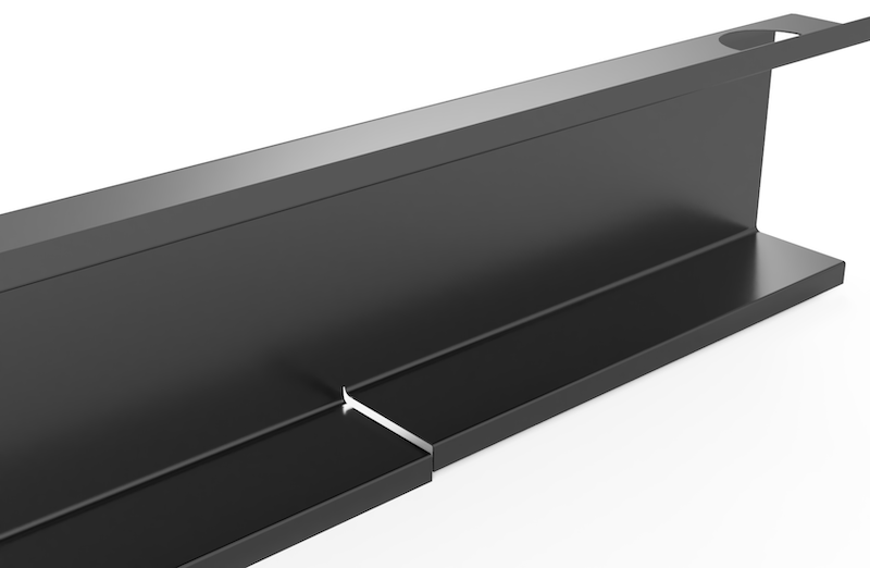

Got started on the drawing, but found out the front of the long is shorter than the back to accommodate the 'rise' in the floor pan. Duh. But I'm asking the shop if they can make bends this close together. If not, I'll have to make it flat like the other repro parts. Or something else I have in the back of my mind. (IMG:style_emoticons/default/ph34r.gif)

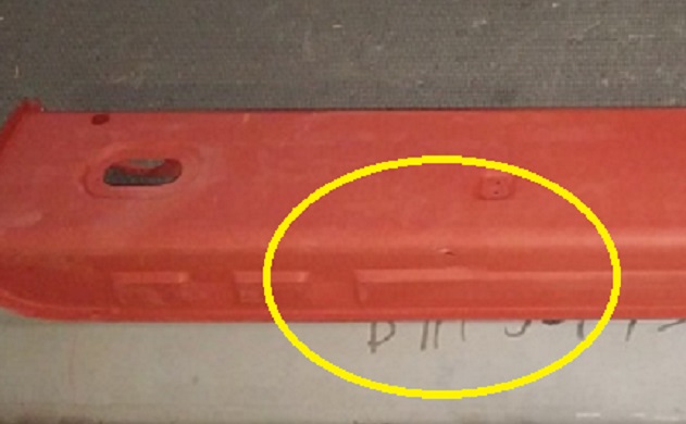

QUOTE(sixnotfour @ Jul 15 2020, 01:09 AM) *
pinch weld is straight regardless
Damn, good catch. Hmmm.... (IMG:style_emoticons/default/unsure.gif) (IMG:style_emoticons/default/wacko.gif)

McMark

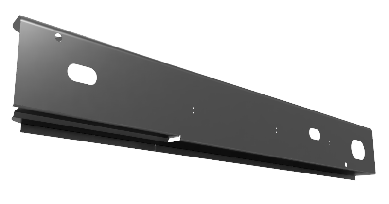

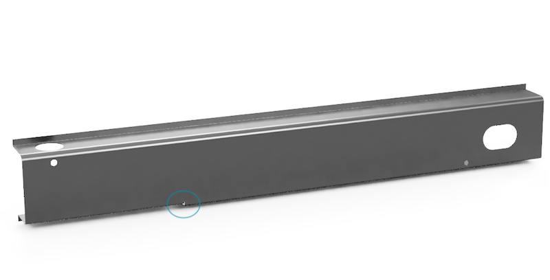

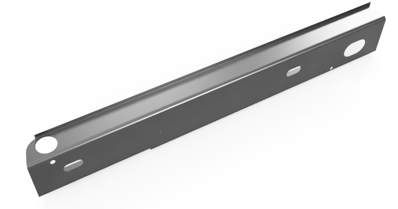

CNC shop called and said this design is totally fine. So after adding the last few features, I think this is the final -- unless someone else can see something I missed.

QUOTE(McMark @ Jul 15 2020, 02:43 PM) *
Give it some extra on the rounded end so you can bend it up to create the flange?

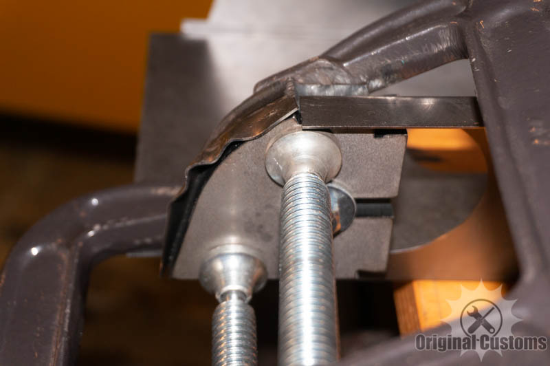

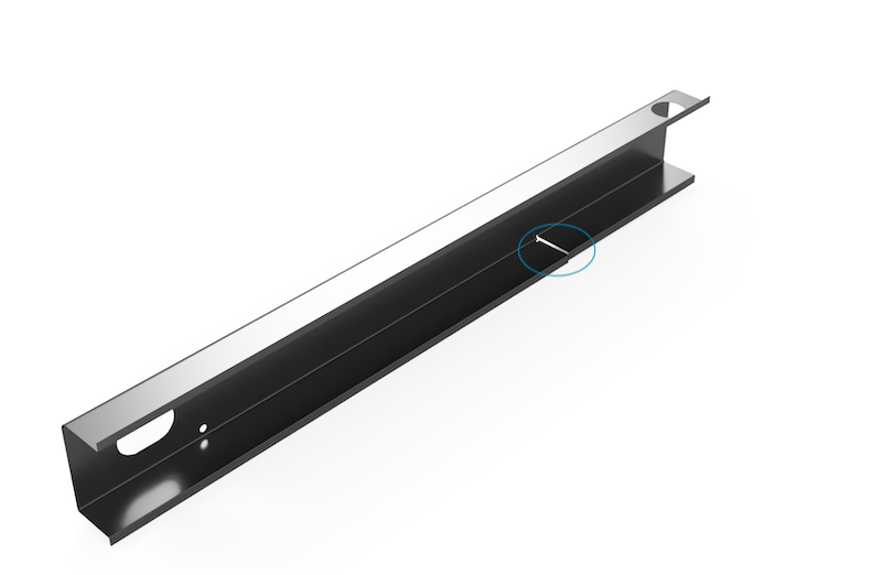

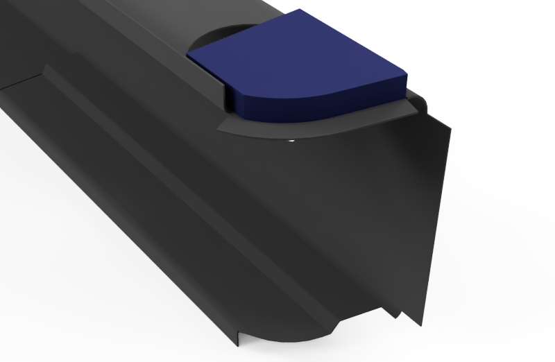

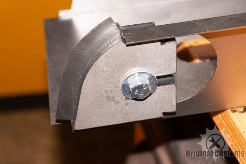

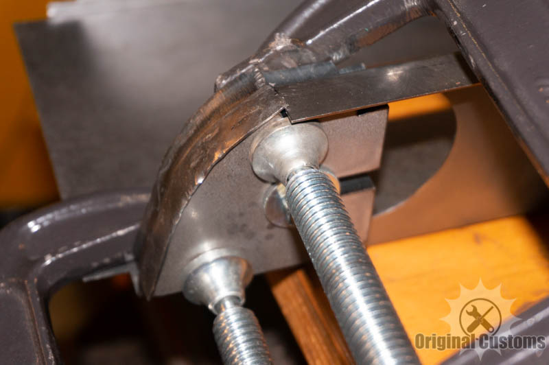

@SirAndy This what you had in mind? The blue block is a shaping tool I'll have them make so I can clamp it in place and hammer it into shape. I don't think it's worth chasing the bit of flange at the corner. But if you're really into it, I can have them cut a little curved piece and weld that into the gap. It's all time... (IMG:style_emoticons/default/unsure.gif)

QUOTE(McMark @ Jul 16 2020, 03:02 PM) *
Hammer away, that looks good. Should have known you already accounted for this.

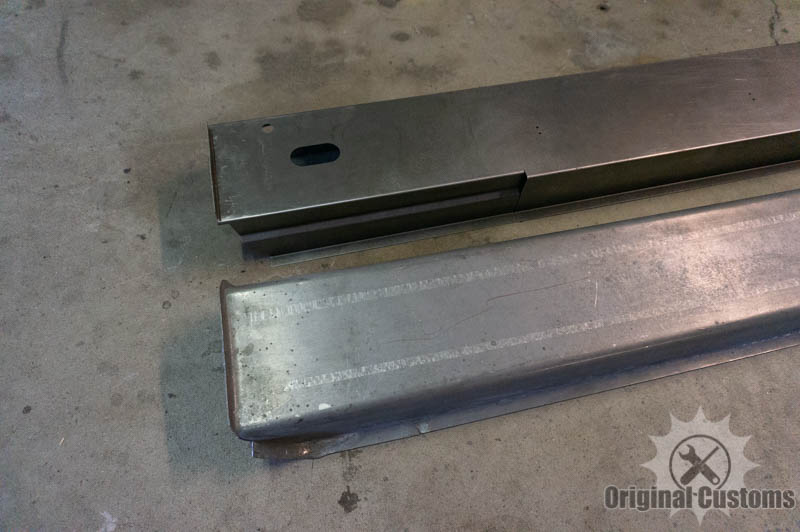

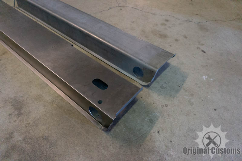

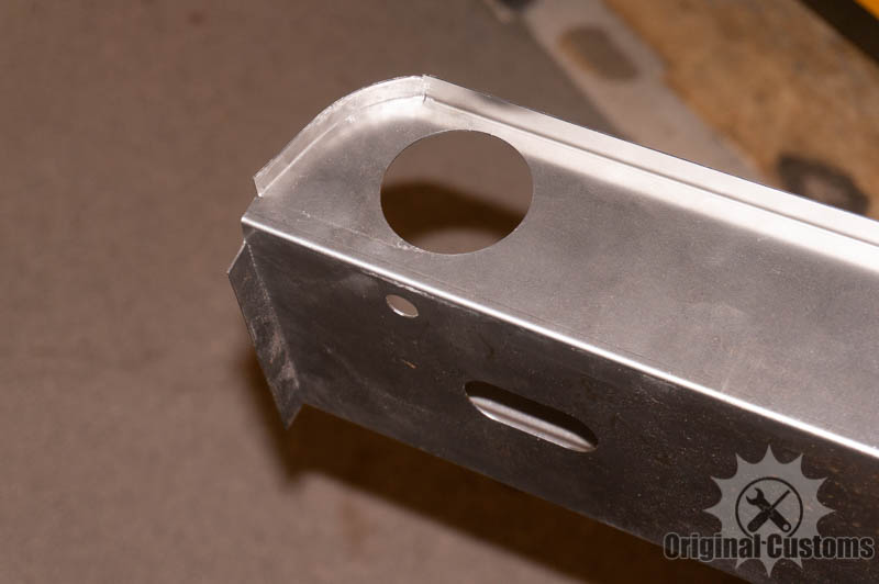

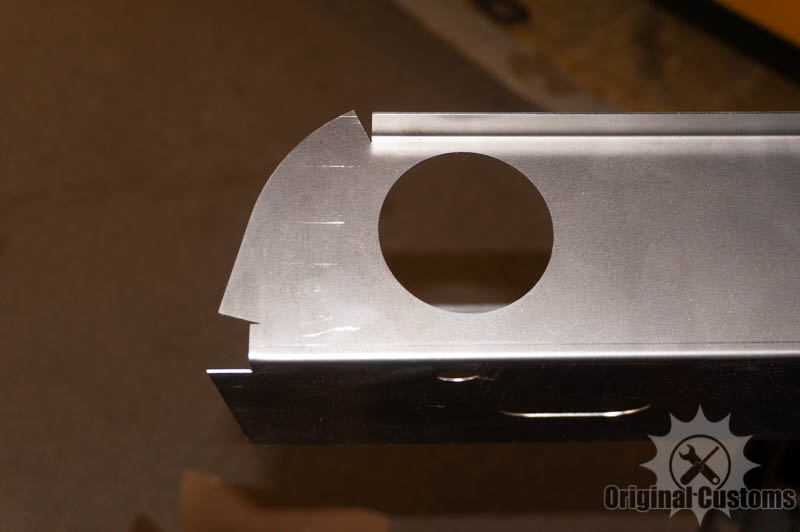

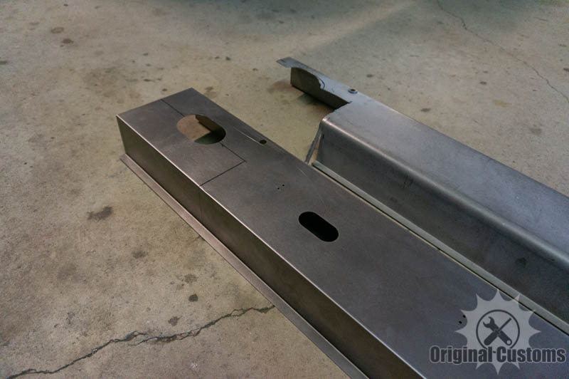

Got the new piece. Really happy with how it turned out, except I need two changes. 1) I had it made in 20g, which is the stock thickness. But I pulled out the driver side piece I have and that's 18g. I should have checked that first cause I want them to match for equal stiffness on both sides. 2) The top radius bend is just a hard 90 instead of a radius bend. But I did bend over the flanges at the front (by the heater tube) to make sure those worked, and it turned out great. If anyone is interested in buying the 'castoff' part, PM me.
BTW, the driver's side piece I have (HESS, apparently) is correct dimensions, so I won't need to go through this again.

Mark,, I applaued your efforts,,The radius is to tight..get a Hess right side..at least it matches the left...wtf Sir Andys paying.. pun intended..
