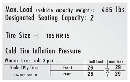

FWIW the 1971 owner's manual and the 914 Porsche Technical Specifications book (May 1974) call for 26 front and 29 rear for both the 155 and 165 SR 15
tires. I've never liked this, as Brant says above 30- 32 works better - even for stock size.

This is on my expaion tank, never went by it after going 205 x 16 x 55
Found 35# a little hard but 32 works well
