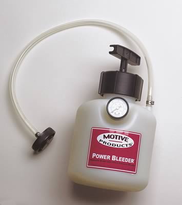

Or a pressure bleeder. That way one person is sufficient and you don't have to worry about air past threads and what not. The pressure pot sits at the reservoir and pushes fluid through the system. You sit at the wheel and open the bleeder valve.
I have this one...
Basically you add brake fluid to the jug. Close jug. Then screw the cap onto the reservoir. Pump the handle a few times (I think 15psi IIRC). Not too much psi as you don't want to blow out any seals. Then sit at each wheel. This thing comes with a length of hose that you attach to the bleeder valve. fill a jar 1/4 of the way up with brake fluid. Put other end of hose in jar with brake fluid. Open bleeder valve. Bleeder device pushes air through the system, through the caliper and into the jar filled with brake fluid. This way you don't have air going back into the system. Pretty easy...

I use the Motive Power Bleeder, but I use it "dry". I don't put any fluid in the bleeder, just use it as a pressurized air reservoir. Still does the same job, but no mess when you unscrew the cap. The only potential drawback is that you have to keep checking the car's reservoir and re-fill it before it runs low (same as with the Wife/Assistant method).

Does the Motive Power Bleeder cap fit 914 brake reservoir ?
Yes and that's what I use with no problems.

We use the Motive Power Bleeder in the Coachwerks shop. I think it's the best way to get fluid past the pressure regulator etc.
