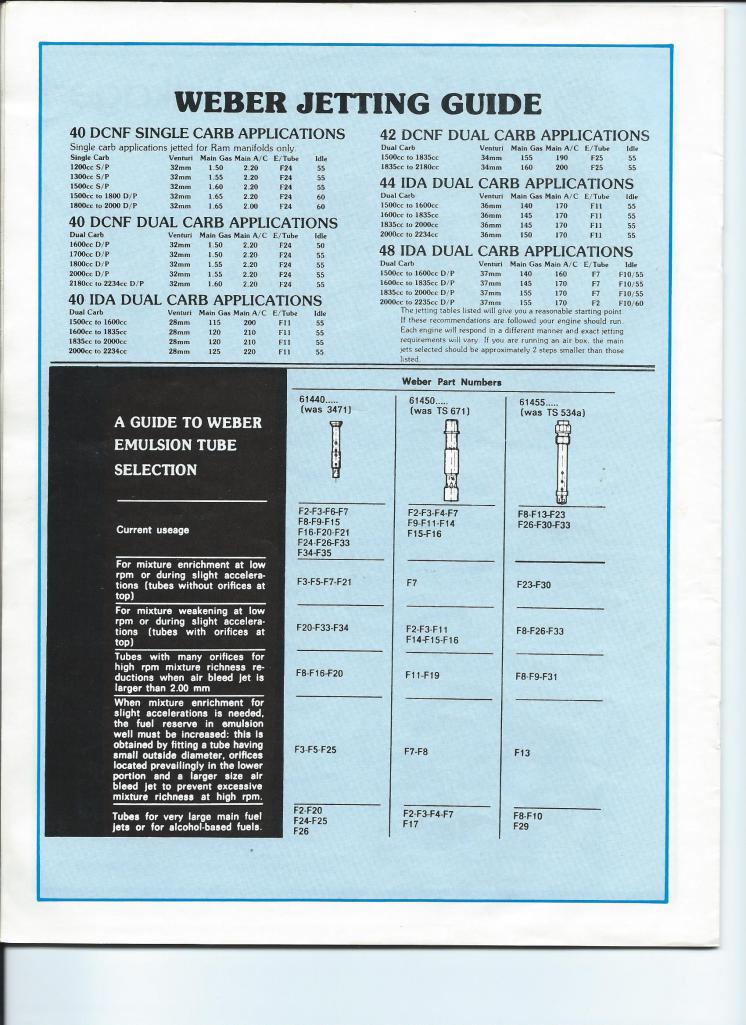

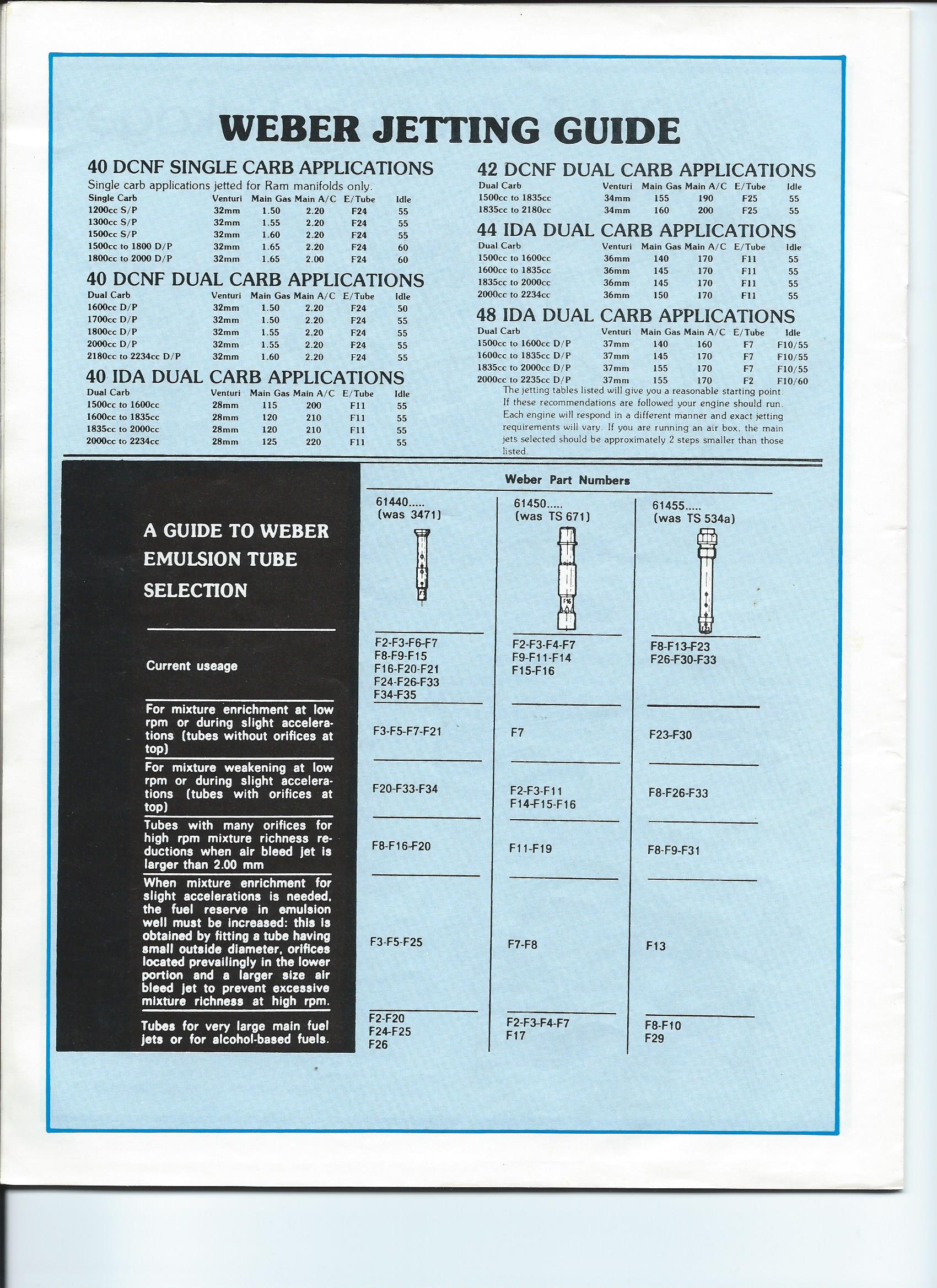

Here is a jetting guide from the Weber Tech Manual that CB Performance used to provide with their carb kits. The copyright date is 1978 by Bob Tomlinson.

The chart above doesn't include the IDF.
My baseline Jetting Recommendation assuming 32-34 vents. Smaller vents will require smaller mains. Larger vents = larger mains and nightmare transition issues. May need to go larger on mains with ethanol fuels.
55 Idles
F7 ET (F11 will work but may have lean transition w/ 34 vents)
120 Mains
200 AC jets
