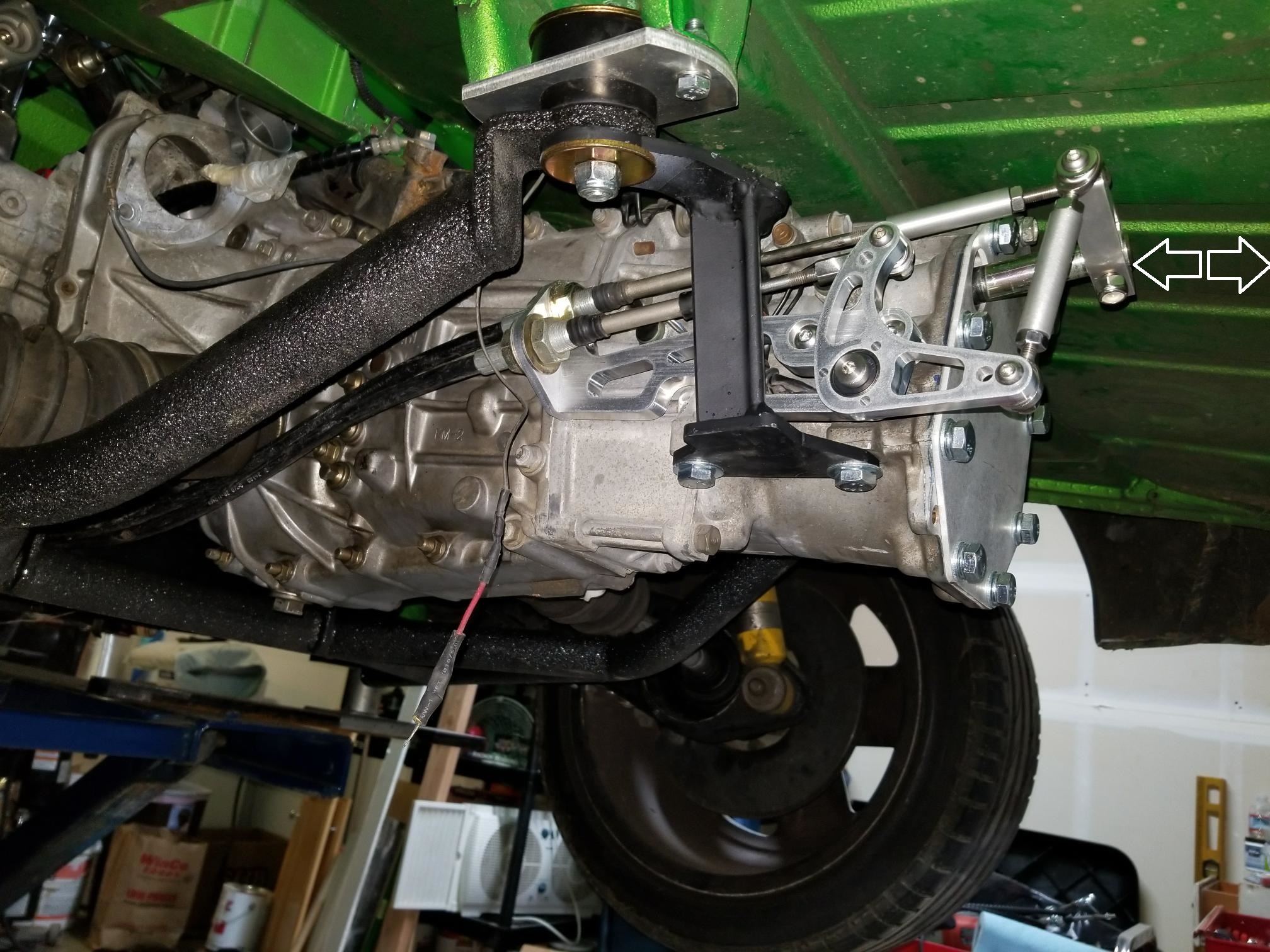

You can get the trans in neutral manually at the shift rod if you need to. It slides in and out of the trans (see arrows) and there are three positions it clicks in to. the middle one is neutral. You will know its neutral because you can rotate or twist the shaft by moving the linkage at the end.

It looks like the trans flanges are centered with wheels. Why are you setting it back another 4", Jaime? (IMG:style_emoticons/default/beerchug.gif)

QUOTE(76-914 @ Mar 16 2018, 06:00 AM) *
They aren't centered. Moving it back 4" would get them centered & where they were with my previous setup. Just an oversight on my part between my old cradle & the new one. Just ordered the cold water one. Which is fine & a good cradle. It is just made with the option of using the 901 tranny or the suby. I could keep it as is but think I'd need to get new axle's. I think the extra angle will just tear them up as they are stretched a bit. Plus this made things tight for my turbo at the firewall as well. I'll see what my wrench suggests is the better way to go
