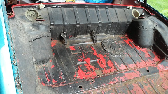

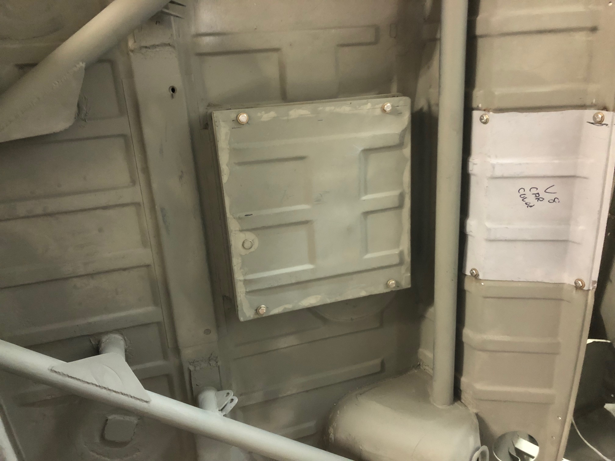

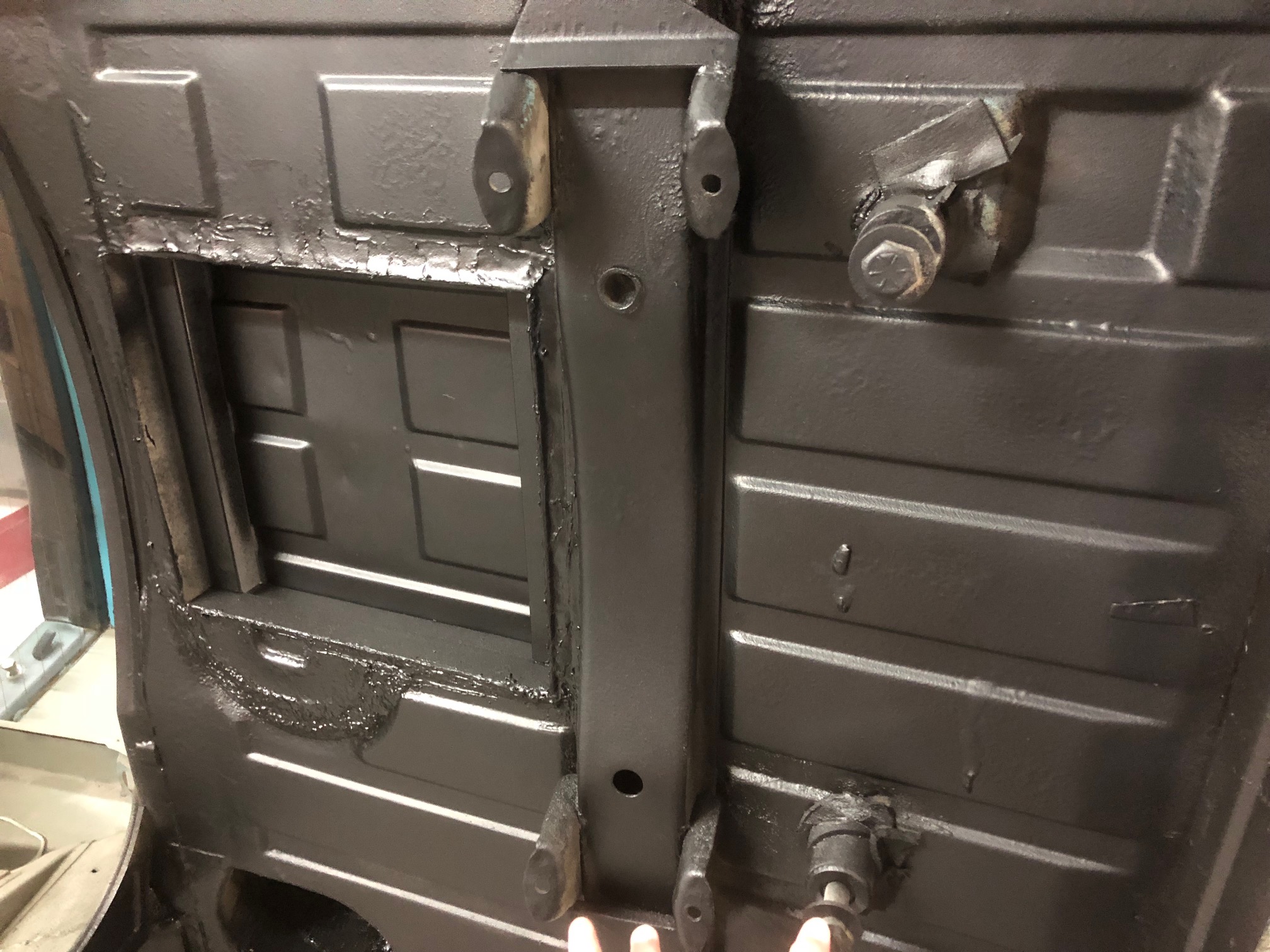

Pictures of my V8 car for the 930 trans. I made a raised area in the trunk (for the clearance)
and then got metal from Bruce Stone so I could make the cover fit and look right. Also did a cover for access to the distributor.
My trans is also moved back a couple of inches and the drop-down bracket show.
You could do it and paint the cover later.
Best,
Bob B
Attached Image Attached Image (IMG:style_emoticons/default/welder.gif)

Hey Bob as usual you work is top notch. I will probably weld in the extra tower braces as well. Worry about cutting the rear trunk structurally. Not a huge area but be good to stiffen things

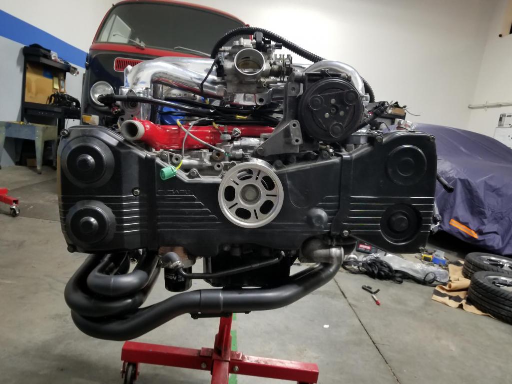

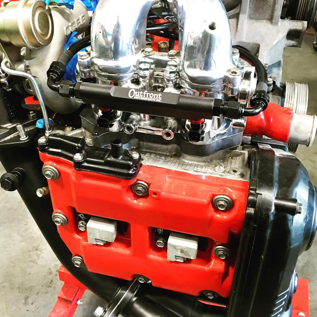

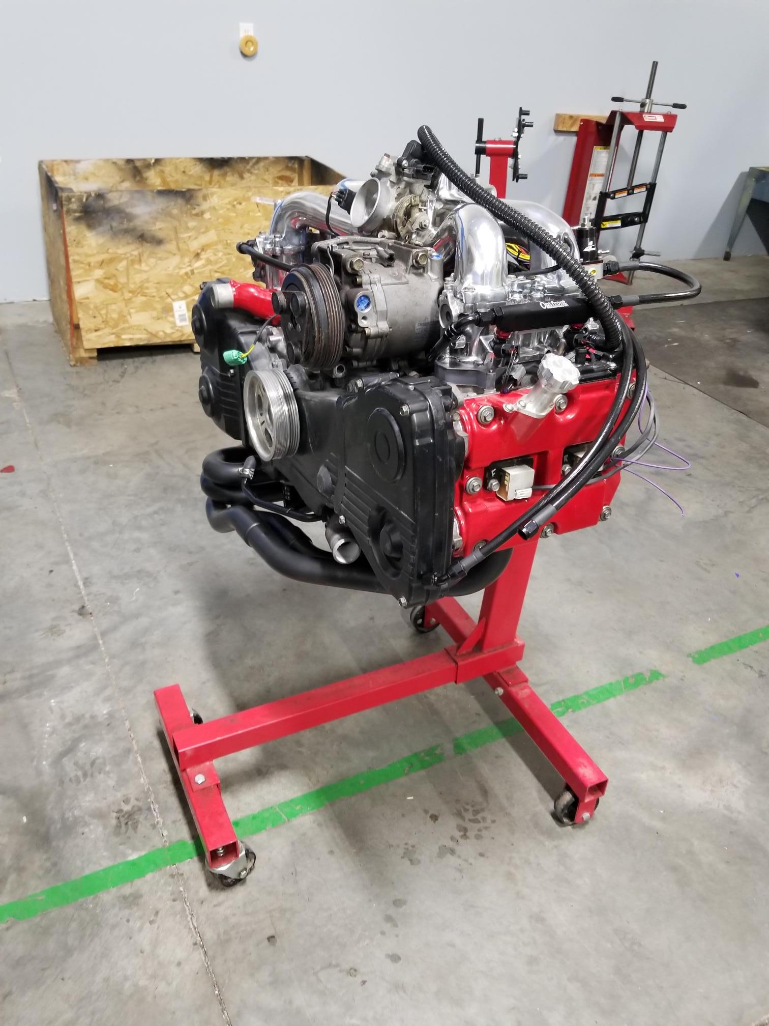

Well haven't seen a lot of progress though plenty has been happening. Here is a picture of my motor finally coming together. With the intake flipped the ac compressor wouldn't fit. Added some risers to the intake to make space. Upgraded my turbo & Fuel injectors. Relocated the turbo to the stock subaru location. Cut out more of my trunk for the turbo relocation. Everything has been long & drawn out. Not to mention expensive. Didn't intend to have so much work done by my wrench. Just changed so many things once I left it there. Mike does good work so in the long run it will be worth it. It will definitely end up much nicer than if I had done all the work myself.
I haven't updated this in a while & this isn't much of one.

I was just wondering how the car was coming along! Maybe I'll see it at Rt66 2019? Nice looking engine. (IMG:style_emoticons/default/beerchug.gif)

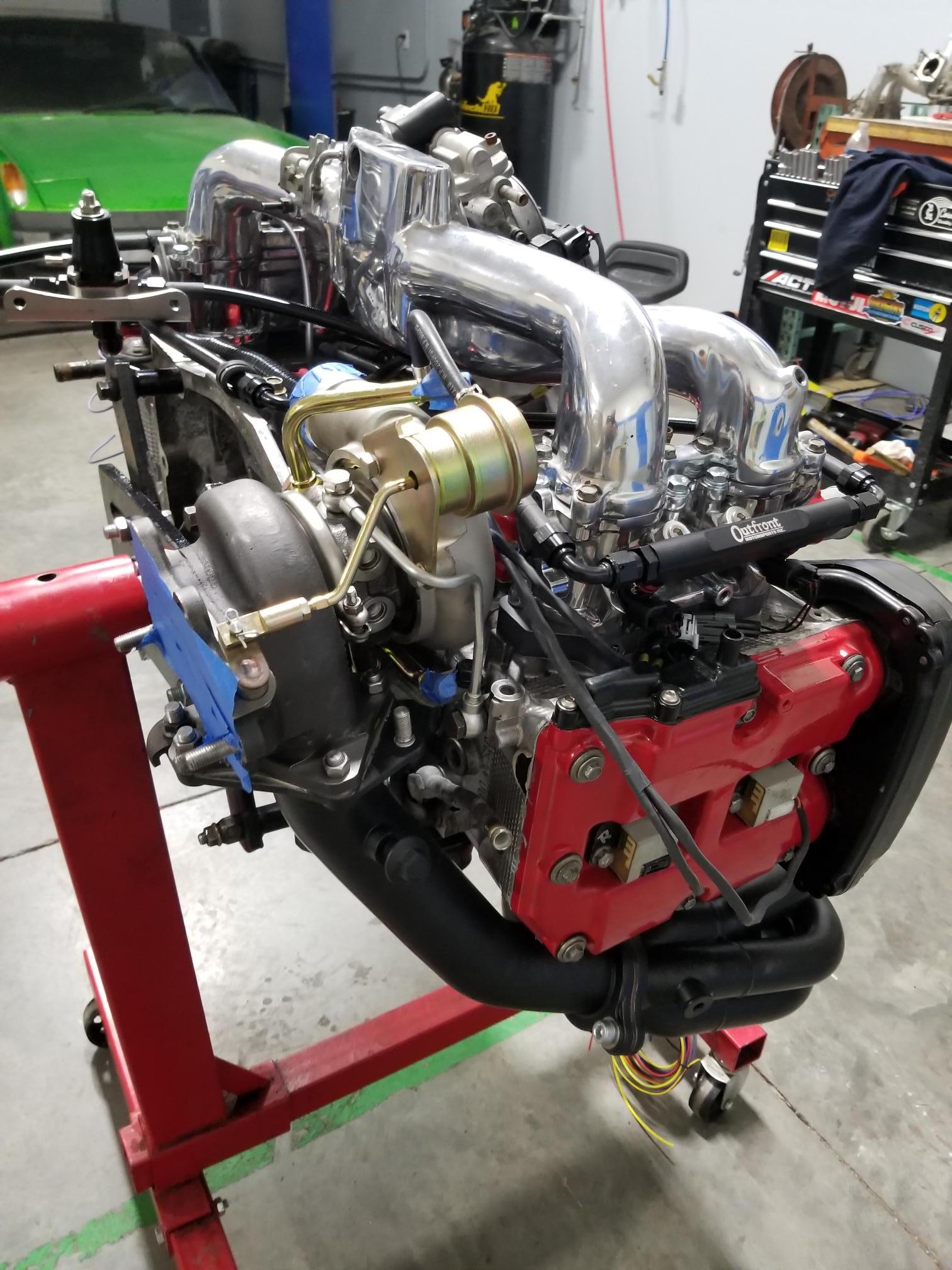

I actually looked at my car today. Took a few pictures of my motor. Supposed to go back in tomorrow to get the exhaust fabbed. The AC unit is a little ugly & the alternator will fit int he middle but only with a smaller belt. Adding the risers to the intake did the trick to fit the AC unit & alternator though. The rest of the AC will be on hold though. I'll be to damn poor to do anything extra. I just want to drive it again. Took a couple pics of my cold water cradle that I had modified so my axels would line up how I want. Basically the motor mounts needed moved back 2".

Is that an Unorthodox pulley in front? I've heard some good things about those but haven't made up my mind to use one yet... But that cradle is looking great as do the details on the engine!

QUOTE(mgp4591 @ Aug 1 2018, 02:28 AM) *
It's looking really good! (IMG:style_emoticons/default/biggrin.gif)
I'll find out for you Mike. I'm not sure on the pulley
