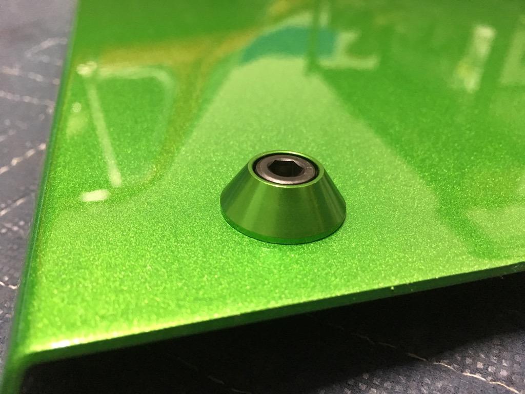

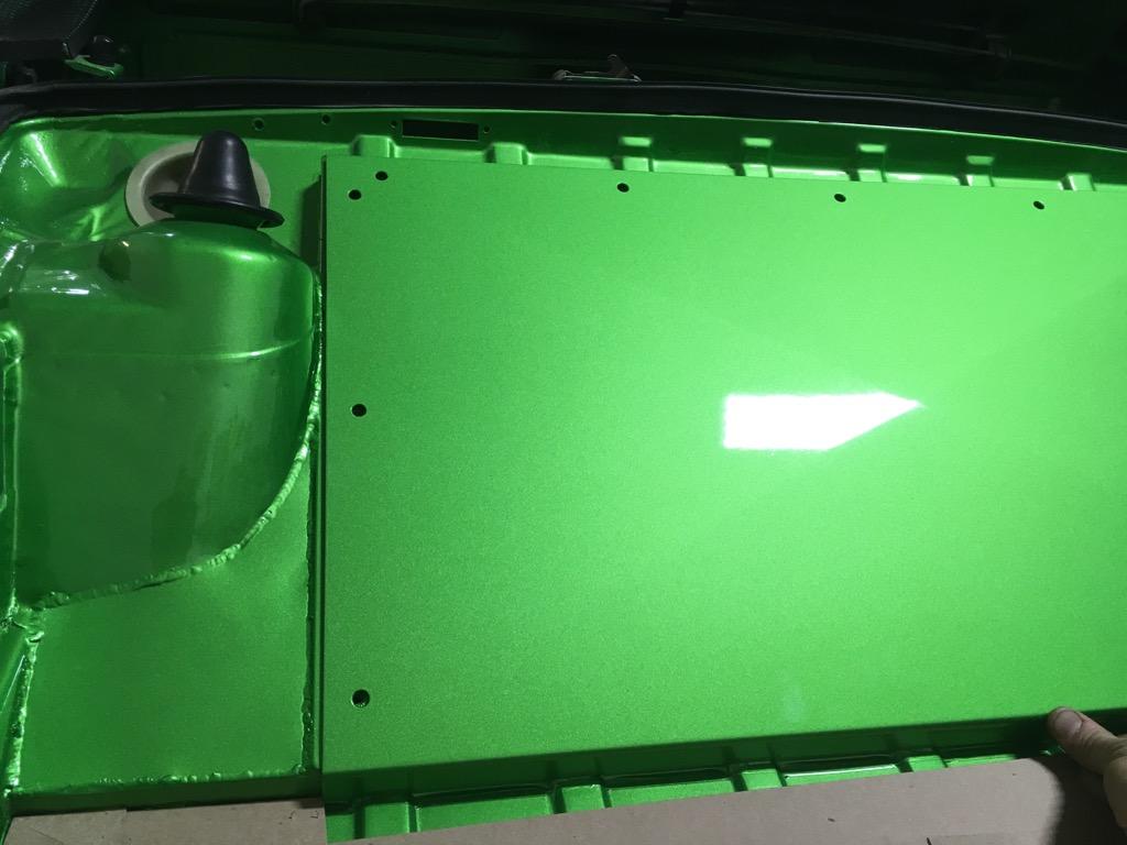

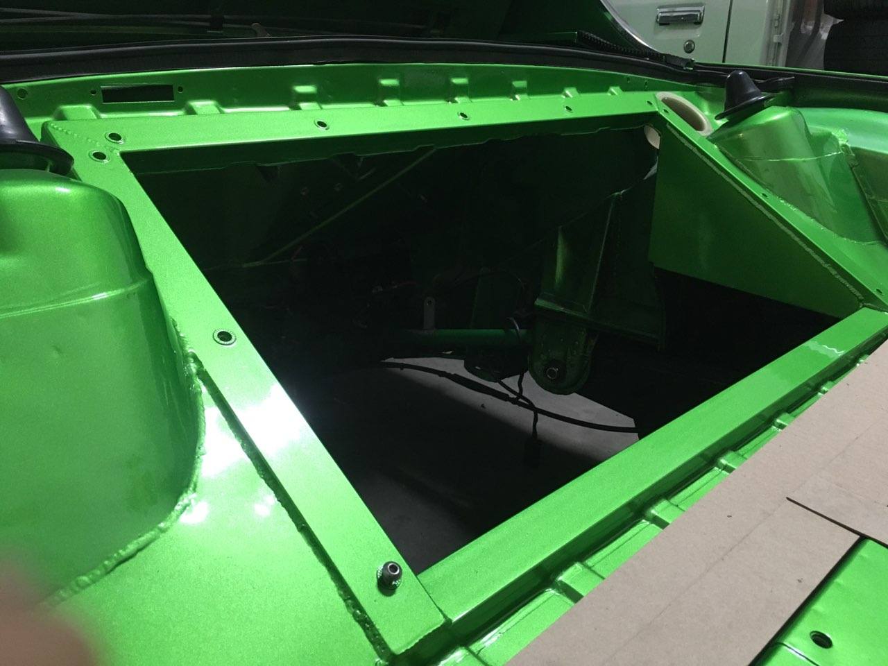

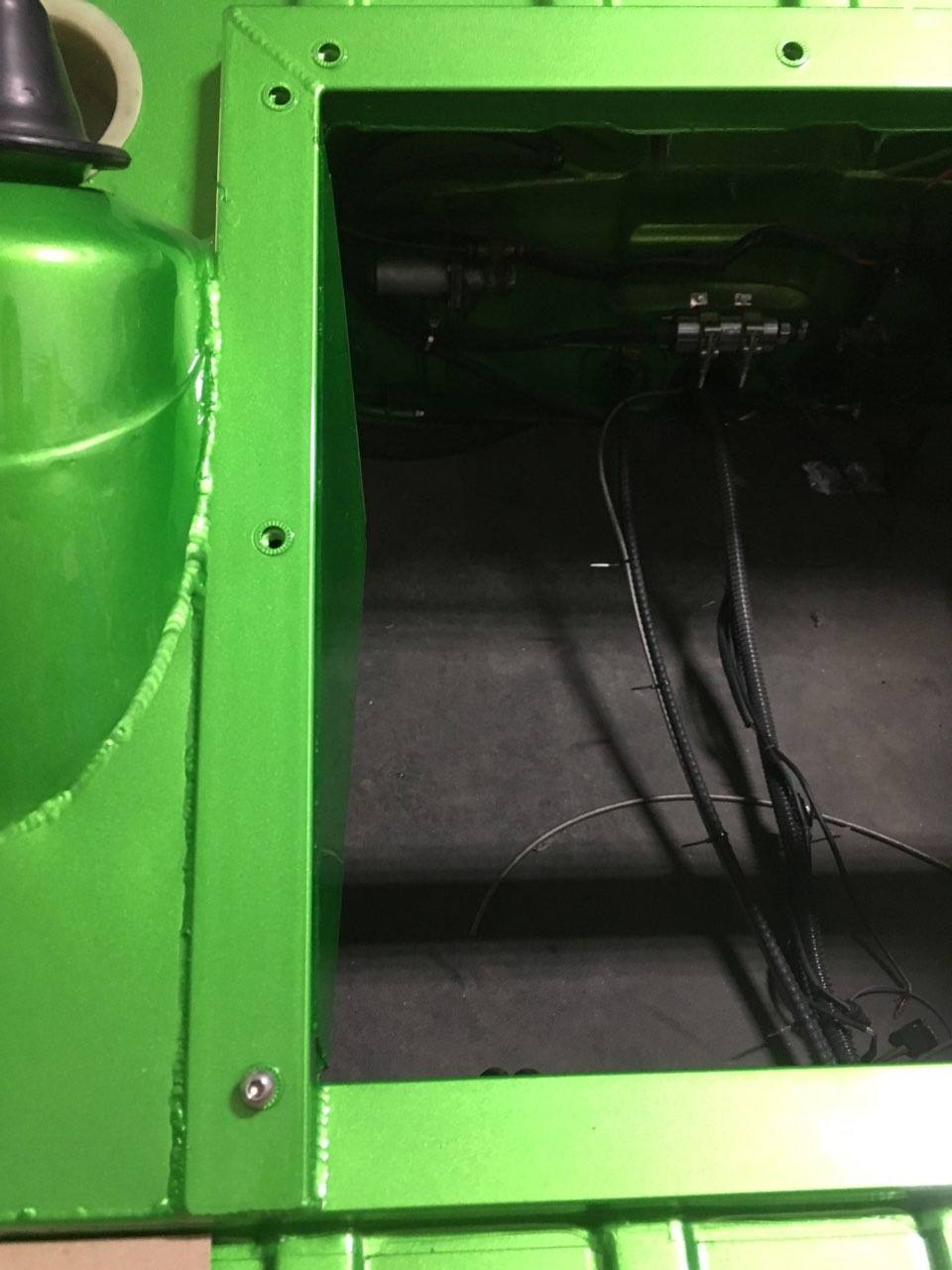

Well not much has been done the last few months on my car. It did get back from getting the trunk cut & cap out painted. Really happy with how this turned out. Super solid yet easy to remove for extra access. I'll get more pics of it someday. These were just a few quick ones from my shop. Been kind of tucked into a corner without anything happening. MY daughter is getting married later today. So money wise I've been kind of content to just let it sit. Weddings are expensive (IMG:style_emoticons/default/dry.gif)

Looks fantastic, Jaime! Hope to see it at Rt66 or WCR. (IMG:style_emoticons/default/beerchug.gif)

Wow, Jamie that looks great! It will also give you great/easy access to the drivetrain. Congrats/best wishes to your daughter, and I hope you can jump back on your project soon.

The details are looking great Jamie!

That looks great!!!!

Yeah that trunk access solution looks GREAT Jamie!

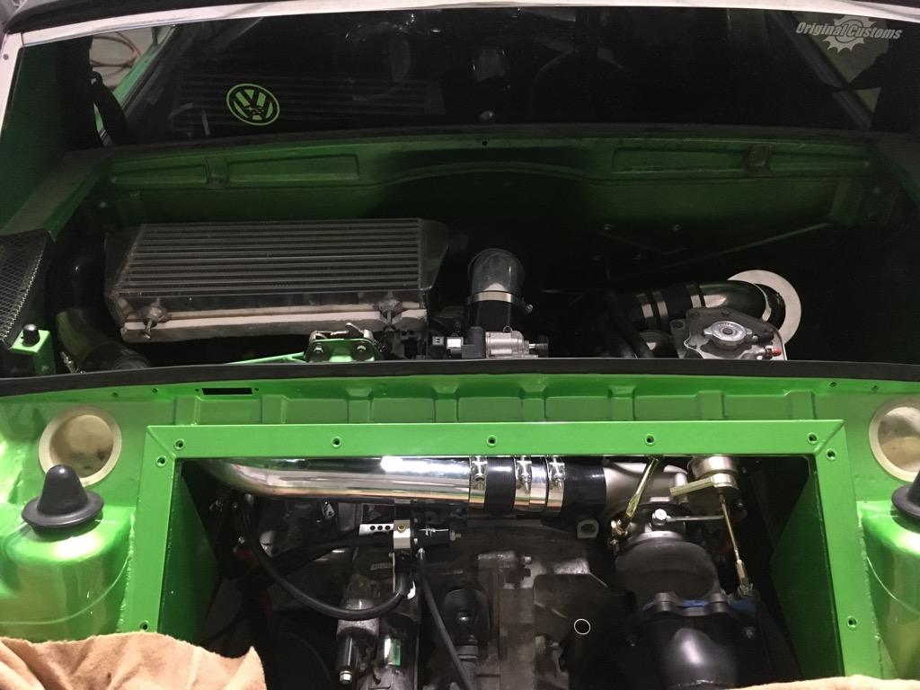

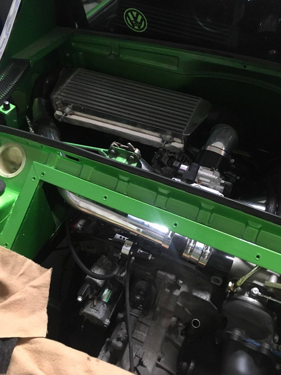

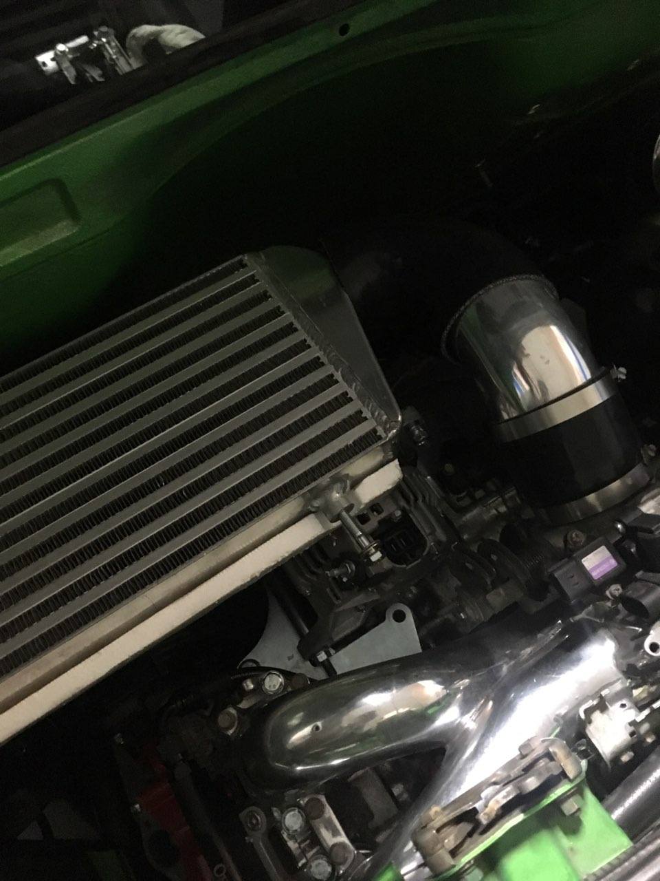

Couple more pics. I will probably end up changing my intercooler. I want to see if it will cool enough with just the air. Going to run a couple small 6" fans to help pull air through it. Just need to run the line for the Clutch MC & tidy up a few things. My wrench is actually working on it again. Had a fiasco with the Fab guy we were using. Guy has cost me at least 4 months. We are done with him finally. At least he got to give me a nice big bill as a going away present (IMG:style_emoticons/default/dry.gif) . At this point I'm just glad to have my car back as the focal point. It really isn't that far off from being done. Last real obstacle is finding someone to do my dyno & tune on the Stinger ECU. My wrench hasn't found anyone willing to do it locally. Outfront has been not great in returning calls. They also have moved on from Stinger ECU's. Anyway I've got to do some calling around to the Dyno's in my area to see if there it someone who will do the tune on my Stinger ECU. The light at the end of the tunnel is at least flickering

Wow looks good. I may need to copy your solution on the access cover. Well thought out. My swap has stalled with your old settup too. Floor pan repairs, seat brackets, pedal cluster is the focus. Hoping for Rt66 in 2020.

What size tubes did you end up using for the radiator?

Gates green stripe 1" 1/4
