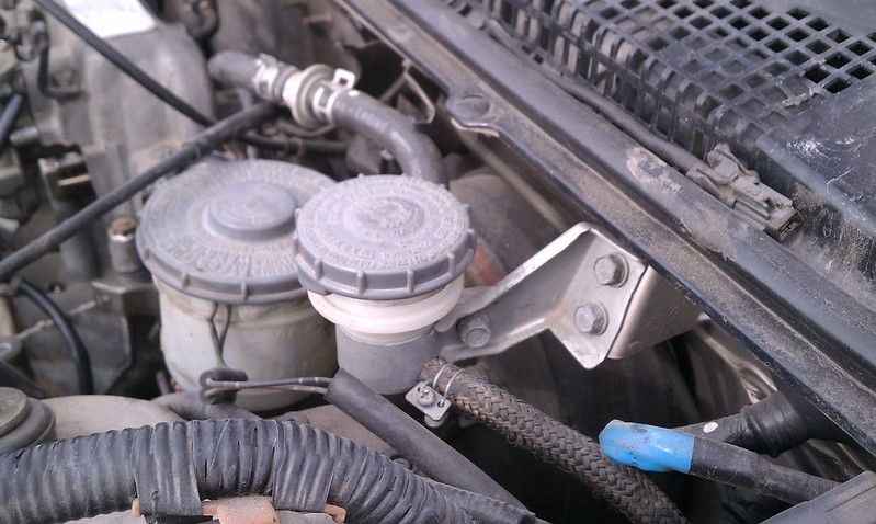

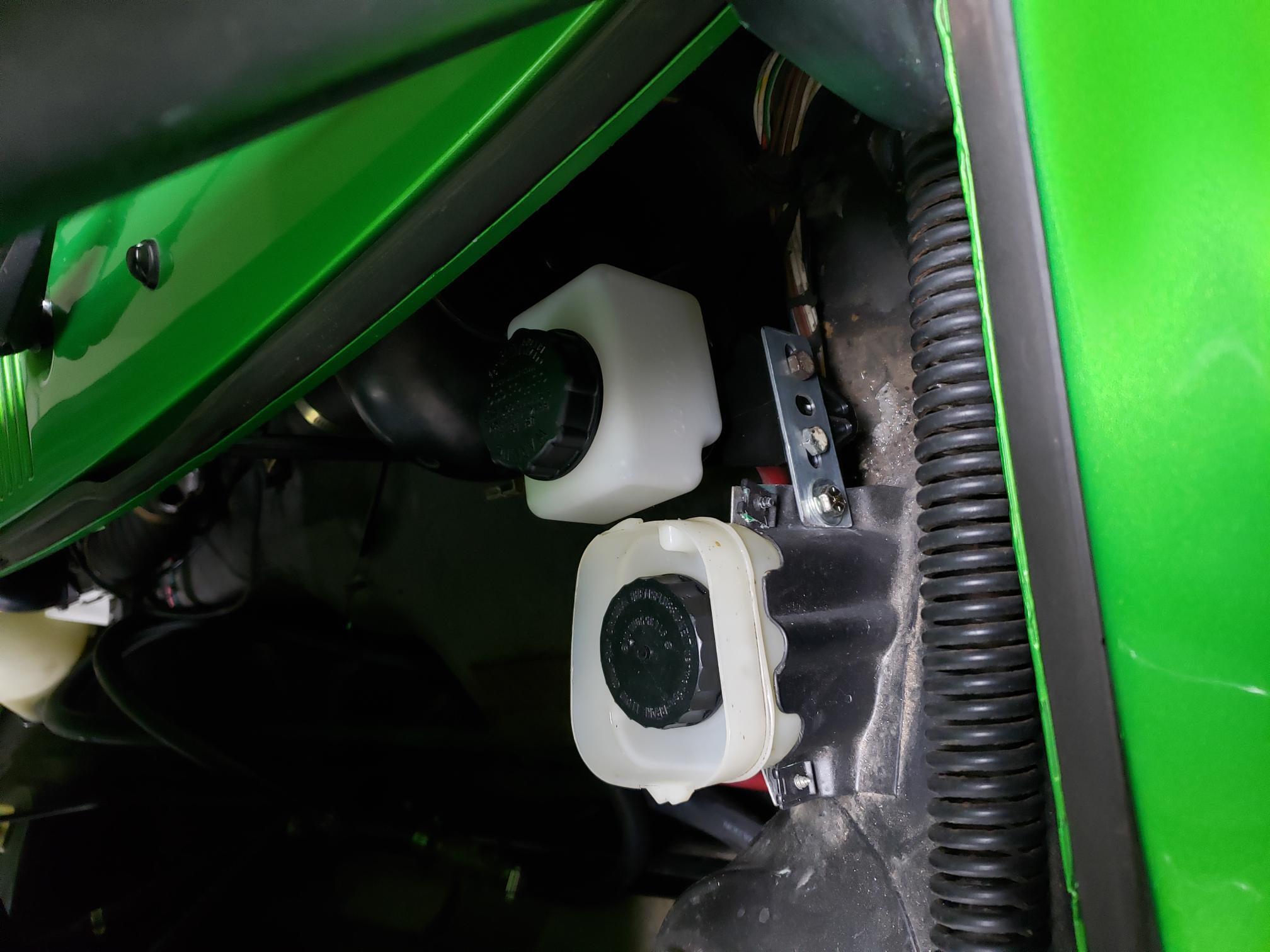

I snagged one off an early 90s Accord, 90-94?. Bolts to the brake reservoir bracket.
(IMG:http://www.914world.com/bbs2/uploads_offsite/live.staticflickr.com-431-1559462546.1.jpg)
(IMG:http://www.914world.com/bbs2/uploads_offsite/live.staticflickr.com-431-1559444111.1.jpg)
(IMG:http://www.914world.com/bbs2/uploads_offsite/live.staticflickr.com-431-1559444112.2.jpg)
Yep, photographic memory (IMG:style_emoticons/default/laugh.gif)

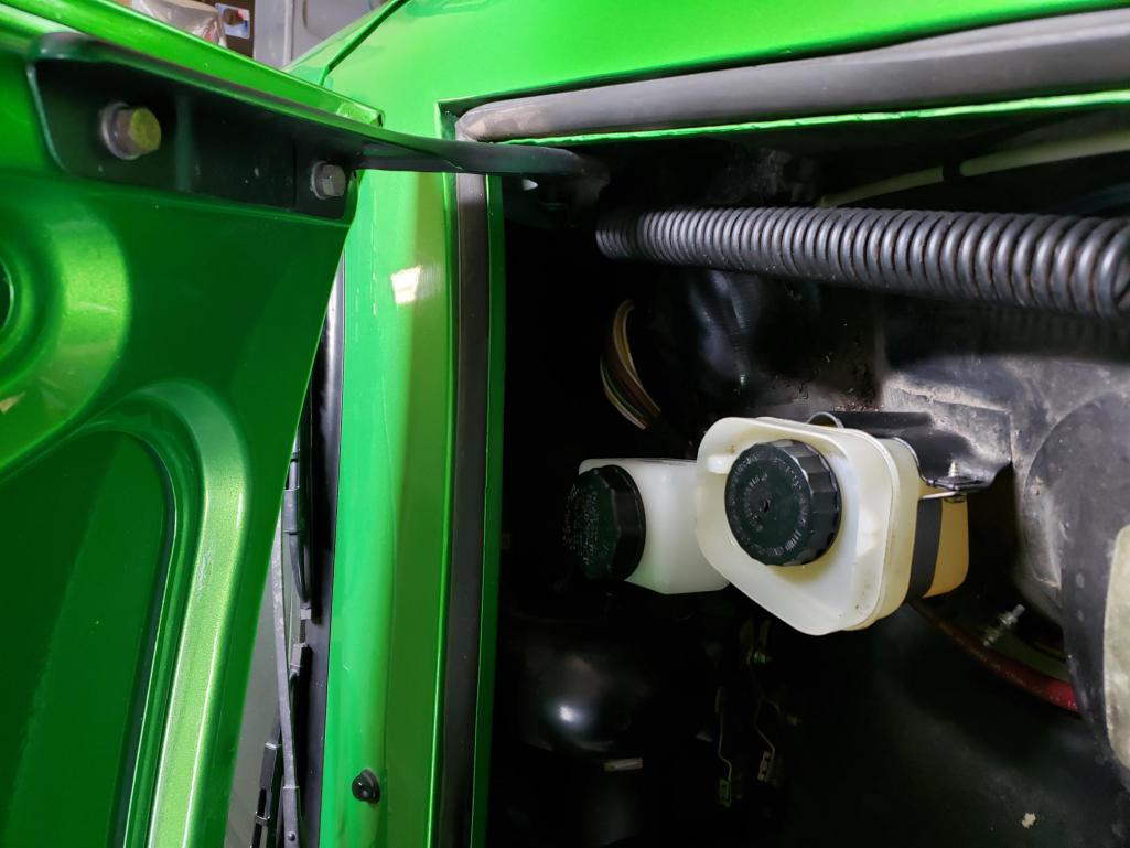

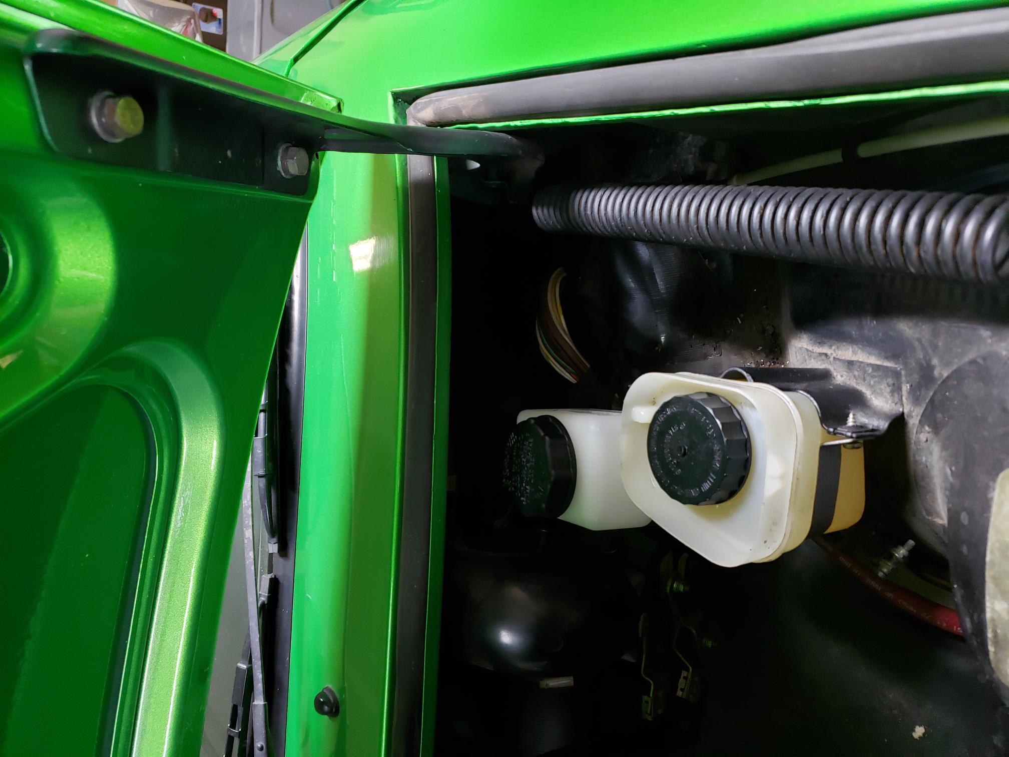

Here is the reservoir. It will sit there just fine. Just need to make a mount. Really should be no big a deal. Just a bracket coming off the Brake reservoir mount.

I used a Wilwood remote mount on mine.

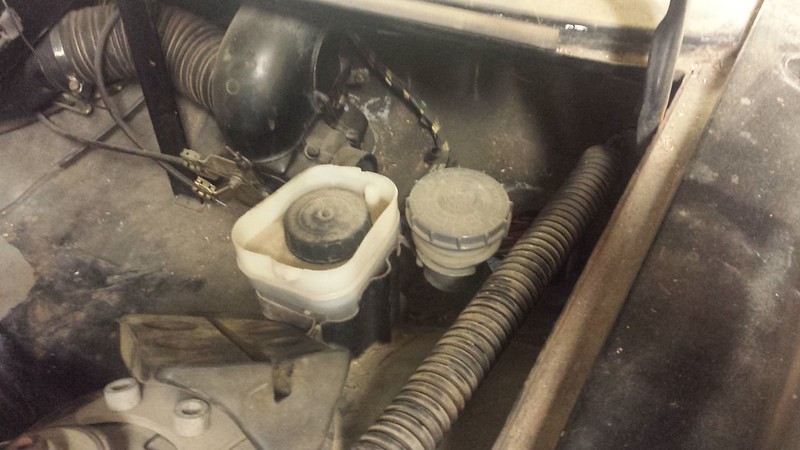

Tilton three chamber, no leaks, a thing of beauty. Push on or AN fittings, not sure why people use anything else, except being CSOBs.

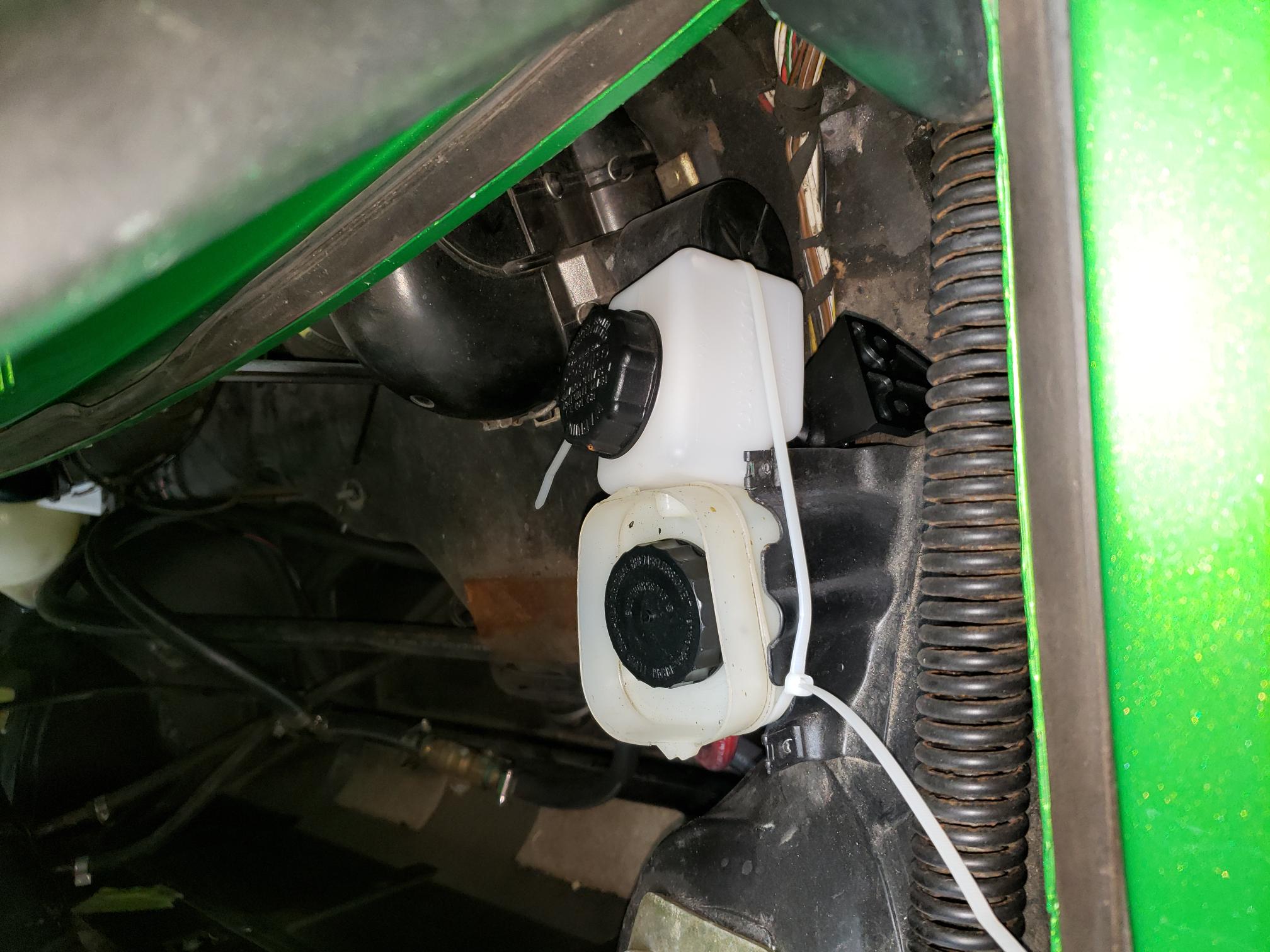

Okay Clutch MC reservoir is in place. I used a Wildwood remote one as well Bob. Just keeping it simple. It's solid & in a great spot. No clearance problems. I did add fluid to find I didn't have my line tight down below. SO it all leaked out on my floor (IMG:style_emoticons/default/dry.gif) . Kitty litter to the rescue

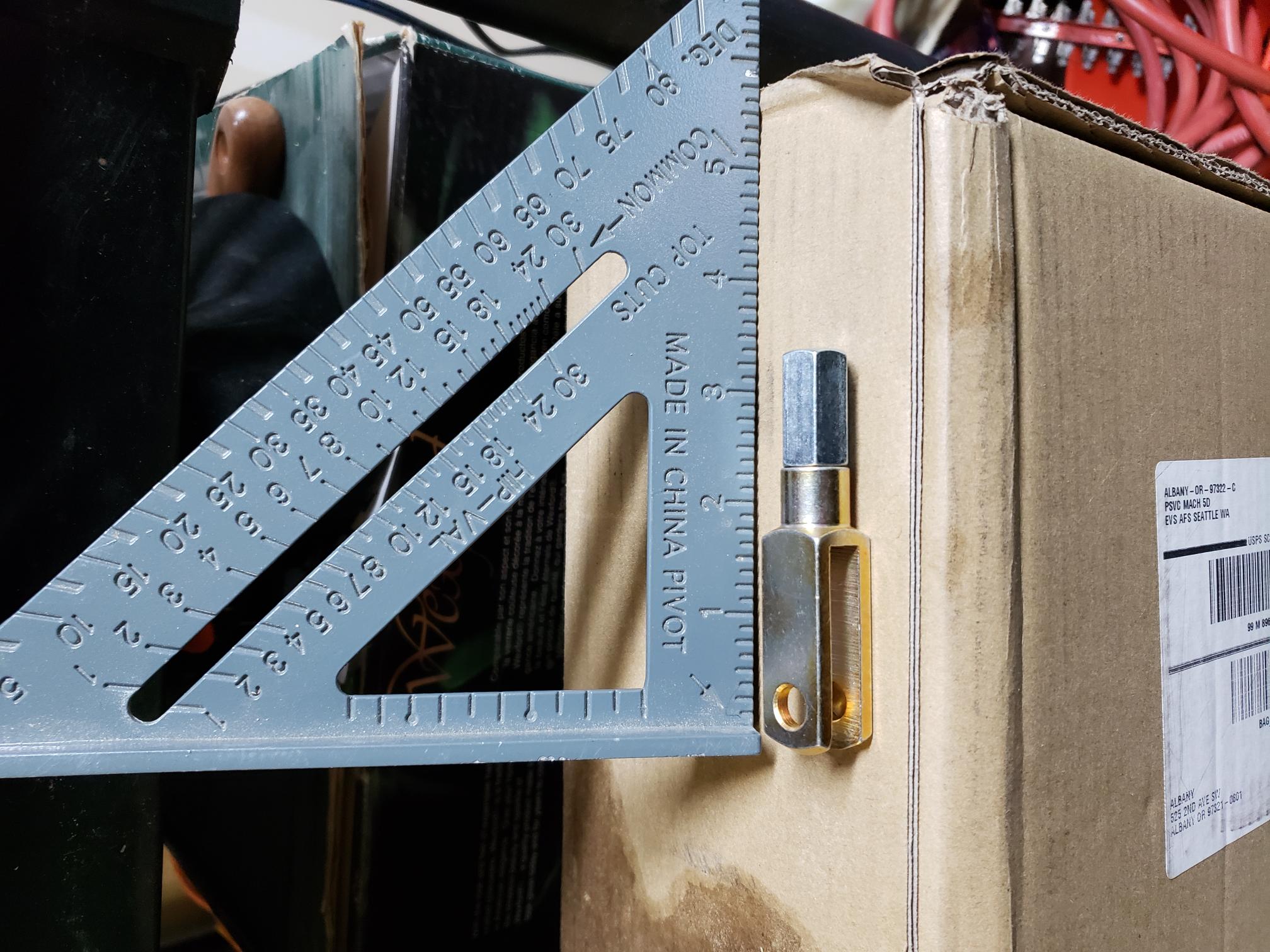

Was out trying to bleed my clutch MC last night. Picked up one of the hand vacuum bleeders. Even had the wife out to pump the pedal some. Just didn't get much of anywhere. Pedal won't return all the way. In back watching the clutch move it doesn't move much. Figured I need to extend my MC bolt so it will engage. I had finally found a longer clevis joint. Not long enough as I need about another inch of length. Going to get a deep nut with a stud & give that a while Nut

Jamie, after you confirm that the long nut (aka rod socket nut or coupling nut) PM me with the length of the rod that you need and I'll make you one. (IMG:style_emoticons/default/beerchug.gif)

Here was my solution of extending my clevis joint so it was long enough. Still adjusting back & forth trying to get the right length. Gave up on it tonight. Such a tight spot to changing things. I put it on & off multiple times. It is really close but I couldn't quite get the locking pin through. Figured if I let it go tonight it will go on easier tomorrow night
